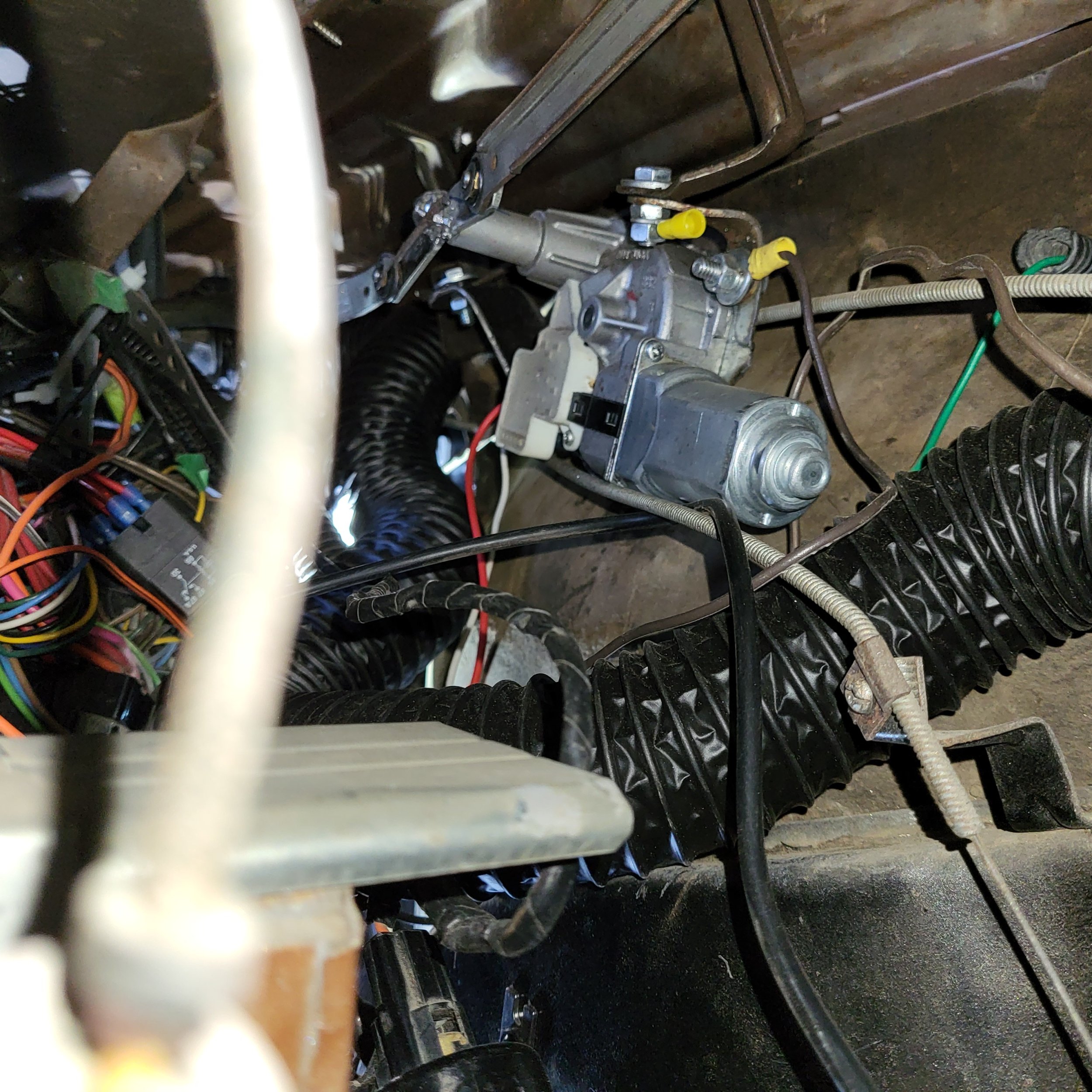

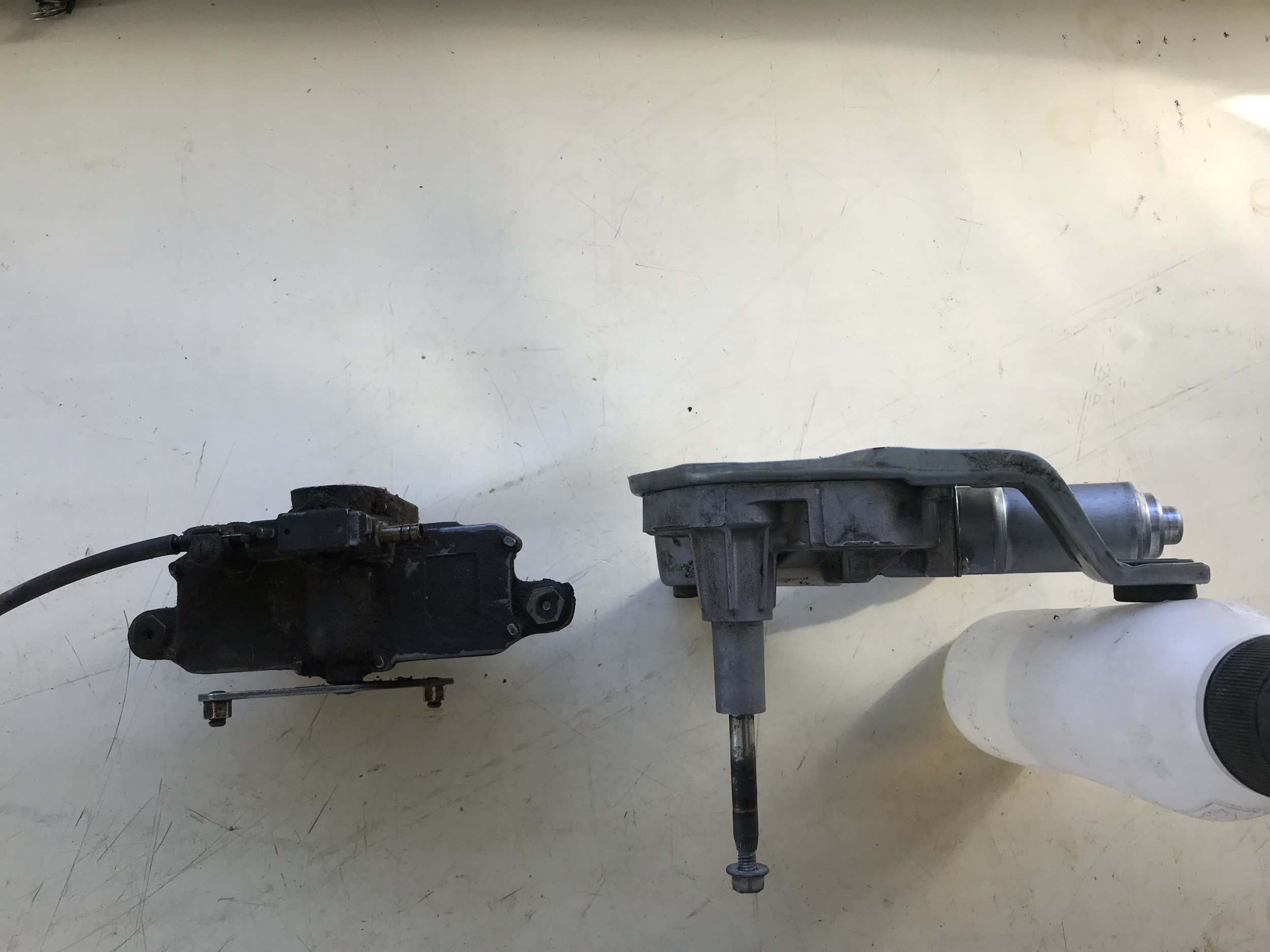

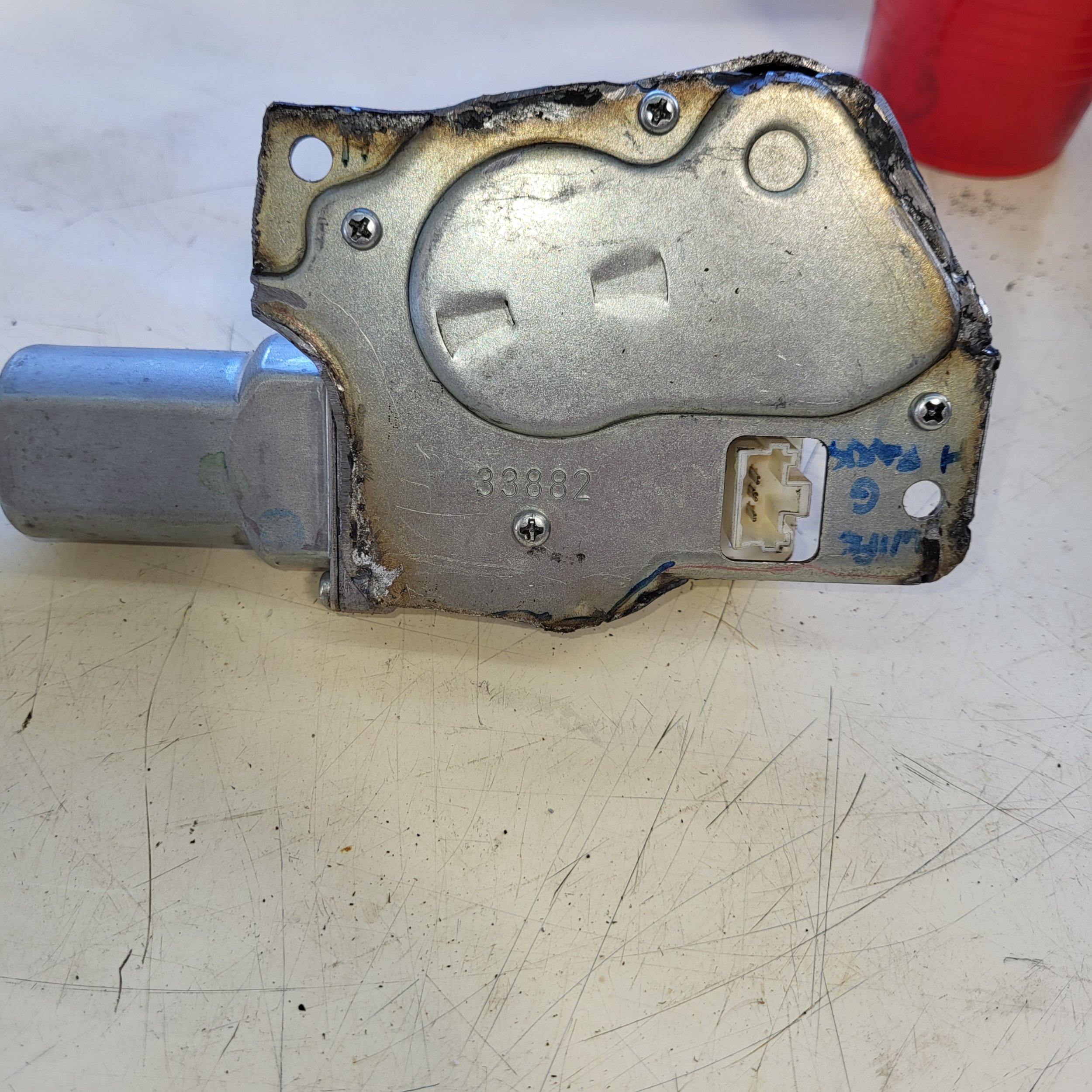

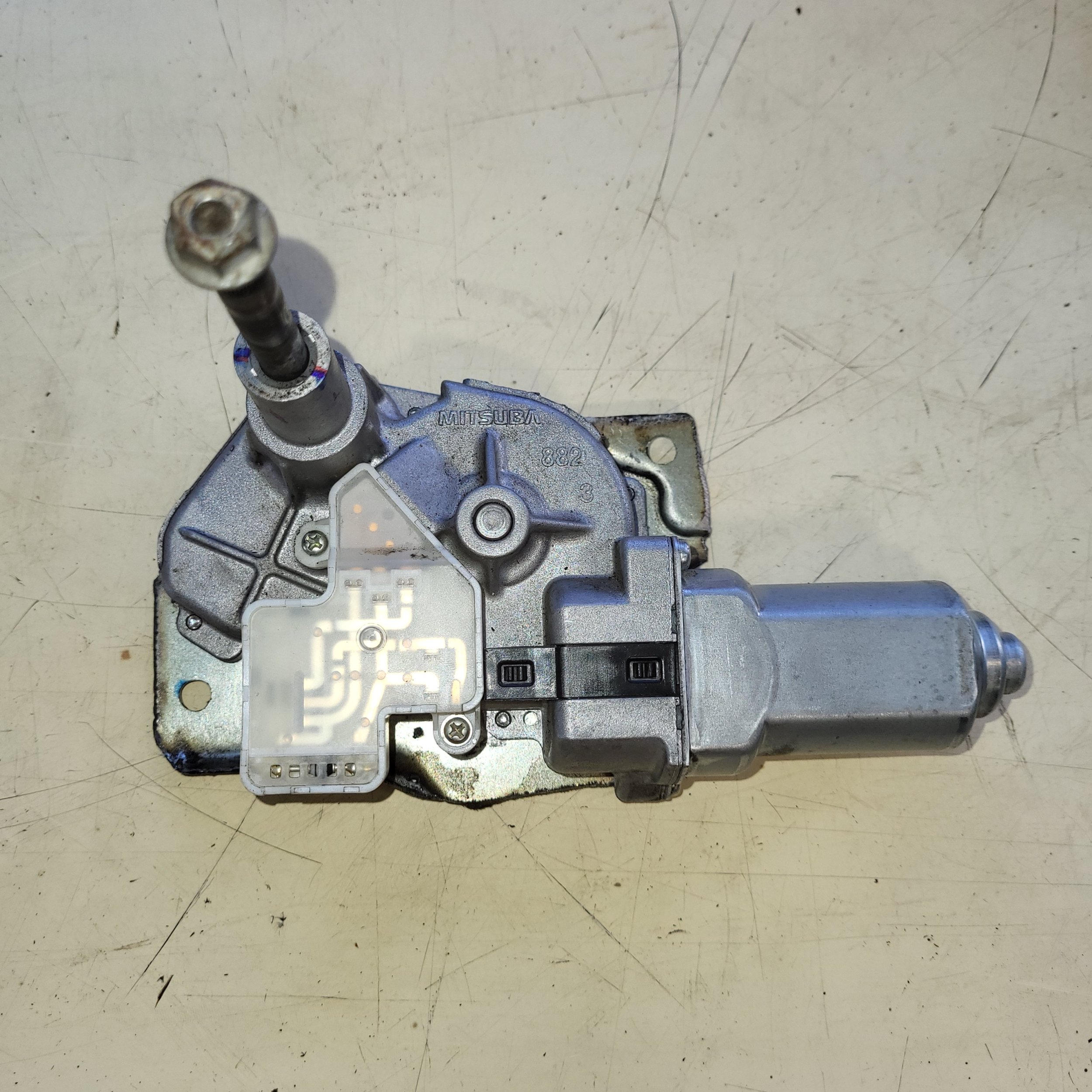

    I used the rear wiper motor from a 2010 Jeep patriot and adapted it to the original setup for my 51 Pontiac. It is single speed and the biggest issue was getting the sweep to work properly. I will be redoing it and making it look pretty in the future when I redo the wiring but I do have decent wipers now. Hope this gives you some ideas. IMG_3173.jpeg IMG_3174.jpeg IMG_3750.jpeg IMG_3749.jpeg IMG_3748.jpeg

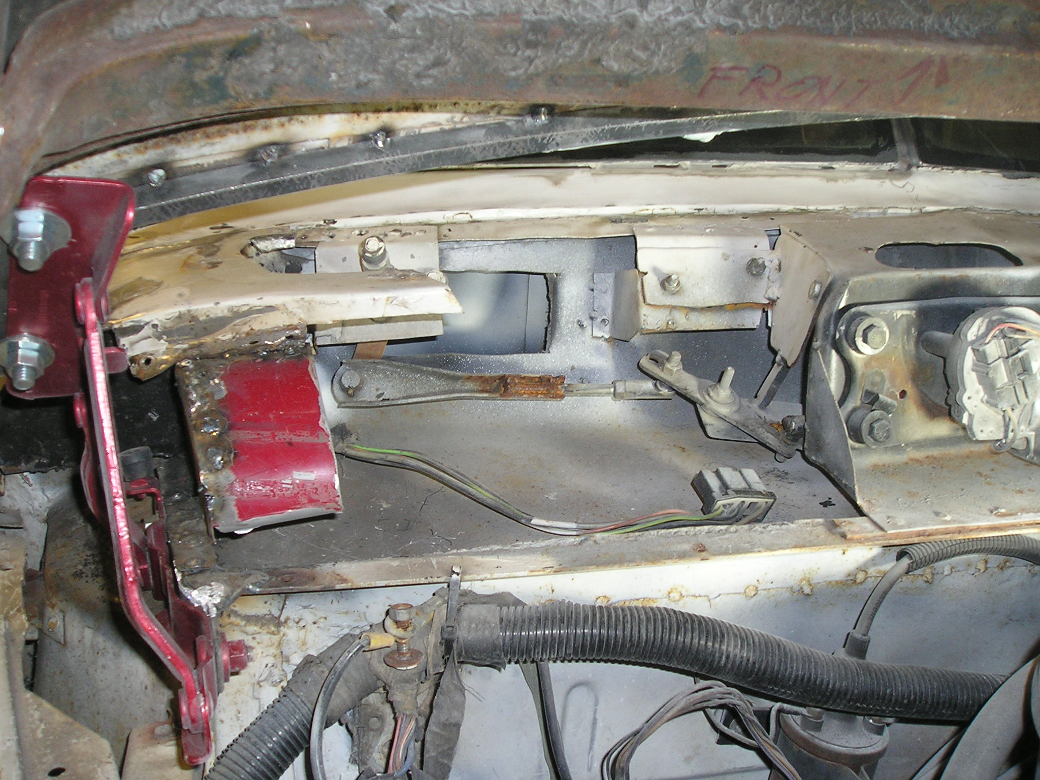

    Just for kicks pictures of the adapted wiper system on my 48 Plymouth coupe. All I had to do was cut off the top of the cowl, box it in and seal it, then mount the wiper system, complete with the idler to reverse the passenger side wiper operation. This system is out of a Dakota, I used the driver side wiper post on both sides so I had a 90 degree wiper sweep.
    Then I built a new cover for the cowl, but it has to be removable so I have access to the wiper system if I ever need to replace anything.
    This system has been functioning since 2011, the car has been driven about 90,000 miles. The system is a bit noisy, but it functions very well. This wiper is a 2 speed with the wiper park. Doesn't have to be pretty, its all covered up (and the car isn't really very pretty either).
