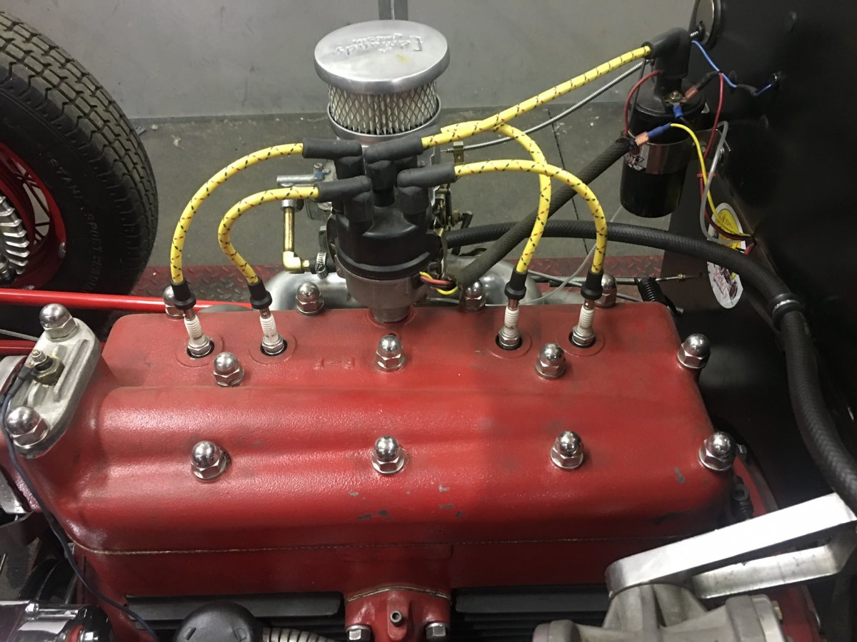

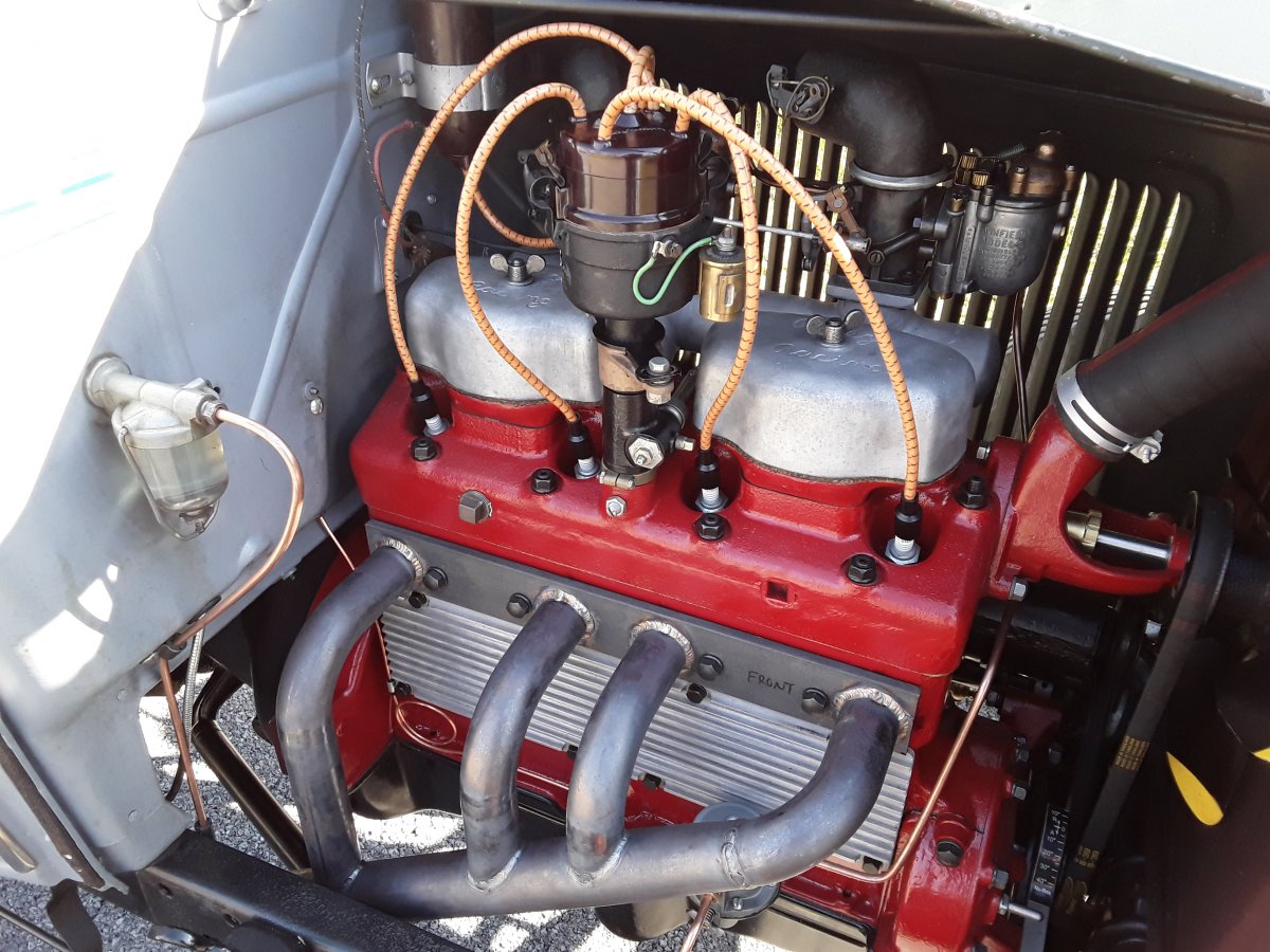

    Welcome! I like bangers too!. Here's a pic of my Model A Engine and my Riley for a later date![​IMG][​IMG]
