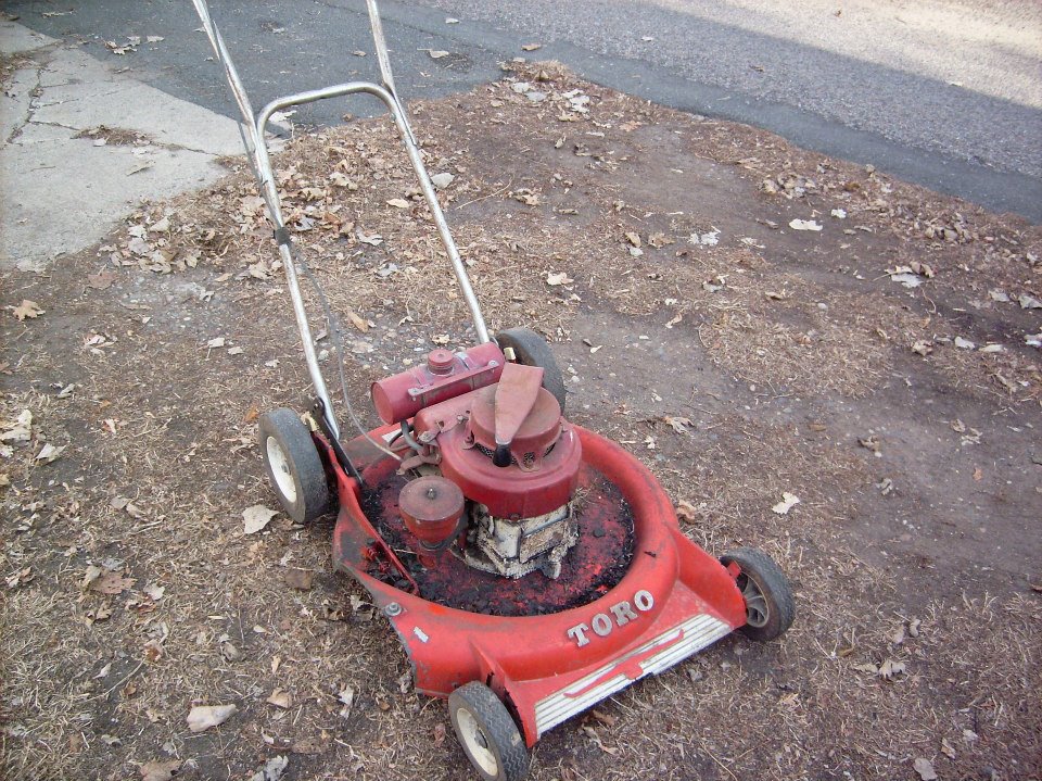

    Yeah man, I have a love for old machines.
    I picked up a '64 Toro Whirlwind from the inlaws. It's a hand crank start. Pretty cool! It kind of matches the Big Mow.

  16. gregaustex
    Joined: Feb 20, 2009
    Posts: 136
    gregaustex
    from Austin
    That Toro has the same tank layout as your modified. It may just be me, but I thought that was funny.:D

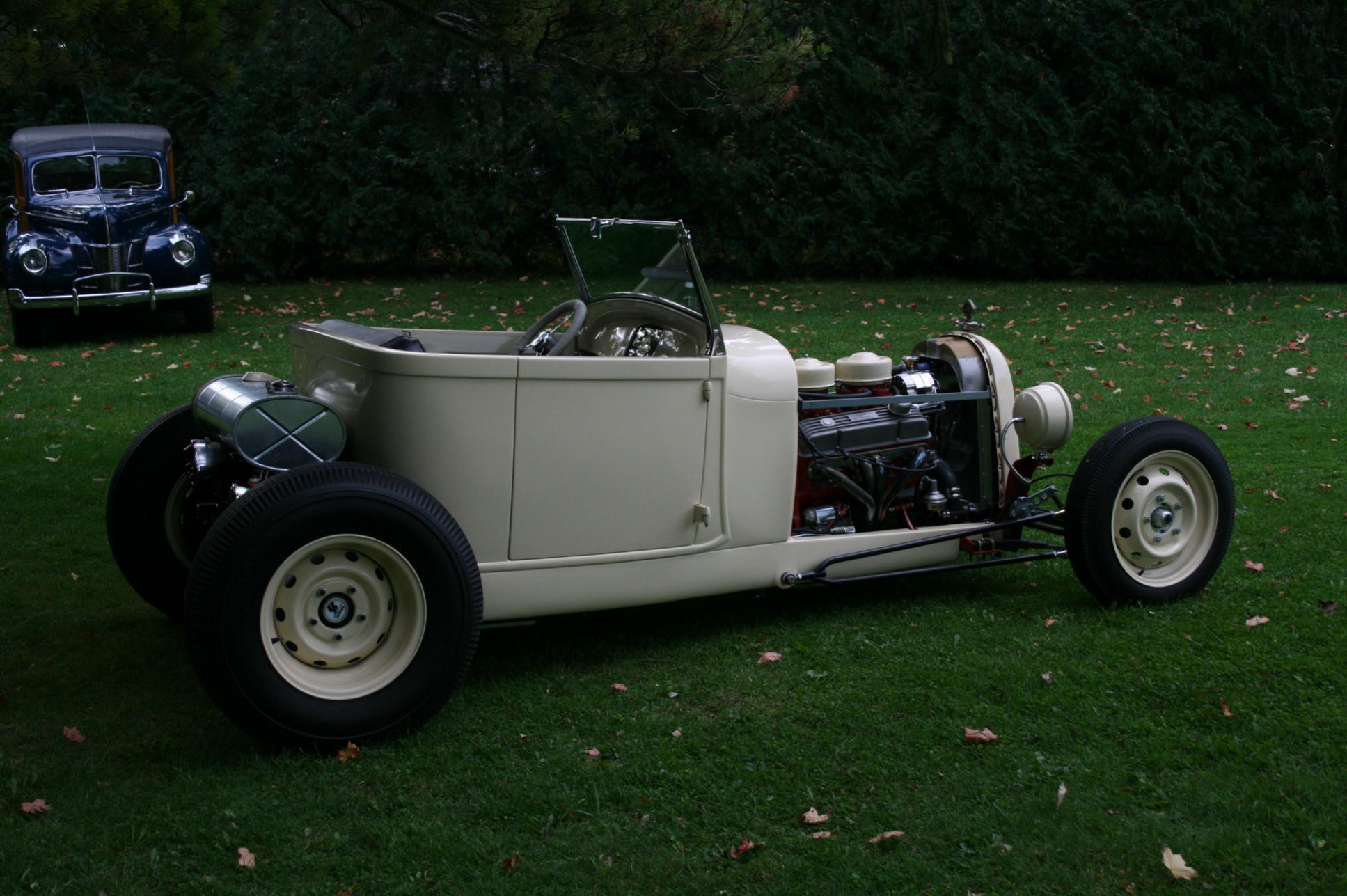

    Here are a few of the "modifieds" the Limey Kid and I built under our Real Hot Rods banner a few years ago. It was fun whiloe it lasted. The cream one is my summer driver. That's Tom "Stroker McGurk" Medley at the Streetrod NATS about 12 years ago.
