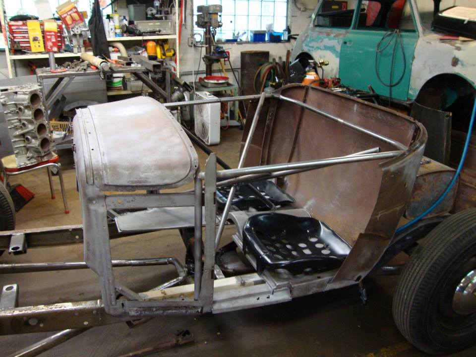

    Well, I found out a week ago that I have to be out of the house we are renting by Aug 1st (landlord getting foreclosed). Neato. I can't seem to catch a ****ing break this Summer. There just hasn't been any time for myself. Now I get to move! I almost have my teardrop finished up, so it looks like we'll be getting some use out of it while we wait a month in limbo to get in to our other place.
    Anyway, I parted out a car and noticed the seat bases looked nice and light weight. I cut them up and set them on the floor. I'm going to have a bench looking seat, but have these be the seat bases. So they will be covered up. They have a nice shape, and I sit in the same seats every day in my daily driver. I have the foam from the front and rear seats so I should be able to carve something out that look like a bench seat.

    Well, this will be day 6 of being homeless! I spent the last two day at the shop. It's the first time I have had in two months to work on the car. So sad.
    I have not had the internet for a while now so I don't get on here as much either.
    I finished patching the left side cowl panel. It's not as good as the first one I did but it should come out fine. I welded both panels back on to the cowl after a lot of fitting.
    A bit more t******* and measuring and I had the 35/36 dash tacked in.
    I had bent a tube a while back to go along the lower side of the dash board. I got that welded in place. It'll tie into the hoop and steering mount later on.
    I made a filler piece and tacked it to the original cowl thing along the windshield. It still needs a lot of work but I have an idea on how to do this now.
    And last...
    I found a killer deal on a '26 Roadster tub. I wish this would have been around a year ago! At this point, I'm sticking to my plan with the body. But the 26 is tempting.

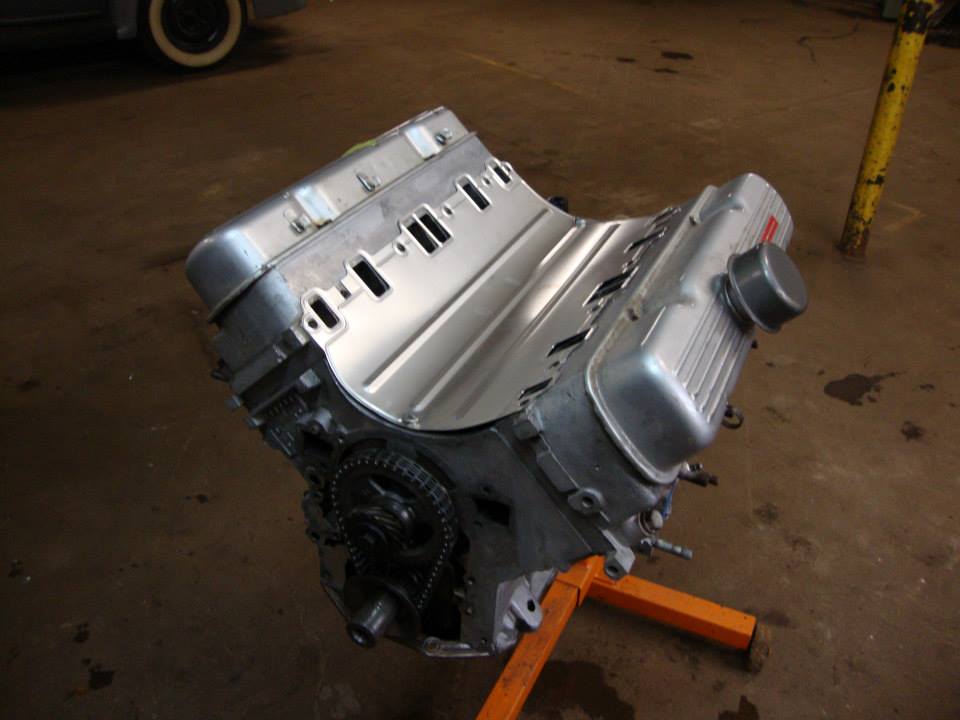

    I have never done any sort of engine work aside from little Briggs and Stratton engines so this is new territory.
    A friend of mine was nice enough to come over and take a look at the newest 215 I picked up and gave me a rough list of parts I needed. The old timing chain was super worn and the PO didn't do a great job on the rebuild. The intake manifold showed signs of corrosion, so I wasn't able to get it bolted back on. Luckily, I had a couple extras and found one that had no corrosion. I pulled the whole front section of the engine off to replace all the gasket and check things out. The PO mentioned the engine didn't have oil pressure. I read the manual and it needed to have some sort of paste in there to prime the pump. I'm ***uming that's why the engine showed low oil pressure when he started it again. I purchase a pump rebuild kit along with it.
    The PO also spray painted the whole engine silver. So I started by cleaning it off and scrubbing things down. I'll be soaking the rest of the parts at work tomorrow so they are clean.
    The surface on the fuel pump cam (?) had a pretty bad gouge in it from wear. Is this bad? I'll get a picture tomorrow.
    Anyway, The engine is looking a bit cleaner already.

    I have most of the engine back together and I'm currently building a run stand to test run it with the Volvo 240 radiator. While searching Craigslist one day I came across a Buick 215 that had an Offy intake and some adapter parts for a 200r4. It was a killer deal. I gave a friend a deal on the 200r4 and traded the trans adapter parts to a different friend for some Offy valve covers he couldn't use.
