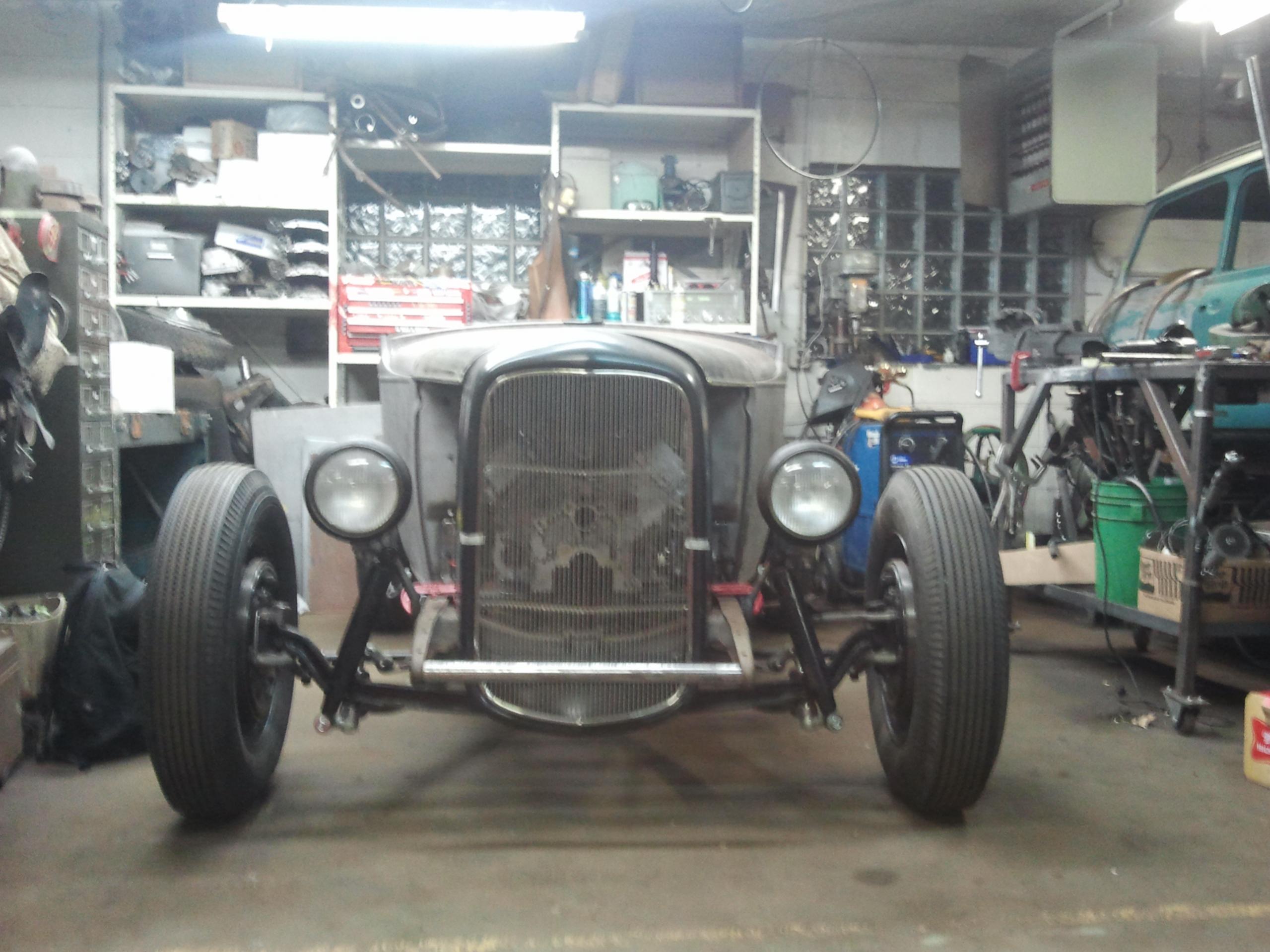

    I'm also figuring out headlight position. Opinions would be nice. This is not an easy thing.
    Holy **** those photos are huge. I will resize tomorrow.

    Looking good man. I'd move those lights down and towards the grill, about an inch or two both ways. Makin progress, Keep at it bud!

    I'd say move the lights in towards the shell so there is about half the gap and down a few inches. They look a little buggy where they are at.

    Thanks for the input. The headlights are only hose clamped in place right now. It's difficult to get a good look at them holding them in the air.

    New position after many other positions and a million photos and stool time.
