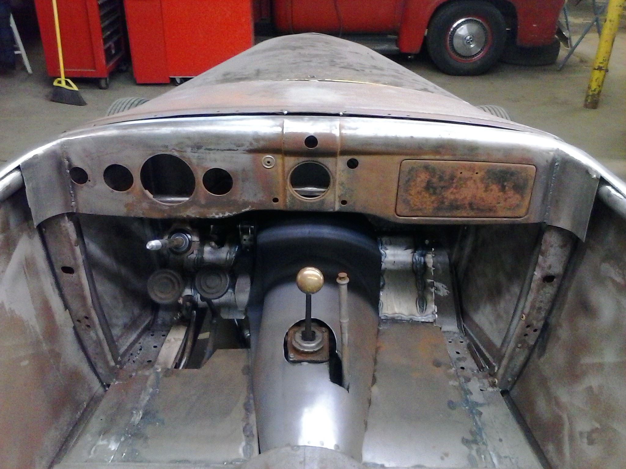

  30. Beau
    Joined: Jul 2, 2009
    Posts: 1,884
    Beau
    I got the right side started tonight.
