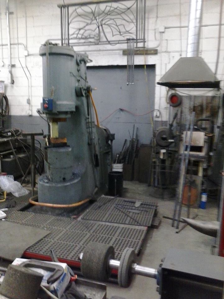

    And I got to use this monster at the blacksmith shop for the first time!

    Are you going to continue to beat on those doors or start on a new set with what you learned? I would suggest you try that shape with a step die on a bead roller.
    That power hammer is impressive.

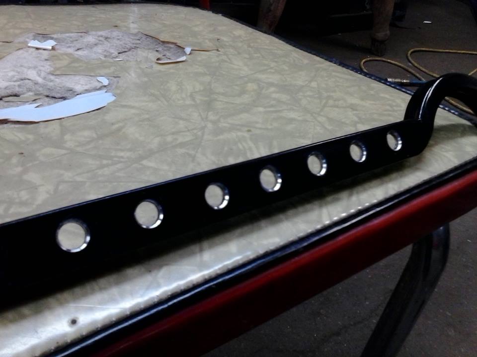

    Speaking of junk, reproduction parts are terrible. The radiator shell and radiator are ****. All in all I think I have things closer to where they need to be and closer to being square-ish. I salvaged the failed drilled out stainless hood supports!!
    The failed hood supports became the drilled out radiator mount. I cut it up a bunch of times and made it follow the top of the shell.
    I welded up all the cuts and ground it smooth. The pieces I drilled holes in are stainless steel. I plan to paint the whole thing black, then semi polish the inside of the holes. Hopefully it's not too street rod.
    It's a nice and tight fit and pretty square for a bunch of new reproduction garbage.

    I gave the radiator mount a quick prime and paint, then use a step bit to clean out the paint an put an edge on the edge.
