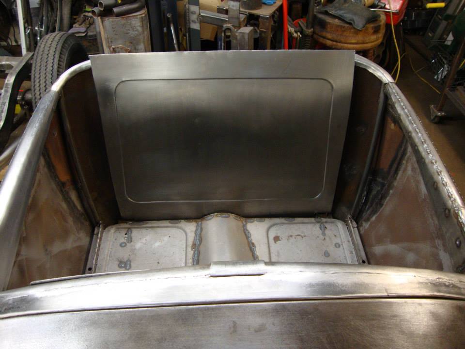

    The bead roller works now. Pretty awesome. We had all the heavy steel laying around the shop and it took about two hours to do. I need to upgrade hardware and it should be good. I'd like to make some sort of table and fence for it also.
    The back yard of the shop is almost dry enough to sand blast so I can finish the inside of the tub. Once again, cleaning parts from the beginning would have saved a lot of headache.

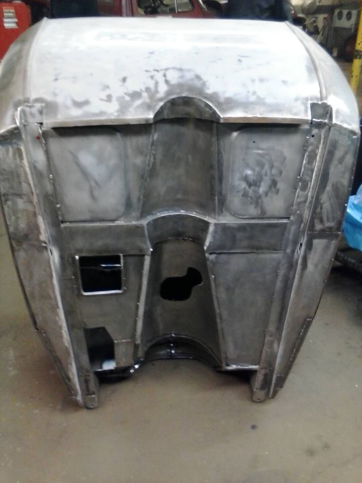

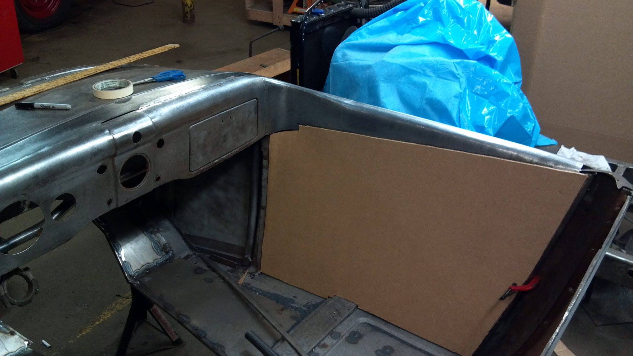

    Some more work on the dash blend.

  12. Beau
    Joined: Jul 2, 2009
    Posts: 1,884
    Beau
    A couple more

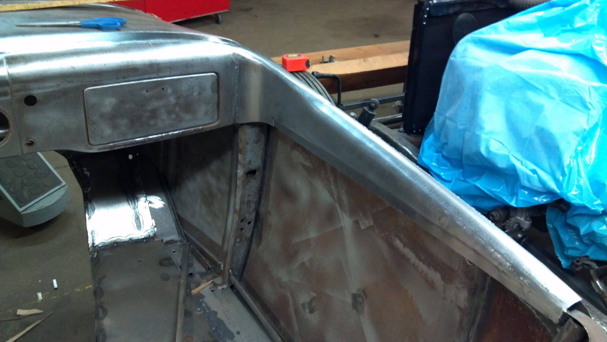

    Working my way around. I got a tube rolled to add a peak and a curve to the rear panel. I tried making a piece for the corner but need to start over with a new pattern. The bike shop is busy again. Time is gettin thin.

    I gotta redo both corners. The pattern I made didn't work once I tried to shape it. I should have a better idea the next round. The damn snow is melting and it's not done.
    I have no idea how some people build things so damn fast. I dedicate at least and hour or two a night and still can't do it. I have been real selfish this past two years gathering funds and time for this build. It almost feels like a job I pay a daily fee for. Hopefully it will pay off in the end.

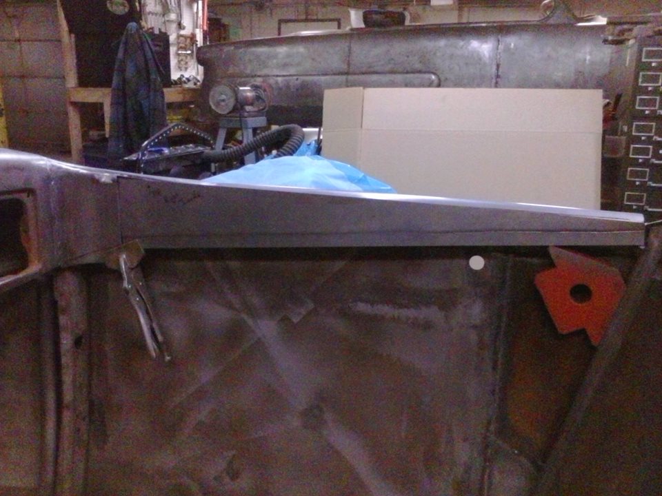

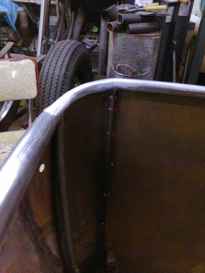

    I got a call from Dan this morning with an offer to help finish off the corners. I decided to take a shot at a new piece this evening and tried a different method. This part is going to be covered by upholstery so it will only be seen here. :)
    Not perfect and the shadows make it look worse but it's nice and solid now. I'm gonna try and blast the inside out this weekend.

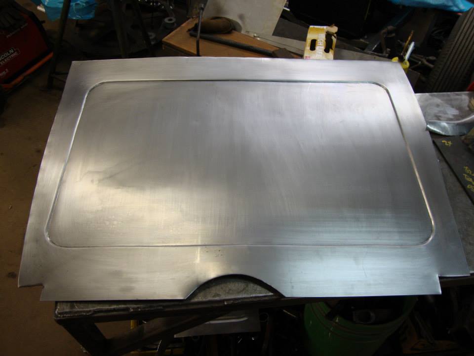

    I needed a break from grinding welds and making noise. Tonight I made a rough pattern (C.A.D.) and centered up a section to test the bead roller out on. It's 16 ga. and it took my club mate Noah's power house arms and my lady Alisha's light touch to help me guide it through straight and flat. I have bead rolled less than a dozen times, and this one finally came out OK. It'll be covered up, but it was good practice.

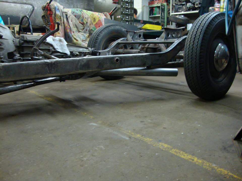

    I have had a few people concerned with the exhaust being close to the Master Cylinder. I wasn't real worried and had planned to wrap it anyway to avoid heat inside the car. I figure I can put some shields in where they were needed. It seems like an odd concern to me consider some people have them in the engine bay with less air flow.
    What are your thoughts?
  27. OFT
    Joined: Jun 1, 2005
    Posts: 579
    OFT
    In early 80's had finished model A roadster build (full fender) with 283" Chevy and auto. Exhaust pipe was almost under the master cyl under floor board. On gas stop #2 on I-80 from Lincoln NE to Colo the brake pedal went to floor.
    Cool-wet day (rained 300 miles) and found that I needed to top off the master cyl at each gas stop to prevent complete brake loss.
    After getting home, made up a heat shield and no more loss of fluid from exhaust heat. Not real hot on the heat wrap stuff. Heat wrap on the headers of my 29 AA flake and brake off easily.
    I would suggest adding heat shield to it.
    Earl
  28. Beau

    Thanks Earl. Some shields will be made. Someone else told me to avoid the wrap.
    I picked up another flex joint and a hole saw and got to work on the right side exhaust. It's a real tight squeeze between the starter and engine mount.

  29. sko_ford
    Joined: Sep 27, 2002
    Posts: 3,010
    sko_ford
    I was going to wrap the headers on my modified but my father in law told me they would rust out very quickly & I would not notice it because of the wrap
  30. patmanta
    Joined: May 10, 2011
    Posts: 3,882
    patmanta
    from Woburn, MA
    X2 on the wrap being a potential rust catalyst. Shields are a much better alternative IMO.
