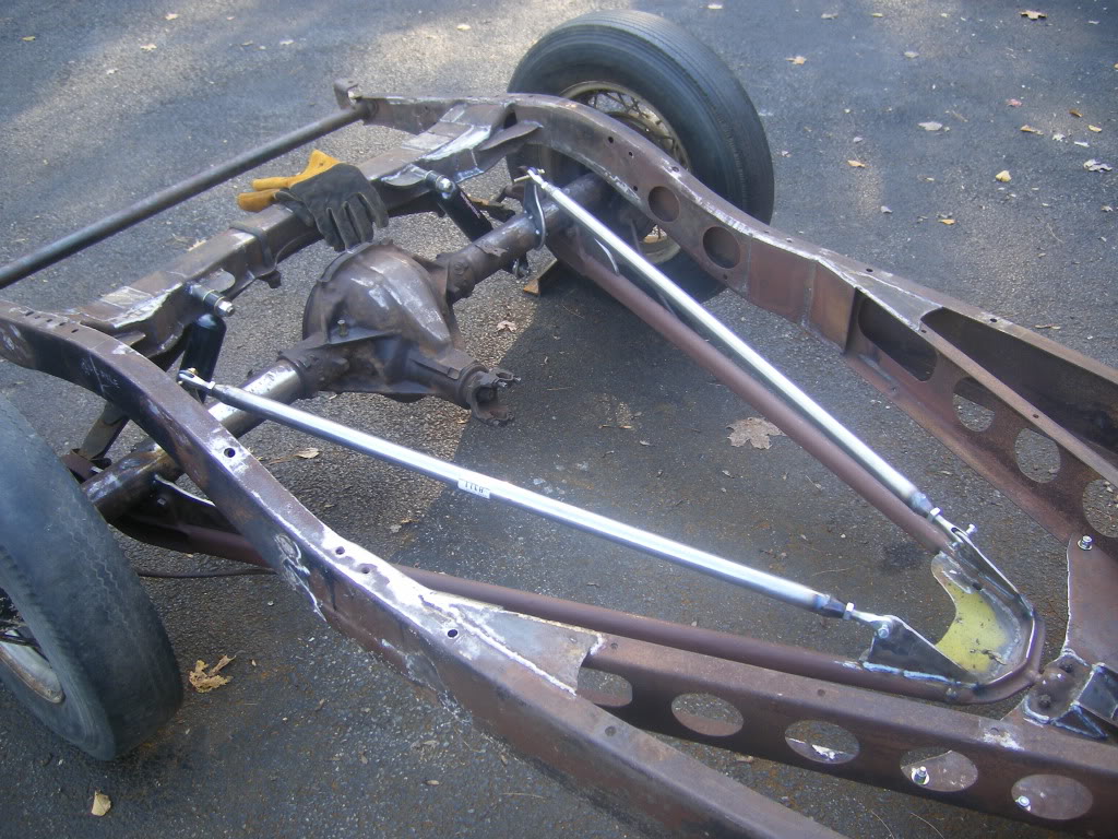

    I think I have found what I want to use for the rear suspension. After hours of searching this site and others, I found a combo that I think looks good.
    Information on using 1935 or 1936 rear bones modified to be a wishbone/ladder bar set up. These threads had info and pictures that help.
    Voodoo Twin's rear set-up is pictured below.
    http://www.jalopyjournal.com/forum/showthread.php?t=663767&highlight=split+rear+bones
    http://www.jalopyjournal.com/forum/showthread.php?t=673848&highlight=rear+bones
    http://www.jalopyjournal.com/forum/showthread.php?t=589044&highlight=1940+bones&page=2
    http://www.jalopyjournal.com/forum/showthread.php?t=117334
    And a member, Pinewood sells these nice little brackets to make hanging them easier.
    http://www.jalopyjournal.com/forum/showthread.php?t=641547
    Other axle info, Front-
    http://www.rodandcustommagazine.com/techarticles/0810rc_old_ford_wishbones/viewall.html
    http://www.droppedaxles.com/FORD_AXLES.html
