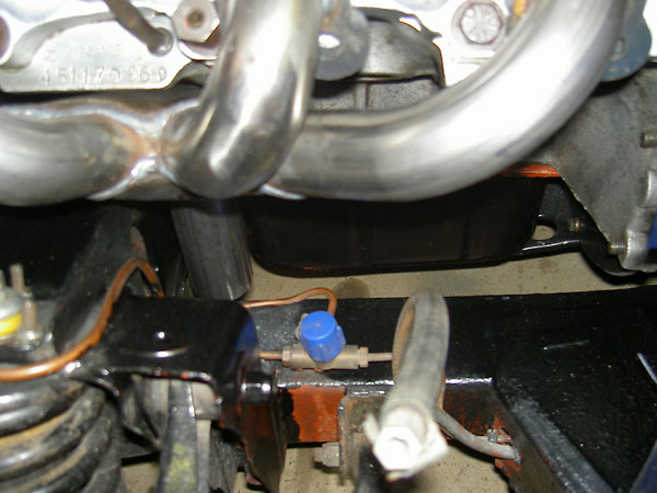

    My project is very cramped, and there aim much wikle room. I need to build something like this
    Because I have such a tight engine bay, and I got to modify everything, and still has to keep within the tight bounderys of the Danish regulations. The SD1 cast iron double rear dump manifold is good, but too wide for my use[emoji12]
    But I most confess that I like your build, and I can only applaud you use of engine, but a Rover is all Alu V8 2.0 to the beta version you got [emoji12][emoji41]

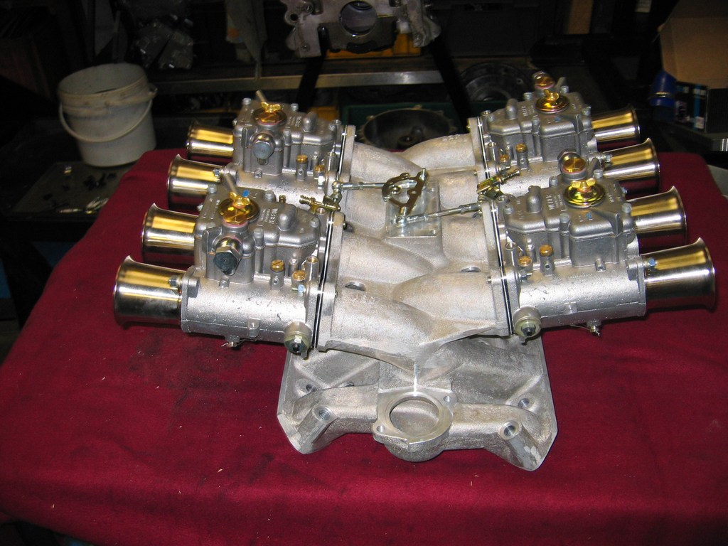

    But I love the intake you got, and I found a weber intake for 2 triple webers, and a intake with 4 double webers, that rock my boat. And one like yours, but there can't be many around.

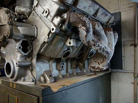

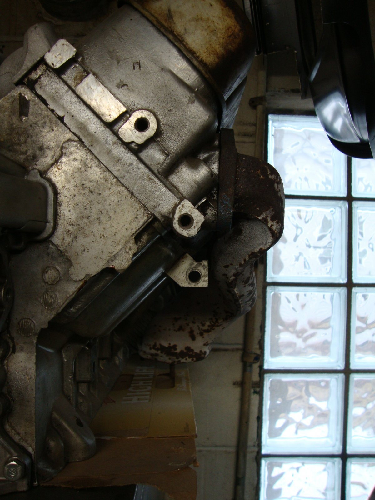

    The headers I have are 25" outside to outside and are symmetrical on each side.
    The cast Land Rover headers are 26" wide but are not symmetrical. The right side header stick out a tad bit more than the left and the flange is up a bit higher. DSC01721.JPG DSC01719.JPG 215.jpg DSC01720.JPG
    Edit- Have you considered running the outlets out the front side of the engine? And old fella I know has a turbo set up on a Olds 215 and he aimed the stock Olds manifolds forward and connected them. Worked real nice.
    I also do not have much room. With the clutch, steering and wishbone I'm just barely clearing it all. I want to run hood sides so it's a tight fit.
    I have three other engines and a pile of parts. Late on I will build a stroker using a Rover block. I just need to wait for more of them get sold for parts. I'd love to see those Weber manifolds too!!!!

    I go and measure my engine bay, next time I'm at the shop. I should look ind to those LR headers.
    I reckon that I have a very small amount of space under those exhaust manifold and down to my very large front crossmember.
    I got a framdless car, with IFS like between a 1940 Chevy and a tri-five Chevy. And I can't cut the fenders out and run fenderwell headers.
    I will look in to the possibility of running two left side manifolds on my car.

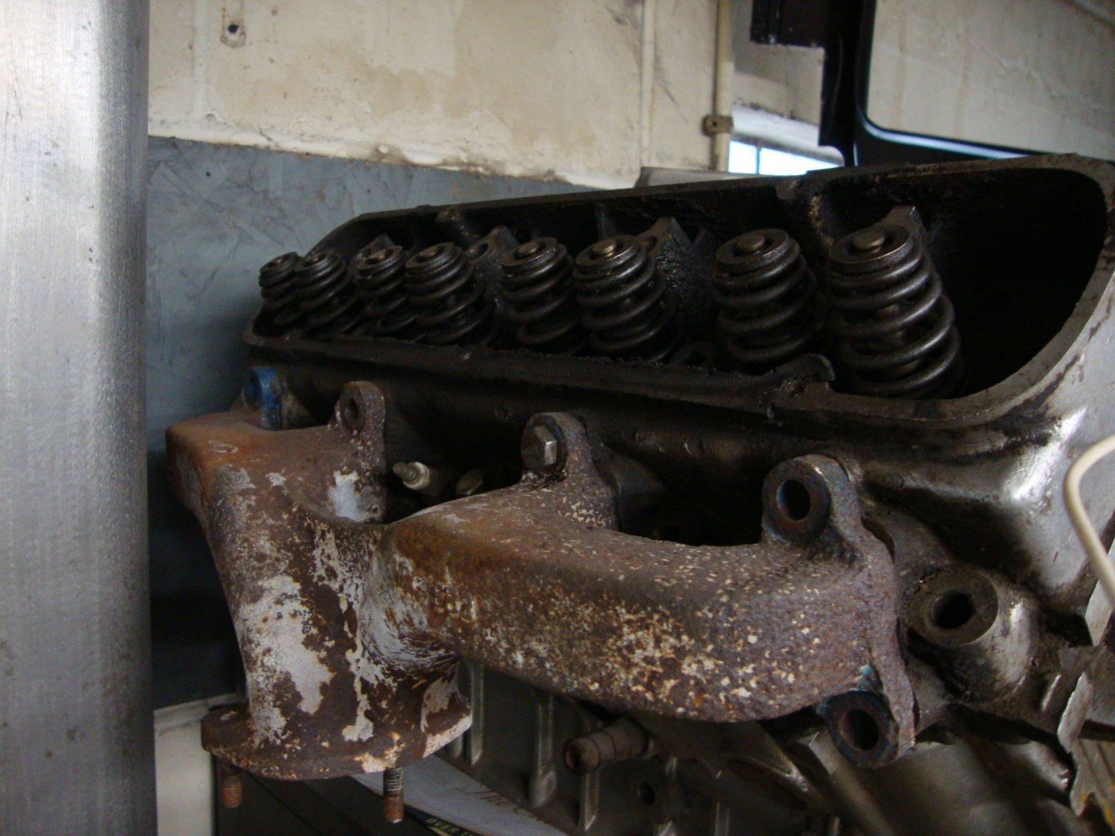

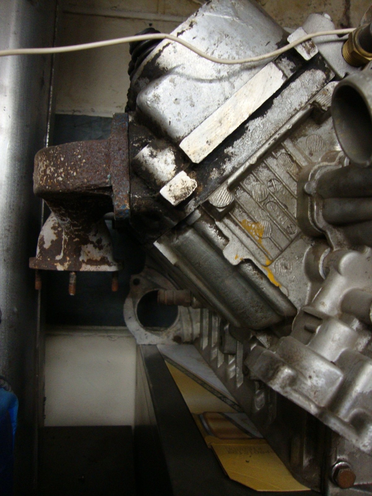

    The pics I posted with the cast iron exhaust manifolds are a spare block I use for mock up. Just to show you what the Rover manifolds look like. The headers with the flex joints are the ones I'm running.
    The exhaust manifolds will swap to each side. Buick, Olds and Rover all shared the same exhaust manifold bolt pattern too. So they can all be used. The Buick and Rover heads look more like a Nailhead though. The intake manifolds are also interchangeable.
    Not sure how your set up is, but the front side of the oil pan offers a bit of clearance if you had them exit out the front. The pics of the engine bay look about like mine. So room!

    That 2-2 intake you posted is an Offy intake that is still being produced. The rest of those are pretty rare.
