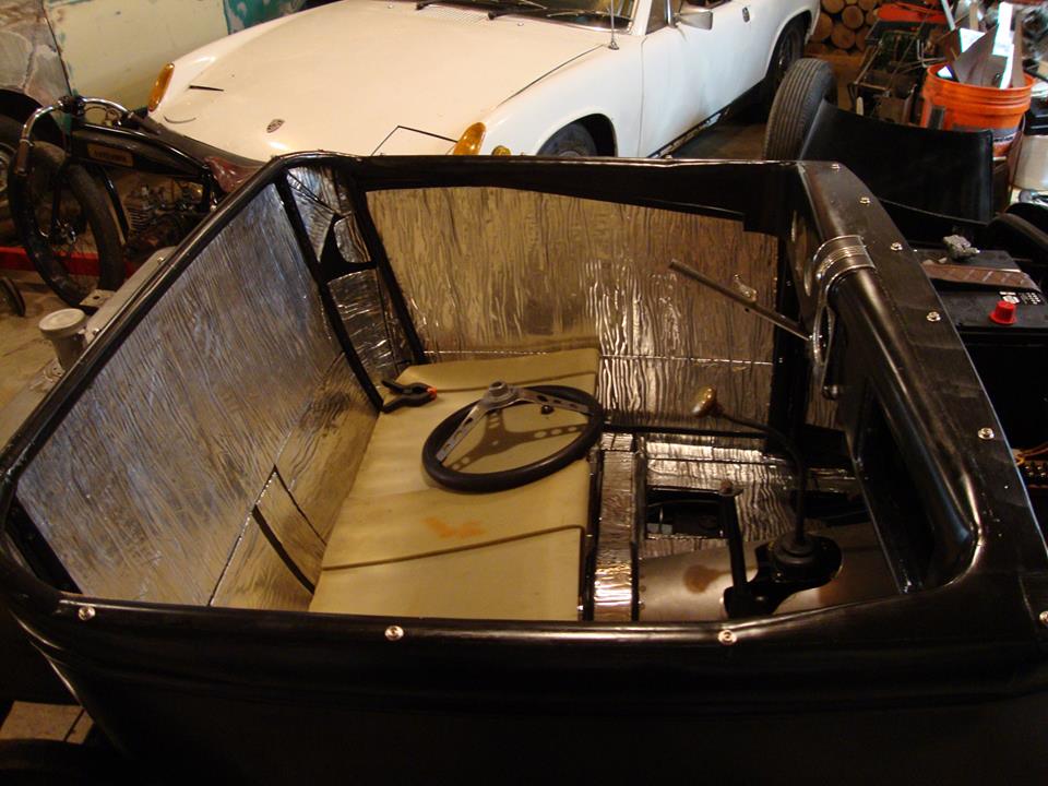

    In the bicycle world we call them riv-nuts, and they are used to fix water bottle cage mounts. The rest of the world calls them nut-serts. Either way, I have a tool and they are really handy little things for mounting the brake line/fuel line/wires. While I was doing that my lady was installing the shiny sticky stuff to ease the heat and noise (in a roadster :) ).

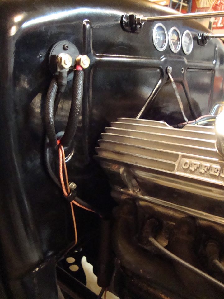

    I installed some mismatched SW gauges in the firewall, and plan to retain stock 35/36 dash gauges. Trying to figure out my wiring and routing now. 11722507_10101349227834040_7515488548235990234_o.jpg

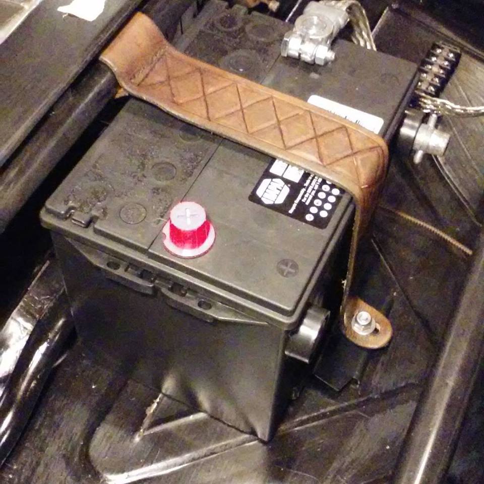

    http://www.jbi.bike/web/advanced_search_result.php?keywords=riv+nut
    I was able to get the brake bled and after a few extra turns on a couple fitting it seems to be leak free. Nice and solid! Batteries now days are friggin expensive! I found the smallest one I could with side posts and the right amount of cranking amps. All this little **** adds up to big dollars....damn. This is the stuff that ****s to buy.
    volvobrynk and daddio211 like this.
    Playing with some of the tools in the leather shop. This is more for looks and practice and it turned out looking more like an old belt. It won't really be seen after this, but it was fun either way.

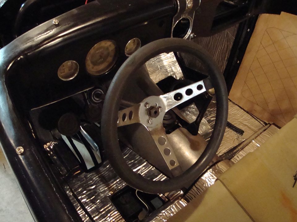

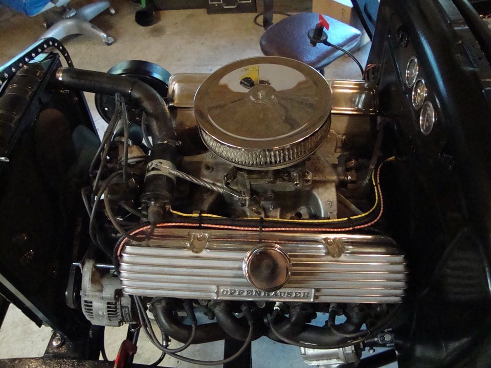

    ****on screws for a snap on cover are now in place. I got a steering wheel from a local guy and welded on a taper/threads so the steering is done. The wiring is about 50% complete. I need to figure out some relay stuff and run wires for lights and that should be good to go. The next big thing is getting the gas tank done and sealing it up. delete4.jpg delete1.jpg delete2.jpg delete3.jpg
