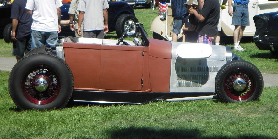

    This one is mine, a 28/29 on Duce rails, small late model Ford 4 cylinder. Yours looks more line a 30/31. Remember you need to be able to fit in it. I lengthen my doors an inch plus made them fit flush and also added 6 inches to the rear quarter panels.
