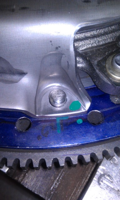

    Some things I have to leave to the experts. Monk, from The Flywheels Drag Racing Club did some more work for me. In or to adapt the V6 Camaro T5, I had to have the 215 flywheel re-drilled. I'm using a V6 S-10 pressure plate. This way, if I find a V8 T5 I only need to change out the clutch disk. He also put new reference dowels in. The pedals and clutch will be coming soon!

    Nice looking clutch! I recall mods that myself and my bro in law did to get a T5 behind a 283. We drilled out the rivets, removed the entire central spring ***embly contraption (on the disc) and then welded the main splined hub back onto the disc. We were then able to install the disc "flipped over" from it's normal orientation, getting the clearance we needed. Sounds screwed up, doesn't it? Well, it works great to this day. I told my bro in law, you don't need those springs in the disc - they are for grandmas......

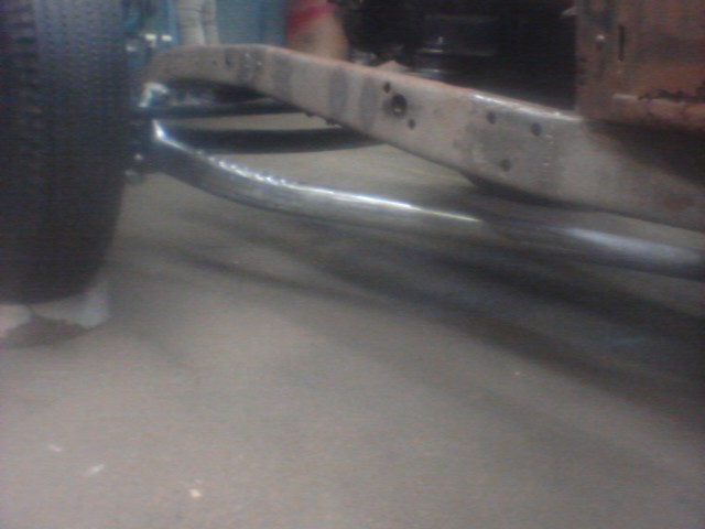

    I spent a lot of time in the shop this weekend. I made the front wishbone bone mount on the F1 cross member. Then I started to clean up a hacked set of 37-41 bones. They still need lots of work. Someone had fun with a cut off wheel. They are a bit more heavy duty than the Model A bones. I figure with the added length, a stronger set would be better.
    The beginning. I added almost 3/16" of material on the on in the back. Weld, grind smooth.
    I did some goofy stuff with the bones. I flipped them, then cut the nine times and arched them the other way. The need one more cut up front and they should be good. The photo is ****. I'll post better pics when I get it closer to done.You can see I need to drop the steering arms down a bit.
