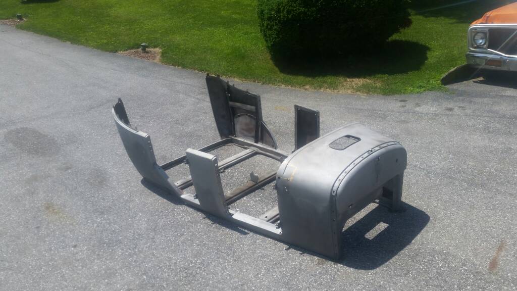

  6. There is whats left T coupe along side the road between home and work. I will get some photos tomorrow night.

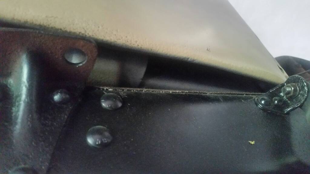

  8. orangeamcs
    Joined: Jun 23, 2007
    Posts: 609
    orangeamcs
    Take some pictures of the area you need pictures of. I have a 27 touring I'll take whatever pictures you want. Your cowl looks ro be a 26 but they are very similar
    patmanta likes this.
  9. orangeamcs
    Posts: 609
    orangeamcs
    Maybe you can use these pics

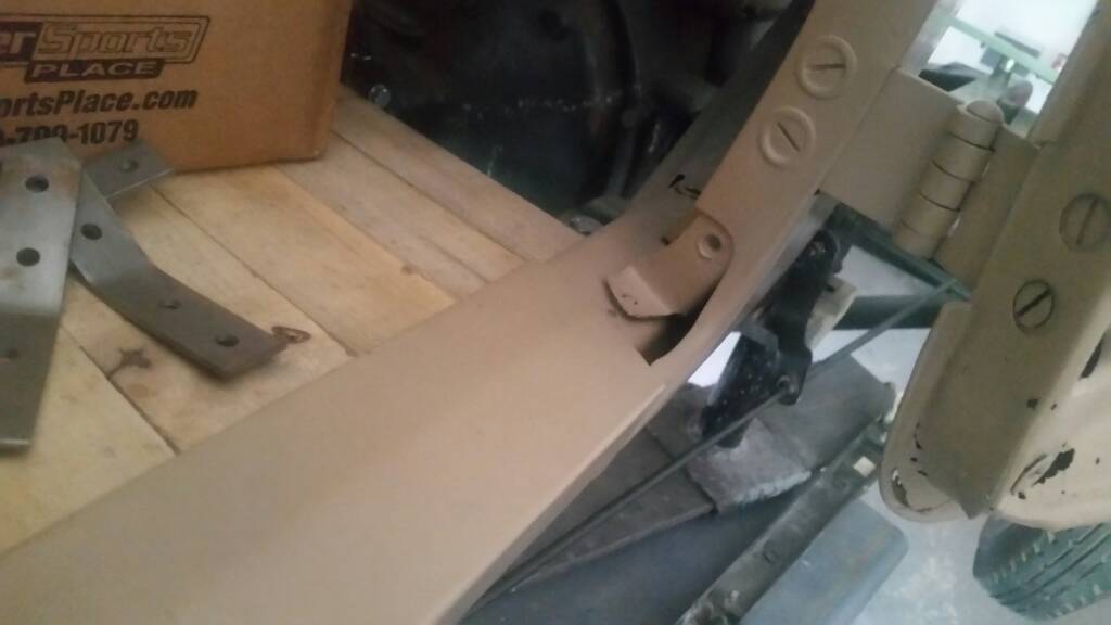

  10. orangeamcs
    Posts: 609
    orangeamcs
    I'll get more or close ups of whatever you want tomorrow. Parts of my jambs are repop also

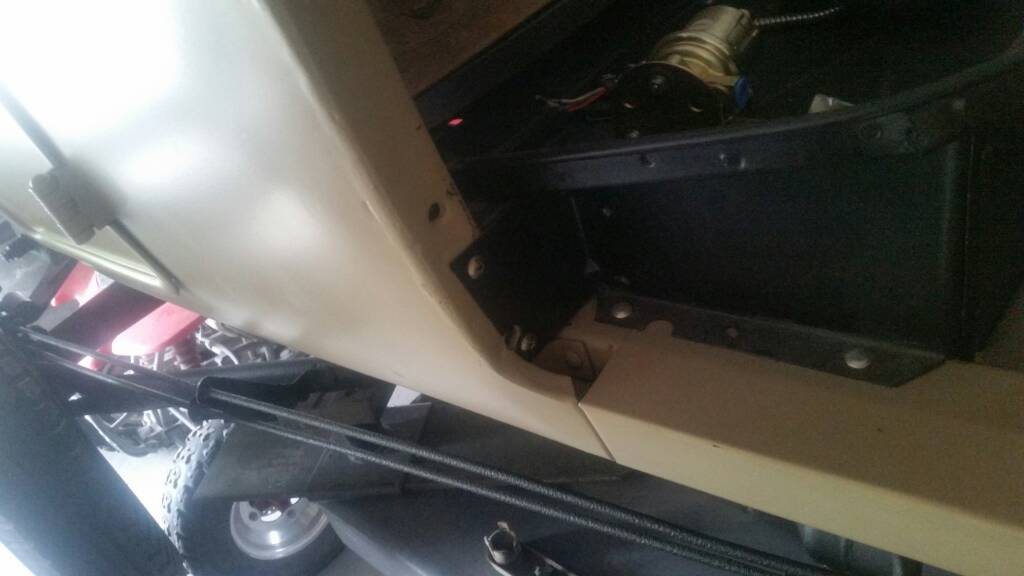

  11. orangeamcs
    Posts: 609
    orangeamcs
    Another angle I had in my phone
  12. Someone just dragged it out of the woods, good for yard art but not much more.
  13. patmanta
    Joined: May 10, 2011
    Posts: 3,882
    patmanta
    from Woburn, MA
    Really? You've seen it? I'll PM you the link. There's some straight doors and other sheetmetal that's better than mine.
    Thanks! Can you snag a pic of the bottom 3" up where the sheetmetal wraps around the subframe up to the door jamb?
    What are the differences between 26 and 27 on the cowls? This one I'm using is probably for mockup. I have another one that's got less difficult repairs to be done to the top but rotten bottoms.
  14. orangeamcs
    Posts: 609
    orangeamcs
    26 has the bump right above the upper hinge.

  16. orangeamcs
    Posts: 609
    orangeamcs
    Got it to work
    patmanta and volvobrynk like this.
  17. patmanta
    Posts: 3,882
    patmanta
    from Woburn, MA
    Yeah, see, that patch panel seems flatter around the edge than the cowl panel. I'm thinking of running a strip down mine with my planishing hammer to put a low crown into it.

  20. bct
    Joined: Apr 4, 2005
    Posts: 3,199
    bct
    If you are talking about the B pillar the sheet metal doesn't really touch the pillar other than the top .the bottom rolls around the sub frame edge. The stock one is curved but not necessary. The sheetmetal has the door shape and it is maintained by the flange being tacked to the B pillar.
  21. bct
    Joined: Apr 4, 2005
    Posts: 3,199
    bct
    Right where mine is cut the b pillar rolls into the subframe but the sheet metal keeps going to the bottom attachment flange. Hope this helps

  24. patmanta
    Posts: 3,882
    patmanta
    from Woburn, MA
    @bct the door jambs are what's worrying me. I'm afraid mine will look like flat lego bricks against a curved surface.
