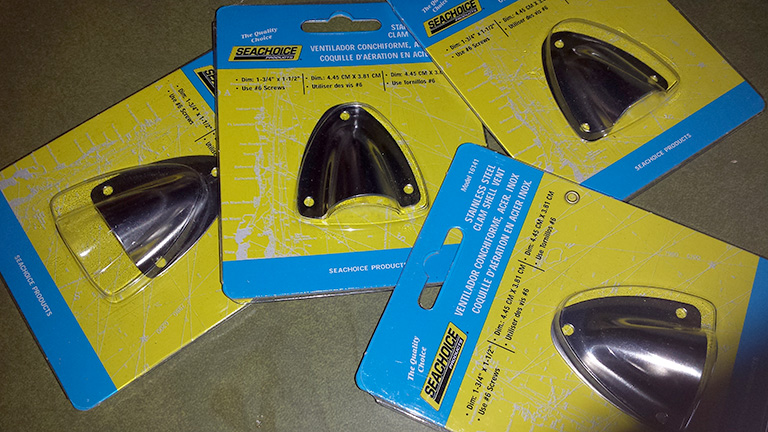

    Sidebar: I picked up some nautical vents. They're 1-3/4" x 1-1/2" stainless and I think they might be good for brake vents:

    I bet them'r more than $2 each ;)

  7. I bet them'r more than $2 each ;)
    Good point !!

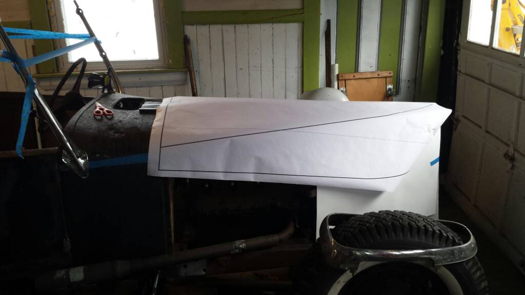

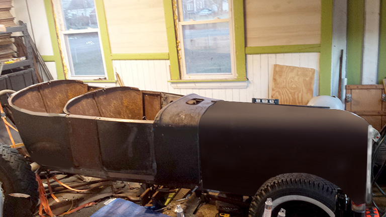

    I have the radiator sitting lower now, so the hood angle is more appropriate to a track style nose. It's lower than the cowl in the picture you used but just ever so barely. Now it's got a good angle to it.
    I'm planning to go in bare aluminum or potentially stainless with no hood sides too BTW.

    I didn't get very far with the paper because my kitchen flooded.

    I like the shorter one just because it puts the nose behind the front of the tires. Now if you extended the frame and used a Buick straight eight………..:rolleyes:
    37 Millrat and volvobrynk like this.

    Actually, dropping a big inline in there just requires moving the body back. This started out with a Ford 300 Big Six in the plan:
    The cowl is sitting back about 10" here, which would just push the back of the tub closer to the back of the rear tires instead of terminating ON the rear crossmember like it does now (read: easier). I could have gotten away without altering the frame at all going that route really.
    BACK TO THE ACTION: I didn't get a lot of work that warrants photo-do***entation done this weekend, but I did get the roll bar bolted down firmly as well as the major step of centering and bolting the subframe to the body. I managed to get the firewall cut off just right and popped into place. It actually looks like I won't need to do a ton of modification to it.

    I put those stainless vents on the brakes to see how they worked out. They're a little small for where I've got them but I'm not unhappy with them. They didn't want to fit up top easily.

  16. You can buy those vents in several sizes - some of them quite large. Marine chandlers stock them.

    Yeah, I've seen them, the big hoss vents run around $20-30 and I might try one on the hood to shroud/cowl the air cleaners when they poke through the hood.
    I started with the small ones because I figured they'd have the best chance of fitting up top unmodified. I may play with making spacers for them to get them to sit up there better.

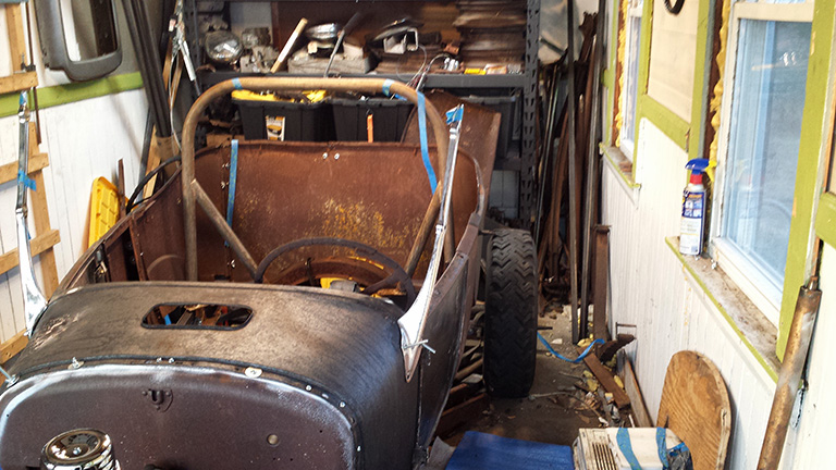

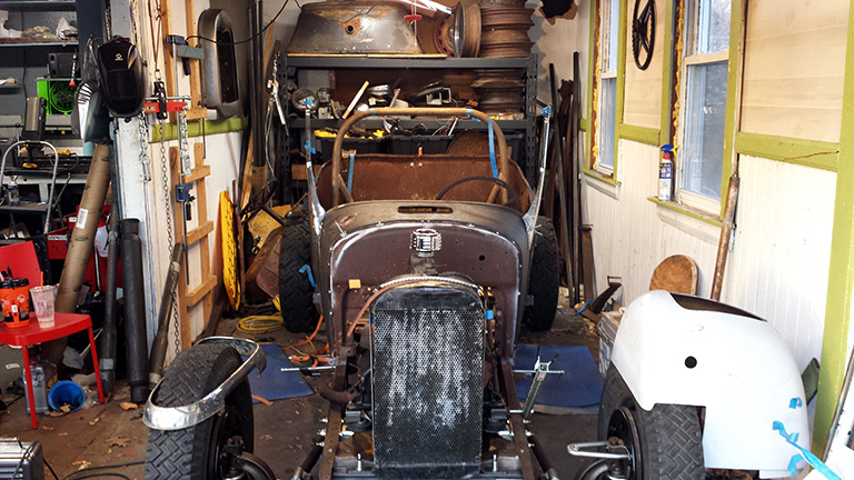

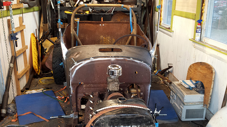

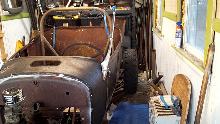

    Well, I'd planned to play with the hood and nose structure this weekend, but my local Metal Supermarkets nixed their weekend hours, so, that didn't happen.
    WHICH forced me to work on the body instead, which needed to be done for me to get an accurate framing made for the hood regardless. The firewall gave me A LOT more trouble than I'd expected since this firewall is not from THIS cowl. That 3" machine screw sticking out there was necessary to work it up into position since I was only born with 2 hands/arms. I have discovered that fender washers are great to use on the old welting rivet holes when getting it into position since there's slots in the cowl skin.
    I also pulled the old seat back out entirely, in an effort to get the body straight. This effort ate most of my time this weekend.
    I did a little hammer and dolly work on the bad spots, but this didn't do a whole lot and quickly started getting into a risky spot for more harm than good. So I got the rails level and put a hole through the structure to bolt them up tight in place. This did not fix things but started me down the right path.
    It occurred to me that I needed another inch of support in this area so I can cut out the rest of the old seat frame and also to control flop in the body. Lots of gnarly cut-off wheel and burnt hair smell later, I got the new tube in snug.
    At this point, I am starting to flush out and chase down issues with the body. As I left things, I'd clamped angle iron in again, this time flushing the panels alignment along the lateral lines. The p***enger side still looks good, but the driver side still has issues. I think some of it stems from the door sitting about 1/8" out of flush with the cowl, but there is certainly still something going on in the center panel and/or the rear quarter.
    And BOTH doors have somewhere between 1/8" and 1/4" too much gap from their striker plates and jambs. So either the cowl moved on me when I put the firewall on, or I tacked the body in and aligned things wrong. Probably a little of both but, regardless, I'm thinking I'll have to sever the tacks and nudge the body up regardless.
    20160228_173123.jpg 20160228_173146.jpg 20160228_173224.jpg 20160228_173247.jpg

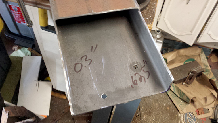

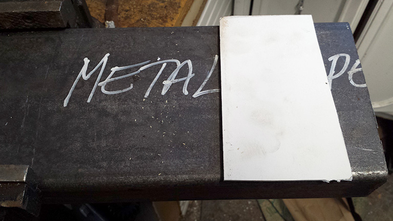

    Didn't get the aluminum angle I needed again but it's on order. I did get some 4 inch flat to make boxing plates though. gonna use the channel stuff on another frame.
    Most importantly, I found a length of 6 x 2 , .125 tubing to make my steering box mount on. If I nail it I may do a tech week on it since I didn't find one.
    Trying to figure the math to get it 90 degrees to the axle is a *****.

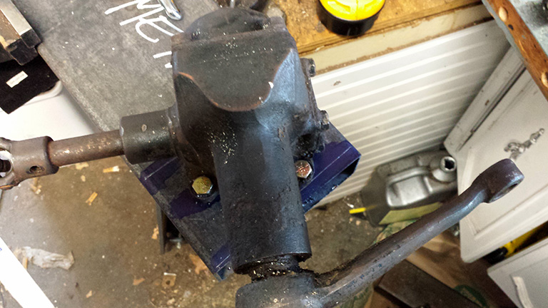

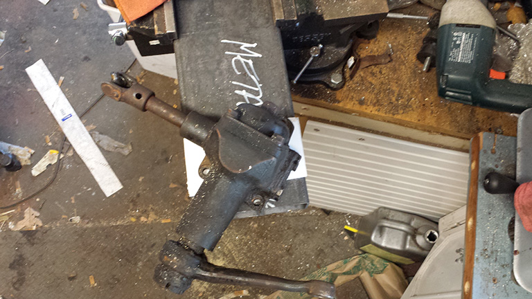

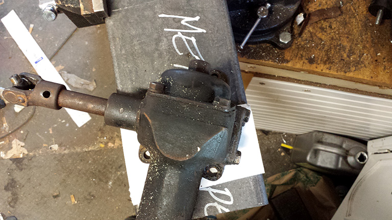

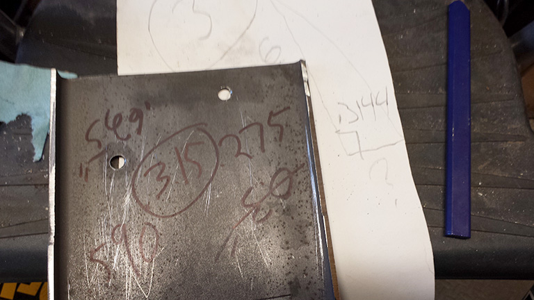

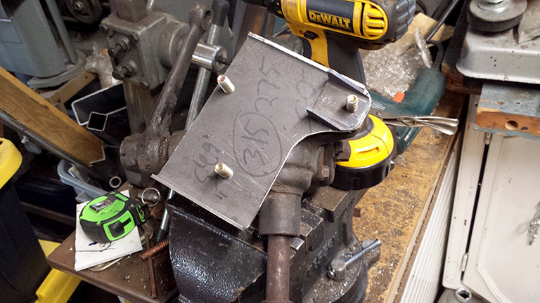

    Ok, here goes: I made a mounting bracket for my steering box this weekend. As stated previously, the idea was to correct the mounting surface to get dead center to 90° vs the axle. I was not able to either find or calculate a consistent number for this. The calculations I did based on frame plans came up with two different numbers, 2.9 into infinity degrees and 3.1551 and beyond degrees.... I CALLED IT 3° and said to hell with it.
    SO that led me to figuring out what the difference in height I needed over 6" would be to get that. I came up with .3144.
    I made a template for the frame rail and clamped it all down. I marked off the holes then drilled and tapped the two bottom holes so I didn't drop nuts all day.
    I don't have any real precision equipment, so I ****m'd and scratched it out as best I could and went at VERY CAREFULLY with a cutoff wheel and portaband.
    20160305_113026.jpg 20160305_113135.jpg 20160305_113230.jpg 20160305_113236.jpg 20160305_120610.jpg 20160305_130901.jpg 20160305_132142.jpg 20160305_132954.jpg 20160305_140252.jpg
    Once I got that done, I did the top hole and shaped the piece. I managed to get the difference in height between the two sides to .315 using my stationary sander and decided to quit while I was ahead.
