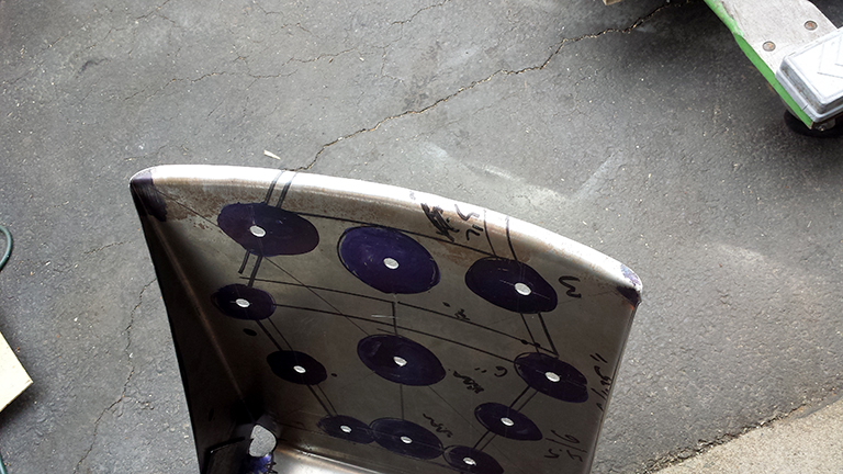

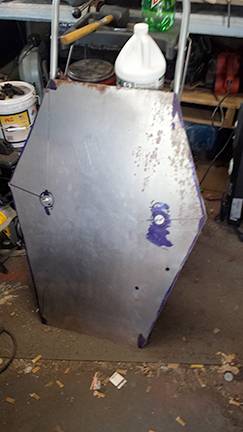

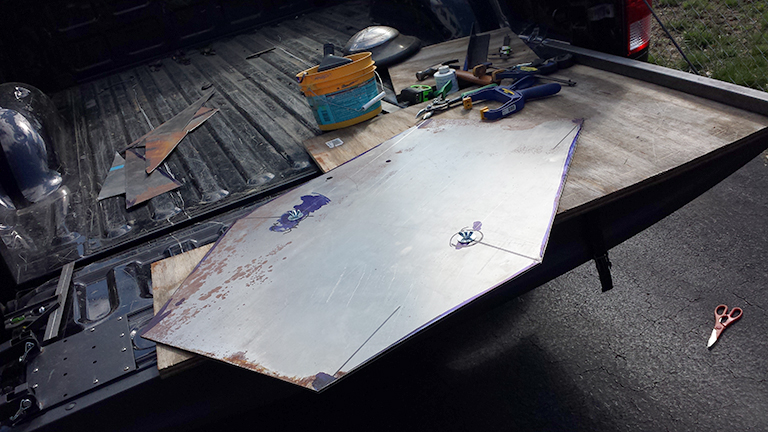

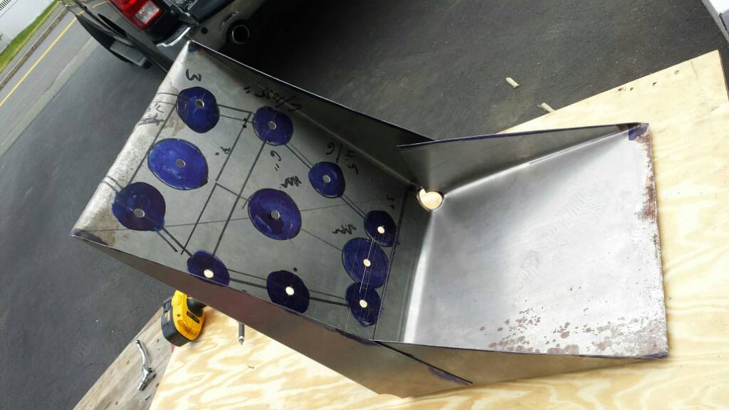

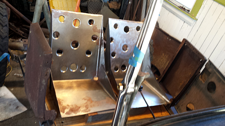

    Decided to leave work early and enjoy the weather yesterday. So I ended up in the shop with the doors open and decided to work on my rear panels, which were pretty bad. The p***enger side rear quarter didn't have much in the way of hammering issues, so I didn't really touch that one. The driver side got some time on the planishing hammer though and I got it to a 'quit while you're ahead' point.

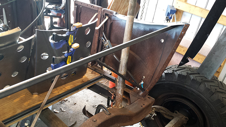

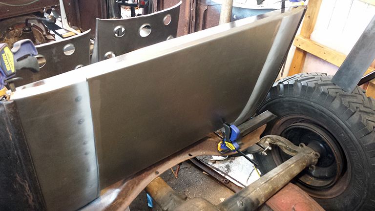

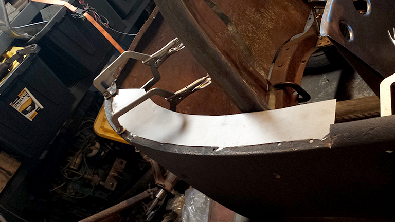

    The rear panel on the other hand, looked like crumpled tinfoil and had some issues that I think are behind some of the fitment issues. I worked the bulk of the panel back into shape but the REALLY BAD area took some mallet and shot bag time. When I tried working it back though, I ended up with a concave dish, so I'm going to need to work it some more or cut it out and make a patch.
    My planishing hammer started giving out on me though. I may have a rotted hose that finally split. I've found that I can't really do a lot of hammer/dolly stuff on this car because my joints bother me for two days afterwards. Fortunately the power hammer and mallet/bag stuff does not, so I'm good to go.

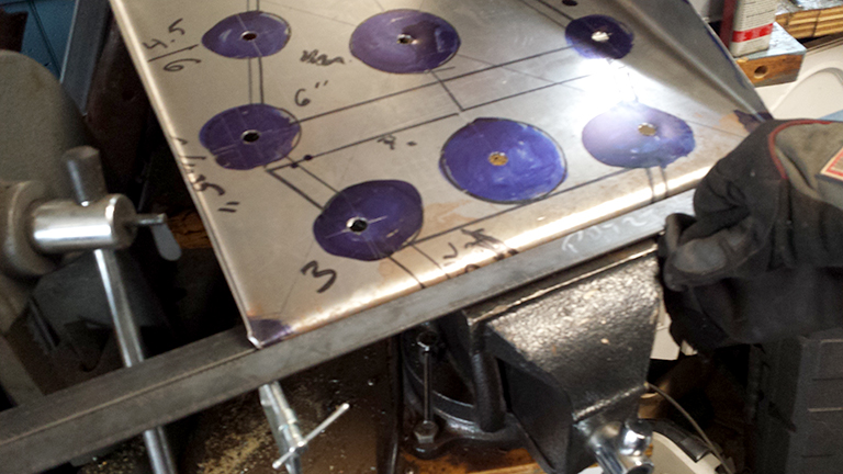

    Got a new bottle on the welder and went to work on the frame this weekend. I probably should have been a little more aggressive with my chamfering on the plates and the frame, but the tacks hold up and looked fine when I ground them down.

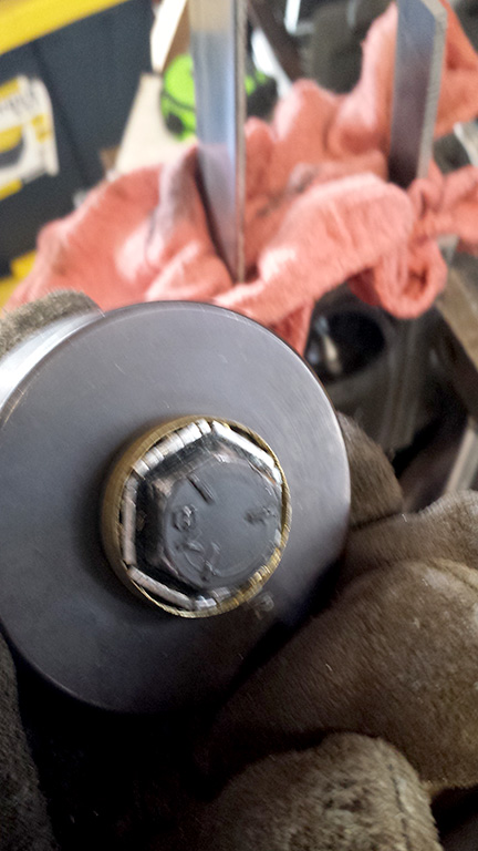

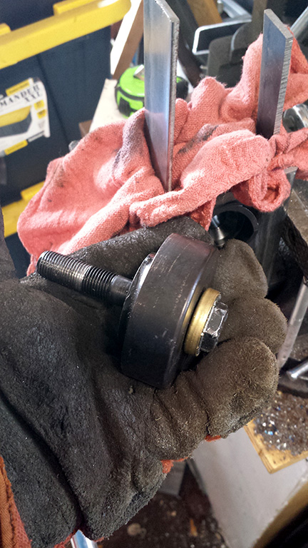

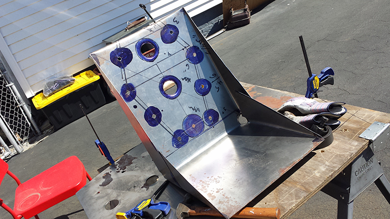

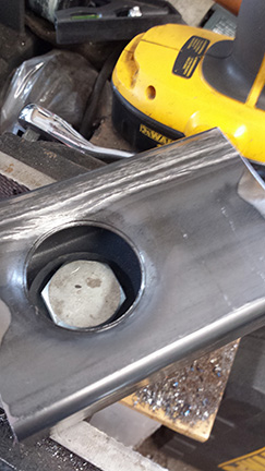

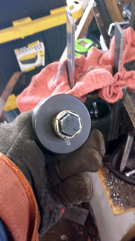

    Did a little work on my new mounts too. I used my 1.5" dimple punch with mixed results. The hole is too small to p*** the bottom rubber isolator through and the hoop prevents the bolt and isolator from being installed together. I'm not sure yet if I'll leave them or cut on them further.
    The cutter on the die can handle 12/10 ga but the hardware it came with CAN NOT. The grade 5 bolt got mangled and the bearing crushed. This was a huge PITA but i was committed at that point and ended up using a ****py hardware store hole saw on the other one and just dimpling it. I cut in about a half inch on the mating surface with the idea that would give me a little better welding surface to work with, but now that I've got them on the engine and sitting on the now boxed frame, I'm probably going to revise them a little more (I'll grab more pictures tonight or tomorrow).

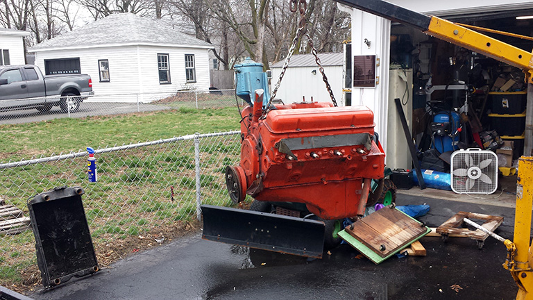

    In 2 stops, I got two 1955 Chevy 265's, an iron Powerglide, several Rochester 2 Jet carbs, generators/starters, and a bunch more related stuff. The truck was hanging low at this point.
    On the second stop, I picked up the X member from a 38 convertible and most of the internal factory boxing plates along with another set of EAB heads and a 38 radiator.
    I'm toying with using the front 38 factory plates to run to the F1 crossmember and make it into a K member. It may take a couple pie cuts but I'm liking the look of it.
    After getting home and a nap, I spent the rest of the day putting stuff away and unboxing a couple of the Humvee seats I got to see if they'll fit in my T. I hope they do because they feel pretty good even without padding.
    The mounts will need to be cut off and modified but the seats themselves might fit; they're 18" wide.
    This 265 is probably going into my next build along with that Powerglide. The other one I'm going to bring to Fitchburg if anyone is in the market for one.

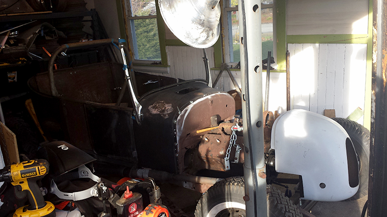

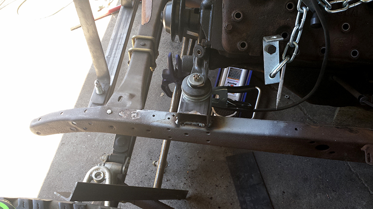

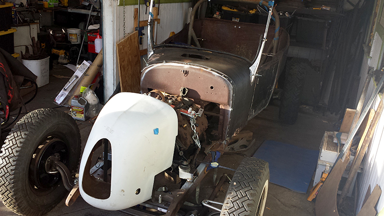

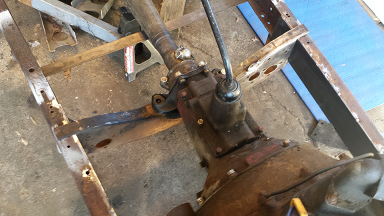

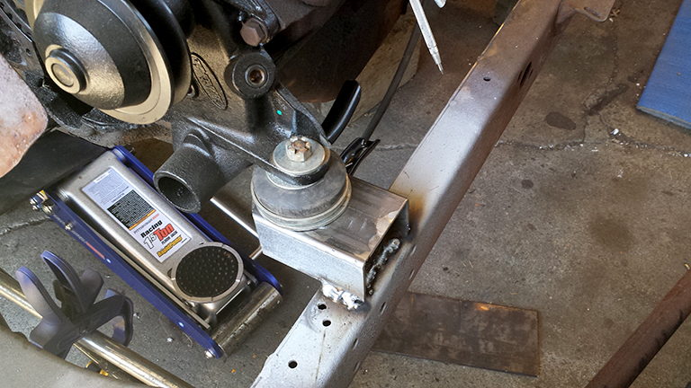

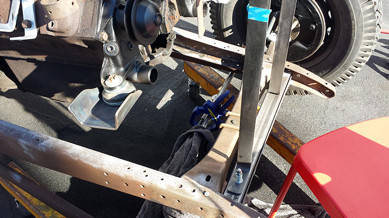

    So I finally got myself back into the shop Sunday and made more progress than I did the first 3 years of this journey I'd wager.

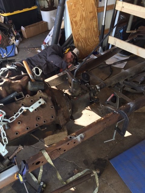

    I got my motor mounts located and heavily tacked in. I used angle, clamps, and some quarter-inch plate to jig it to center. I cut the mounts to be a quarter inch inset from the outside of the rail, so this worked out nicely.

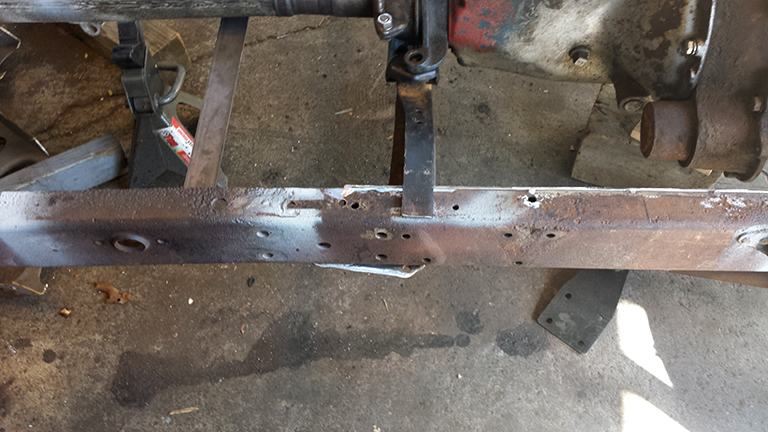

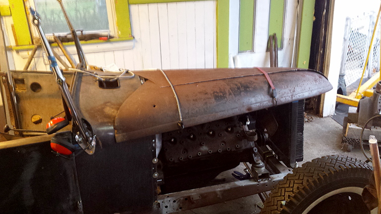

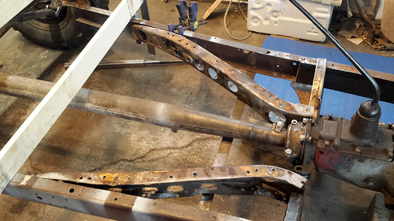

    With that done, I was able to jack the transmission up and get at the F1 Crossmember. I pie cut the gaps and bent the lower flaps in, then re cut the 4" channel in them. I found that it was a lot easier to see if I was on the money from the outside of the rail (PRO-TIP!).
    The lower tabs didn't end up being terribly consistent. I'm going to address this when I blow it apart to finish weld the bottom of the frame. I'm pretty sure it's because the pie cuts are not as aligned as they could have been but it won't affect function; the thing is centered and perpendicular to the top of the rail on both sides.
    Once I had that firmly tacked in, @BOSTONCAMARO came by for a visit. We got the strap that I had in there to hold the rails cut out and played around with those K-member pieces a bit.
    I'm going to have to put my Master Cylinder back in to really do anything with them so we put the sheet metal back on the car to see what it looks like after the panel beating I did a while back.
    20160424_181457.jpg 20160424_181506.jpg 20160424_181519.jpg 20160424_181527.jpg 20160424_181602.jpg 20160424_181618.jpg

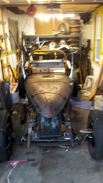

    And this is where I left off. I'm good enough on the frame to get on body work, but I should probably make a decision on the boxing. I need to either put a fish mouth plate at the end of the front boxing plates or box the length of the frame. I can't really decide which way I want to go just yet.

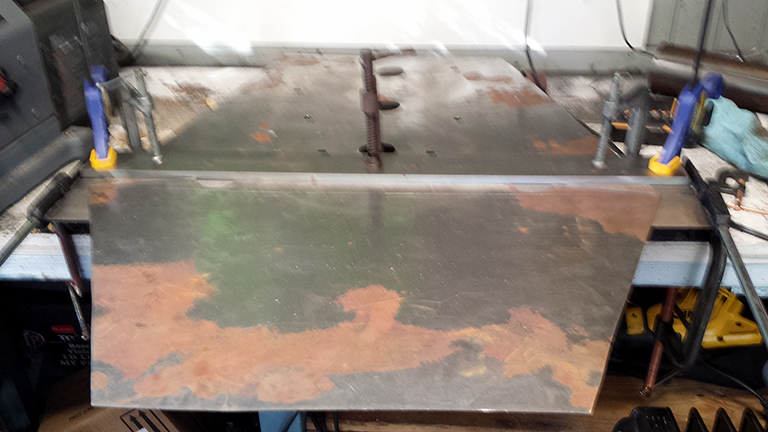

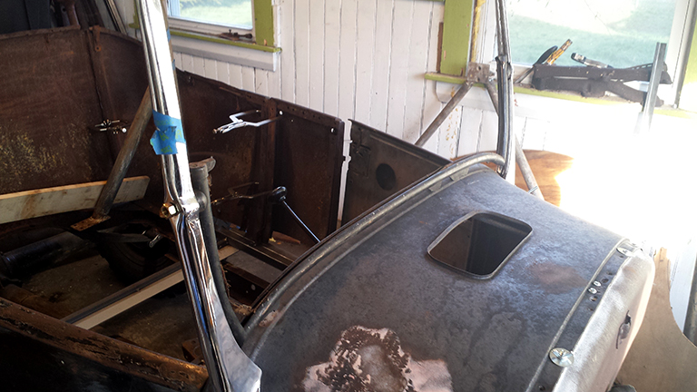

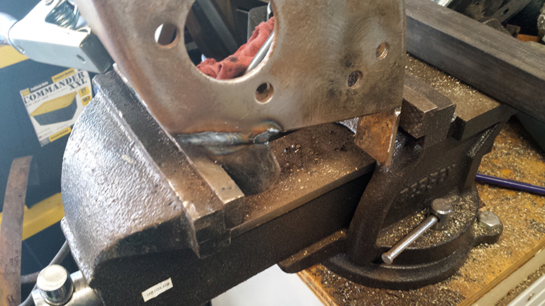

    I finally figured out what to do about mounting the cowl feet. On a stock subframe they mount at an angle and lower than the rest of the rail. I took measurements on my old subframe and the subframe on the car I just drug home and decided that if I took a piece of 1" box tube and cut one side down to 0.85" that it would fit. It did.
    I put a piece in my bench clamp and ran a cut down one side near the edge. My cutting wheels are 0.05" so I made a cut, clamped down, backed off slightly, ran the cutter through again, repeat, until my jaws were around 0.85" and then tacked / welded them.
    Once they cooled, I bumped them in with a dead-blow; fit like a glove.

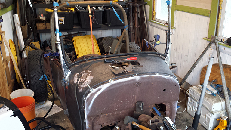

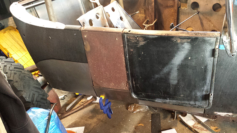

    I got more than I thought done this weekend, at least according to the list I made. I crossed a few things off, which is a lot when there's less than 25 major items.
    Pulled some body mounts off one of my T frames and did a little repair to one.
    A soak in some Evaporust and a little more work to get rivets out and I'll be in good shape. I think I'll pull another set from one of my other frames though.
    I got the cowl feets and subrail extension tacked in. I got the wonky latches out of the doors and aligned the cowl, doors, & center panels to where I'm happy with them. All tacked in now at least.
    Started on the bracketry for the roll bar. I should have cleaned the frame up before I put that awkward sob back on and saved myself some trouble but I've at least got it mocked up and drilled out. I'm probably going to have to stud the outside bolts because of how it lands on the outside of the frame rail (see them standing up there).

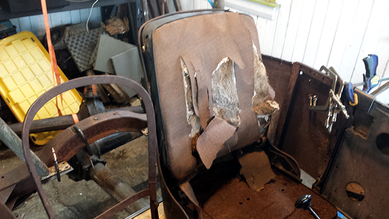

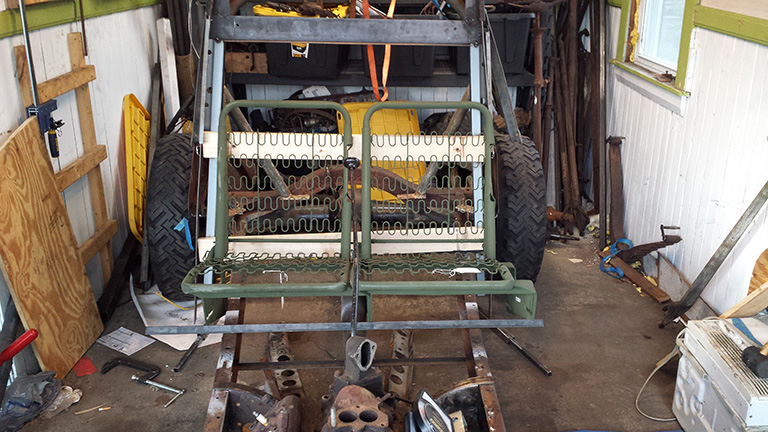

    WHen I started winding down, I pulled out some seats and tried the staggered seating idea out again. I'm not happy with it so, back to the drawing board. I tried a Humvee seat too but it was a bit of a chore to cut the frame off the bottom so I only did the one (after exploding a cutting wheel). I did not grab a picture but the bare frames are about 18" wide, which makes fitment doubtful.
    ThHis is one of my commercial truck seats (22") and an old T seat frame (sedan I think):

    I'm planning to try to MAKE some Bomber style seats with 18g Steel and maybe some conduit or 9g wire for edging. None of my other seats fit well, so, here goes, wish me luck!

    Preview of the seat project.

    I was planning on doing an epic update. But some things in my life have gotten tough and my heart's just not in it today.
    So I'll just be doing a photo dump.
    I knocked some things off the list over the past 2 weeks I took off from work. I got some good coaching and help from my neighbor, Paul too.
    I made SEATS:
    20160516_140329.jpg 20160516_152545.jpg 20160516_153728.jpg 20160516_161402.jpg 20160516_161807.jpg 20160516_180210.jpg 20160516_180625.jpg 20160516_193221.jpg 20160516_200017.jpg 20160517_152347.jpg 20160517_152709.jpg 20160517_153548.jpg 20160517_155931.jpg 20160517_160124.jpg 20160517_160415.jpg 20160517_160522.jpg 20160517_161110.jpg 20160517_161820.jpg 20160518_150450.jpg 20160518_155541.jpg 20160518_161523.jpg 20160518_164427.jpg 20160518_171025.jpg 20160518_173654.jpg 20160518_183727.jpg
    I also learned to do your bends before you cut if you want a radius.

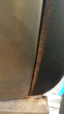

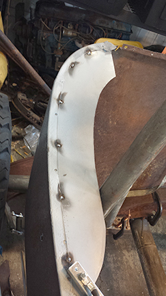

    After Paul & i spent an hour or two on the original back panel, I decided it was going to be too much effort for too little return to repair it fully. So I made a new panel in 3 main pieces once we could see enough of the original shape of the panel to figure out a pattern.
    But before that happened, he gave me an idea to fix my quarter panels and make them consistent:
    20160519_183542.jpg 20160519_191759.jpg 20160519_195923.jpg 20160519_203318.jpg 20160519_203711.jpg 20160520_124342.jpg 20160520_140224.jpg

    Rear Quarter Filler Panels:
    Then I started a fire, which I put out.
    Tim_with_a_T and slv63 like this.
  28. Nice Fab work Pat.
    patmanta likes this.

    So, after many months of inactivity on this car, I finally did something.
    Saturday I drove up into the mountains of NH and picked up this 39 Hudson 112 hood from some folks I've bought from before. I didn't get lost this time and my dog also got to meet a horse, which he decided he should guard.
    I went ahead and cut'er down the middle to start actually DOING something and formulating my next move.
    Otherwise, I've just been buying parts for the flathead rebuild; oil pump, seals, valves, etc are in-hand now.
    brEad, Tim_with_a_T, Stogy and 4 others like this.
