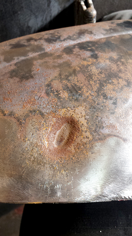

    So, I cut the hood up over the long weekend. I think I borked the nose up some, but I'm working on a fix to get the sides aligned up front just right. I'm going to have to draw a grid on both sides and use my contour gauge.
    I also bought an English Wheel after wearing myself out hammering on the first of the bullet dents. I went and got the HF unit because I could have it RIGHT NOW and had a coupon.
    It did in about 20 minutes what would have taken hours if not days of hammering by hand. I've got all the bullet holes and dents handled and have started re-contouring the way it sits against the firewall.
    It looks worse than it is.

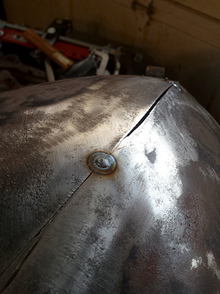

    But I did decide to tack it together to figure out where I stand. I seem to have stretched the metal a bit on the side that had all the bullet holes and dents. I've got some high spots that i'm trying to figure out how I want to handle. I hit it with a torch and a wet rag once but I'm not sure how effective it was.
    The nose looks OK though.

    The problem is the dents and bullet holes were stretched to begin with. Running it through the wheel further stretched it. Next time you can shrink just the dent areas and then bump them back into shape.
    For now you can strategically place heat shrinks and rapid cools like you said... But I prefer a shrinking disc. Order one on ebay or take a drive to charlton and buy one from Wray Schelin directly.
    Beau and patmanta like this.

    Yeah, I didn't use a lot of compression on the wheel, but you are correct, I did stretch the material and make my own mess.
    I've seen shrinking wheels but I don't know much about using them. I'll watch some YouTube videos today though. Thanks for the tip!

    Thanks! I did get a little excited with the wheel since I hadn't had access to one in years. I at least hammered the worst one on the nose in almost completely using the hammer off dolly technique. But that's actually what wore me out enough to say tohellwithit and go buy that wheel.
    Honestly, the wheel did do a lot of work that needed doing quite quickly. I just seem to have traded off a little more stretching of the metal than I had anticipated.
    I'm going to try to use my HF stud welder to make hot spots to shrink next. I've seen some videos of guys using them with success. The MAPP torch seems to work but it heats a large area. It will be a continued learning experience if nothing else.

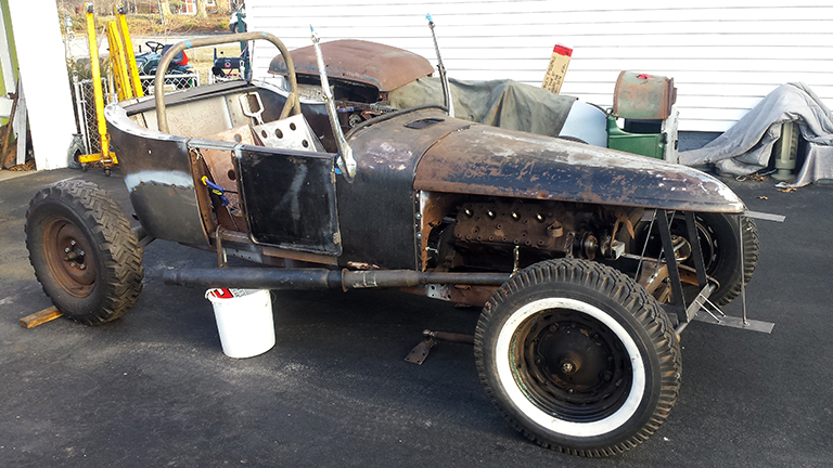

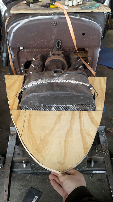

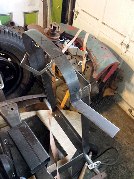

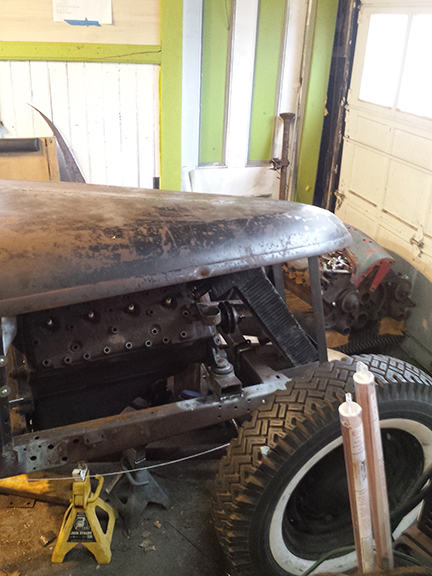

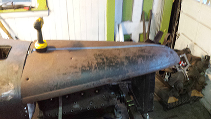

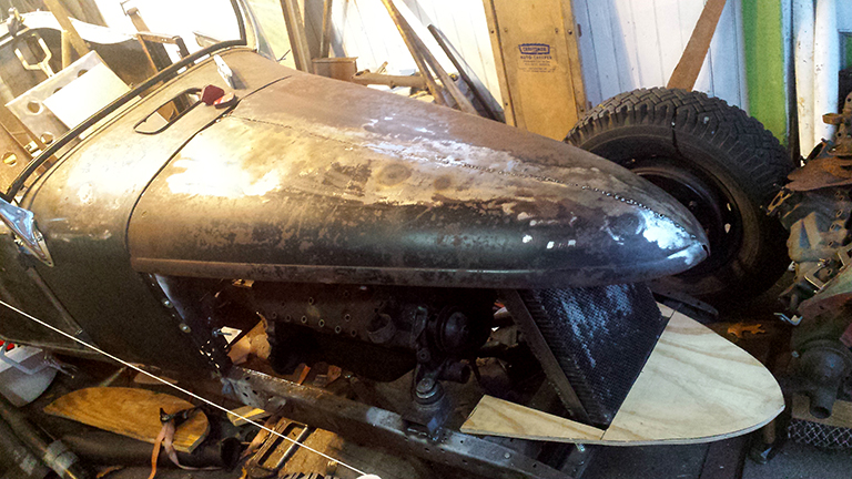

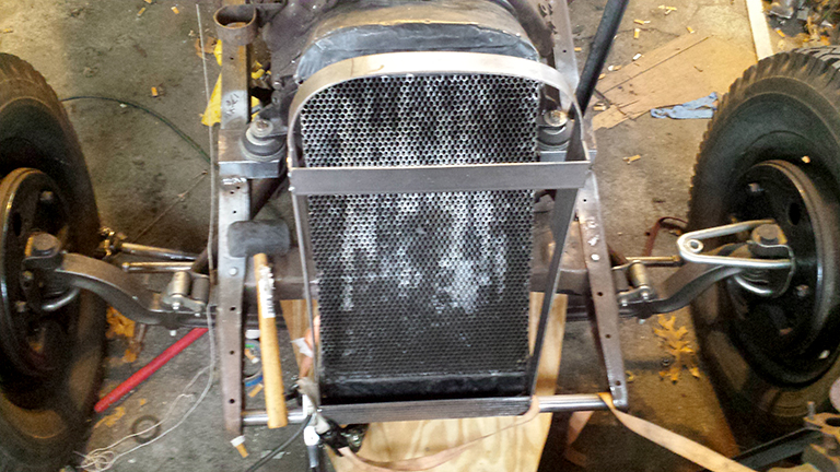

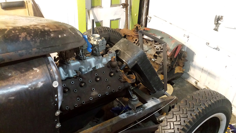

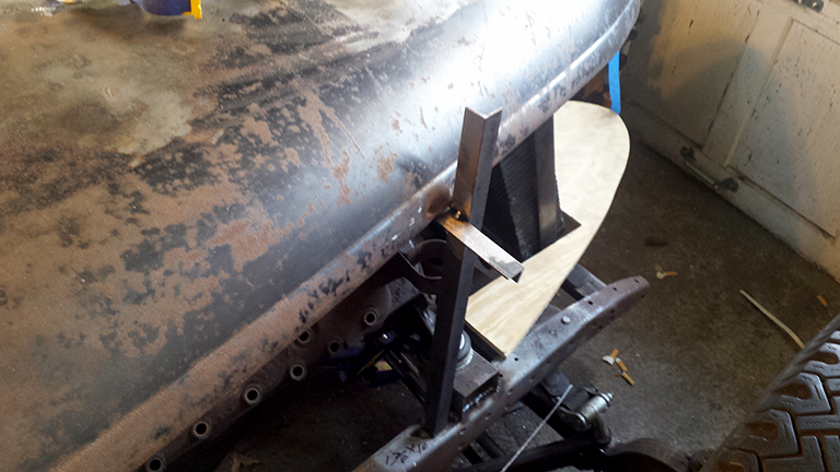

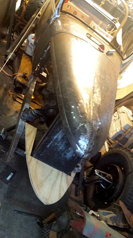

    Took a long break and spent all last week on the car. I got the hood to stop oil-canning. It still needs some smoothing, but it's close enough to work with now.
    So then it was on to the nose! Which is probably what everyone is most anxious to see, myself included. So I made a template to grab the curves first but then discovered that I needed to put a floor in and get the body up another 3/4" to chase out the bucktooth slope in the hood. So I cut one out of plywood and spent a whole day fighting with it to get it under the body, tucked up into my subframe, and bolted down.
    20170104_141133.jpg 20170104_141152.jpg 20170104_141533.jpg 20170104_141540.jpg 20170104_161611.jpg 20170104_161701.jpg 20170105_104105.jpg 20170105_125415.jpg 20170106_120439.jpg
    THAT didn't do it, so it was time to re-***ess the radiator placement. With some advice from Paul Gangi, my neighbor, I decided to put it in at a mild angle and bring it forward and down. I did it by putting a 1" spreader up front and tacking a piece of angle in to start the radiator support and built up from there.
    20170106_120457.jpg 20170106_165906.jpg 20170106_170033.jpg 20170107_130856.jpg 20170107_131659.jpg 20170107_131733.jpg IMG_20170107_112348.jpg IMG_20170107_145012.jpg
    I even played around with these 41 marker lights a little.

    I had a 40 but I sold it. A 37 MIGHT work but I'm really better off fabricating the nose myself to get exactly what I'm going for. The car has a heavy rake, remember.
    Also, $700+ for a real nice 37 nose that I'd cut vs. $40 for some 20ga!
    I need to find the good, thick craft paper to make templates now. the stuff they sell at the arts & crafts stores is **** (too small and too thin). I need to go to an art supply store I guess. When I was a kid, you could get the good posterboard at the grocery store.
    volvobrynk and BenLeBlanc like this.

    Surely! As far as process and precision though, it's mostly a tape measure, sharpie, and an eyeball at this stage.
    I used 1.5" x 1/8" strap for the radiator support and the top I just bent around the radiator by hand, somehow dead centering it. THen I marked the sides with the hood down after welding it in, measured for consistency, and bent the tabs up at the correct angle and height. They'll get lopped off eventually, but they give me a level plane to work off of and likely put isolators on to help control the hood once it's tied down.
    I'm going to do some work with rod stock to further reinforce it. Then run some flat stock out off the bottom of the chin forward to start building out the lower grille support.

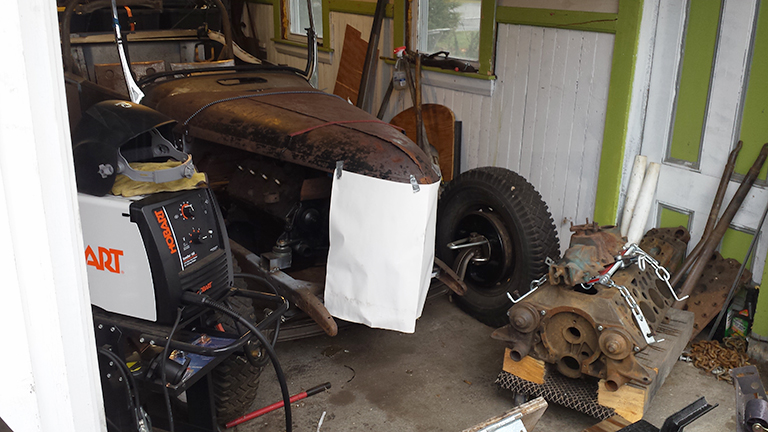

    Well, I burnt up my last tip on my welder and only got 4 hours in the shop this weekend, but I made some progress on the nose structure. I've got 2 pieces on there that I can start building the shape structure off of now.
    I had just gotten into stiffening it up with rod stock (not pictured) when I burned by tip up. If I had some nozzle gel I could have gotten back into it, but I went to Salem for a burger and beers with a friend instead because it was really sunny out and I was mad at it anyway.
    Tim_with_a_T, bct and volvobrynk like this.

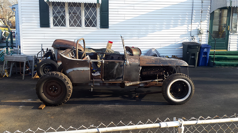

    So, with that out of the way, I actually rolled the Thundercasket out of the shop and into the light on Saturday since it was a perfect day for it.
    Now we can all see what I've built here. It's impossible to really see it in my little shop; I've been worried I was building a wonky black banana in there all this time but now I'm very happy with where this is going.
    HERE IT IS!:
    I actually cleaned some of the shop too while I was at it!
    brEad, bct and volvobrynk like this.
  26. volvobrynk
    Joined: Jan 30, 2011
    Posts: 3,587
    volvobrynk
    from Denmark
    Its BELCOM time. Relax and enjoy the progress, but looks long and a little goofy with the long nose and no chin.
    I'm looking forward to the underpart, I thing it will balance it out nicely.

    It's difficult to see in the pictures for sure.
    I have a template made, but it wouldn't fit in there with the structure in place without cutting on it, which I did not want to do Saturday (and cleaned the bay out with the time instead).
    volvobrynk likes this.
