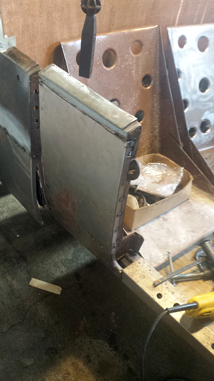

    Not the exciting type of update this weekend, but I did get the center panels tacked in finally, which needed to happen. I switched by welder down to 0.023" wire and had a much easier time with better results too.
    20170128_160241.jpg 20170128_160259.jpg 20170128_160305.jpg 20170128_160310.jpg 20170128_160541.jpg
    Oh, and my neighbor picked up a project finally. It's a 46 ford cab with a Dodge bed on a S-10 frame (shudder, I know). We were tossing ideas around on how to knock the ugly out of it without breaking the bank. In the pic below we're seeing how his old 34 fenders look.

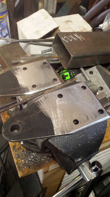

    I was feeling a little burned out with messing with sheet metal and the nose, so I went on to checking another important item off the list, mounting the wishbone brackets and starting to bend them.
    I got the plates tacked in satisfactorily, but I didn't get too far bending the heads of the bones back. I made a bit of an oops towards the end of the day and grenaded my cutoff wheel, so I decided it was time to go in for the day.
    20170204_134028.jpg 20170204_140832.jpg 20170204_145645.jpg 20170204_134017.jpg

    Snow day yesterday. Ended up doing math and pie cutting the bones.
    I think I'm going to have to cut and re-weld my mounting plates now, because I'm pretty far out in threads on my tie rod ends now (like, almost 3"), which I should have accounted for, but it just did not occur to me unfortunately.

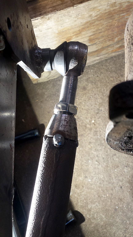

    OK, so, after learning the valuable lesson "just because you can get your tack weld in there, doesn't mean you can get your cutoff wheel in there later" over the weekend, I moved my wishbone mount plates up about 1.5" to compensate for taking the 0.5" out of the tops of the bones to get the caster flipped the other way. Now I've got about 10° though, so I guess my math was off by 3° :confused:

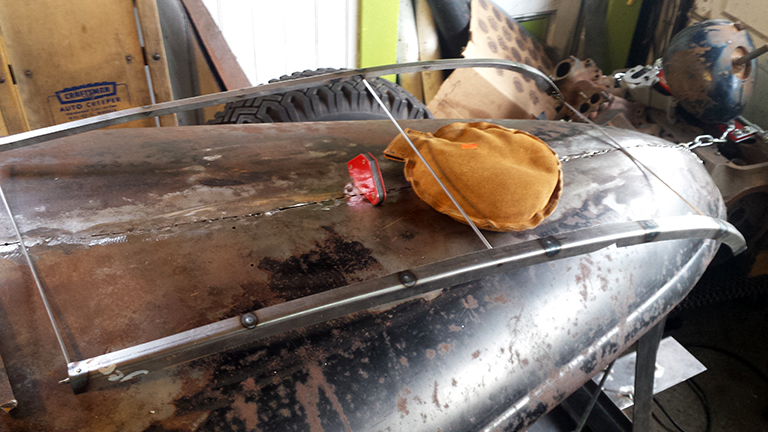

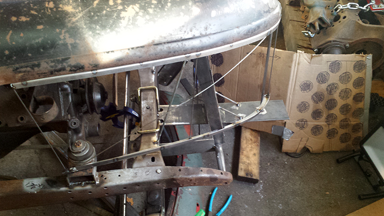

    Made some progress this weekend. Started off giving the windshield stanchions a much needed haircut. Now the car looks right finally. I should have done this months ago.
    Then I pulled all the fasteners under the hood on the cowl so they don't interfere and ran some machine screws and washers up from under the hood with fender washers on top to level it to the cowl. You can't really see that in the pics I took.
    Once I got that where I was happy and cut some bits off the radiator support, I started cutting strips of steel and braking 90's which I then shrunk the curvature of the hood into. So far I have two of the six I intend to make. Hopefully this works out. I'm still trying to plan how I want to skin this nose in the end but these will at least give me a way to make a structure regardless.

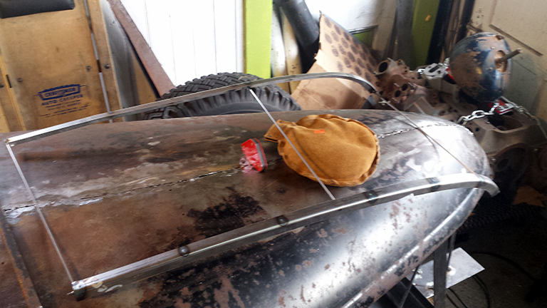

    One of the next moves I'm considering is to lay the windshield posts back a bit more. My seats are set almost on the floor right now and I actually need to come up a little, so I've got wiggle room to find the right balance.
    Looking at this early pic of the Chrisman, I'm looking at the angle of the windshield as inspiration.
    My car is VERY different though. It's got a 2° rake for starters.
    http://www.hotrod.com/articles/hrxp-1107-chrisman-barris-dobie-gillis-coupe/
    brEad, Stogy, Shaun1162 and 1 other person like this.

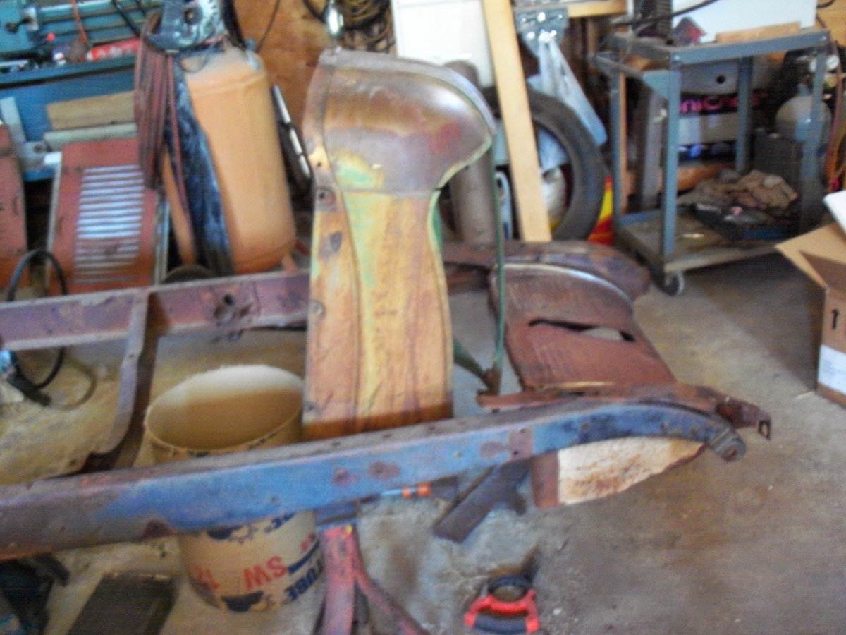

  27. onekoolkat1950
    Joined: Mar 23, 2008
    Posts: 1,871
    onekoolkat1950
    [​IMG]this is the same Oliver grills shell mated to a Avory shell .
    brEad, Stogy, patmanta and 1 other person like this.

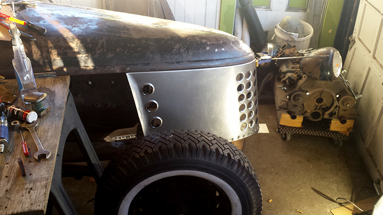

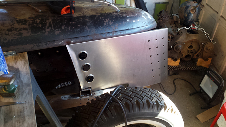

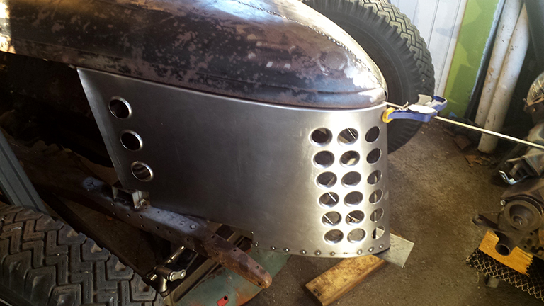

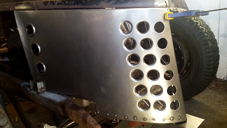

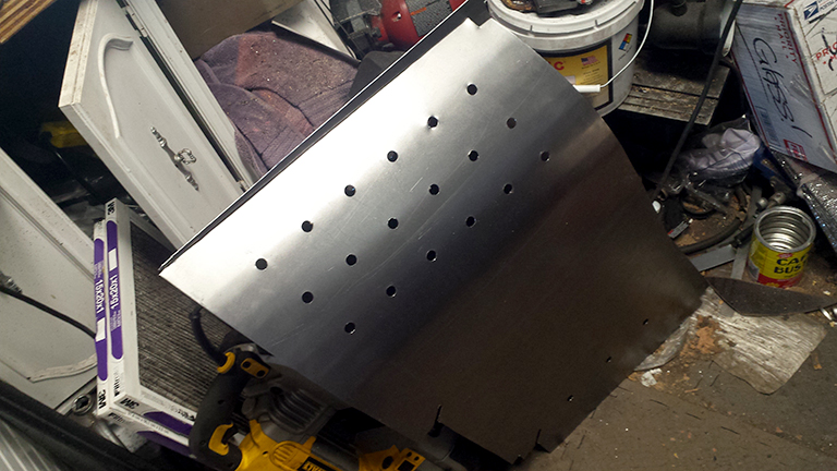

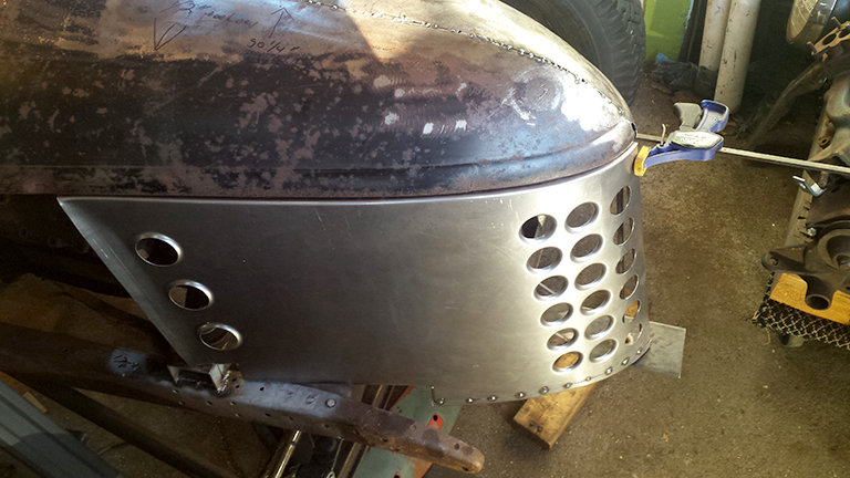

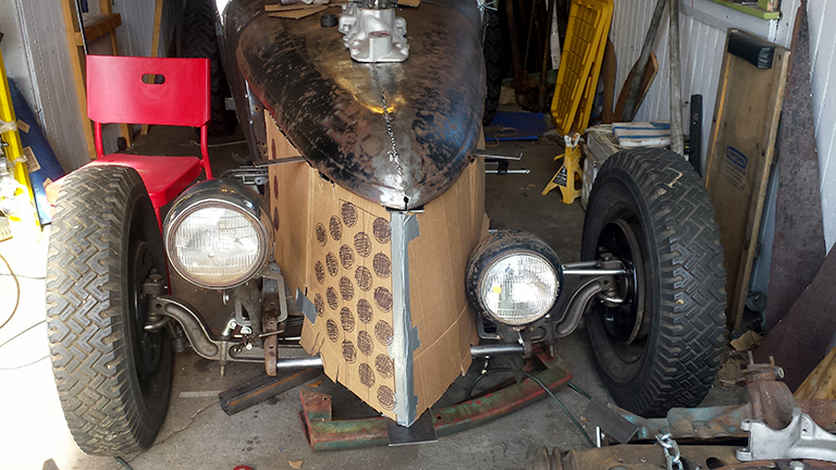

    Ok, MAJOR progress this weekend. Here she is.
    3 days of work and overthinking to get this panel done. It's not perfect and I'd do some things differently knowing what I learned from the process but I'm going to push on and mirror the other side and make it work.
    Here's the rest of the pics:
    This was the first plan, which could have worked but I thought would be more difficult in the long run. It DID give me a good solid template to base measurements off of though.

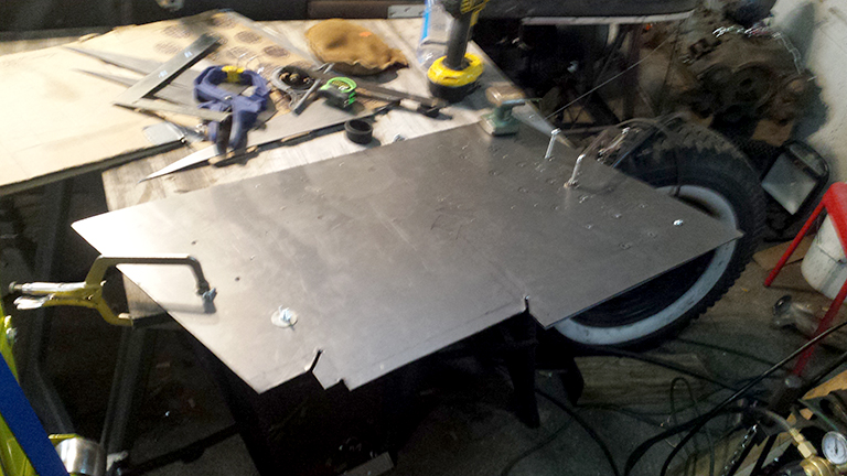

    Here's the cutting and shaping process. I screwed my sheets together. Since I only had one sheet of steel and the store was closed, I decided to favor the top edge and patch the front lower with a contoured piece later.
    20170304_135017.jpg 20170304_180411.jpg 20170305_103245.jpg 20170305_111816.jpg 20170305_120008.jpg 20170305_124422.jpg
    The dimple punch DID flatten the metal out a bit even though I put a curve in it beforehand. I had to borrow a socket from my neighbor so I could use my electricians punches on the front row (the curve is deeper there). I'm going to try to put a spine in the center to even out the shape once I do the other side.
    20170305_154047.jpg 20170305_164751.jpg 20170305_164958.jpg 20170305_165022.jpg 20170305_164919.jpg
    I kinda wish I'd held off flaring the back of the panel, because I'm not 100% happy with it. I think I can clean it up though. I used the stretcher, a flanger, and my english wheel. I think I'll shrink the brake edges back down and do a little more loose wheeling (and maybe planishing with a soft hammer).
    So, here she sits.
    bymanr, brEad, Tim_with_a_T and 4 others like this.
