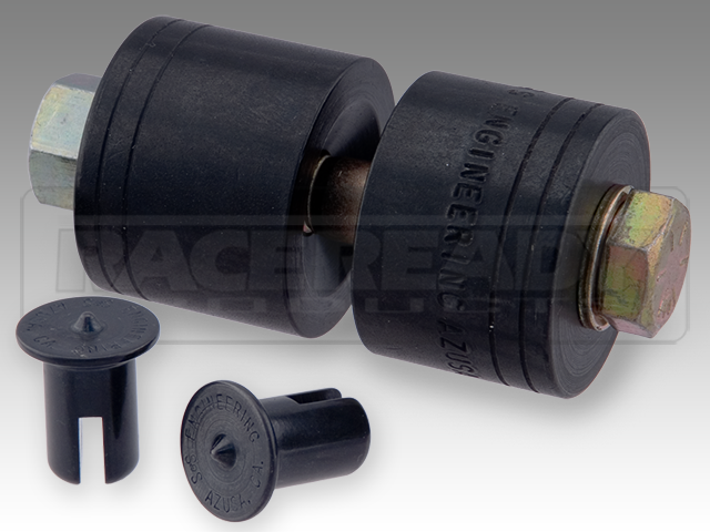

    Pat, looking good man. How did you flare the holes? They are neat like that

    Dimple punches! Sometimes called Aircraft Punches or Punch & Flare tools. I have 1.5" and 2" I got off Amazon.
    https://www.amazon.com/gp/product/B006K8GL6I
    I used them on the seats I made too. They take some muscle, so I use my air ratchet. The OD of the ring on a 1.5" is nearish 2" so I used a 2"-ish HF electrician's punch on the leading row where the curve was deepest on the nose. The flares tend to flatten the material.

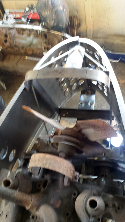

    Not much new and exciting progress this week but I did get the other side shaped and punched. Next will be to finish it up and figure out mounting.

    HAH! Yeah, I need to do some work in the front. I didn't bend the tabs in past 90° yet to get them to flush up. I ran out of shop time during the storm on my snow day Tuesday and had to switch over to snow removal.
    I'm not entirely sure yet how I'm going to approach joining the halves. I know I'm going to make at least one brace for the middle to push some of the material out into shape where the dimples are pulling it flatter and it's far away from the curves of the edges. That will tie it together a little. As far as fusing it together though, that's going to be a little tough because getting at it with a welder in the back is tough. It might even be tough if I had a pinch-welder. I'd prefer not to run a bead down the middle of the outside but that may be what has to happen. I'm open to suggestions.

    See here? I'm not over the moon with the flare or the fut around the engine mount stand here:

    Those aren't formed blisters. That's what you get when you take two 40' hoods and put them together.
    I actually don't need clearance in that area. Everything clears the nose I've built. I'm just not happy with the flare I made at the end of the piece and that somehow my pattern ended up an inch off where it's cut to clear the engine mount risers.
    The driver side has not been flared, so I COULD re- make the p***enger side, but that is a lot of work that's not progress. SO my options are to try to shrink it back down (also a lot of work) OR cut the flared section out and replace it with new steel (which would be tight because the flare starts probably less than a half inch from the punched holes. This is why it's a good idea to test an idea like this on s**** first; I just got carried away.
    I may actually hit the area with some paint so I can really see how ****ty/good it actually is.
    But the idea of the flare was to help PULL air out and away after the fan so I don't end up with as much high pressure in the engine bay, under the hood, and against the firewall.
    The simple solution I'm working on now is to take a piece of 18ga and do a mild S brake to it to put an angled lip at the back of the punched holes and another angled flap protruding from the side by the coil mount, then clone it to the other side. I would also make a filler piece for that 1x2" gap that's driving me nuts.
    But maybe the flare isn't that bad and I should keep it???

    Ok, I got back to work over the weekend. Lots of it was just fiddling around and figuring out what to do, but, I did DO some of it.
    The nose mounting is finally happening. I landed on just making a couple plates to hold the bottom corners where they meet the engine mounts. I used a piece of 3" flat that had a bit of a curve to it already and it seems to have worked out nicely. I ran out of stock, but the plan for the top is to use some narrow flat or perforated strap to run from the firewall to the radiator support which I can screw the top of the nose to.
