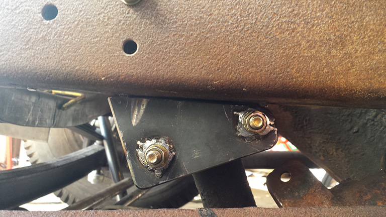

    patmanta
    from Woburn, MA

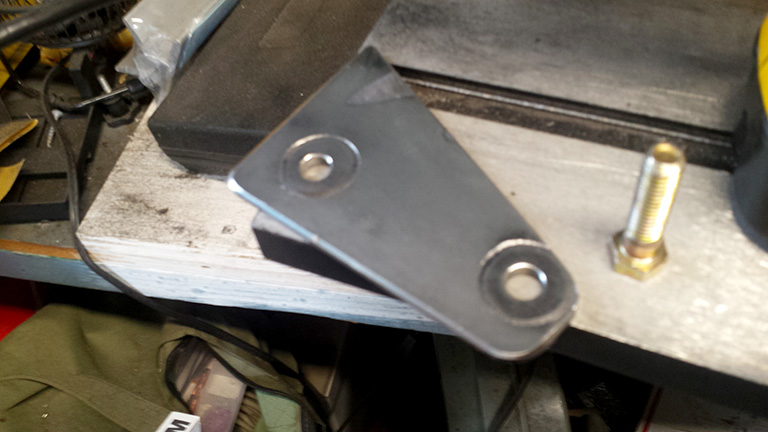

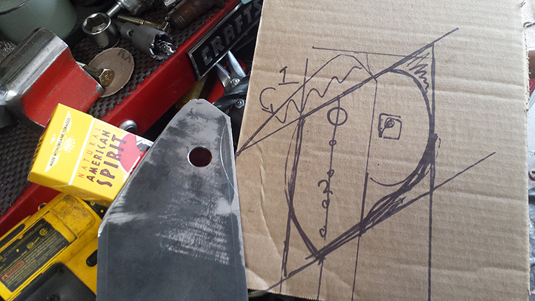

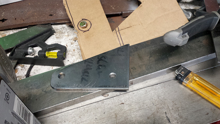

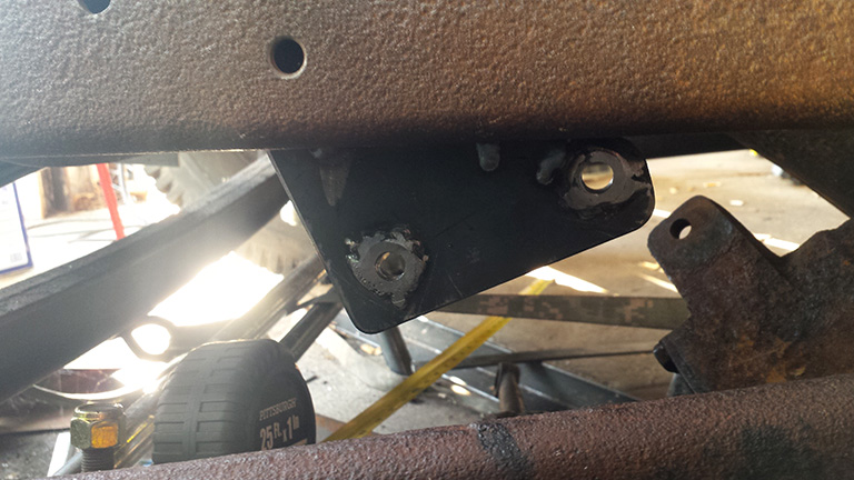

    THANKS! Yeah, this is very true. When I've been out of the shop too long, I've learned to pick something small that I can either complete, or get most of the way there with visible results in one day, to get started on. This fit the bill because I've been thinking about it for a while, so I had a good idea already what I needed to do.
    So, here's what's going on. I am making the bracket out of 3/16" plate which I will gusset, if not run a spine around the entire perimeter. I have my drag link set level and parallel to the tie rod. The pitman arm is level to the ground and in line with the tie rod and drag link. The top hole on the steering box happened to line up with a hole I had made for mounts that I decided not to use which was a nice bonus. The bottom two holes require a bracket. I was delighted to discover that said bracket and mounting holes lined up far down enough for a socket to clear the frame rail!
    This box was already cut and has a U joint in place already. My placement seems to work out just right as the U Joint sits just under the top of the rail. This solves all my clearance concerns for making headers later. I just need to decide how I'm going to locate, secure, & run the steering now. I also need to buy some new joints, shafts, & a drag link now that I have a fixed point to measure from. So, seat placement needs to come soon.
    Also, I need to get out there more than once every 4th week because OOF! MY SHOP MUSCLES HURT! Seriously, when I'm good about making shop time, I feel great, but when I get out there after too long a break, I feel it in my joints and meat for several days after. HEED THIS WARNING, YOUNGER BUILDERS!
    tomschev2, Stogy and Mikel50 like this.
  8. patmanta
    Joined: May 10, 2011
    Posts: 3,882
    patmanta
    from Woburn, MA
    MILESTONE: STEERING BOX MOUNT IS MOUNTED.
    Now I can route my steering and order a correct tie rod (easier said than done apparently).

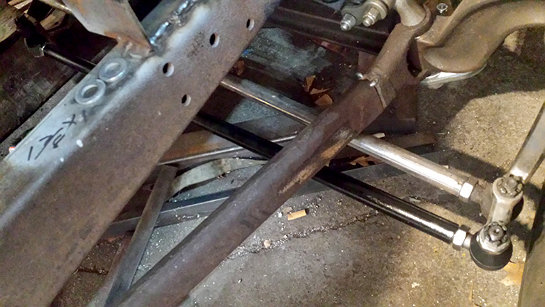

    SO, this morning's issue is that my eye to eye measurement is 31" for this steering box on this drop axle in this model A frame. The easy route, Speedway, only offers 30" and 32" which begs the question, do I get a 32" and cut it or do I find another option?
    EDIT: Remembered it's a So-Cal axle and therefore So-Cal carries a correctly sized tube. Now to figure out the steering shafts and U-Joints.
    Other than that, I made some ugly welds, reinforced the holes on the bracket, and tacked it on to the frame.

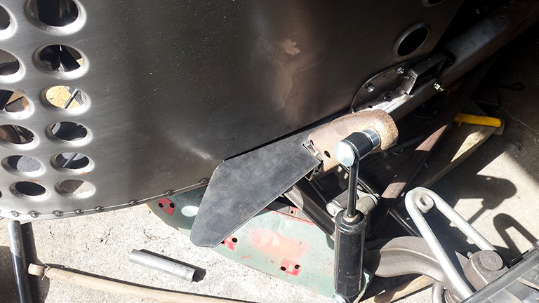

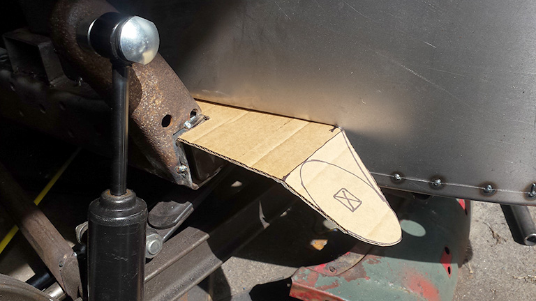

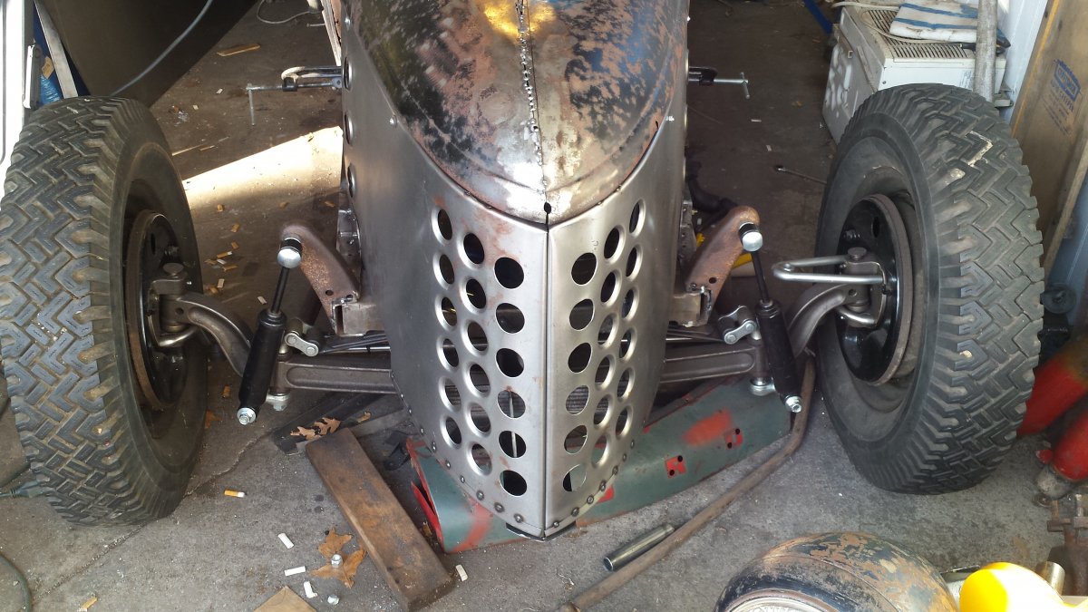

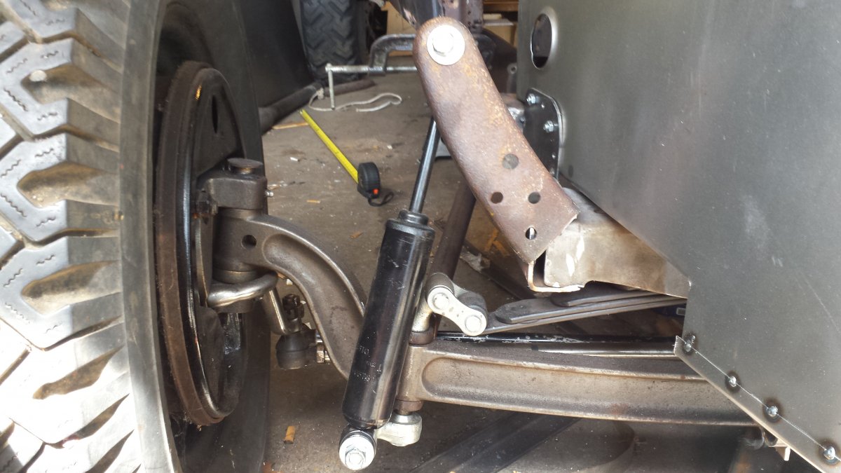

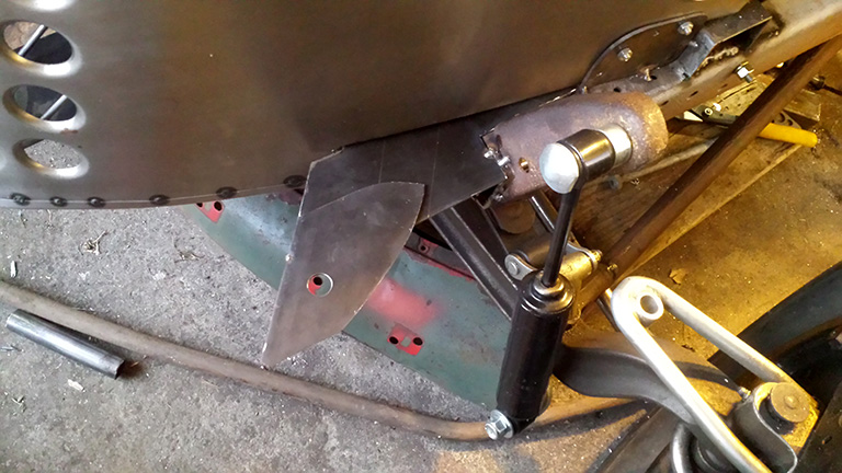

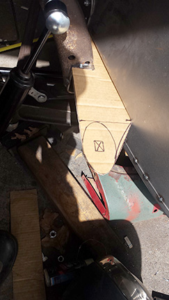

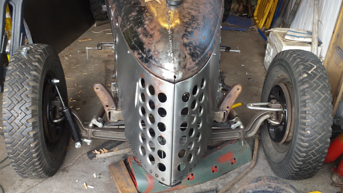

    Bobbing my horns today while I wait for steering parts.
    I'm using them for shock mounts.
    Not sure how I want to orient them or to put the shocks ahead or behind the axle.
    Opinions?
    tomschev2 and volvobrynk like this.
  14. Mikel50
    Joined: Mar 30, 2015
    Posts: 1,113
    Mikel50
    I think the top looks better.
    brEad, tomschev2 and patmanta like this.
  15. patmanta
    Posts: 3,882
    patmanta
    from Woburn, MA
    Yeah man, I grabbed my neighbor Paul and we came up with the same conclusion because it echoes the drop axle instead of opposing it.
    Here's what we came up with.
    brEad, tomschev2, volvobrynk and 6 others like this.
  16. BenLeBlanc

    That's a really cool idea and looks great. Are you going to mug weld the gap between the front cross and the side rail?

  18. patmanta
    Posts: 3,882
    patmanta
    from Woburn, MA
    Yes as well as probably make a curved fill to tie into the nose.
    Gentlemen, we have shock mounts.

    I've never noticed anyone using the horns for shock mounts either, that being said. I'm kinda surprised, they look right at home.
    Curious what the green/red piece is under the nose. Is that potentially a lower air damn maybe ? It would certainly go with the look you're trying to achieve.

    That's the F1 nose piece that I've had kicking around for a few years. It may find its way onto this car somewhere, but it's not on the definite pile. It's a throwback to page 4 (2013) and the first vision for this build:

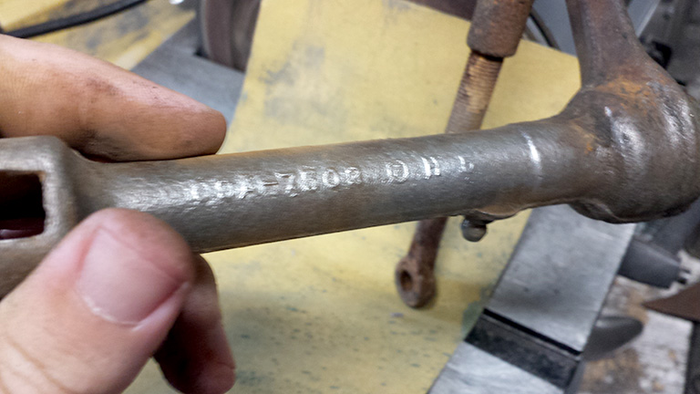

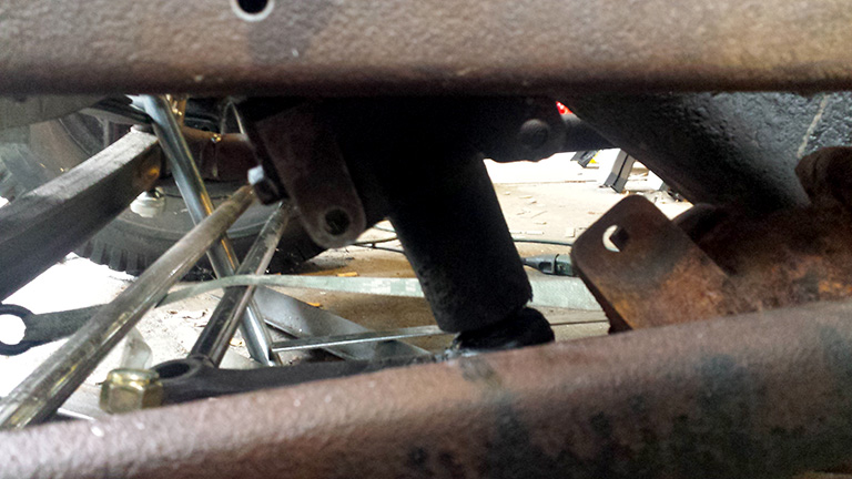

    CLUTCH IS LINKED!
    I love the feeling when a part fits!I bought this Equalizer shaft in a lot to get the pivot and was pleasantly surprised to find out that it was a perfect fit for my staggered F1 crossmember and pedal bracket mount.
    Number looks to be 09A-7503 but it's tough to tell. The numbers on VanPelt seem to list 01A & 51A...
    Regardless, I need to sort out the pivot location now because, as usual, something is in the way or close to it!

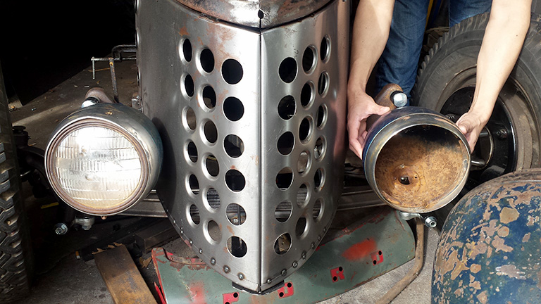

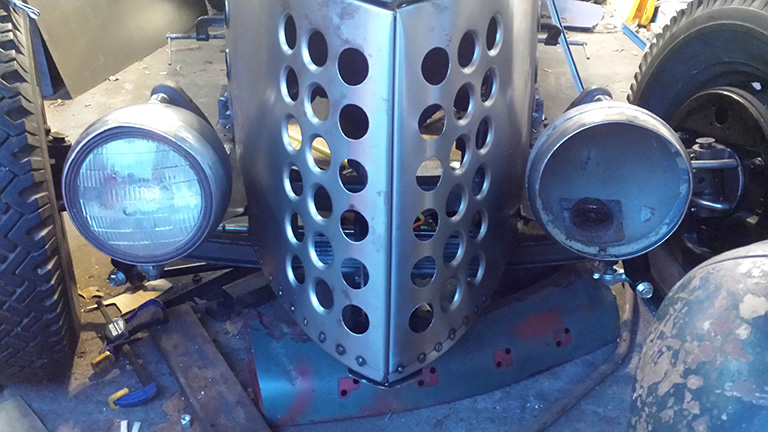

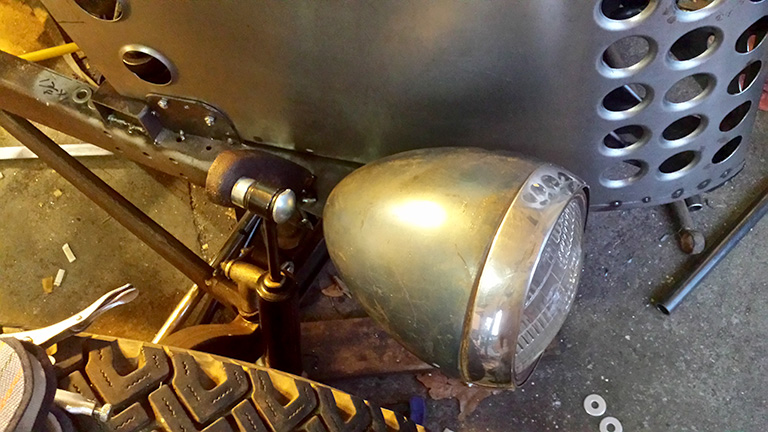

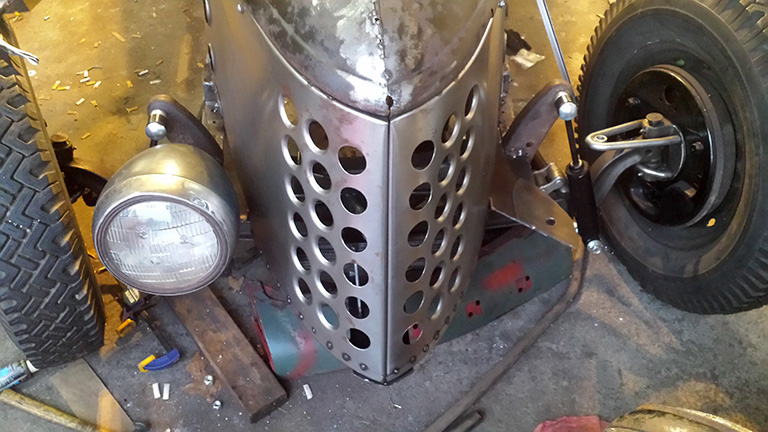

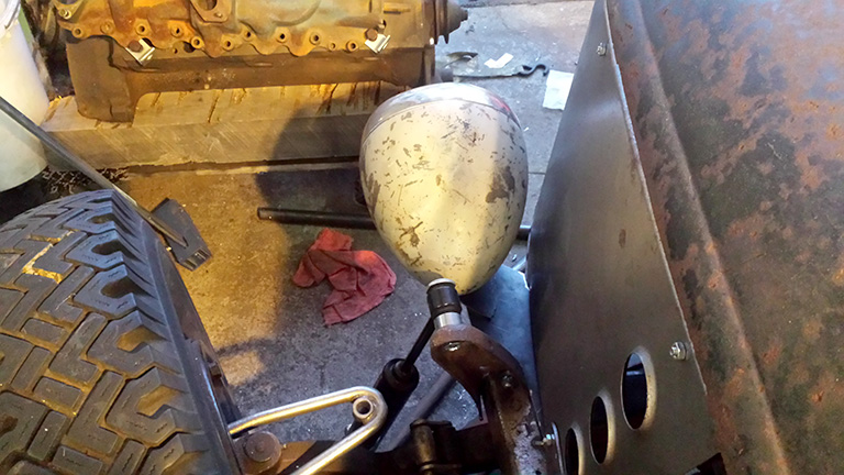

    Weekend update, lots of chipping away. Last week I got my drag link, painted, and ***embled it. It's not sitting quite as I expected but I think we're still good to go. We shall see when I get things rolled out in the daylight and an actual steering wheel connected. The steering box moves freely but I don't know if there's any play in it yet.
    I got my headlights mounted too. It took all day and I had help for a couple hours. I'm fairly pleased with the location, but I may try a couple other options. I'm not sure I'm happy with these plate mounts I made.

    I'm super pleased with them too, to the point that I kinda don't want to obscure them too much with those pesky headlights!

    You could adapt some Prowler headlights into your nose piece. :rolleyes:
  30. patmanta
    Posts: 3,882
    patmanta
    from Woburn, MA
    HAH! AT LEAST THEY WOULD STAND OUT FROM ALL THE MINI COOPER LIGHTED STREET RODS!
    37 Chevy housings were discussed though :cool:
