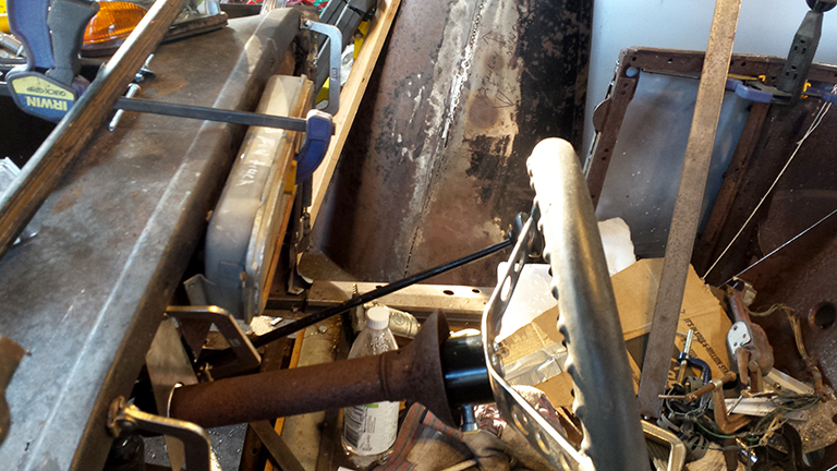

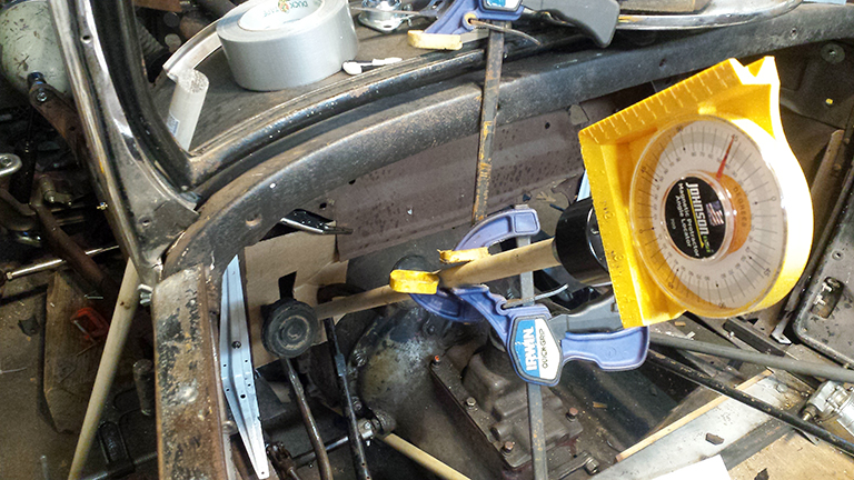

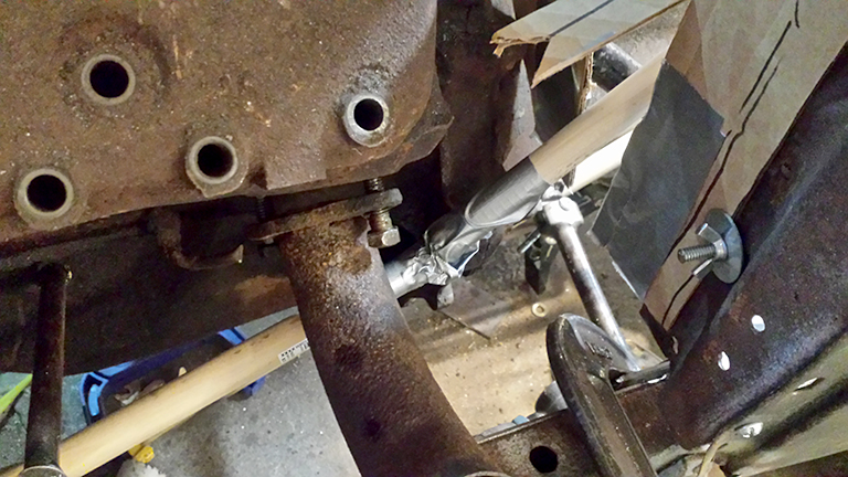

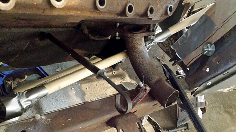

    Started trying to get a handle on the steering run yesterday. Only got so far.
    I'm using 3/4" dowels, duct tape, toilet paper rolls, and cardboard, but so far I've discovered I need to get the firewall going as a part of the process because there's not enough of it in the right places.
    With 2 "joints" I'm coming up with a 45º hub. I'm shooting for 30º since that's what I'm accustomed to in most of the cars I've driven and I'm going to be pretty laid back and low in this car. I'm going to have to devise a better jig and system for getting this all dialed in.
    I've also gotta shorten my pedals (any advice?)

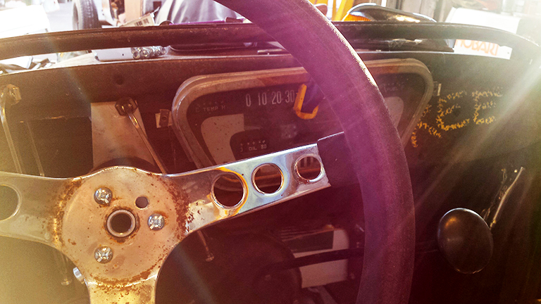

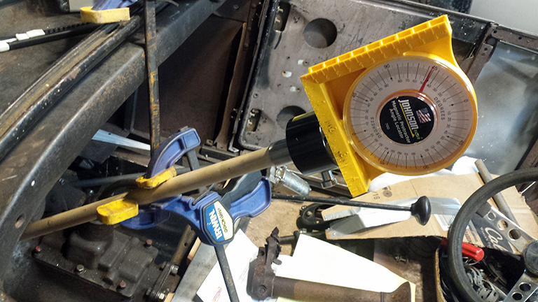

    More fiddling around with steering this weekend. It was so steamy that the wood dowels were not much help from the swelling. But I've got things fairly well figured out now after making a tool out of a piece of flat stock cut at 35º to give me a better idea what I'm looking at when I play fiddlesticks.
    I made a firewall template too and soon discovered that I'm probably going to have to put a recess in it to accommodate the firewall/shaft throughput nicely.
    I also did a little mockup and got the wheel where I think it's comfortable; 25º and 2" over from the stock T location. I also know that my 53 truck gauges will fit now AND clear the shifter.
    Getting In and Out is proving to be very difficult though. I've got a detachable wheel hub now, which helps, but I'm considering bolt/welding the center panel to the driver's door and locating the latch at the back of the center panel where it meets the back tub section (which had a striker plate on it previously anyway) and cutting the panel where it's currently got a seam between my sheetmetal and the patch panel I used.

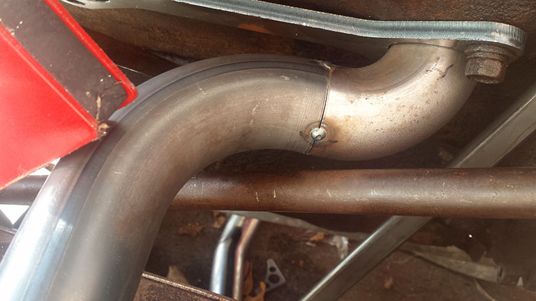

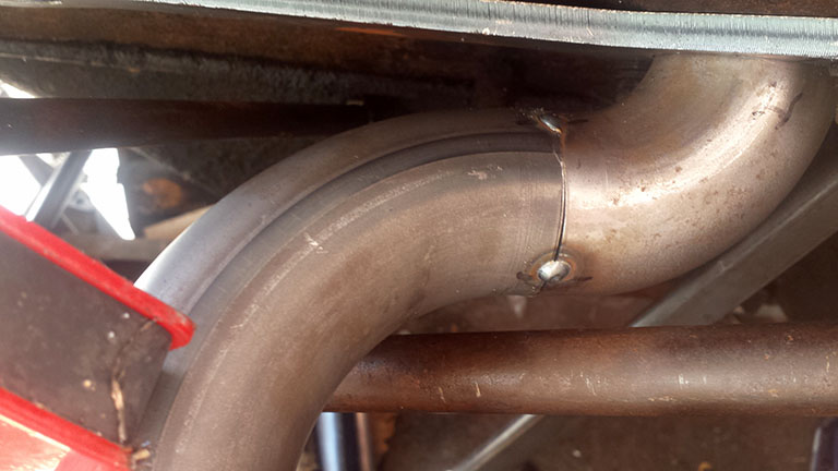

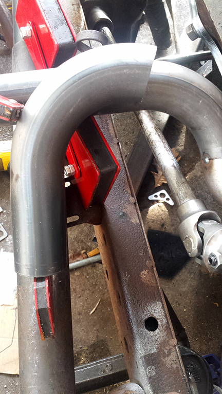

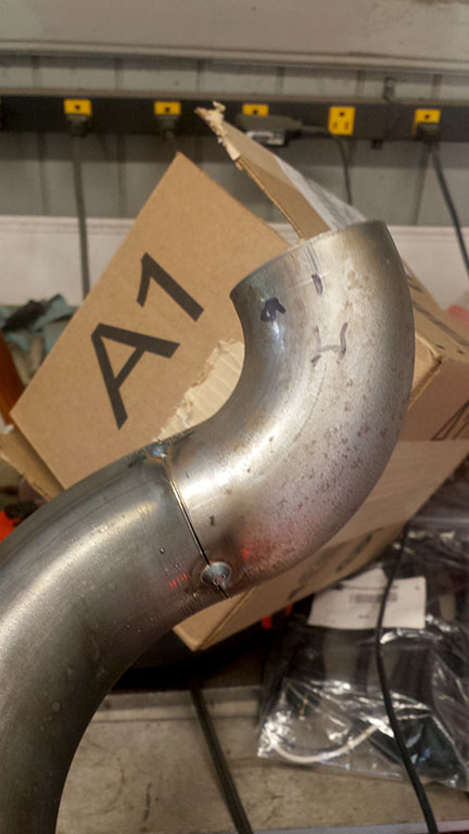

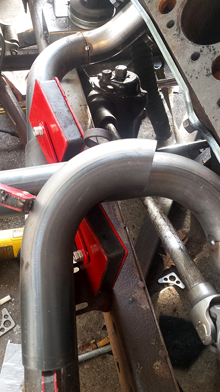

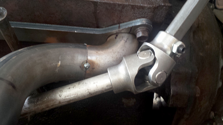

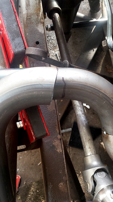

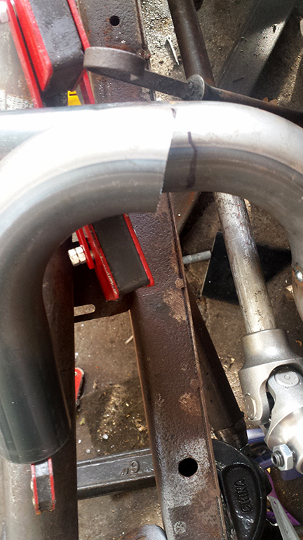

    I've been keeping busy on the steering/exhaust issue and finally started making some progress after throwing some more money at bends.
    I put one of the sides mostly together and managed to get around the steering rod with a comfortable half inch of clearance. Now I just need to get from there to the collector tube.
    QUESTION: Do I NEED to put more of a sweep/angle into the tube and do I need to dump in farther away from this center port dump in?
    20171021_150424.jpg 20171021_151603.jpg 20171021_151609.jpg 20171021_151625.jpg 20171021_151646.jpg 20171021_174801.jpg 20171021_174816.jpg 20171021_174831.jpg 20171021_180347.jpg

    That looks like a pretty smooth transition to me. Mine ended up a bit tighter than that and nobody has **** on me about it (at least not to my face). Haha.

    I guess I'm just a little concerned about backpressure from the back cylinder pushing up into the center pipe AND creating a really hot hot spot with there being 3 cylinders dumping gas so close on that part of the pipe.
    Opinions?

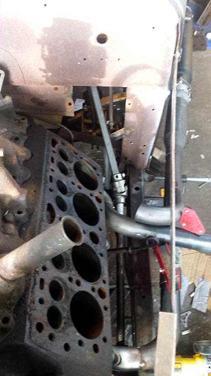

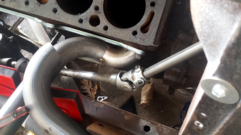

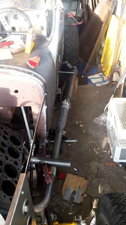

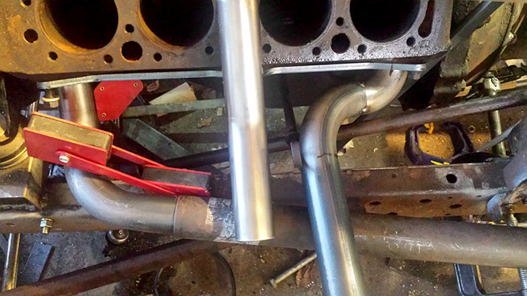

    Namely, I got my steering connected (about 75%) for the most part. I still need to sort out the column and the stuff under the cowl but I have it sitting at my target 25° and the intermediate is well under 35° to get me there.
    AND my exhaust clears the U joint by a half inch! I feel pretty good about myself for not having to throw anything away so far and nailing most of my lengths on the first cut in this process.
    I've got my tubes laid on there and it looks like I can get back to around the port location on the collector tube without much fuss.
    I angled the whole setup out more to the edge of the rear tire. I had it following the body, but this just did not look right to me at all.
    I also put clothes on my dog to give myself something to chuckle at while I was doing all this.
