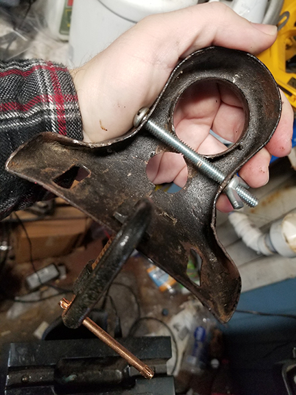

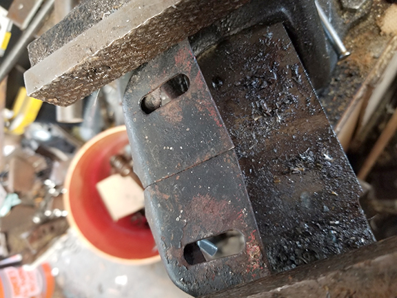

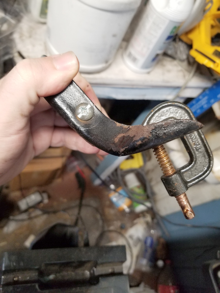

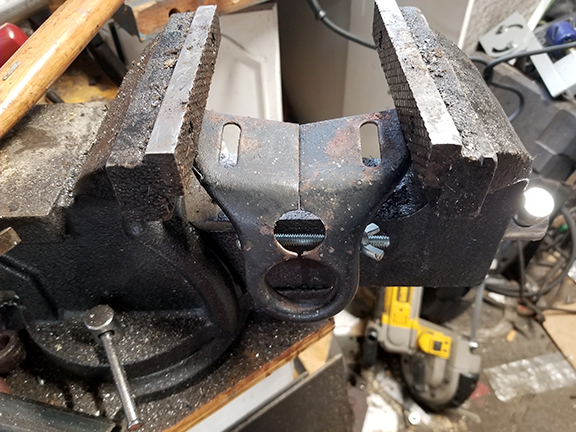

    I made A LITTLE progress this weekend, some on the car and some on the shop conditions.
    I finally cut the last tube for the header run around the steering shaft. I feel like I've been agonizing about this for at least a quarter-year now and I'm still not done. Next I'll address the center port and then move on to agonizing about how to tie it all into the main pipe.
    So, instead of continuing to drive myself crazy on these tubes, I moved on to driving myself crazy with another tube for the steering. I pulled a F1 drop and tube I got for shipping plus a penny off ePay. Neither piece is pristine but nor are they rotten like a lot of my stuff starts off so it was refreshing. I had to change the angle of the drop so I put it in the vice and gave it a few thuds with a deadblow hammer and fine tuned it by bumping the sides down until I got to around 20° (the dash seems to sit around 5°).
    I cut the tube down, pulled the clamp off the end, and got a bushing partially pushed up into the end to center the shaft.
    Now I've just gotta figure out how I want to control the column. The drop doesn't grab it firmly or have enough contact area to do this so it needs a second point of control or a sleeve that's firmly mounted behind it somewhere. Here I'm toying with the clamp off the tube and some angle iron.

    In the interest of actually making progress, I'm still trying to figure out my steering column and mount. If I had some nice insert bearings that would fit nicely in the F1 tube I would be ahead of the game. I've been shopping for that to no avail so far.
    Any suggestions?
    If I don't find something very soon I'm just going to throw money at it and have Speedway make me a custom length one and move on.

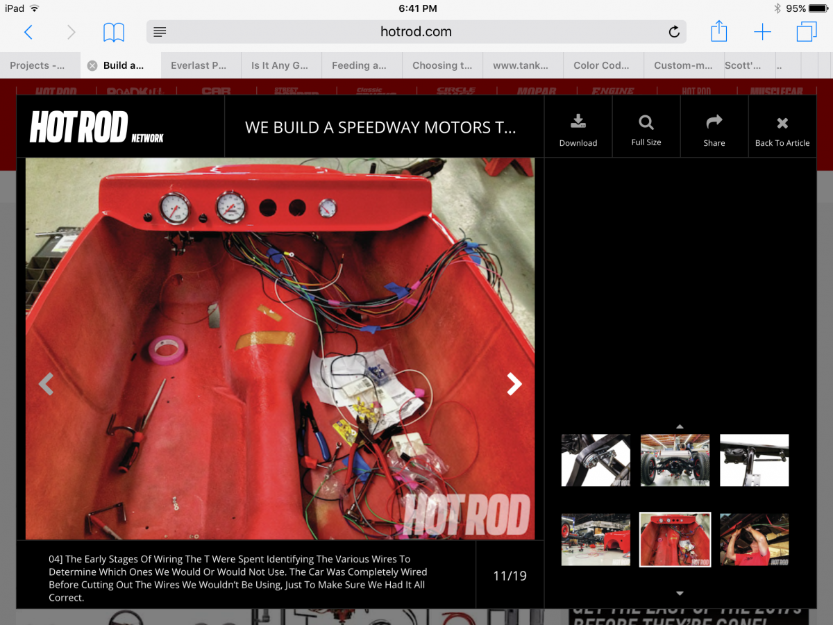

    Speaking of them, I saw this bracket they make for their Kit T and I'm wondering if it or a rig like it would be useful to me in my wacky steering setup.
    Anybody use one of these Speedway Tribute T Steering Column Mounts? I'm not sure I understand how it is meant to be used or if I could use it or if I should make something LIKE it:

    schedule 40 pipe and wheelbarrow wheel bearings. The right size pipe, they press right in. All available at home depot/lowes. .75" shaft slides right through. A few shaft collars holds it in place.

    THANKS! You're a lifesaver! So, shaft collar on the outside to put pressure on the bearing?
    I haven't found any tube shims yet and I'm not sure what the exact ID of the column tube I'm working with is (the OD is 1-3/4" though). Bearings seem to run 1-3/8" OD which seems to be a fit for 1-1/4 inch schedule 40.

  19. Speedway says That bracket fits their tribute T body only.
    You can make it do whatever you want with it but it is installed in these pics.
    If your imagination is good, you can see how the bracket points the column right at the 4" raised corvair box.
