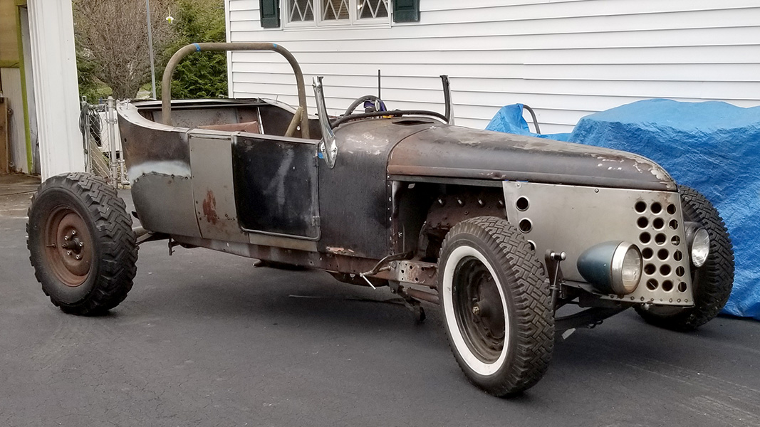

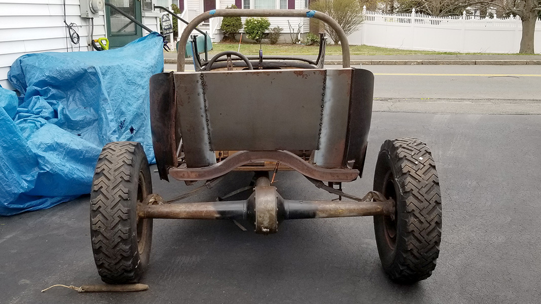

    NOW, on to the bad and lessons learned here.
    My big takeaway from getting the car outside of my cramped shop for the first time in over 2 years is that when you're building something this ambitious and coloring outside the lines, you really need to be able to get a GOOD LOOK AT IT. My little shop really only let me see a section at a time so I thought it was looking cool though something did feel a little off; I just couldn't place it.
    Something does not work with the relationship between the wheels and the body.
    While I'm overall pleased with the wedge shape of the body, the way it is sitting just does not work for me.
    The nose feels just a little bit too far forward.
    The rear end and its 32" tires look tiny, almost smaller than the 29's up front.
    The whole car is sitting overall too high for a body like this.
    I already knew I needed to revise my floor and subframe, and I'm sure glad I hadn't started that yet because the new plan is to pull the torque tube, cut my kick up tacks, and move the rear end inboard until the crossmember is inside the tub. This is something I should have done from the start that would have saved me A LOT of grief.
    I was going back over my older Instagram pictures from before this car really took shape and found the prototype shot I took a few years back. The rear end is situated in a position that I think will totally change the look of this car to be more in line with my vision and taste.
    I am going to do this first since it is actually easier than making changes up front and I want to look at it again once I do so before deciding on a plan of attack up there but I think I am going to have to go spring behind axle to get my wheels a little closer to the tip of the nose AND to drop me down a few more inches. I'm sitting HIGH still with the bottom of the frame like 13" off the pavement at the firewall.
    I've got room for it with some modifications:
    TFoch, Stogy, tomschev2 and 1 other person like this.

    I agree with your ***essment and your plan. That said your progress is great. It is always tough to design and build at the same time, especially in a tight spot where you can not see the whole project. Credit to you for being able to look at your work truthfully. That is not a common trait.
    slv63, tomschev2 and patmanta like this.

    Thanks, @Six Ball , yeah, if anything I've learned through my experiences over the past few years, it's the value of looking at your stuff and being honest with yourself.
    And yeah, my shop situation is part of what ground me to a halt back in the beginning of 2018. This weekend's movement has highlighted that and I'm trying to think about how I want to re-configure things further to maximize my space.
    This is where I was at Saturday morning. I had actually gotten the steering linkage mocked up at this point however! So that was a win a**** the entropy.
    And here is how I closed up after @BOSTONCAMARO helped me get the car turned around on Sunday:
    OFT, tomschev2, Stogy and 1 other person like this.
