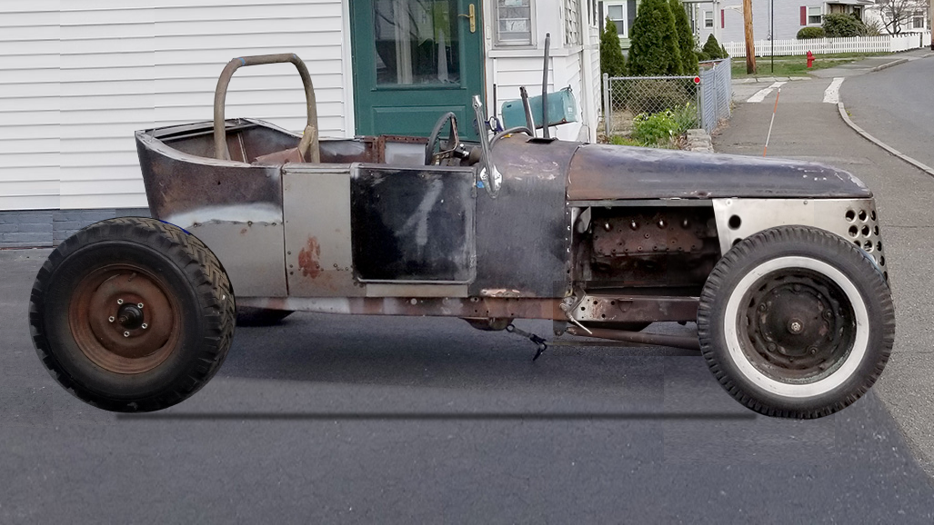

  3. Hey Pat, just catching up on this build. Rolling it out was what it needed, and the changes you're looking at are right on. I'm wondering what a smaller wheel/tire would do for the front end stance?

    Yeah, that's where I'm going FIRST, but i am anticipating that I will feel compelled to go the whole 9 (figuratively and somewhat literally as it's looking 6 rear forward & 3 front forward). And when you're up close and personal with the car, it really does seem a bit too tall.
    Going to the smallest tire I think I can run as it sits would put me down 1.5" in front and I'd need to find something complimentary out back, live with more than 2° of rake, or kick the rear up to compensate. I will not rule this out.
    Though I could pull the wheels off of the 29AA to check. They're radials (155/80R15) but have an OD of almost 25" and a set of 500-16 Firestone ribbed dirt trackers are just under 26" so the ride height difference would only be about 0.575" ish. The rears on there now are 32" Super Traxions on old Jeep wheels.

    @patmanta you are right about Photoshop adventures eating time...but I enjoy it...gr*** grows longer but Stogy has fun...:D...I will say many of you fellow Hambers have very creative minds and come up with some pretty interesting inspired Hotrod/Customs.
    I will do another mod with the hood side off and get that pipe out...does it restrict the door opening?...It may be optical but it appears that way from my angle...what is the other system?
    I'm a fan of a driven look as opposed to spotless showcar but they do look nice all carwash fresh.
    You have a vision as most all of you builders do...glad I could present some options...
    Just a little background on the deco trim behind your grill shell...its a stretched out wing of a vintage Stewart Warner Badge.

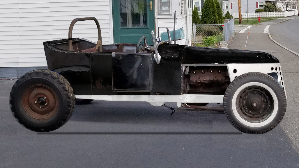

    I blacked things out a little more to get a better idea of where I need to go. This sh00p is dropped 2"/rear in 6"/front out 3" with the lights moved up.

    @patmanta I know it's just an artwork but one of the things that catches my eye is the angle of Exhaust and the Wishbone visually entwining...oh and all the rest is pretty awesome too.​

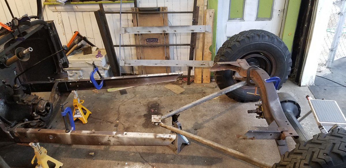

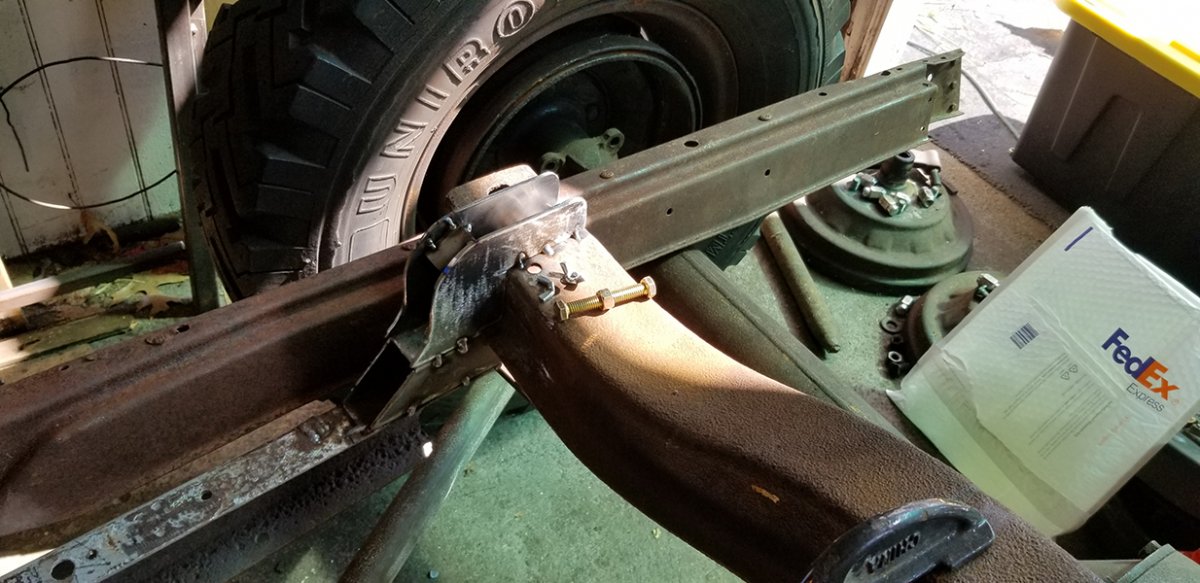

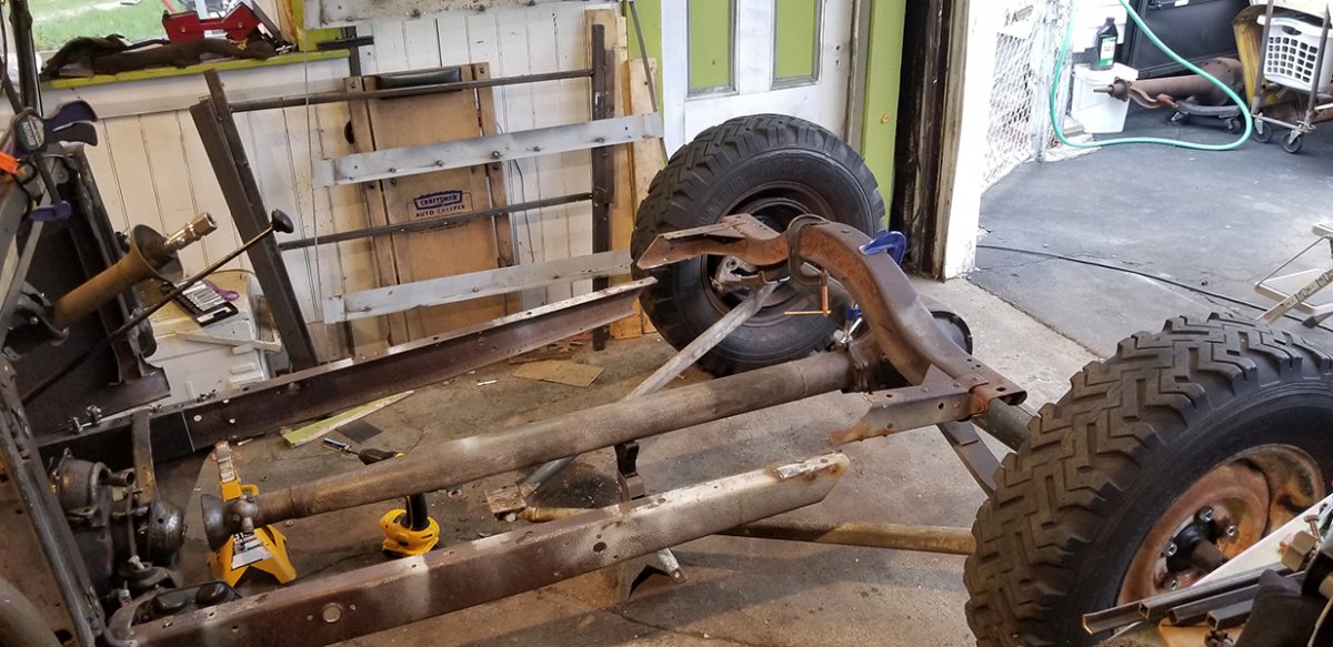

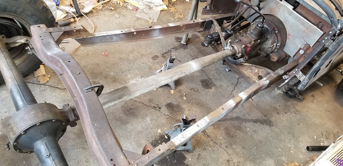

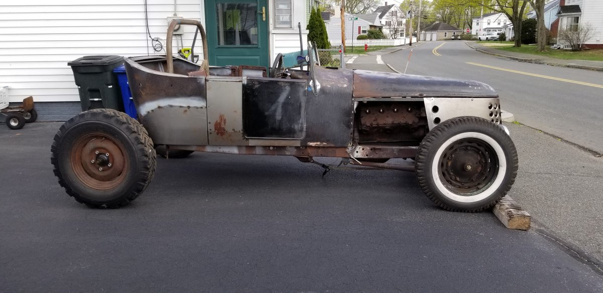

    OK, SO, I tore my body down and dismantled my subframe, which I had put together a little better than I had thought so it took a lot more time and cutting than I would have liked.
    I cut the rear crossmember loose and pulled the torque tube. Then I dropped a new rear crossmember on there that I got from @'54Caddy while picking up YET ANOTHER PROJECT CAR (LOL), which saved me a lot of h***le.
    The pictures don't really show it very well, but I'm now sitting down another 2.5" and the rear end has been pulled in about 6" so the rear end & axles are about even with the tip of the tub.
    Next up is to get this setup secure enough to roll out and see where I'm at before I drop and kick out the front axle or work on the subframe again.
    20190501_151650.jpg 20190501_155858.jpg 20190501_163426.jpg 20190501_163438.jpg 20190501_175304.jpg 20190501_181127.jpg 20190501_184222.jpg 20190504_171016.jpg 20190504_171110.jpg 20190504_171922.jpg

    Probably too late, but if it was mine I would move the front wheels forward a little, and move the grill shell ***embly back a little.

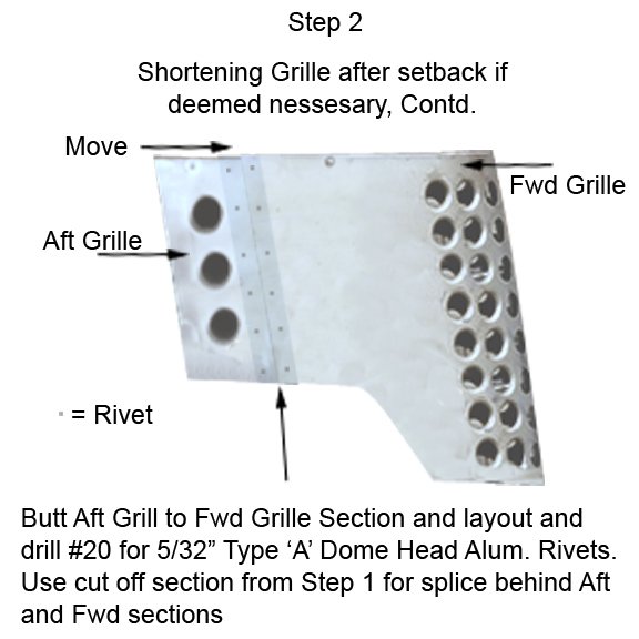

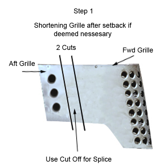

    :rolleyes:...If you click on the thumbnail, then click the arrow (or pic) you can cycle the changes made...
    Which involves moving the grille back and shortening the hood 3-4" and moving tire/axle forward 1-2" and t******* aft grill with holes to expose more engine bay after moving it all back...;)

    image.png The pic with the nose moved back looks way better!

    @patmanta furthur to suggested change should you consider it might entail modding the grille as moving things back 3-4" may cover the engine bay more than you would like so you could cut and splice like so retaining the lightening holes you introduced while still looking p***able and retaining your Original Grille.
    Then there's the Hood...:eek:...Anyways your call in the end...nobody including myself said creating was
    not without challenge...;)

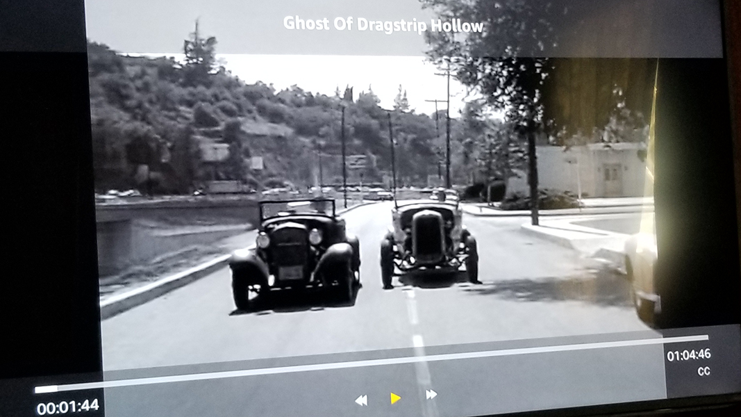

    Also this weekend, I watched The Ghost of Dragstrip Hollow. It's streaming in full on Amazon Prime, FYI.

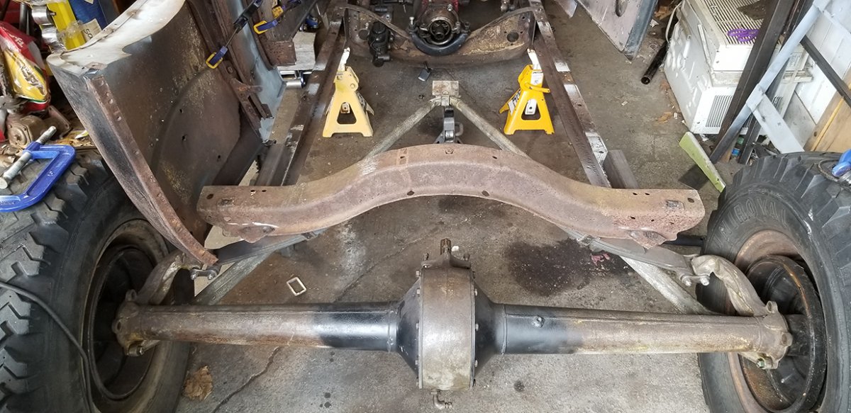

    I reinforced the rear kick with some brackets I made (not pictured). They're tacked on for now; I've gotta put my 0.30 wire back in the machine before I finish weld them (I really should have done that before I started but I was too antsy to get going I guess).

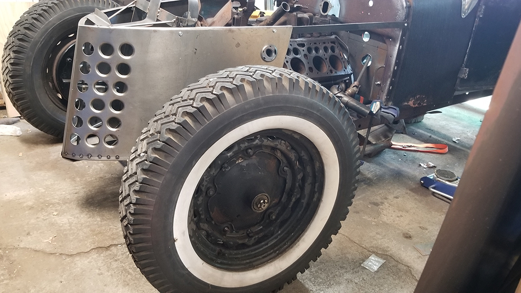

    Then I moved up front and started playing with the stance up there. I got it set up one way with the perches I got from RJays about 7" back with the spring I had (which is obviously too long for this).
    The stance looked pretty cool, but, solve one problem, make two more. The steering geometry isn't ideal and the pitman is deep in the red zone as far as scrub line goes (I'm talkin like <2" off the ground). So, that's going to be a challenge. Moving the cross steer box and switching to side steer both present new challenges. This is a bummer because I had my drag link totally parallel before, LOL.
    oof!
    Actually, it's more like THREE PROBLEMS because I don't think I can run my old sprint car radiator anymore because it's in the way now. I'm probably going to have to rework a Falcon/Mustang radiator or one of those chopped 32 aluminum jobs off ePay. I seem to have about 20-21" height and 17" width to fool with and keep clear of things. I cut off the cage I made for the old one too.
    20190801_182022.jpg 20190801_182030.jpg 20190801_184803.jpg 20190801_190332.jpg

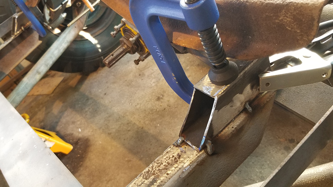

    Here are my kick up brackets in their tacked state. I need to switch my wire back out to 0.30 before I finish weld them.

    I've been struggling a bit with this build lately; starting to wonder if I will ever see it run let alone drive it. Mostly because I keep having to make fairly significant changes in what I was hoping would be the beginning of the home stretch.
    I'm also starting to doubt myself on the nose design. I'm worried it's not going to really work when the car is all together. It's also the major feature driving a lot of these drastic changes. The wheelbase would be fine as it is if I just threw a 28 or 32 shell on there and called it a day.
    BUT, Saturday I powered through some of that self doubt to get a few hours in on the ol Thundercasket.
    I put the body panels back together on the new subframe and discovered that this is indeed a Roadster subframe and that a roadster subframe is narrower behind the doors and back than a Touring subframe which was a deflating realization. I'm going to have to come up with a solution for that now too.
    Moving back to the front end, I came up with a bit of a solution for that problem area. Since I'm having trouble finding and fitting an off the shelf radiator and the spring behind setup seems to be problematic, that told me that the area to focus on was the front crossmember.
    If I buy myself a couple inches of radiator drop, I'm in good shape. If I suicide perch the front spring, I can run spring over and my dropped steering arms should still clear safely. I have not finalized my design or started much of any fab or deconstruction, but here is the basic idea:
    I'm thinking I will put in an engine cradle crossmember under the engine mounts to hold things together while I work on this AND to stiffen the front end a bit. I am a little concerned about a little bit of flex under weight I have observed which this should remedy. I've got a piece of the original touring car's running board crossmember I'm thinking I'll use there.
    Then I will remove this and reset the front spring setup.
    Then I will install this 3" angle iron in its place and give it some sort of perch setup. I am working on ideas to make that happen now but here is the general idea.
    I'm taking some notes on the Hinman Roadster's setup, even though this mockup and setup I've got is not an exact ****og.
