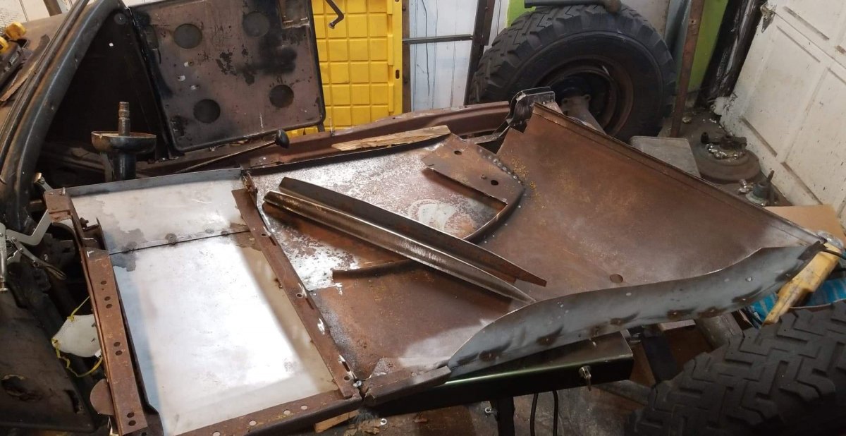

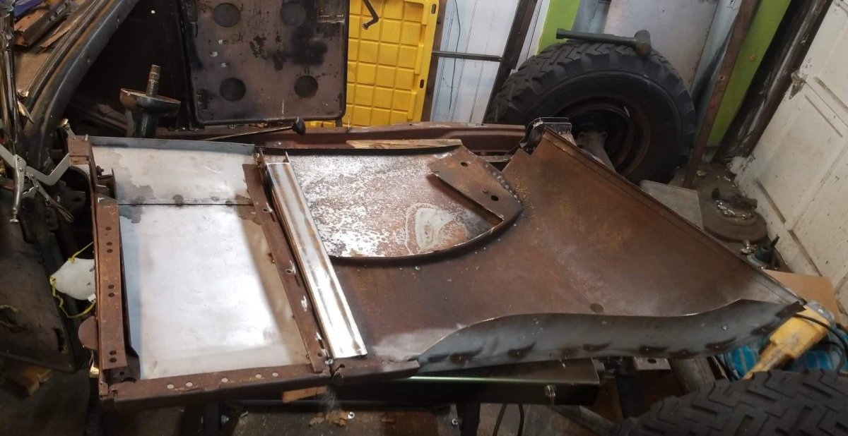

    SO, FINALLY got a bit of good time back in the shop after weeks and weeks of other things taking up my time. Halloween was good but I'm still cleaning up from it outside. I took the week of Thanksgiving off to give myself some ME time to putter around on my lawn tractor and work in the shop. I did get a couple bottles of propane this weekend and fired up the heater in there.
    So, on to what I actually did. Mostly it was a lot of moving things around and staring at the car but to get there I finally finished what i was working on when I left off, which was tacking that angle iron on and putting the spring over setup under it.
    I'm not over the moon with the results immediately but it's pretty close to the limits of what I think I can do without moving the steering box or going back to a side steer setup. I'm not down as low as I was with the spring behind setup in the existing crossmember but I'm forward a good amount. I am going to wheel this beast out and LOOK before I do anything else this time.

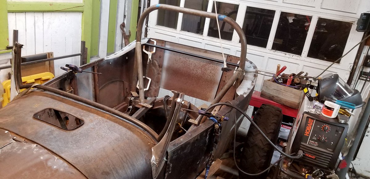

    Well, I tore the car apart and cut on the nose some.
    The subframe needed to be ATTACHED to the frame for me to get anywhere, so I spent most of a day nudging, bumping, and measuring until I got the subframe as centered and located as close to where I thought it belonged and put some quarter inch fasteners through the frame to lock it down for now.
    The nose was made to sit on the 32 style crossmember, so I had te relieve it to fit over the straight crossmember. So I did an OK job on that for now. I have been mulling a rework or a total remake on my nose lately anyway.

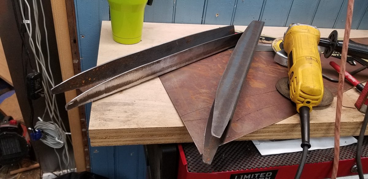

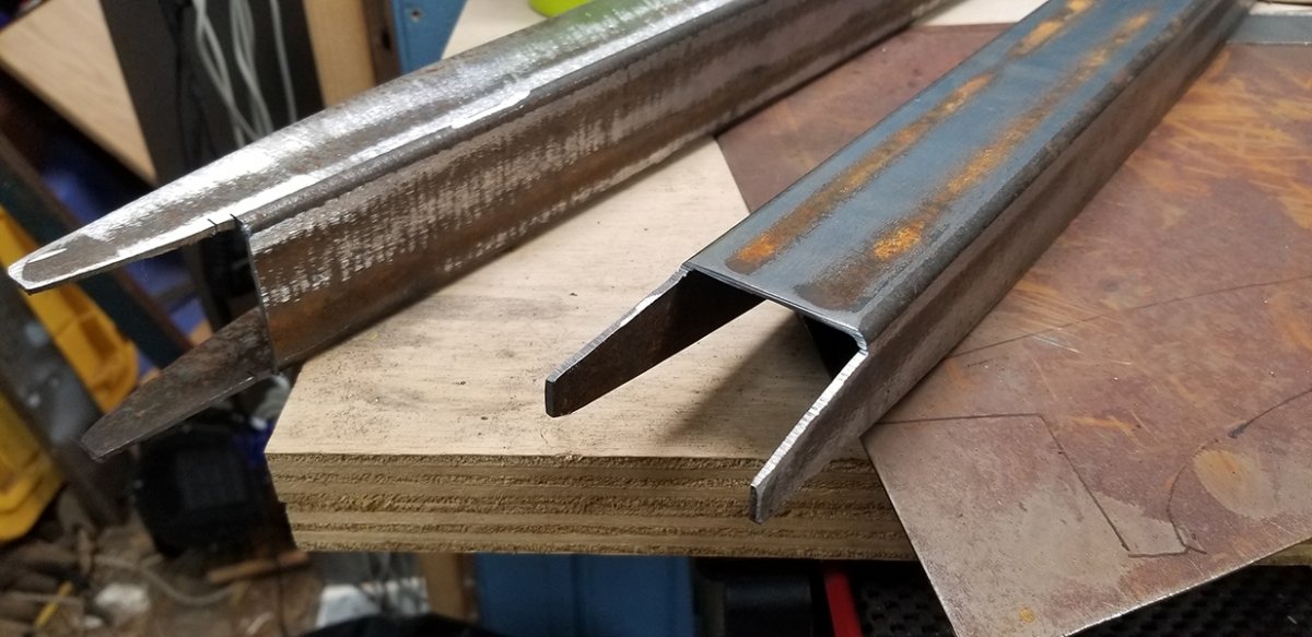

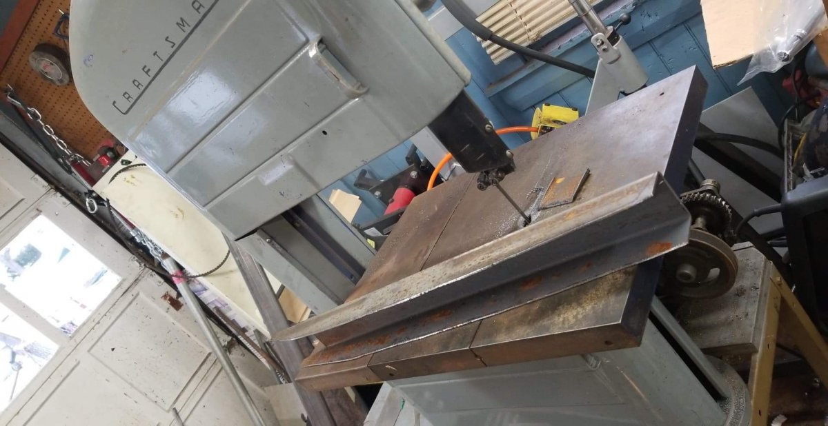

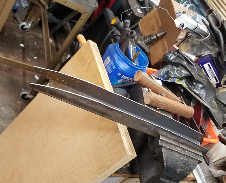

    I've finally gotten some work done that I'm happy with and should advance the build considerably. Having something other than a bunch of floppy panels held together crooked with clamps has been a pox on this project for years and I made the decision that I needed to get that under control to get any further. SO, I made up a template, got my band saw back in action (I ended up having to make a tensioner knob for it), put up new shop lights, and set about cutting on some 2" box tubing I've had for ages.
    20200201_163652.jpg 20200201_170123.jpg 20200201_170131.jpg 20200201_170142.jpg 20200201_174203.jpg 20200201_174211.jpg 20200201_174217.jpg 20200201_174231.jpg
    Originally I was going to make one and cut it down the center to give me two but I liked how sturdy the piece felt that I made a second one to match. I'm pleased with the level of precision I was able to get on these. They are close enough to identical to give me a good shot at some semblance of symmetry on the body.
    chryslerfan55 and OFT like this.

    That is major progress and nice work. I love tools! Symmetry ? You can't see both sides at once. Don't get picky now. :rolleyes:
    chryslerfan55, OFT and patmanta like this.

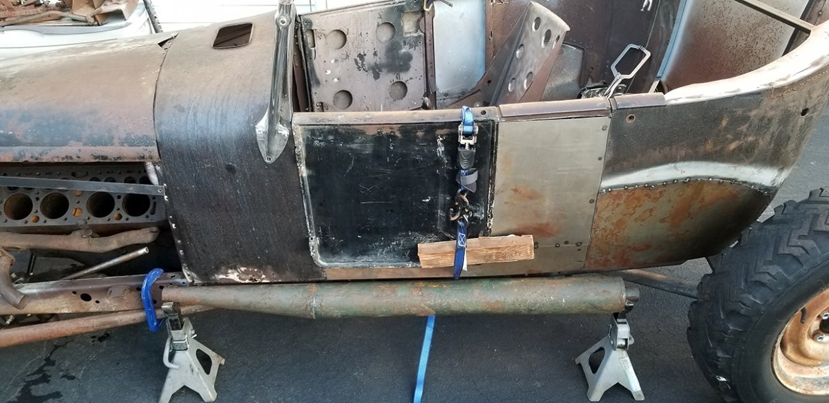

    I have started trying to put the body together. It is a challenge, but I haven't been outright defeated. I have one side on where I think it looks right.
    I started mirroring my work to the panels for the p***enger side so I can get everything working together. Hopefully I don't need to section the rear panel I made to get the width right.
