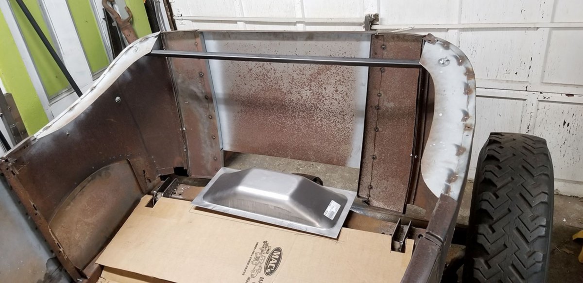

    It may not look like much change, but this picture is more about what you DO NOT SEE than what you do; there are no clamps holding the rear panel to the rear quarters in this picture. It would have gone a lot quicker with another set of hands but I got it done within the allotted amount of cussing and time.
    Also pictured above is the Model A crossmember hump cover I scored on clearance through Mac's/Ecklers. This will save me a bunch of time and gives me a good starting point to wrap my head around what will become my trunk floor. I also picked up some floorboards at the same time. They came in a bit wide but I'll take that over too small. I think I may end up cutting the slots out entirely and making a steel plate for the pedals to p*** through once I take about 2" out of them.
    Other than that, I cut the day a little short to go on to other things but I spent some time starting to think about a rear nerf bar and fuel tank placement. I determined that one big cab-width hoop would look stupid. I'd need to come out at least 2' from the back of the cab to clear the tires and that won't look right. So I'm thinking of a narrower bumper back there, possibly a sprint car front bumper. Other ideas are an oval bumper set vertically run about a foot off the rear end center and/or a couple T-bars run off the axle housings like the Carillo Roadster had.

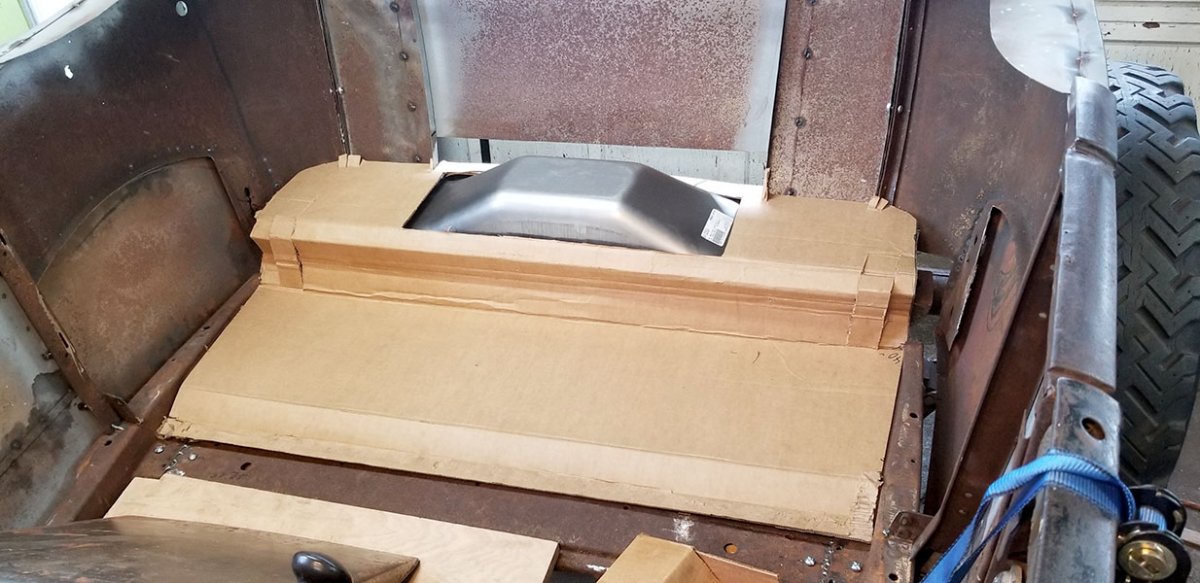

    No metal work lately but a lot of work in wood and cardboard leading up to more of that. I got a rough template started for the floors in the back of the body. It looks to work out that I can just go up over the rear crossmember brackets I made and be at just about a perfect spot for the Model A hump cover I got to sit. I'm going to make a gasket for that and attach it with rivnuts or something so I can get to the spring clamps easy if need be.
    I also started m***aging the MAC's wood floor kit to fit. This took me a bunch of back and forth with a marker and a jigsaw but I finally got the fit roughed in good enough to call it a day before I had to scoot on Saturday.

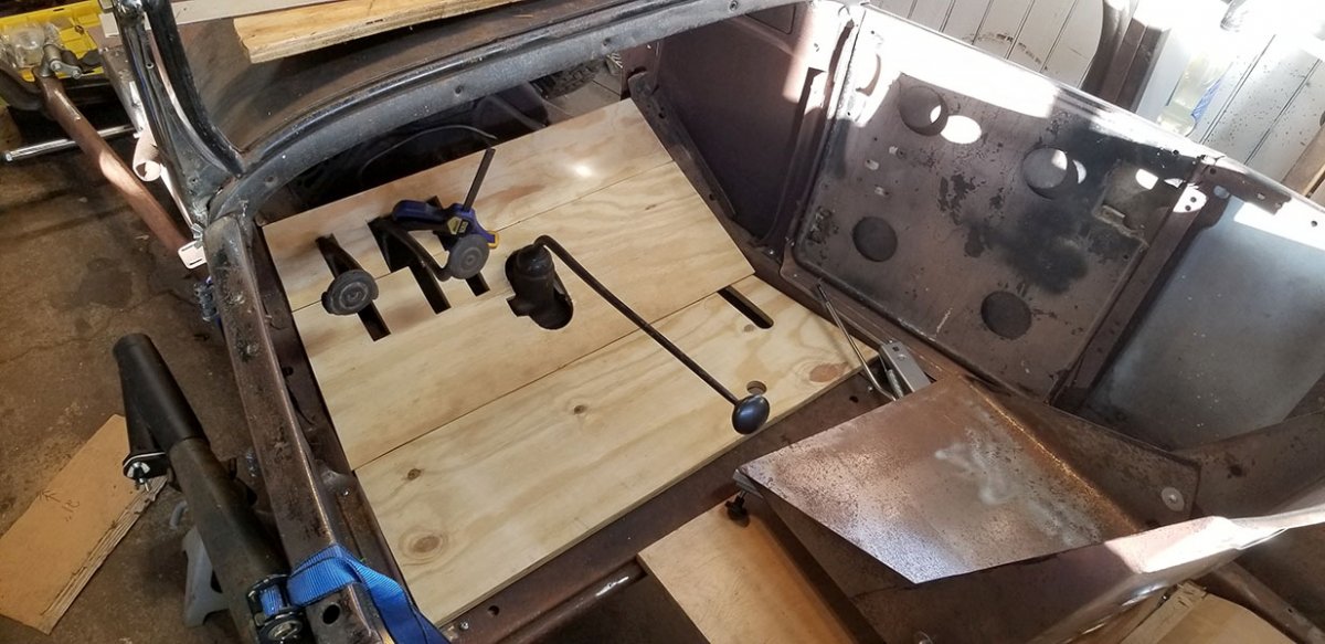

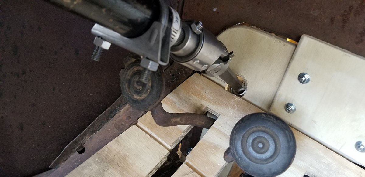

    Well I got my floor boards cut out and in the car. The trunk area still needs some thought and revision but I was able to sit in the car close to properly for the first time and get an idea of the ergonomics. Also I was able to make vroom noises.
    I found that I have a good amount of room to work with but a little less room behind me in the cab than I had expected. That's not really a problem but is a push to mount the fuel tank behind the body instead of behind an interior firewall.
    I discovered that I have room for all 3 pedals, no problem, but that I need to shift the clutch and brake pedals over about 2 inches. Otherwise I'll have the shift tower making the angle on the gas pedal awkward and putting my foot in a situation where it's likely to clip the brake pedal constantly. The pedals also need to come down a bit to clear the bell but the location of the F1 bracket is about as far outboard as it can be I think. I am not totally sure what the best way to attack this is going to be yet. I just know that I have room to the left for the pedals to move to where they will feel right and give me a clear shot to the go pedal.
    I will also need to bend the shifter a bit to offset it to the right some. 1st gear wants to be somewhere inside my right leg at the moment. Second (pictured above) and third are good to go. Reverse is a little snug up on the wheel zone (which isn't mounted in the pic, just on my knees).
    Getting in and out is probably always going to be awkward but I don't want to start the body over again to make longer doors. I am kicking myself a little for not just sectioning the front and rear doors together to make the body this size and if I ever build another one like this that is what I am doing.

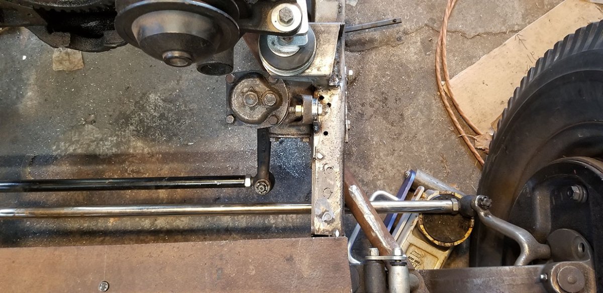

    OK, so, incoming 2 months of progress here and on the truck build. I've been working from home since the middle of May and I gotta tell ya, it's been an enormous quality of life improvement on its own other than the cir***stances. I actually have the energy and desire to do A LOT so that's what's been happening (even if I'm still a bit slow).
    Where to begin, OK, so, I finally fixed the steering box location to get parallel and above scrub again.
    Hacked the **** out of the motor mounts I had made in the process. I needed to be higher anyway so I used a set of @rottenleonard mounts I had that clear the steering box and sit 2" higher to eliminate the extra spacers.

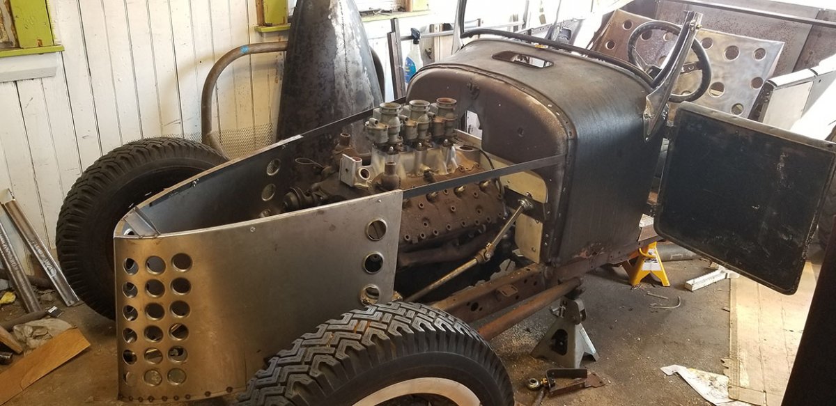

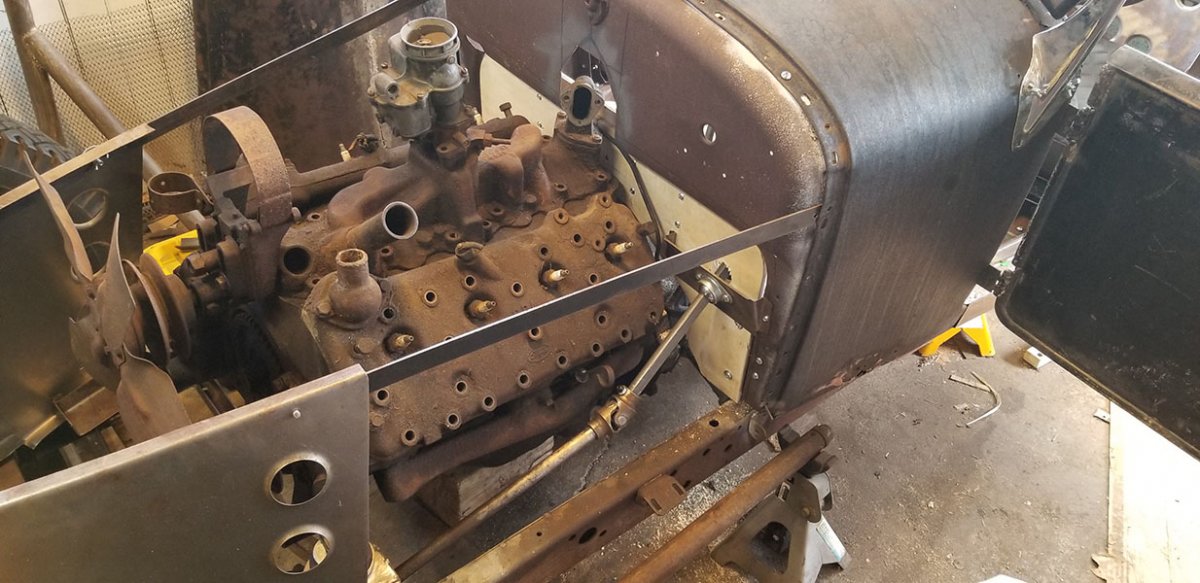

    This week's efforts have been to make a firewall in order to further develop the steering run. After failing this task twice last year with steel, I used a couple s****s of the plywood from the floor. I'm pleased enough with it for now. Maybe this is the firewall, maybe it's a template for a sheet of 16ga when I can get some, who cares, right now it makes it so the steering seems to work and I can build around it until I make that decision.
    This fits in the pocket under the bulged area on the 27T firewall and around the block to bellhousing interface area.
    I made it in 2 pieces because I had s****s close in size, I didn't think it would go in as a single piece (it does), I thought it would be easier to mirror the sides, and I expected to fail and s**** it (I did not).
    I was able to re-use a bracket I had made for an earlier failed firewall. This will probably get flipped around and over to the inside later. For now it is performing its function.

    Now able to get the steering shaft angles under control, I am working on the second point of contact for the steering column. I whipped this simple plate out yesterday while being lazy and having an early beer-o-clock. I opened up three existing stock holes on the firewall to mount this piece of 1/8" plate. I am thinking I will run 3 pieces of rod stock from this to the U clamp there and another to the dash.
    Feeling like I had done something, I wanted to play a bit so I dropped the triple on there with a couple hats to see how much hood will need to get cut. I'm OK with it.

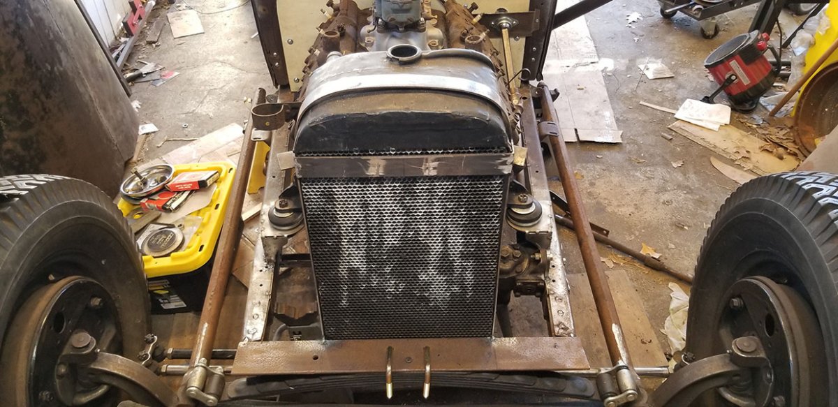

    Cut up the old radiator mounting cage I made years ago to press back into service on the #thundercasket the other dayyy.
    Remember this wonky old thing? Well I liked the part that actually came in contact with the radiator, so I liberated it.
    Tacked it in and surprised at how well it MIGHT work though it is going to be TIGHT. Squeezing a fan in will be a challenge but the numbers seem to indicate that I will clear. Going to need some flexible hoses for the water and vapor to this old sprint car radiator for sure.
