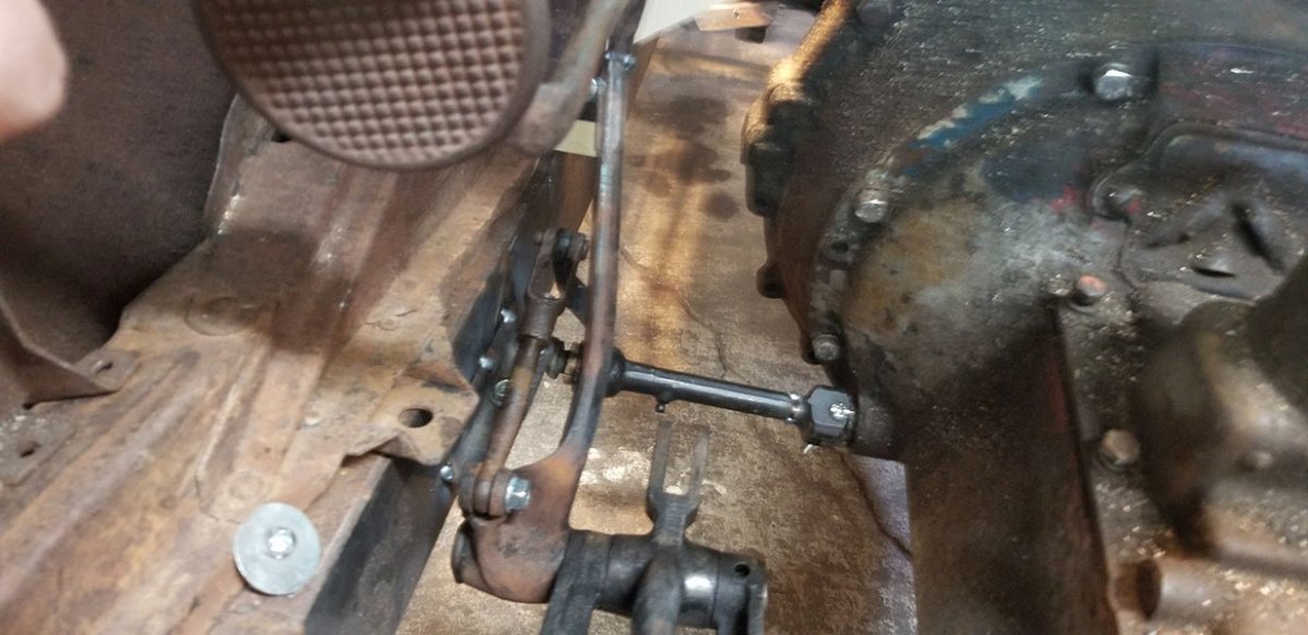

    I played around with a similar set-up for the clutch actuation, but then went another direction. I saw a pedal ***y that moved the actuator to the right side of the pedal ***y and it looked like a sweet set up. Then I priced a reproduction of said pedal ***embly and decided there had to be a cheaper way to do it.
    First I took the clutch pedal and cut the tab side off the pedal side. That way I could use the same shaft. It has to move in the framework now though, so I ordered some new bushings and will ream out the frame to hold them. That may be overkill? I don't know. Here's the basic set up shown after splitting the pedal.
    That moves the actuator tab closer to the transmission.
    That allows me to use a different shaft in the transmission and run a more direct set up.
    Pictures aren't so great and I haven't got all the angle set up yet but I think it should work

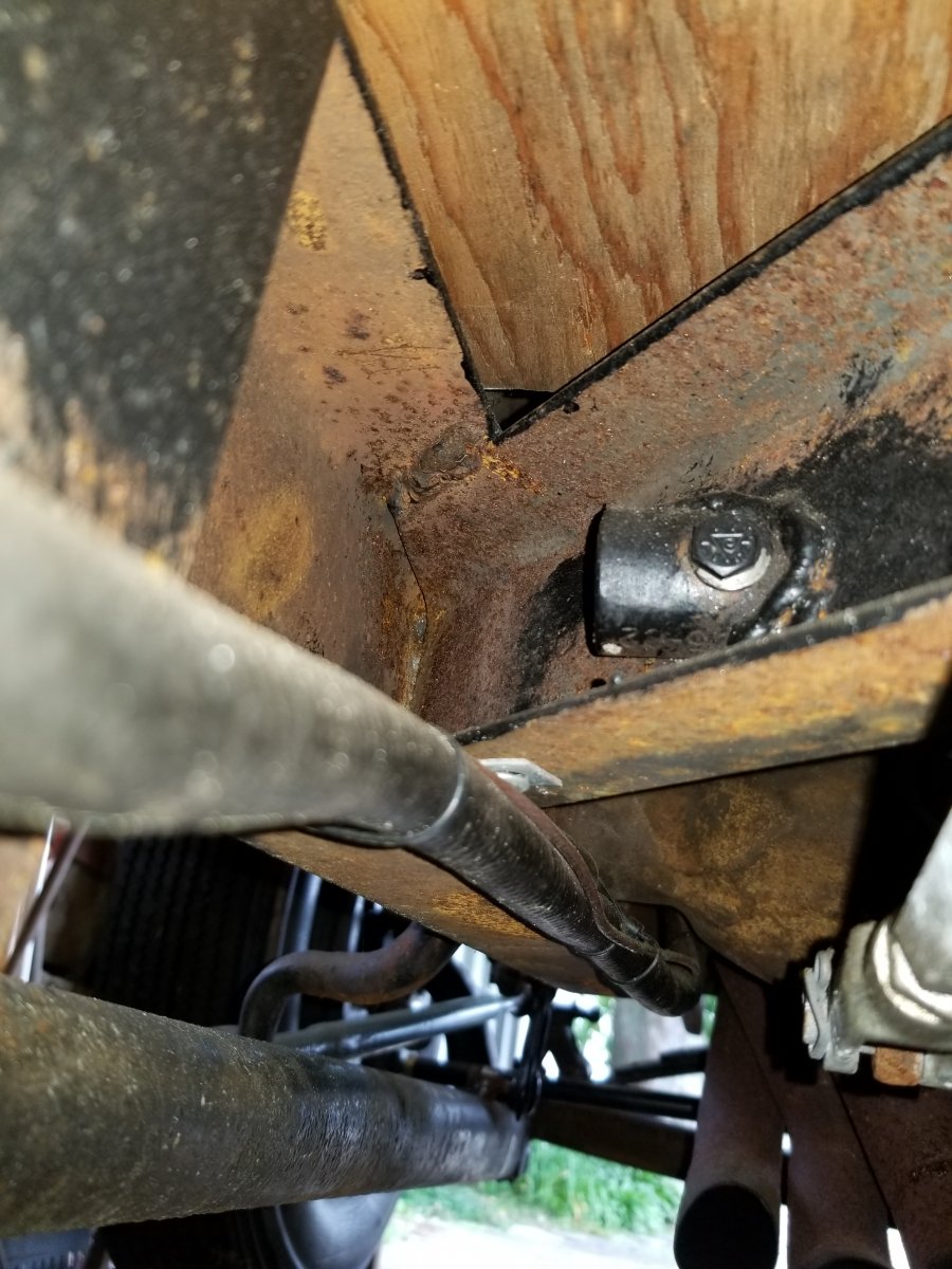

    That looks familiar. I think I've seen this in your build thread. I'm curious to see how this works out for you.
    I like how you notched the subframe to get a fastener into the frame there. I had not crossed that bridge yet!

    Hey Pat, nice progress on the casket. When I put my pedals together I realized that you do not need much "throw" on the clutch pedal for it to actuate. Just a heads up. . . I remade mine a few times before they worked. For me this was the hardest part of my whole build.

    The funny thing is, I've since added a tab on the frame so I can go back to using the original hole.

    Thanks, Ron! Yeah, that's lining up with what I am experiencing and being told. My neighbor came by to look at the builds on the 4th while I had the car out in the driveway in the sun. I told him I wasn't quite sure where to focus next and he said I needed to get the clutch pedal set before I could figure the rest out (ergonomics, etc.).
    Yesterday I was out there mounting the pivot and discovered how difficult thos was going to be pretty quickly. Once I had everything lined up I discovered that, in fact, I did NOT have everything lined up and I will need to torch the clutch pedal arm back because it's going to interfere now. I also had to find and order an offset clevis yoke because the clutch rod does not line up with the pivot on the pedal anymore.
    I don't think I can do that on mine because of where my body sits on the frame. Those holes come in on the edge of the frame. I'd have to cut into the boxing and put a pipe in or something. How did you do yours?

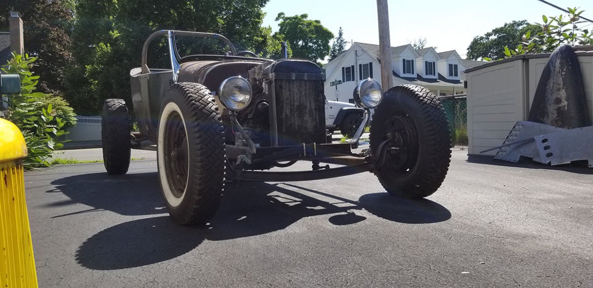

    On the 4th, I decided that I'd get the car out in the sun and get some pictures to see where I'm at. I discovered that I need to do a lot of fine tuning to get this nose and hood cleaned up. The hood is lumpy and the nose seems off and crooked now. This is going to take a lot of time, so this will be getting moved to the Stage 2 buildup of the car now unfortunately. But here's the pictures, including the new roll bar placement, over the rear crossmember, and the fuel tank mockup. I borrowed the vintage stanchions and lights from the AAVA to stand in here; they are not staying.
    20200704_155204.jpg 20200704_154743.jpg 20200704_154658.jpg 20200704_154644.jpg 20200704_154633.jpg 20200704_154545.jpg 20200704_154528.jpg 20200704_153329.jpg 20200704_152747.jpg

    My frame isn't boxed so I just added a half round tab (to match the shape of the rubber discs I'm using to adjust heights) and drilled a hole.
    I don't recall why I did it now. May have been to get more space for the clutch actuator, which I've since moved also? It's always something.

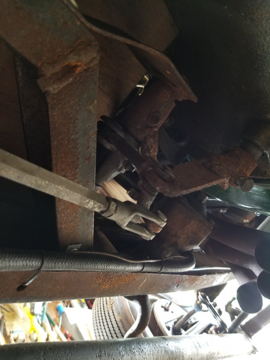

    OK, so, you're pulling the clutch lever up instead of pushing it forward there?
    Gotcha. I just welded a piece of angle iron inside the frame rail with the pivot bolted on to it. My pedal ***embly has been moved inboard though whereas yours is in the stock location if I am not mistaken.

    Absolutely, I do too. But I am not entirely pleased with it the way it sits now and I don't want it to push back the FIRST DRIVE DAY back while I struggle to get it just right. I may end up redoing it entirely.

    Thanks guys, I appreciate it. The nose and hood are actually all steel! And the hood is lumpy and a possibly a little crooked and definitely bowed. And the nose doesn't track the way it was intended, looks crooked now, and needs to be re-worked if not re-done. I may chip away at finding a solution to fix it on days that I want to work on something lightweight here and there, but I need to knock it closer to the back of the to-do list for now unfortunately.
    And I will definitely not call this car "done" until I get it to work or make a new one like it. Don't worry.

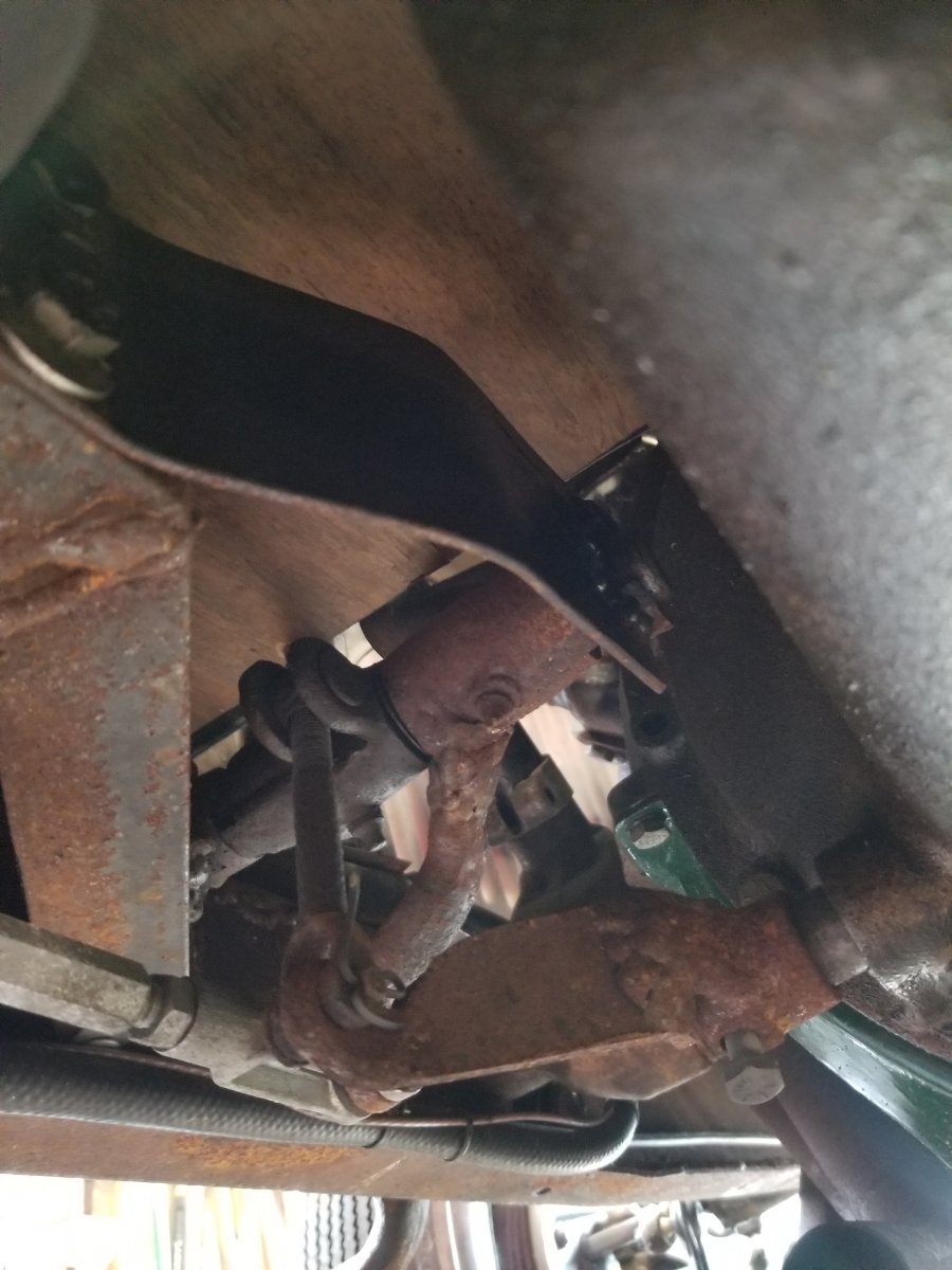

    OK, so, the realization that it is time to deal with the engine is now fully upon me and I am feeling unprepared for the moment. The main issue that makes this a problem is that I have yet to be able to get the engine CLEAN. In the beginning, I wanted to avoid hot tanking it and just swap some components after a quick degreasing. I didn't do well with oven cleaner. I haven't tried Purple Power yet but a lot of this is caked on, waxy, oil, dirt, & Carbon buildup. I'm not sure how far I can get with a power wand with a soaper hooked to the garden hose and my hot water tank.
    Then there is the issue of the Clutch! I have the original 11" clutch out of the 37 big truck and the big 4 speed. I need to hook up to the 39 transmission somehow and I am under the impression this won't entirely work and even if it does, will be a beast to run with these shortened pedals. If I throw money at this, what would I get from, say, the Speedway catalog?
    I was able to solve one issue at least. I had ordered an offset clevis, but when it arrived, it did not fit, so I had to shorten a different clutch arm to get lined up. Unfortunately, even though I set it to the exact same length as the one I replaced, I am seeing the bushing peeking out about 3/16" so I am figuring I need to put some length back into it or put some offset into the pivot ball. But that has to wait until I get a clutch in there so I know the setup is appropriate.

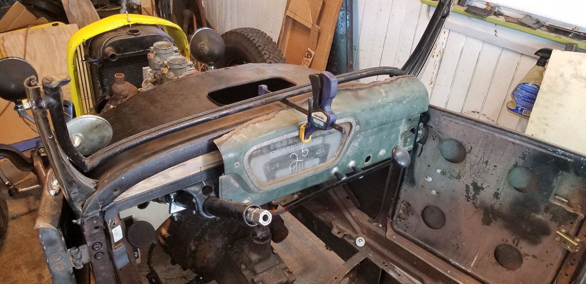

    Once I hit that particular wall with the clutch and engine, I spent some time playing around with the F100 dash that I would like to incorporate into the car. I did some dis***embly and cutting on it, which helped me clear my head. I do not think I want to graft this into the cowl like it looks like I am getting ready to do here; that's just the easiest way to hang it on there for now. I think I want to go more flush to the cowl and maybe do a bolt in mounting when I get around to it.

    So much going on! it's good you can move from one thing to another to keep it moving. I like the dash. No one said it was going to be easy. :eek:

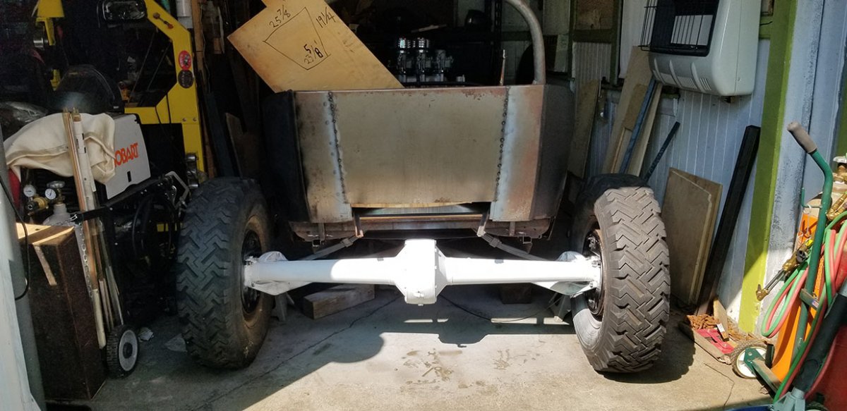

    Did a lax cleanup and paintjob on my rear brakes then laid a rattlecan coat of white on the rear end and bones to see if I like it. I like it.
    Also got a 10" flywheel from Prewarandmore and a matching clutch setup from Millworks Hot Rod yesterday. Now I can install that, allowing me to dial in my pedal setup and check that off the list.
    Once that's done I will need to pull the engine to clean it and do my rebuild.
    Gotta rebuild the front brakes at some point too. At least those plates are nicely painted already.

    Yes, my clutch pulls instead of pushes.
    I also run an 11" truck clutch with a 39 car transmission, it all went together fine. But I see you have a new set up so that's a mute point.
    It looks by your pictures that you are pretty close to making the pedals work, just need a couple fancily fabricated arms.
