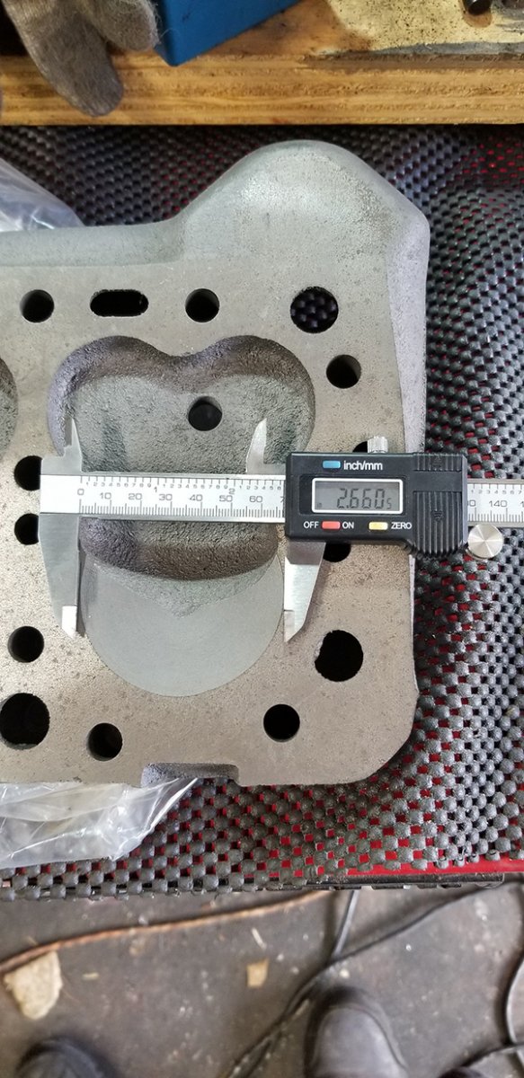

    UPDATE! As I mentioned over in my old engine thread (MY FIRST FLATHEAD... NOW WHAT?) after a partially successful yet gone otherwise horribly wrong cleaning of the engine, (I ended up pressure washing the block and made A MESS of my driveway), I took the engine and rotating ***embly up to Powerplay Engine and Machine up in Wilmington, MA for a shake n bake, magnaflux and then to address the snapped head stud, cylinder hone/bore, rotating ***embly work, balance job, etc.
    This all has me re-thinking the 8CM cam and wondering if I should just put something much more aggressive in there since everything is apart and I am throwing money at it anyway. I'd like something that can be driven on the street but doesn't have to be super comfortable as long as I can get my little 1500lb car down a 1/8 mile compe***ively. Any suggestions?
    And I took a look at my EAB heads too. I'm not really sure where to measure for valve clearance on them. I found an old post by the late great Brice Lancaster that advised to just run the heads and cam you want and cut them for valve clearance and another old post from @286merc saying he'd used a few .365 Schneiders. I have, up to this point, been looking for cams that come in at .338 (8CM) or less but that rules out some of the more aggressive cams I'm interested in looking at like the Max-1, 400jr, Thumprs, All but a couple Schneiders...

    Measure for valve to head clearance over the valves. Not being funny. There are no piston to valve issues. Make sure that you have enough clearance twixt the valves n head pockets, + around the perimeter of the valve edge. Unlike ohv mills, flathead intake flow goes around n over the valve head. IIRC, in an article in 1001 Rod & Custom Ideas, Ed Winfield described the method of using the "valve curtain area(block seat to valve face @ full lift)" to define the area over the valve needed for proper breathing. It does affect comp ratio. There are a couple of decent books out there that describe some decent theories & past/current practices.

    One thing to consider. I was going to use EAB heads, but when I test fit them, the new domed pistons that I was using hit them. Using flat top pistons would cure the problem, or have the head machined.
    Just another thing you may run into while putting it all together.

    I got pretty wildly varied measurements in the valve pockets so I am not sure what is going on with these heads. I also found that the dome reliefs are not consistent in size so I am now wondering if these were done wrong by the shop who sold them off on Ebay to me years ago.
    This does not seem right to me unless I am missing something:
    20200828_143830.jpg 20200828_143926.jpg 20200828_143944.jpg 20200828_143957.jpg
    I went with an Isky Max-1, Zephyr springs, and some Johnson hollow adjustable lifters. You nailed the plan otherwise.
    Were you using Egge pistons? I have read that is a common issue with EAB heads and Egge. I was looking at Offy pistons or possibly re-using the stock pistons I have since they are in good shape. I'll have to cross that bridge when I come to it though.

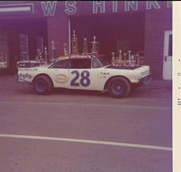

  7. I am running Egge pistons in the race engine (261 Chev.) if I was turning 10,000 of 20 laps every Saturday night or going for a land speed record light wight forged would be in order, but for street use or a few times a year low R.P.M. racing I don't see the need.
    Bill Roese won a lot of races in this car, 312 Y-Block with cast pistons, running against 327 Chevys with forged pistons!
    My father crewed on this car
    chryslerfan55 and patmanta like this.

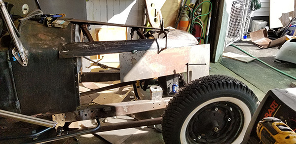

    While the engine is still off at the spa and new parts are trickling in, I am tuning the body up and trying to figure the hood out (more on that later).
    With the engine out, I am now able to brace the frame up a little better. The weight of the engine and the tall mounts act to twist the frame rails quite a bit, so I have been intending to use this piece of Model T running board brace as a cradle type crossmember under the front of the oil pan behind the water pumps. I like the look; I just hope it holds up.

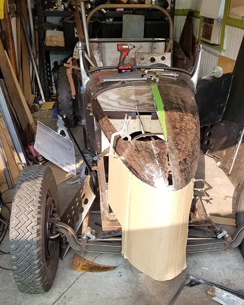

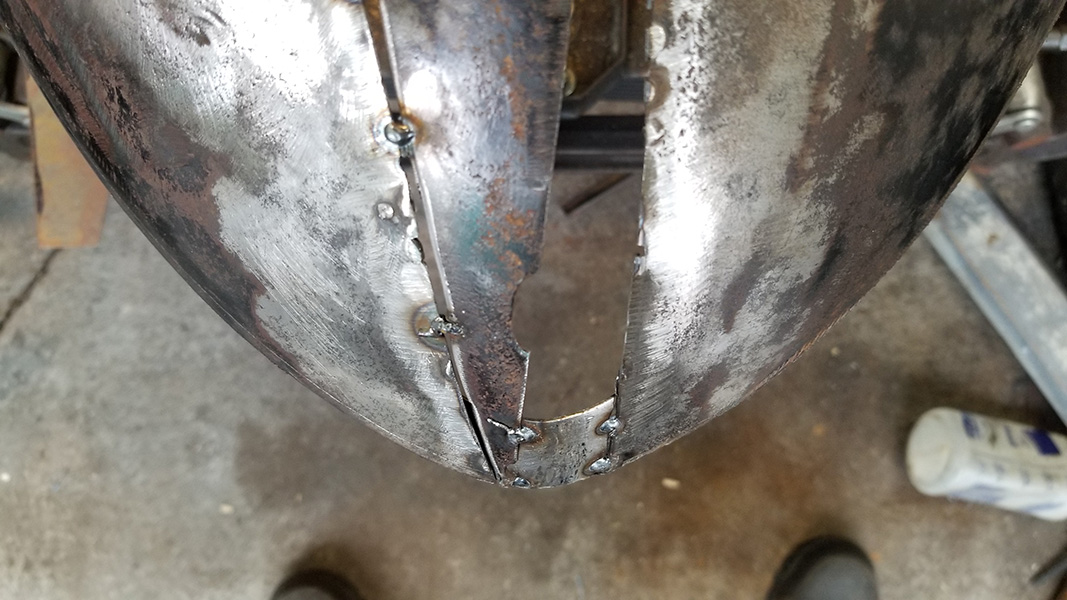

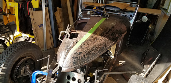

    Let me backtrack from that shot a little. I've been dissatisfied with the hood and nose for a while now and with the engine off at the shop and while tending to other things on the body, I couldn't leave it alone. SO I pulled everything off and brought out the old track nose and some tape, which led me to maybe a blister idea.
    This was doable but not really the look I wanted.
    Back to the metal hood, I cut the halves apart and cut out all the metal that was overworked and really beyond saving with my tools, skillset, and patience which happened to provide a relief for the radiator. I also cut the nose in half to be able to move it around better:
    Still unsatisfied, I drew the hood back about 3" and allowed for a gap somewhere between 1.5" and 2" that I would fill. This has the look I think and will soften the nose, which just really looked a little too long and too sharp still even after the wheelbase change. Unless I rebuilt the whole car around a pinched frame with a full pan, the original shape just was not going to work for me.
    Around this point, I finally had the sense to re-work and utilize the original structure from the hood. It took a little repair work but now I have something relatively uniform to work off of.
    At this point I finally realized that the rib at the bottom of both sides needed to go, not just aesthetically, but structurally. Each side was a mixed bag of dents, missing material, and cracks that worked to push and pull each side anywhere but flat along the bottom edge. So that's all gone now. THe sheet of steel you see here in the picture was just for a visual reference; I don't think I am going to make full sides but I'm going to likely end up making something new there. First thing on the agenda is to get this all uniform and symmetrical around the edges. I'm thinking I may lay it down on a sheet of 18ga and cut a template off the "good" side then transfer that over to the "bad" side, make them same and weld it down then cut whatever is in the way. I haven't fully formed a plan thet though.

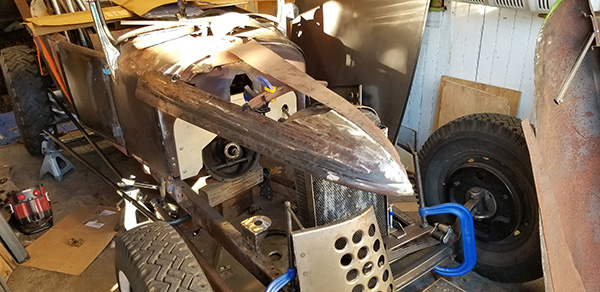

    Can't be afraid to cut things up. Can't be afraid to start over. I've settled on adding about an inch gap at the end of the hood, another degree or so downward angle, and lined up at the cowl (rather than a 2"gap and 3" shorter).
    I'm working on a template for a new nose now and I'm happier with it so far. I'm ditching the angled wedge for a mild round & straight drop instead of the jutting chin. I'm also putting another 4" of length on it.

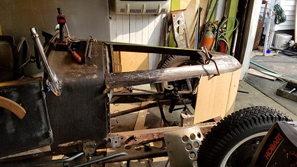

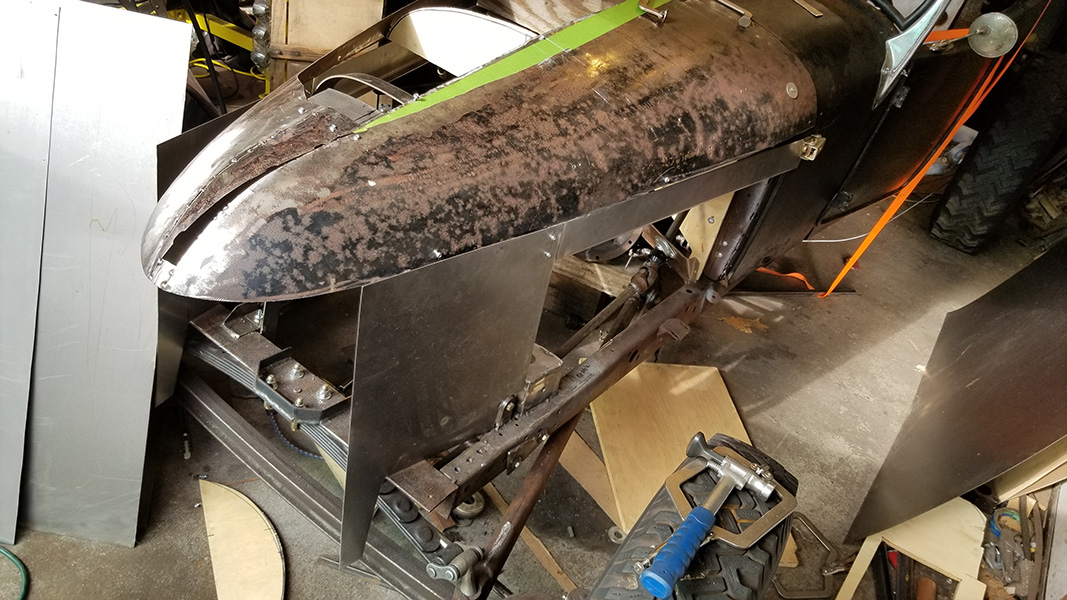

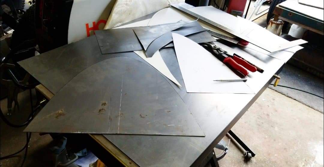

    I made some wood templates with the idea of making a buck. I'm not super thrilled or confident in the precision or symmetry but I do tend to chase things down obsessively when it comes to that. I need to keep the mantra "close enough is good enough" going through my head. I did some hammer work to get the nose symmetrical ENOUGH.
    That wedge strip probably has to go in favor of a piece I will have to make.
    I decided the cardboard wasn't entirely sufficient so I started making pieces out of 18ga before I called it a week. Now I am considering the notion that it may be easier and cleaner to just make the nose and then make a new hood to match since the two sides really do need a bit more work to clean up than the pictures show. I have plenty enough steel around to make and s**** a few new nose pieces if I don't just use/fix the end of the hood.
    In the past few weeks I also put my old cordless out to pasture in the house in favor of a new Milwaukee setup. This is my first impact driver and I gotta say, I wish I got one of these things sooner. It made super short work of this Greenlee punching.

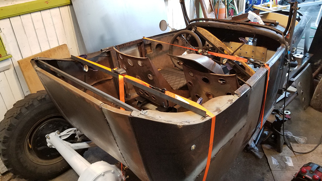

    Started by tackling the D pillars to take all the wibbly wobbly out of the *** end of the tub. These half inch carriage bolts I can't remember why I bought came in handy. I ended up cutting and notching the original pieces then simply put them together with sheet metal screws (which are my favorite thing right now, the Milwaukee driver I got makes them a breeze). Got the one side tacked together straight and the door closes flat. Working on the driver side now.
    Used these carriage bolts I've had forever which worked great. I'll probably make some rubber washers to close them up and dampen any vibration.
    Been running around the body and subframe tacking here and there. I discovered the subframe still has a little flex to it so I've cut a piece of 1x2 box tube to add a third crossmember back there which seems promising. I'll have to cut that seat frame some more to fit but that whole area needs more attention anyway to accommodate the roll bar mounts to the rear crossmember and clean up the back panel.

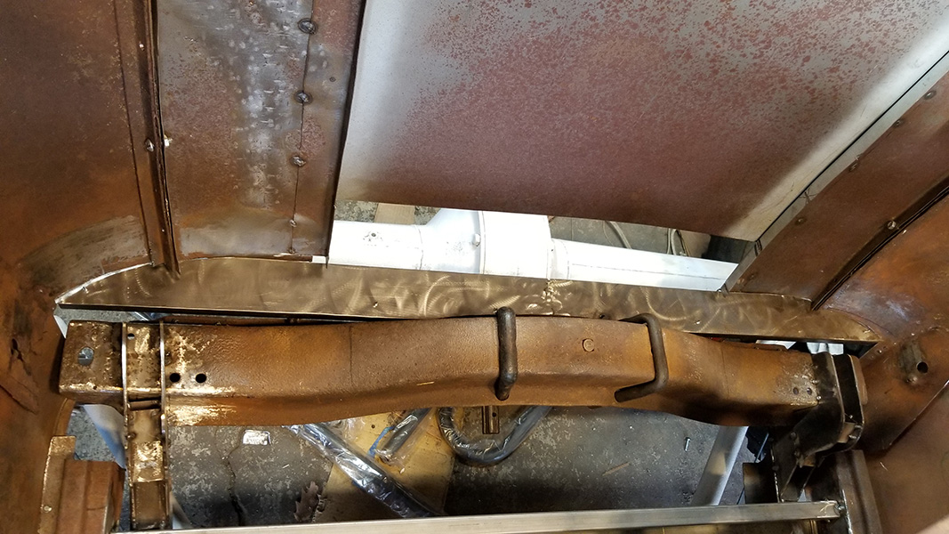

    I've been picking away at the car still over the past couple weeks. Worked on fixing the bottom of the back of the tub. Loving my new Milwaukee driver for making holes in angle iron and sheet metal screwing that to the piece I made here. The M12 die grinders are BAMF too; I highly recommend them.
    That was a tough spot to get my arm, welder, and welding helmet into so I made a few ****oos but it will hold just fine until I can get in there without all the strapping and bracing I had going to get it tacked. I had to do a lot of push/pull from outside to get it lined up good enough. I only totally missed once and blew through once. I'll take it. There is NO FLOP and very little wobble in the tub now.

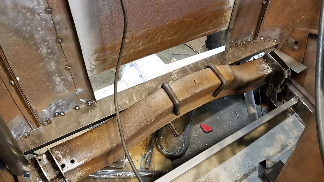

    Starting with the firewall, I got the 16ga plate welded in. I screwed up the gap filler pieces and had to cut them, re-brace everything, and re-weld it all. It was a mess. They were holding a flex in the plate that I didn't notice when I tacked it in. Then all the new welds made a mess that I had to grind out. Now I guess I will be using filler on the firewall!
    20201024_150153.jpg 20201024_134321.jpg 20201024_134302.jpg 20201024_134246.jpg
    I did a **** job welding wire around the perimeter too. I will never use 1/8 rod for stuff like this again. I have a high spot in the middle that I think I need to cut, flatten out, and re-weld that the wire certainly doesn't help.
