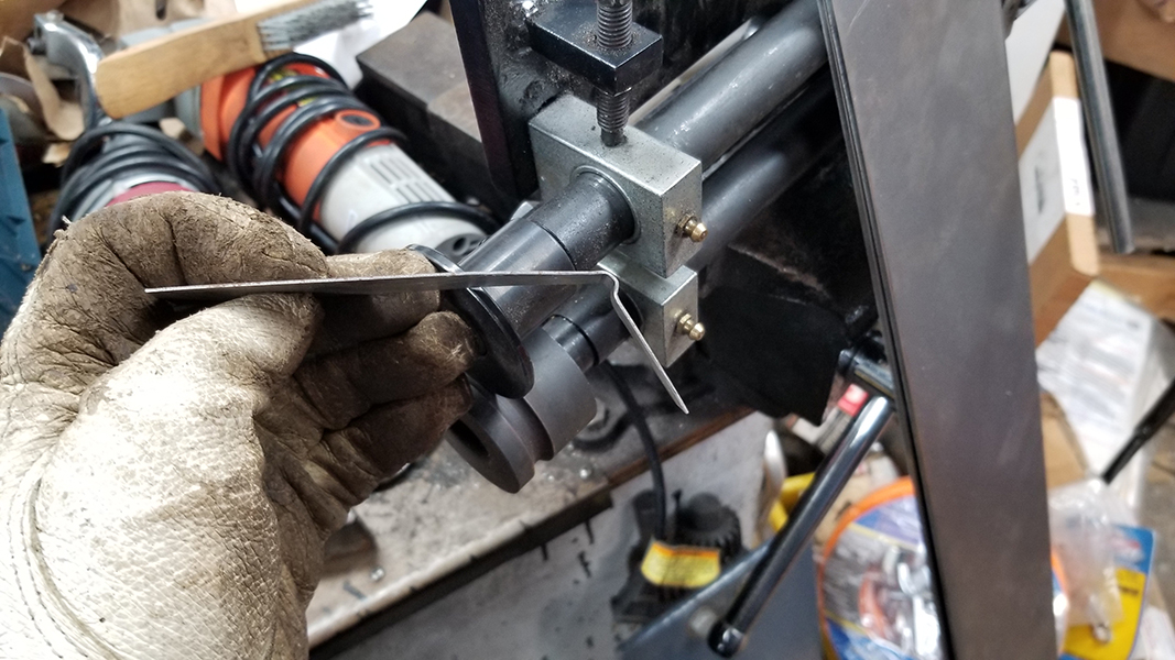

    I started working on filler pieces for the sides on my little bead roller with a small female profile and a tipping die. With a little bending and planishing to form, these came out great. I may end up cutting this one out and making a bigger piece though. What I ended up with looks like it may be good enough for filler though.

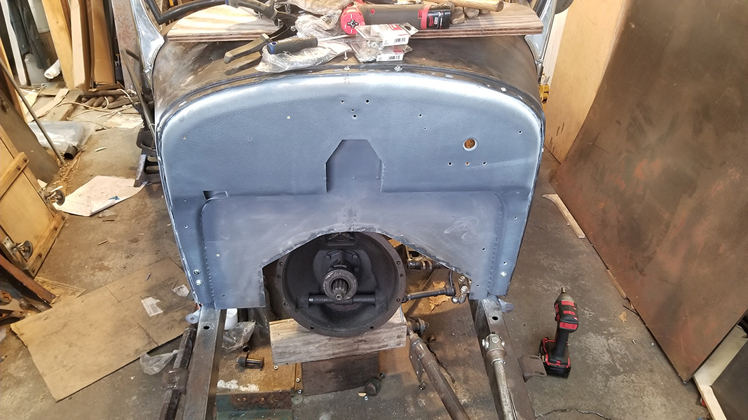

    I've been focusing on getting the cowl section straight enough for the past couple weeks. I got the firewall good enough, hit it with some Krud Cutter rust converter then a few layers of parts store lacquer primer and white paint. I left most of the new metal with just whatever overspray it got since I'm probably not done working on that part.
    Once I finally managed to get it back into the cowl I realized that the body was sitting ever so slightly off which I just could not stand. So the ratchet strap came out and I cut the tack welds on one of the body mount brackets I had made. I had left the front mounts undrilled for this very reason and I am glad I did.
    20201107_162521.jpg 20201108_122422.jpg 20201108_143518.jpg 20201108_143528.jpg 20201108_143555.jpg
    Extended one a bit then drilled them out and locked it in.

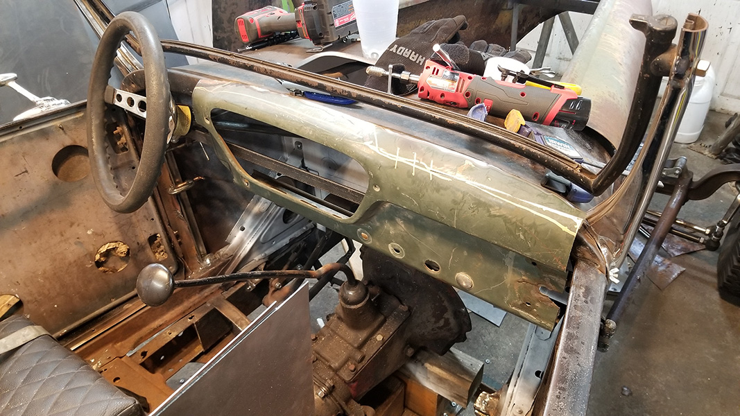

    Still picking away at getting the body sitting and aligned to a 'close enough is good enough' state and chasing out as much flop as I can. That doesn't make for interesting pictures but the dash might. I determined that the only way to mount this dash without it being a major production and have it removable is to go under and against the cowl with some tabs attaching to the original holes and a crossbar I made which will tie into the firewall and subframe. The pas. side will be shaved and tapered down to look good and I'll make the driver side to match when I have time to get back to cosmetics. For now I have a structure and know that the instrument panel fits and that the shifter clears it.
    Does anybody happen to have an early F100 glovebox?
    You'll notice the fuel tank in that first shot there. I've also been tinkering with ideas for mounting that as well as making a rear bumper out of 1" nerf bar tubing when I'm winding down for the day (ignore the plywood, that's just there to help keep the tank on there).
    I realized that I wasn't quite sure if I should mount the tank to the body itself or to the frame or if it mattered.

    I really like the dash and having it removable will be a big plus when wired with a plug so all the wiring can just un-lug for removal. I'm not as sure about the tank but think it should be mounted to the frame. I have a nice old tractor tank with a mechanical gauge that I'd like to use on something, maybe the Es*** speedster. :)

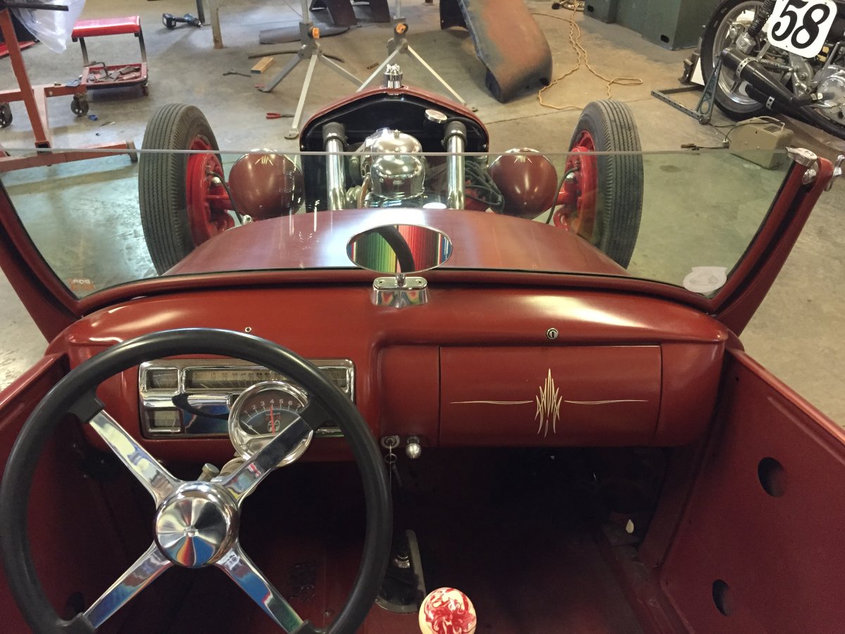

    I don’t know if you are going to like your dash down the road, I fit a 40 dash in my T modified and it really cuts down on steering column angle, foot room and pushes everything out. I would do it again if I built the car today. I’m not criticizing just letting you know.

    I'm thinking I'm going in the right direction and I am thinking I will put the fuse box behind the gauge pod under the cowl door which I think I may flip and add some kind of locking rig to for easy access.
    Thanks, I dig it :cool:
    Thanks, I'm conscious of that. I'm making the dash fit t omy needs rather than building around the dash. I have my column drop hanging off the support piece and not the dash which would put it too low for what I'm going for. I started putting the steering back together and making the new 1" seat risers today to get the ergonomics dialed back in so I know what else I need to change while I continue stiffening the body up.

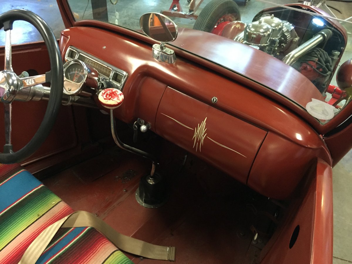

    This is my 40dash my body looks shorter than yours. It does push everything back but it looks so damn kool. DF40B871-37D2-4BC6-9E66-1979C093402D.jpeg 2D467749-7625-4294-BACF-42491370AD7B.jpeg 408D91E0-AD78-4AB5-8378-B1DBBE7784A8.jpeg

    Thanks for showing me these, I have always admired your car! How did you handle your floor and kickboard area? My floor is a mess still and little better than some s****s of hacked up plywood. It's starting to bum me out which is, I guess, part of what comes with a project dragging on so long.
    Correct. the F1 column drop I'm currently using (and may replace) is suspended from a piece of 1" angle behind the dash that runs just under the door tops. So my column is sitting 3" or more higher, roughly just under the speedo on that 40 dash. My F100 dash is also set close to flush against the cowl rail. I trimmed a lot of it back to make sure it wasn't in the way and also to remove all of the flame cut edges on the piece.
    This earlier picture shows where the steering column is. I haven't drilled the new piece yet; I just got back on steering yesterday.
