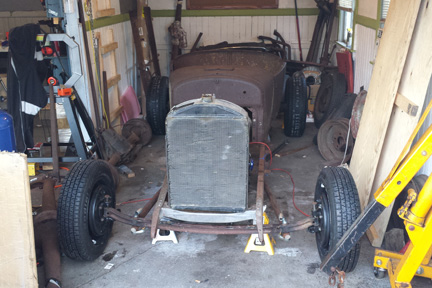

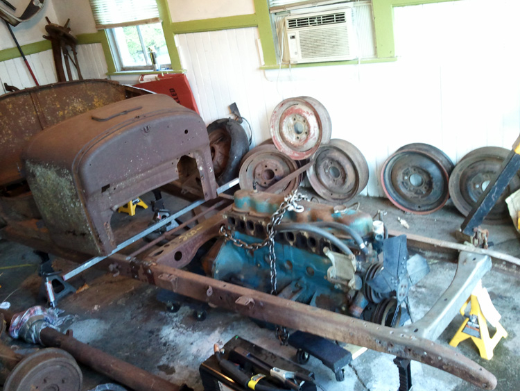

    Before that I managed to get the wheels on and slap a mockup together with good intentions and a couple zip ties.

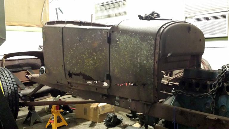

    The body is actually worse off than the pictures show. I have some patch panels to save some time and I'm planning to extend the cab a bit. I have patch panels for a roadster to provide lines to match the sheetmetal which I will need to fabricate to. The subframe is rotten on the pas side, so I will also need to fabricate that with some box tube and angle iron.
    Right now I'm trying to get my axles sorted. I'm looking to get a 4" dropped axle up front and I need to swap bells on my open drive F1 rear with the bells from a p***enger bajno so I can hang the rear behind the crossmember. Then I can mount the spring and figure out how much to kick the rear up.
    Next up is trying to figure out motor mounts. Fabricating flat mounts is looking to be beyond what I have tools for and I haven't found anything that I know will work with the (ugly) stock mounts on the engine.

    Once I get my frame all set, suspension, & motor mounted I will be turning to the bodywork. I will post pictures of the original subframe (what's left of it) for reference. It's hard to even find pictures of a Model T subframe let alone any parts for one.

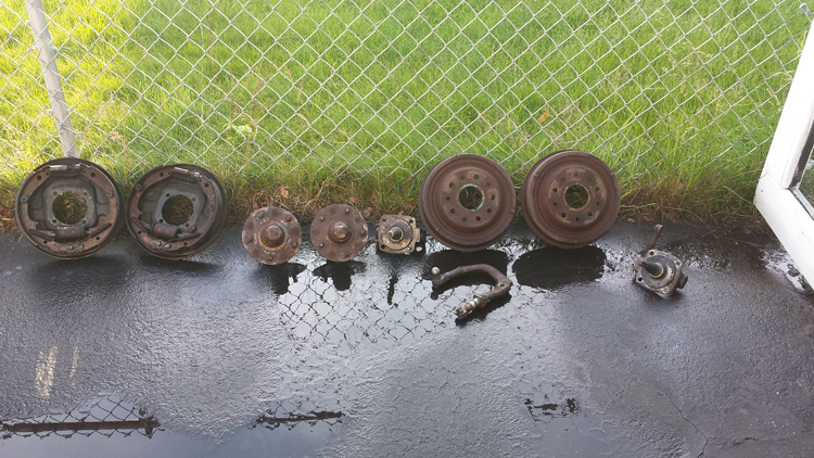

    Swapped bells from the closed center over to the open drive center this weekend. Washed off most of the crud too.
    They both look due for new drain plugs.
    The mount for the factory panhard bar is bent a bit and the threads are rotted away. I'm not sure what I'm going to do about that yet.

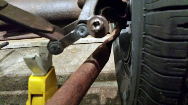

    I got my dropped axle last week and excitedly slapped it together loosely... then scratched my head for a bit because something was way off. In my excitement I put my wishbones on upside down. :cool:
    I've got one of my events coming up in October that was a perfect excuse to do another render of my build for. It's Friday, so here's my contribution (cross posted)

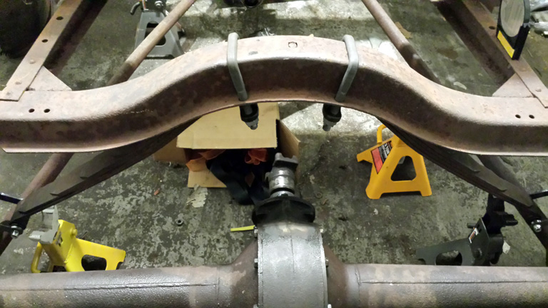

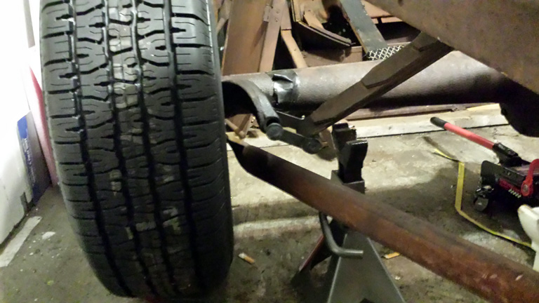

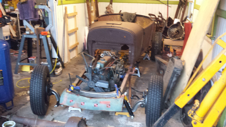

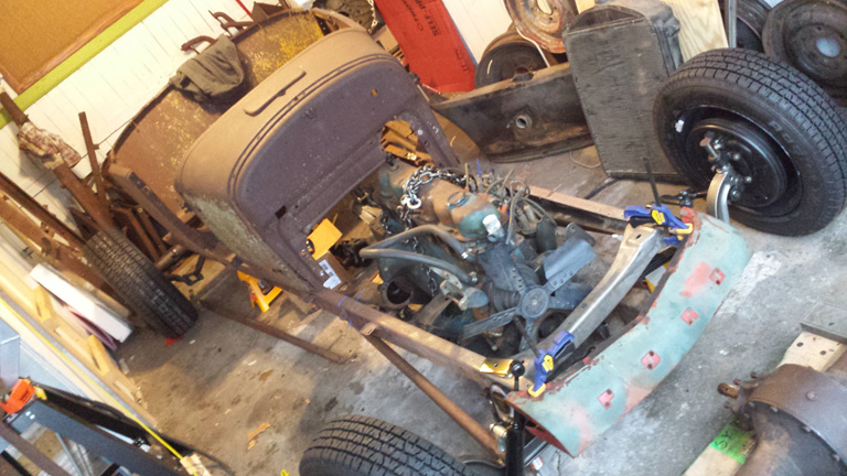

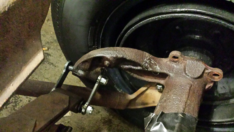

    I've made a bit of progress on the car this past month. I scored a nice F1 piece to cover my frame horns (with some work) and slapped my rear end on there.
    I'm sitting at a 4° rake now, *** waaay in the air with about 9 or 10" difference between the lowest point of front and back crossmembers. The 9 leaf A spring has about 9" clearance over the center shaft housing and my shackles are at 35° so I think I need a shallower, possibly longer spring (though there's not much load on it at present).
    The shackles look to want to make contact with the rear bones. I bounced on the rear crossmember a bit and got them to hit. I've seen this setup done on modifieds but most seem to be bent parallel to the frame. Not sure how that is done.
