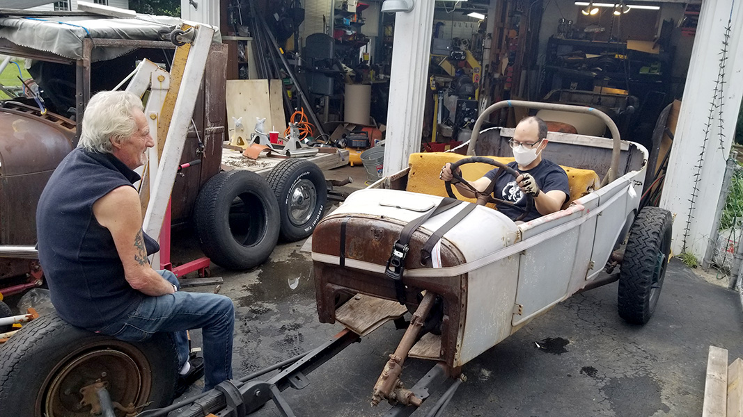

    So, It has been a while and I have not been in the shop much due to birthdays and tending to my property in Maryland where my mom now lives. I spent a week and a half clearing scrub trees, fixing stuff, crawling around on the roof and eating seafood. Here is my satellite toolshed and my chigger infested woods down there. It is 2/3rds of the half acre lot.
    But before all that I did get work done on the car. I am now approaching the point I was starting to get to like FIVE YEARS AGO when @madfish did this render:
    Now:

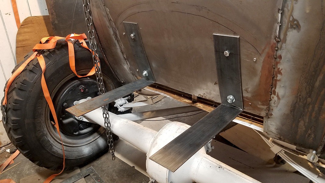

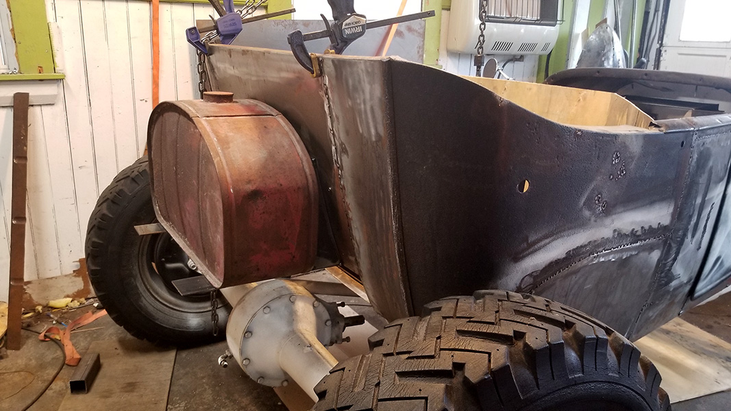

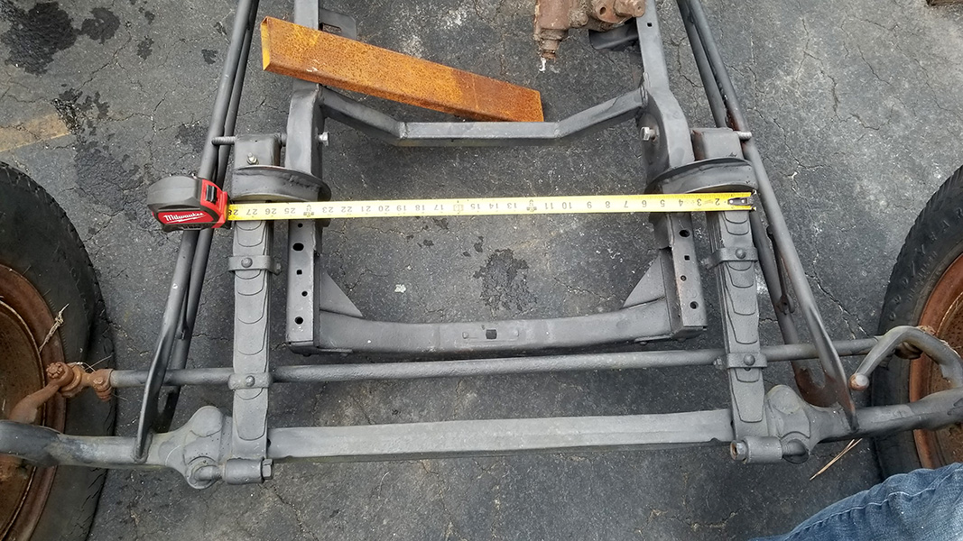

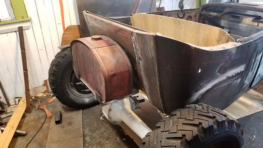

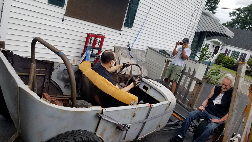

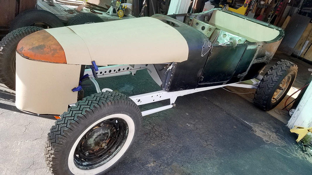

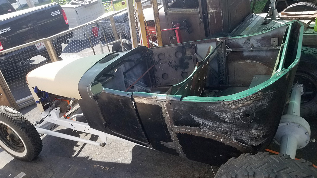

    I had a nice mentoring/brainstorming session the Saturday before I went down south with my neighbor, Paul, and we pulled the nose back like 4-6" (much as @Tim suggested) and suddenly it worked. We mostly played around figuring out ideas for mounting the gas tank after that.
    This is where I was before he showed up and I was unhappy with it.

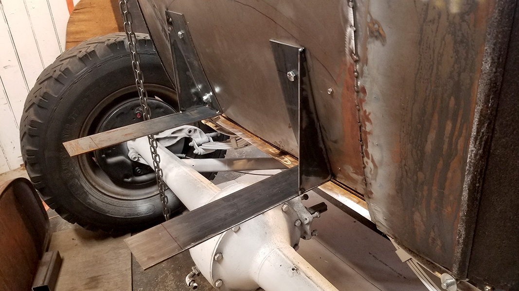

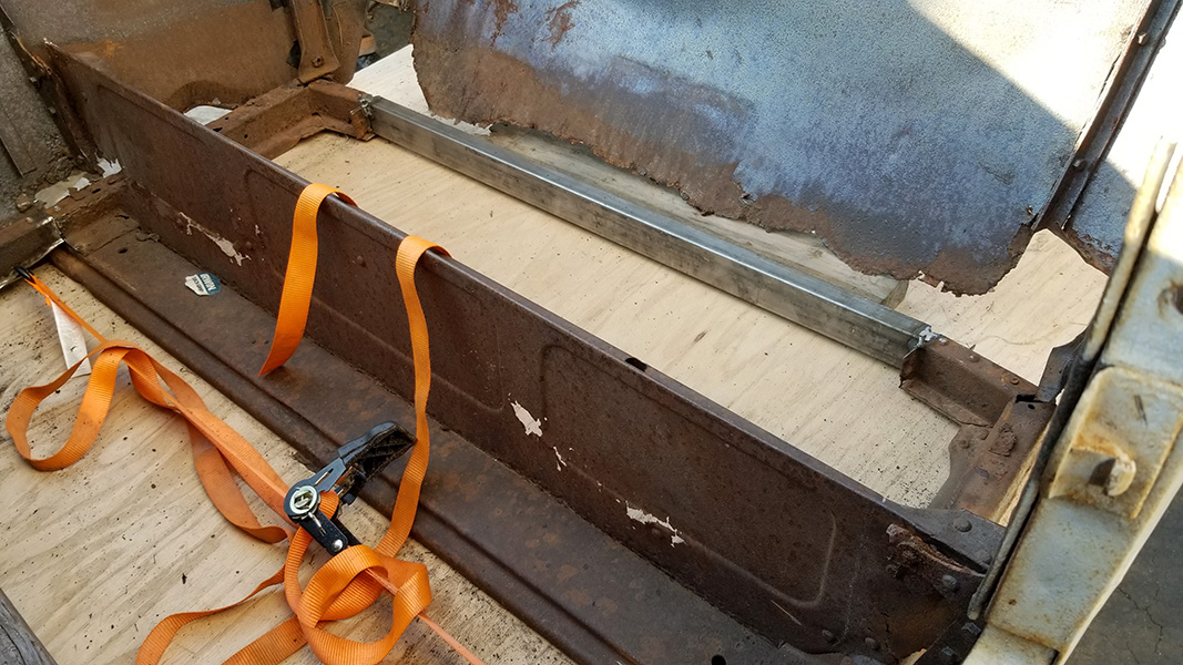

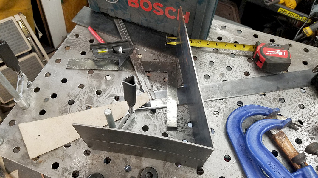

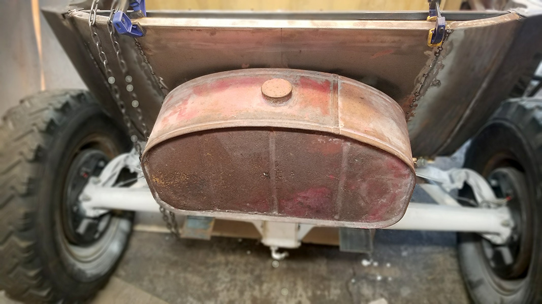

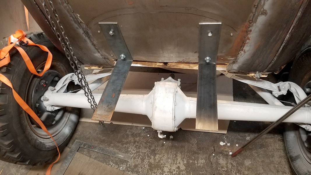

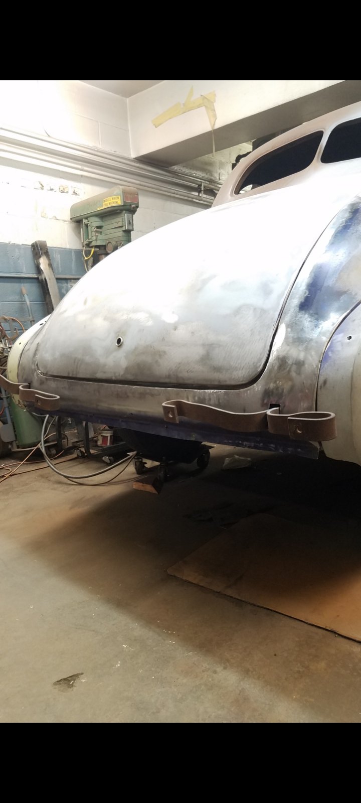

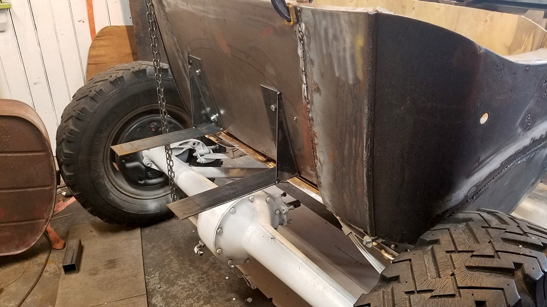

    Earlier that day I finally settled on a method for covering the rear crossmember finally. I just cut up some angle and box tube to make a frame over it and screwed metal to it. I used some edge cover at the back where the wood or metal piece I will close the back up with will sit against. I will extend runners to tie things together there.

  4. Tim
    Joined: Mar 2, 2001
    Posts: 21,578
    Tim
    from KCMO
    Hah! Awesome!
    these things are so “simple” visually that something 4” in a different direction can look dramatically different.
    @Austin kays sends me photos all the time of hotrods that aren’t quite right and I end up moving the head lights or put bigger tires on back. Just little proportion things and all of a sudden it’s totally *****in! So I’ve got a lot of practice at messing with photos of cars screwing with the proportions.
    stoked it worked in real life as well :)

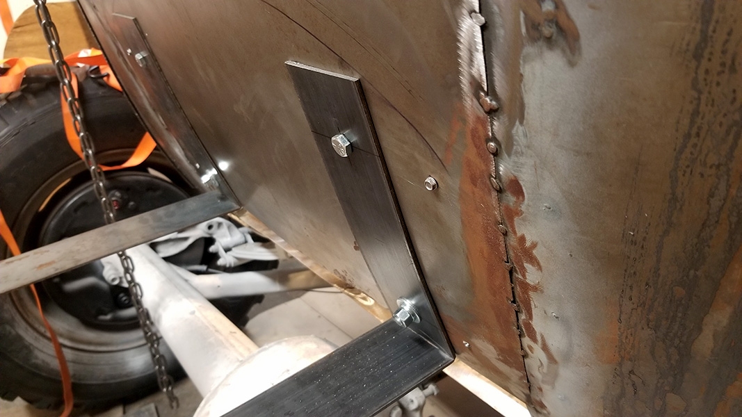

    Didn't have any road tripping or social energy this weekend & skipped all the car shows and races to work on getting my fuel tank mount made for the #thundercasket this weekend. It turned out a little snug but it isn't finish welded yet. The important thing is, it works and I like the look of it. I got a piece of wood rough cut to cover the back too but that will wait a bit until I'm done fiddling with the tank bracing.
    20210821_190353.jpg 20210821_192322.jpg 20210821_192326.jpg 20210821_192333.jpg 20210822_161029.jpg 20210822_161129.jpg 20210822_161000.jpg 20210822_160905.jpg 20210822_170759.jpg

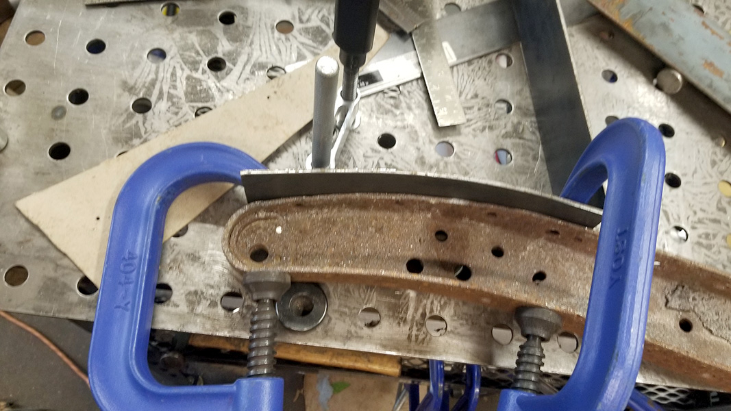

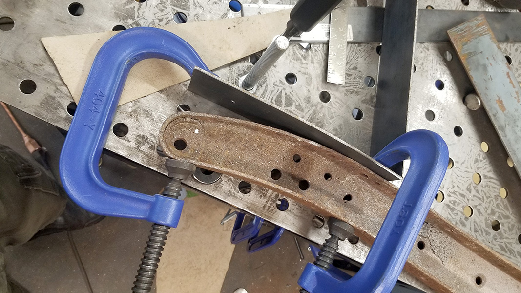

    Here is how used a Model A frame horn & a couple forged clamps to get the brackets curved to match the back of the tub.

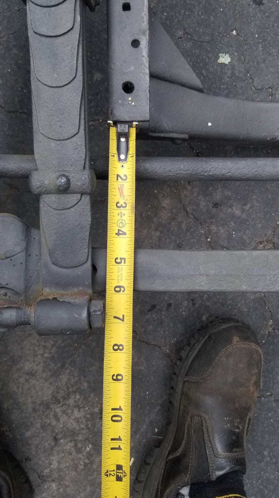

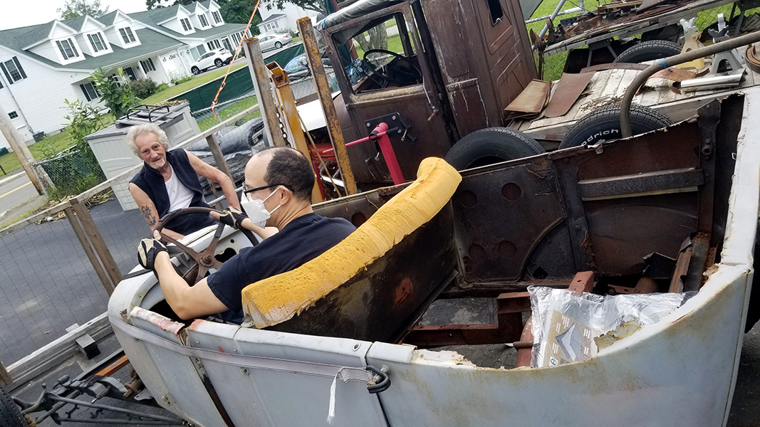

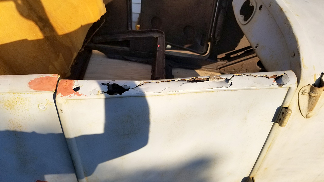

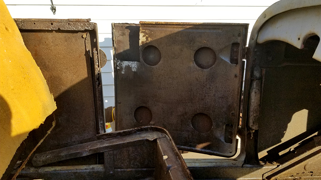

    So, I picked up another hole in the head (project) over the weekend. Though I did manage to get my fuel tank brackets welded up OK before that arrived.
    Fortunately, this project isn't mine, it belongs to a friend of mine and I am helping out for a while with direction and a place to work on it. We will see how that works out, LOL.
    It came on a half finished Z'd T frame with an odd quarter elliptic front end setup on an axle I can't ID and am not sure I trust (no shackles, it's on welded J bolts and the hairpins are welded up too) so we decided to throw a Speedway Tribute T ch***is under it so we can focus on getting the body good enough to go down the road sooner than later.
    20210828_165611.jpg 20210828_165650.jpg 20210828_165656.jpg 20210828_165720.jpg 20210828_165822.jpg

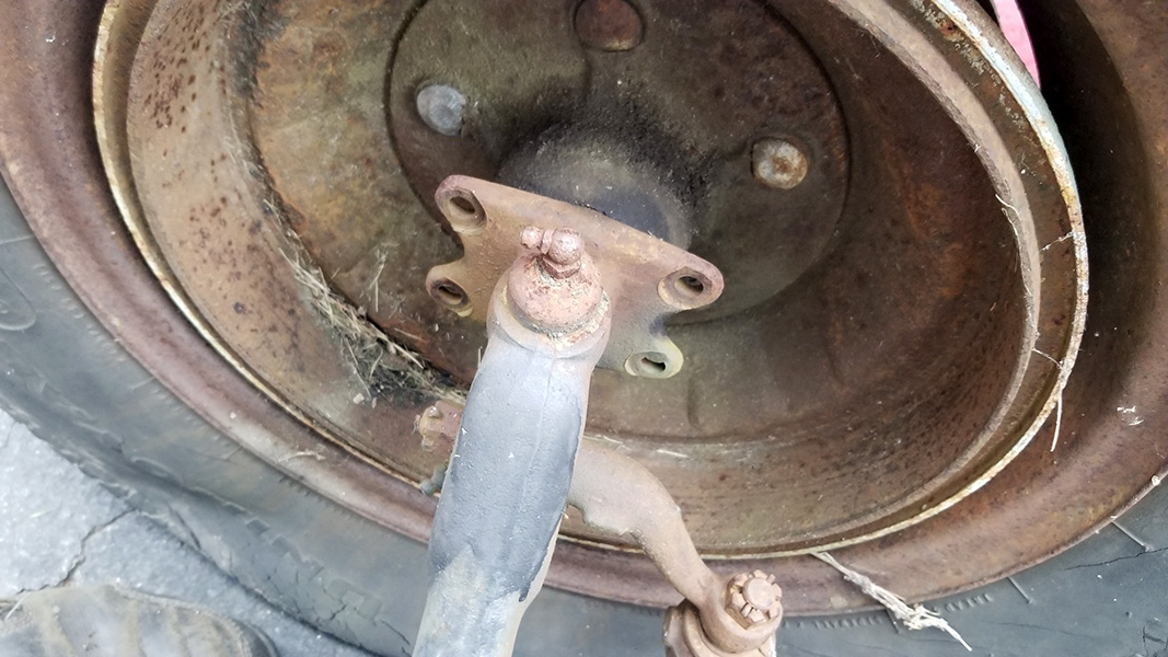

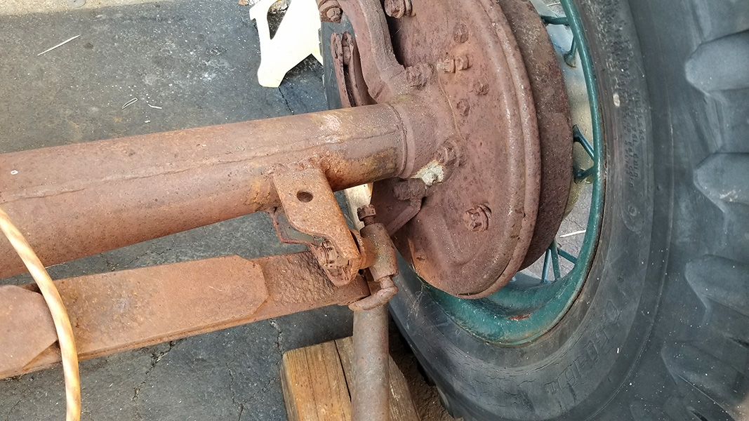

    Here is some detail on the front axle setup and spindles. Not sure what this came out of.

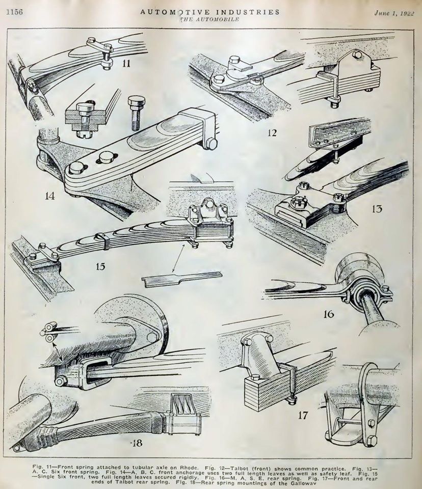

    Wish you were closer I kinda' like the front suspension. I think it could be made to work and not need the hairpins at all.

  11. patmanta
    Joined: May 10, 2011
    Posts: 3,882
    patmanta
    from Woburn, MA
    I'm taking the frame and front end but I think I am going to punt the axle and its weird welded on J bolts, batwings, and hairpins. The spring setup frameside is a bit weird but I don't think that side is inherently unsafe. My neighbor Paul didn't see an issue with ANY of it but I just don't want to fool with that setup when I can just put some receivers through a Model A axle and run shackles to those springs. I've got some cast off 28/29 Tudor bits that I can cobble a bucket out of that would sit nice enough like that and make a good cheap project for someone and get the bee out of my bonnet.
    If they hadn't ground off some of the mounting tabs on the axle, the Figure 10 setup might have been possible. But I'm not real sure why they went to all the trouble of using a QE front end setup to only go out 6" too.

    Until '25, I think, Chevrolet had quarter elliptics all the way around. I plan on using them on the rear of my roadster and after seeing this maybe the front. That would allow it to be a bit lower and not go the Ford route.

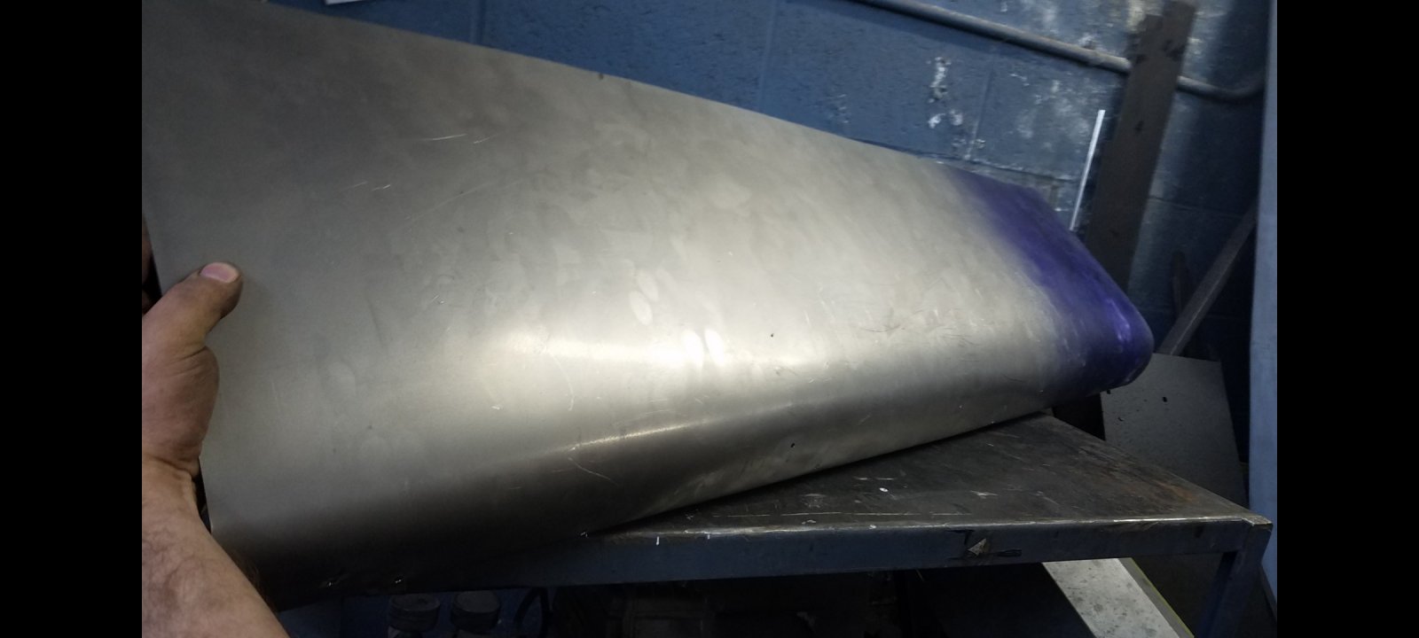

    Well, Nothing terribly interesting to post as far as pictures go really. I have been working on MY car though. I finish welded a bunch of tacks inside the body structure and I can shake the whole car from any point in the tub now so it is about as rigid as I think it is going to get and the tank should hold full just fine.
    AND I made the car a steering roller again too. I put the new round DD shaft in and mounted the firewall flange bearing so the only flop left is from the second mounting hole I still need to drill for the column drop!
    Over to Ruben's T project, We decided to trade out the ch***is (to me) for some of the parts out of my collection and punt the front end entirely (still no idea what the axle/spindles are, the welded J bolts seem unsafe, the welded hairpins seem too rigid and underbuilt, etc. not something I would drive fast on). We ordered the Tribute T ch***is from Speedway along with their repop Buick style drum kit which is all still backordered. Once we get it though, ideally we will be able to just ***emble and build the car. I sent him home with 36 Ford headlights and the repop rear brakes to paint and build as his homework. We got a new rear spring too since the odd spring mount setup and T spring will NOT work in a driving car (see pic).
    We did some work to the body and grafted in the rear of the subframe I removed from my car years ago. I had to weld in a new rear cross for it but it wasn't too bad. The subframe was cut up a lot more than I had hoped; I really don't understand why people do some of the things they do to the structure of these bodies but the liberal use of bondo leads me to think this car wasn't being built to last. The door tops were made of cardboard, duct tape and bondo, for example (good thing I can make new ones on my bead roller).

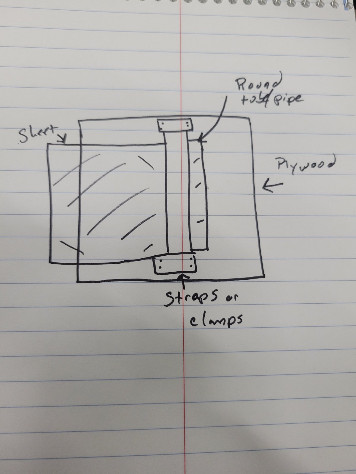

    I think if i was going to start to make a hood for a car like that, Stogy's link and Louis B's car would probably where i would start https://www.jalopyjournal.com/forum/threads/the-brooks-special-louisb’s-29-lakes-roadster-build.1107348/page-8#post-12918886...thru
    And ive used 2.5" exhaust tubing a bunch of times to make big round bends in sheetmetal, where a length of tubing gets clamped to the sheet metal, maybe a few small tacks to keep things from moving and hammer on it with s**** hammers/ dollies, etc. Thats what i used to get the shape started for the tail panel on my Buick, (18ga, i think 52inches wide?)
    I made a sort of 'slip roll' on a piece of plywood with some tubing and straps to keep the tubing in place, and slip the sheet metal underneath tubing and pull up on it/against it. Maybe a torch to warm it up and get it a little easier to move

    Yeah man, I have a 4' pipe that I put something under on the ends then clamp down to a table and more often, the wood bed I made for my AAV8 pickup (that's usually used for a table or a party deck depending on the day and number of beers).
    Planishing against tubing sounds like a good way to lock the bend in too. I do that with a curved face hammer on the T top rail pieces I've been making for my car (and will be making for the Touring car in the driveway).
