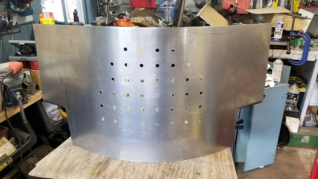

    Thanks all! I'm cursing myself a little for not plotting my drill pattern before I bent the sheet but I'll figure something out for that hopefully today. With at least guide holes done I can bead roll a step along the top to facilitate welding the cap in.
    I am undecided about what I want to do to finish the bottom edge. Currently it has an extra 4" left that is marked for t******* so the chin cap can be added but I am not sure if I want to or not.

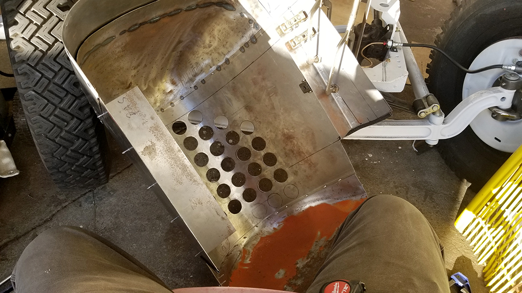

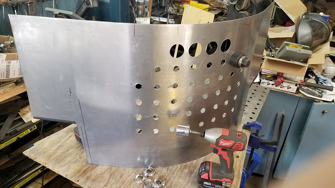

    My ENTIRE DAY Sunday at a glance because I screwed it up for 3 solid hours before I got it good enough. Laying out the punch pattern for the nose skin.

    The new nose is looking good! What are you using to punch the holes? Are you going to dimple/flare them afterwards?

    I am going to use a 1-3/4" Greenlee punch like I did on the holes on the leading edge of the first nose so they don't resist or flatten the bend. Once I get it all together and welded to the cap, I may try to measure the radius in a couple spots, design and then 3D print a flaring tool or two with the correct radius to flare the holes 1/8"dia. Typical punch/flare tools are about 1/4"dia so I'm hoping this will still get THE LOOK while still being able to work with plastic tooling. But that's not a primary step in the build; it will run just fine if I don't get to that right away (or ever).

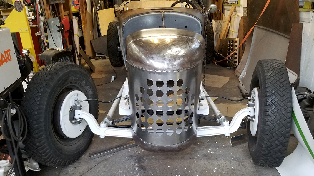

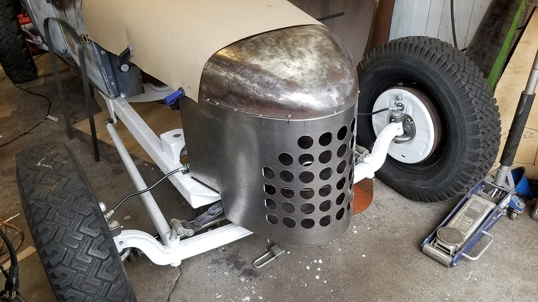

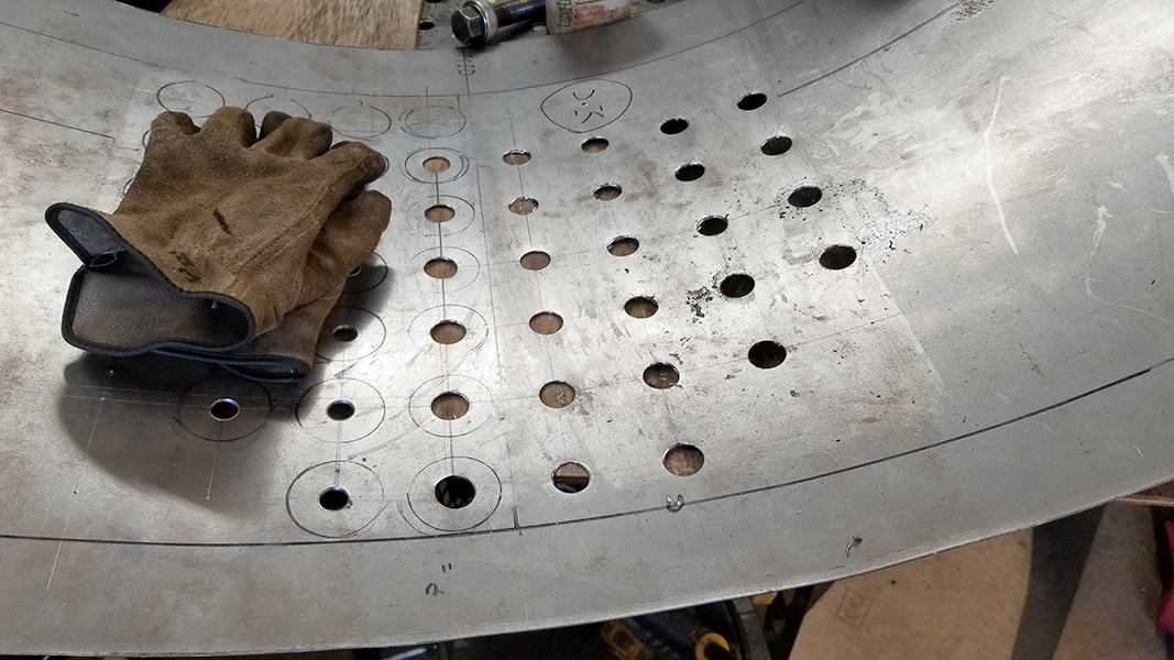

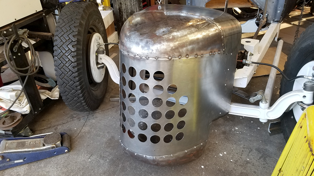

    I punched the nose skin yesterday. It was unnecessarily difficult because of the oversize screw on these HF punches but I got it done. Anybody know where I can get a punch set that uses a half inch screw instead of having to make a 3/4" hole just to get a 1-3/4" punch? My dimple punch sets work great with a half inch screw and I burned up my #4 step bit and most of my energy drilling guides.
    Anyway, here we are!
    20210929_172229.jpg 20210929_172216.jpg 20210929_172209.jpg 20210929_172202.jpg 20210929_171016.jpg 20210929_163352.jpg 20210929_161902.jpg 20210929_151938.jpg 20210929_145932.jpg
    I marked out a bottom row but chose not to drill it (other than the one :( that I did by mistake). This is becase I am not sure if I want to leave the bottom flat like it is now and punch that last row, or cut the extra material on the bottom off and add the bottom cap to round the nose out which would make those holes a bit close.

    Looks good! Like the rolled pan idea, not sure if another row of holes would be too close but you can see it better.

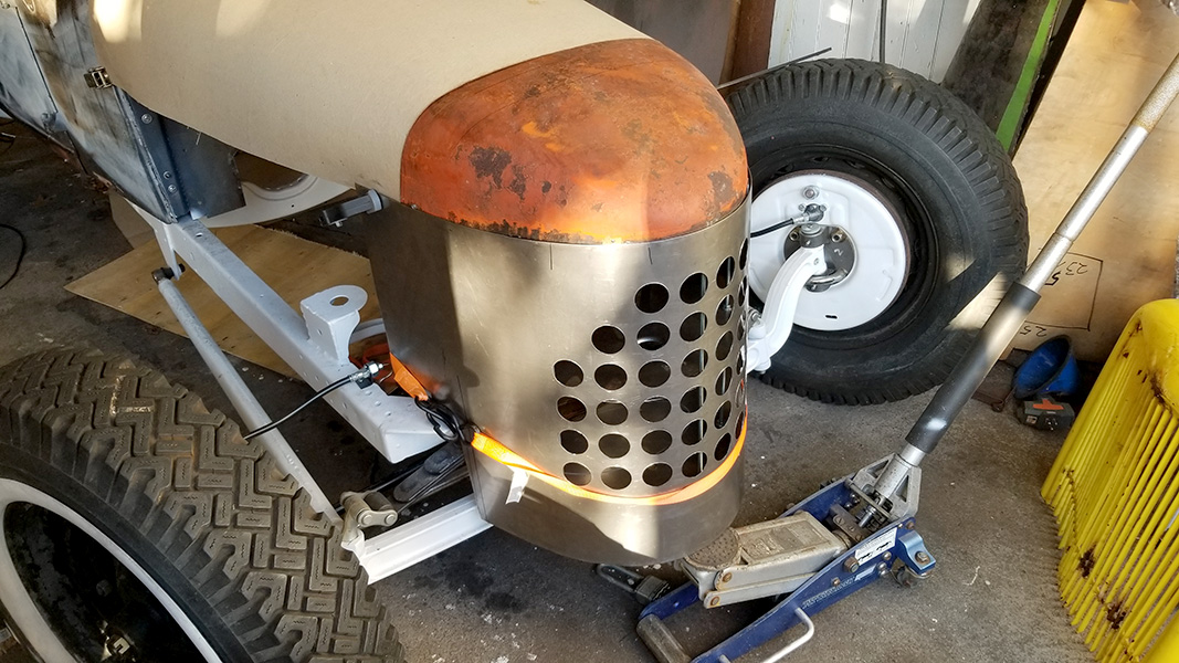

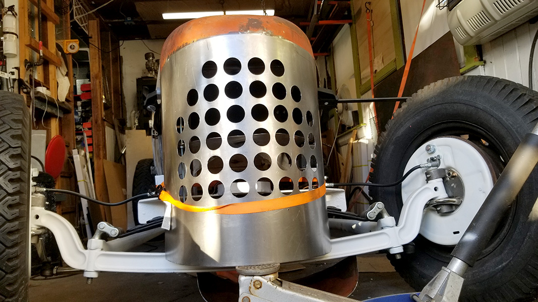

    OK, so, see that line under the >:C face there? That is the cut line where the bottom cap would go. I wanted to stay somewhere in the neighborhood of 2" out from the seams if I could so I decided to be cautious until I had a definite plan either way.
    Now that I have the minimum holes punched and the skin back on the car, I am leaning towards doing the cut and adding the cap to the bottom. It looked cool as is before but with the holes it makes more sense to run the cap down there now. The plan will be to cut the extra material then do another mockup on the car so I can see if adding the bottom row is a go or a no-go.

    Yea, That is getting close. Even closer if you flair them and it might look crowded.

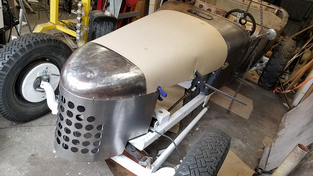

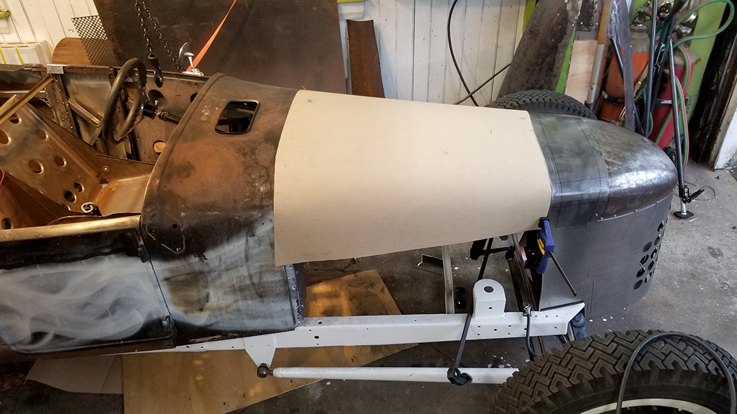

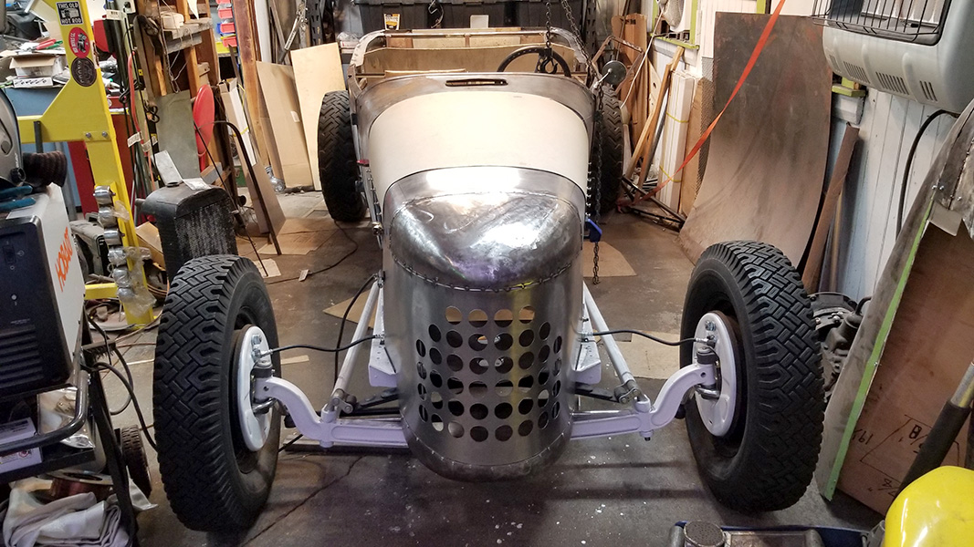

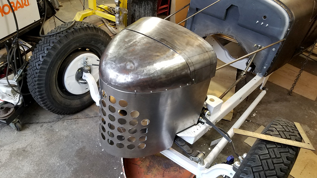

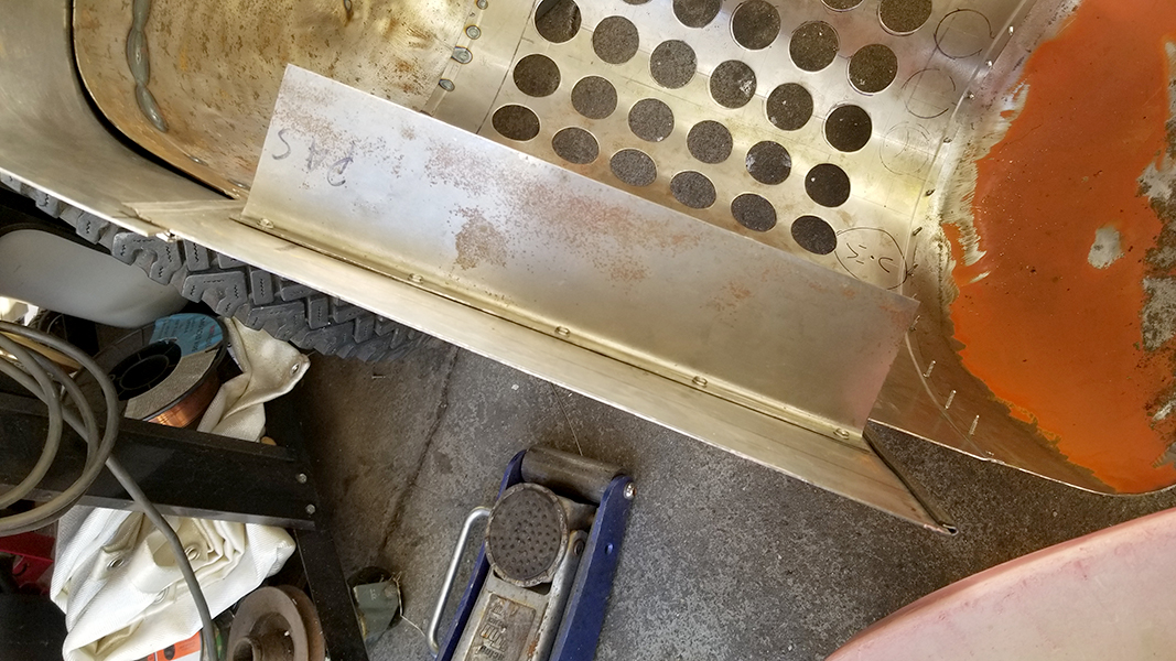

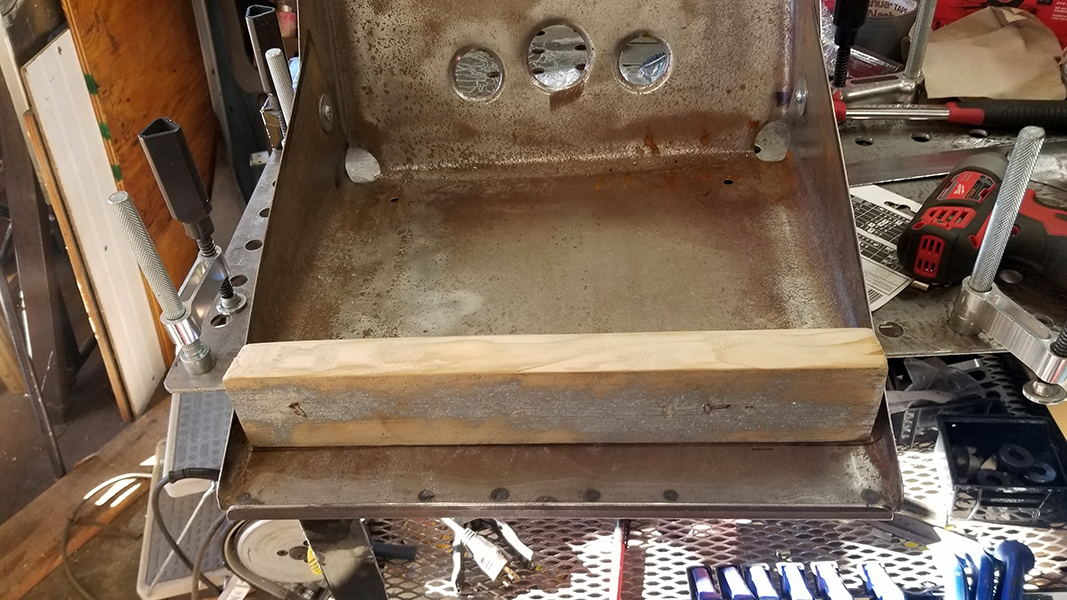

    THis weekend I started working on the top and bottom caps. I got them stripped fairly well (it was nasty) with a stripping disk then took the skin over to the bead roller. I am still REALLY liking my 8" roller and motor combo.
    Stepped the skin then fought with clamps and straps until I had it set good on the buck before moving on to fight with getting the cap set on there right. Sheetmetal screws are my best friend. I have really good luck with #6 stainless hex caps and my 12v impact driver (the big 18v impact driver tends to rip the heads off and the base grade screws even more so, fyi).
    20211003_133627.jpg 20211003_133515.jpg 20211003_133445.jpg 20211003_133431.jpg
    Once I got that all set, I decided the best approach would be to make a filler piece and worry about a hood next week or so. Doing it that way seems cleaner, SO, I cut my hood template off and used a piece of that to start. I added about 2" for safety and to allow for a step to grab a hood like a stock shell would.
    20211003_174736.jpg 20211003_174724.jpg 20211003_174721.jpg 20211003_174226.jpg 20211003_174218.jpg 20211003_152216.jpg

    Yes, once I get it all set just right with my poor mans clecos. I am not happy with its current mounting situation and once I get it all at least tacked up, I can get the buck/structure out of there and do something a little more streamlined. I didn't think I would be able to take all of it out but I did manage to get things together well enough without needing to attach it permanently to the skin or the caps. It will need some filler, I'm sure, but it should work out OK in the end.

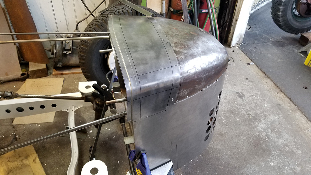

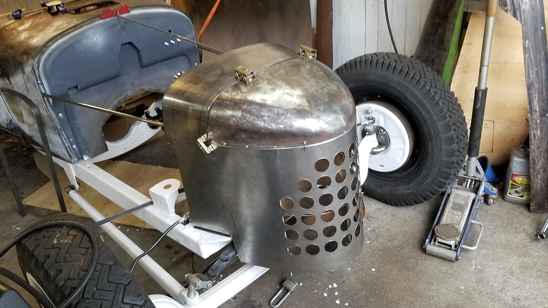

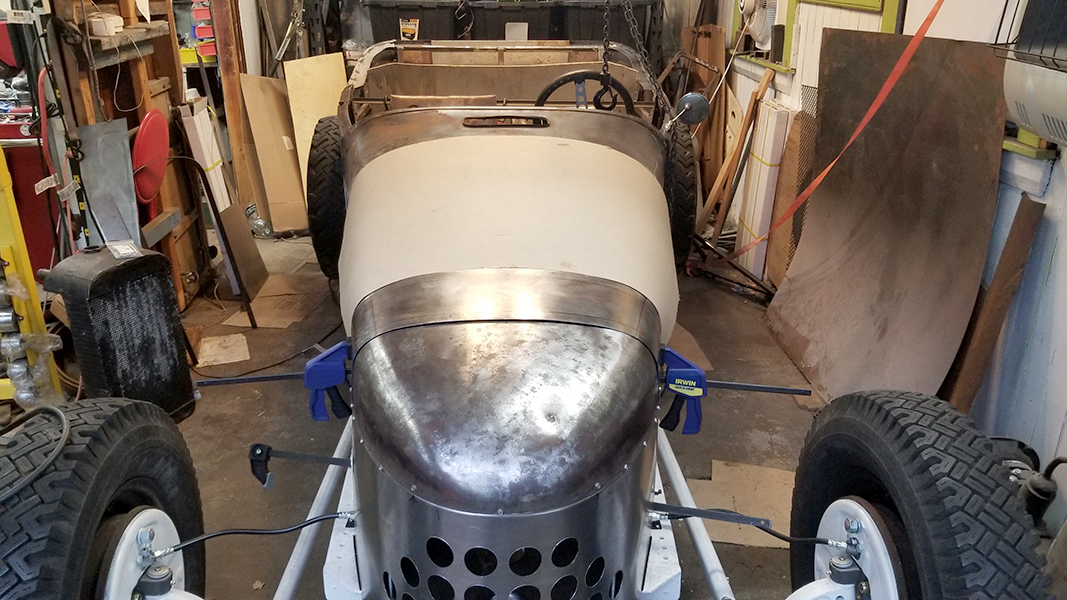

    OK, so as you saw already, I have the nose fully skinned and almost got it welded up until I ran out of shielding gas this weekend. Sheet metal screws (poor mans clecos) to the rescue! Pictures will tell the story.
    20211010_181136.jpg 20211010_180312.jpg 20211010_180259.jpg 20211010_144457.jpg 20211010_144440.jpg 20211010_144426.jpg

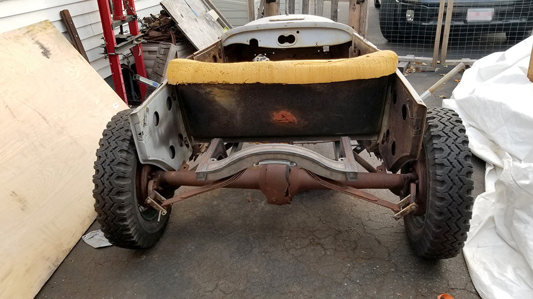

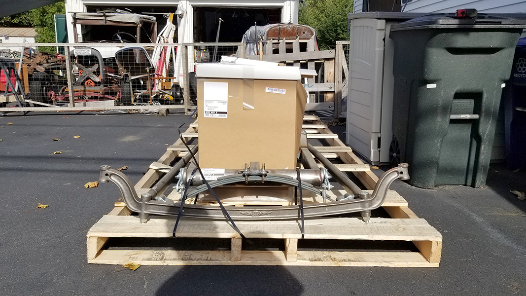

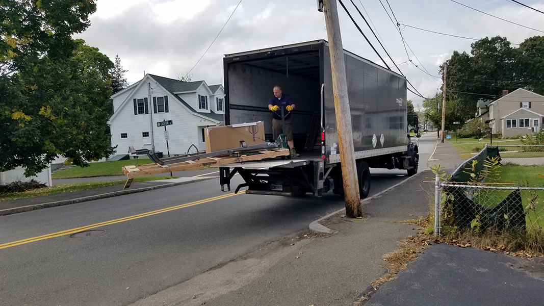

    THEN I took delivery of my friend's Tribute T ch***is. I made a cardboard mockup engine and we scratched our heads quite a bit over the dimensions and placement since this ch***is setup is really meant for a gl*** 23 bucket body. Here is what all that looked like:

    Gotten a few things done over the past few weeks. I made up some stiffening ribs that act as deflectors inside the nose to direct air towards the radiator instead of letting it all blow by. I installed those with rivets to make it easy to change if I need to AND since I still haven't gotten more shielding gas (I was out in Oregon last week).
    Next thing I did this past weekend was make up some little 16ga tabs to attach the nose to the frame. I'm going to have to slot one to get the fit perfect I think but it's amazing to see it on there without clamps finally. I will probably add at least one more point of attachment up top. I am thinking something like threaded rod or a bolt welded into the top of the nose and a sleeve or heavy washer welded to the top of the radiator support would do that duty nicely.
    Here is the eye candy:
    20211017_145000.jpg 20211017_150631.jpg 20211017_150636.jpg 20211017_162111.jpg 20211017_162115.jpg 20211017_162122.jpg 20211017_171130.jpg 20211017_171140.jpg

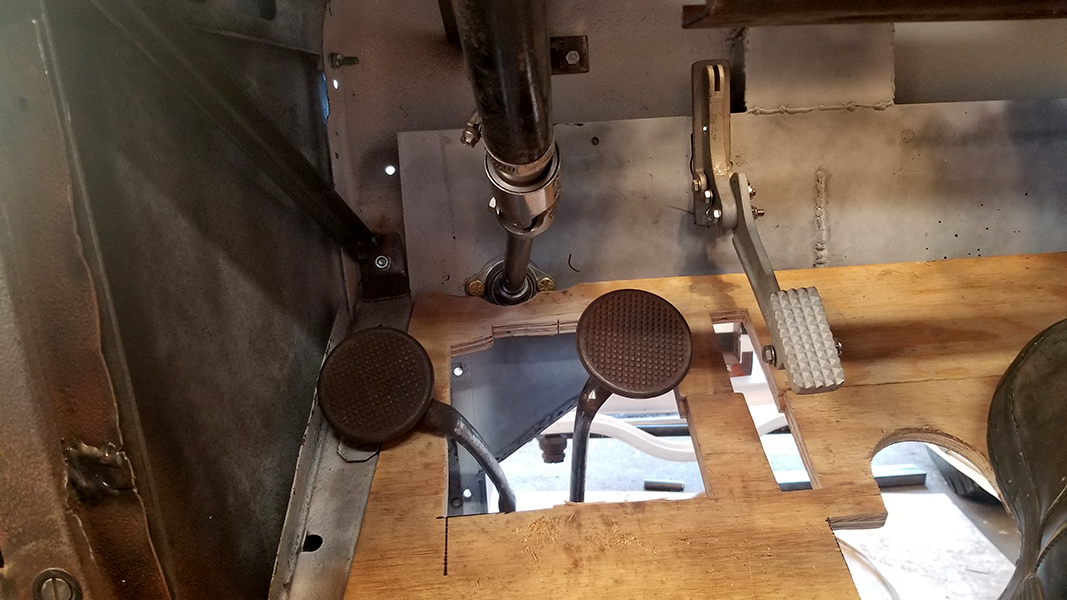

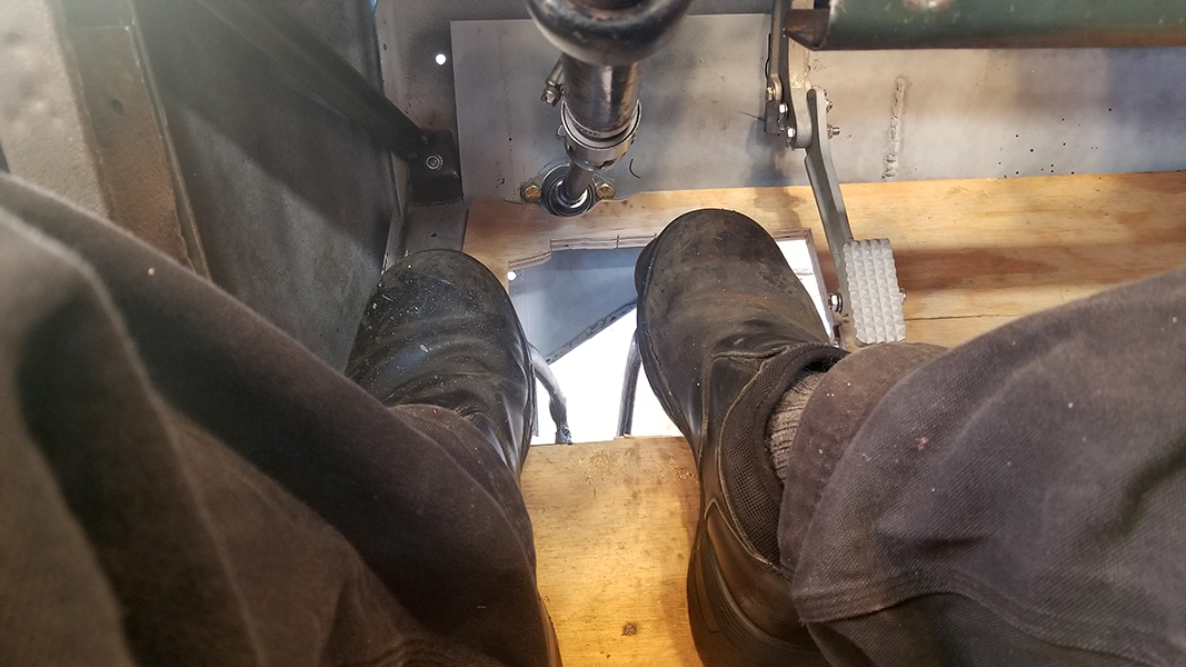

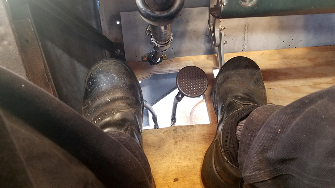

    The weather was bad Halloween weekend so I had a little help in the shop with the heat going. Got the dash in where I want it, cut a relief for the column drop, then made a template and plate to back it and mount it (not pictured). Was going to roll the edge on that piece but when I unpacked my new radius dies, the set screws were nowhere to be found so that will be a future update.
    This past weekend was light duty in the shop today since I hurt myself on Halloween chasing down a dog that was in my care (tore the skin off my right palm in a bad fall). Made a simple block riser for my seat pad and mounted my go pedal! Small work but big payoff. Got the seat mounted again yesterday too (also not pictured).
