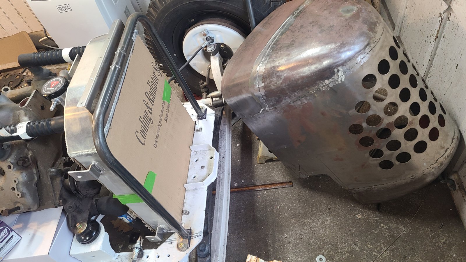

    Just so you don't think I'm slacking. Here is whaat I'm fiddling with now. I am making a hoop to support the nose and the radiator. I'm waiting on some Dzus plates and hardware to lock it all in. I will need to re-route the brake line here once I am done. This hoop is 0.120" tubing so it should add a little structure.

    That is a good idea. I have not figured out my radiator issues yet. The right radiator would help. Keep at it your struggles give me hope!

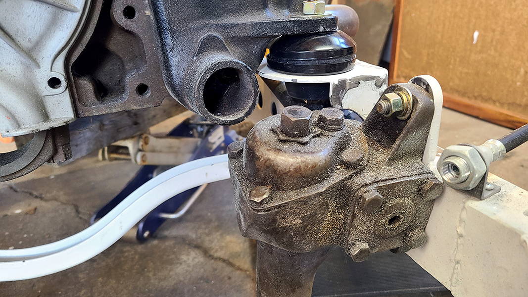

    next I need to figure out how to get the coolant around the steering box, LOL
    I have a bunch of tubes coming from Summit to play with. I'm hoping I can just get over it with a couple 90s.

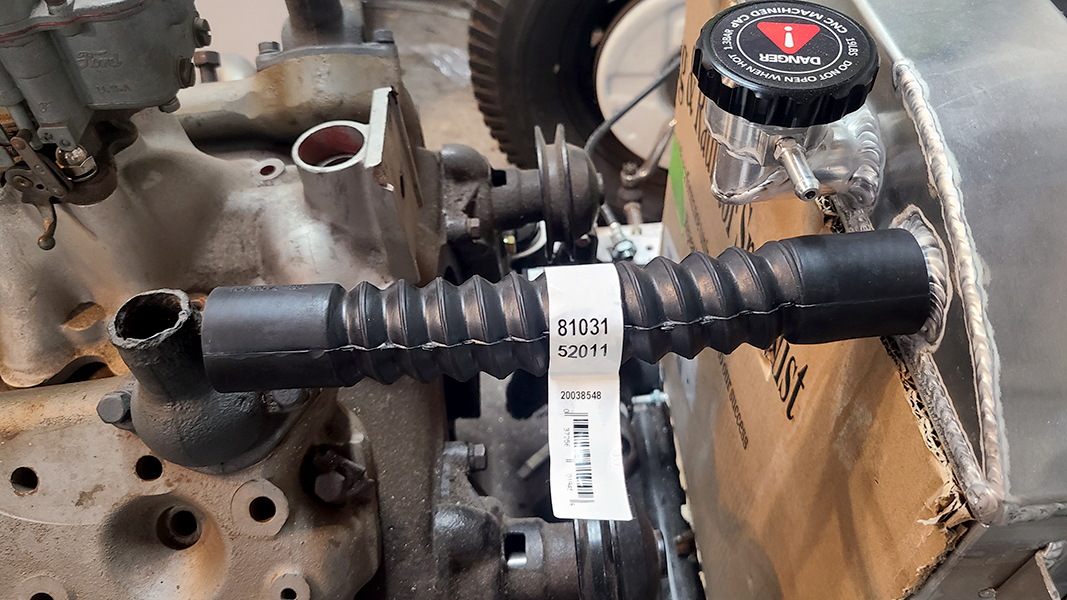

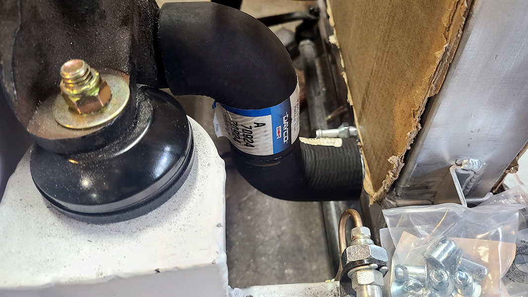

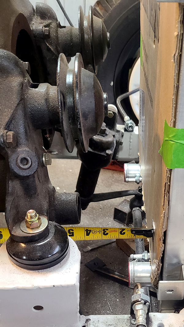

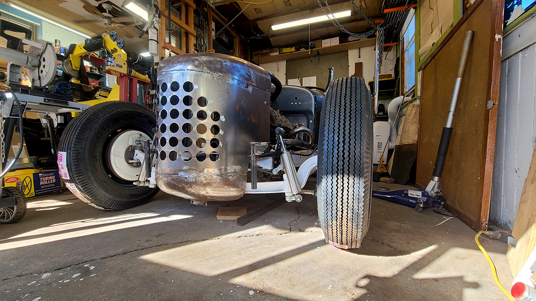

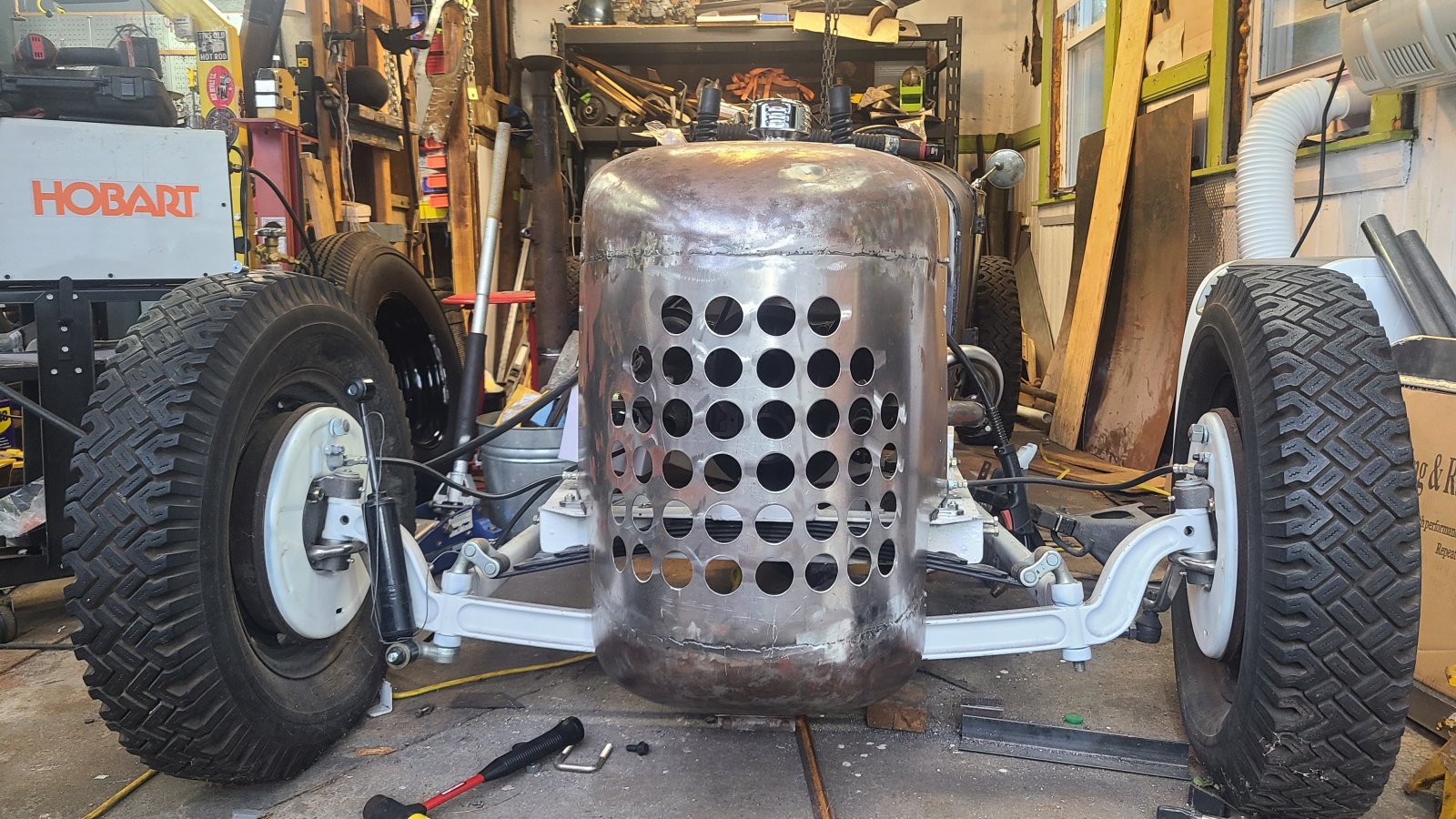

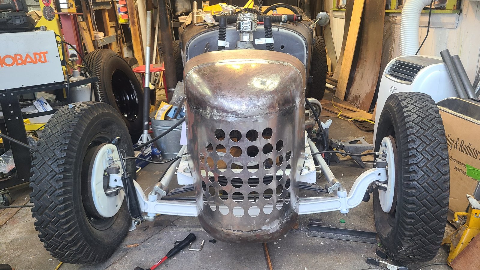

    OK, a couple victories to report. First, I got my torque tube put back together straight and welded up!
    20220826_165913.jpg 20220826_165450.jpg 20220826_165346.jpg 20220826_164944.jpg

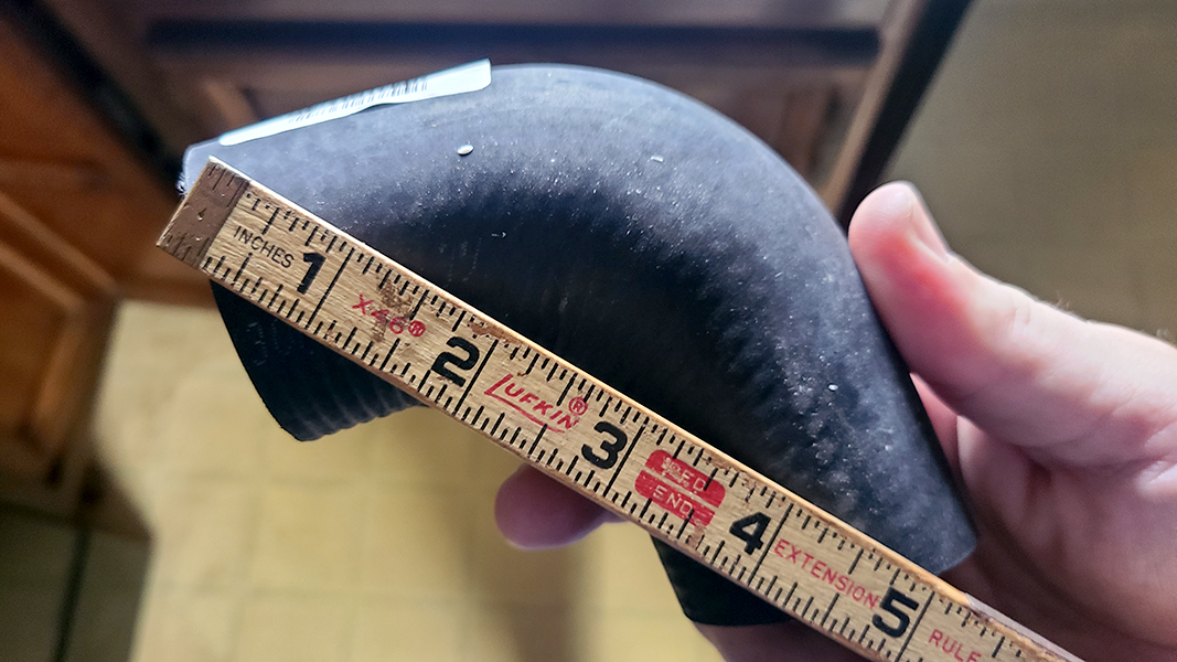

    Then I managed to get ONE out of four radiator hoses run. I definitely did not approach my measurements right up top and I have a challenge ahead figuring out how to get around my steering box, but the lower p***enger side pump went together with a couple 90s and a 3" tube! I trimmed an inch off the ends of this 90 until I got what I needed. They're 4" x 4" so I had enough to work with.
    oops

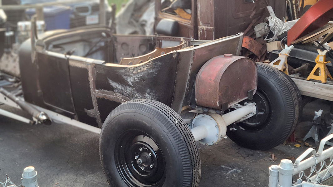

    I have actually been working on my car, just mostly doing stuff to @justa170 's build lately (that update is coming next).

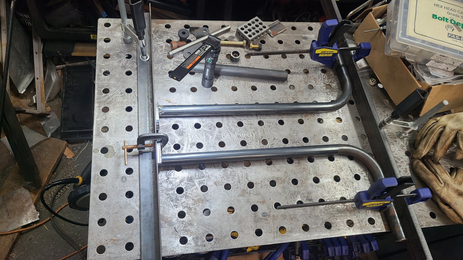

    I got my radiator hoop tacked up and bolted down to my satisfaction before I took off to Maryland for a couple weeks to work on and around my mom's house. Since I've been back, I managed to figure out how to use these Dzus bits to hold the nose on. I got 2 in this past weekend and I figure 2 more should go in for good measure.
    20220905_142926.jpg 20220905_154458.jpg 20221010_155901.jpg 20221010_160440.jpg 20221010_161958.jpg 20221010_162016.jpg
    Also, got my rear Firestones mounted and discovered the curb guards and that the guy who mounted them hadn't noticed either, LOL, oh well. I'll get them matching soon. I'm inclined to turn them guards in since I'm not running WWs.
    The matching fronts are off getting mounted to my Wide 5's already.
    You'll also notice boxes of engine parts and the new carb risers. I'm gearing up to get my block back and get my engine built finally. Haven't decided how I want to go about the port and polish but I'll hammer that out soon. Figuring out my lower radiator hose on the driver side is vexing me at present and I may need to cut and solder the port over there. I'm looking to set the pumps and belts into a 59ab configuration potentially, I've got most all the bits to do that. I've gotta set up a distributor on there and see what's going to fit. The fan clearance is what's got me chasing my tail up there since I jacked my block so high.

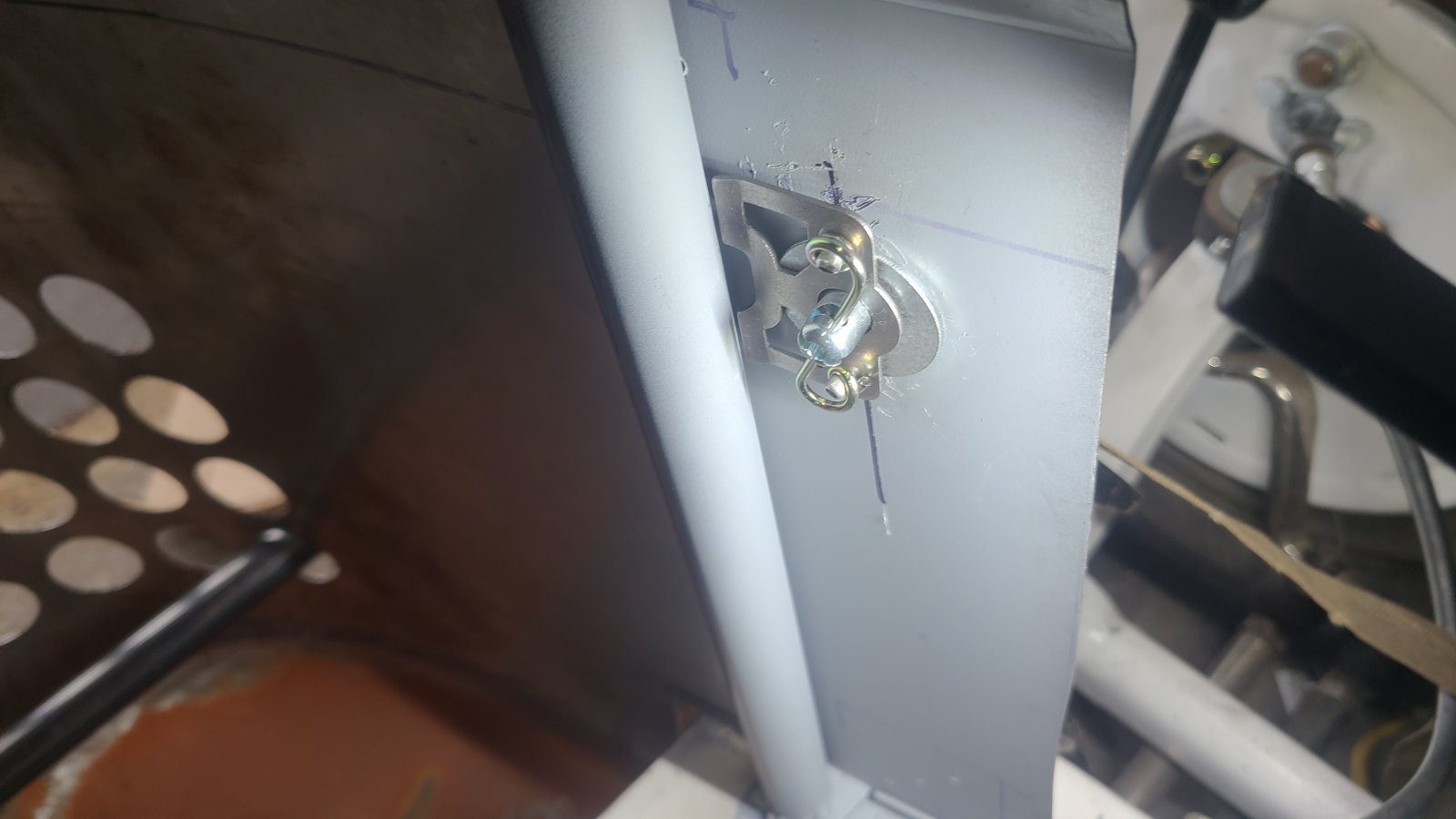

    Nice progress. I like the Dzus clip idea. I though if using them for all the body panels on my Chevy when I was thinking of replacing all the wood with steel. The rear quarters has 4 pieces + the trunk. There's inspiration here, Thanks!

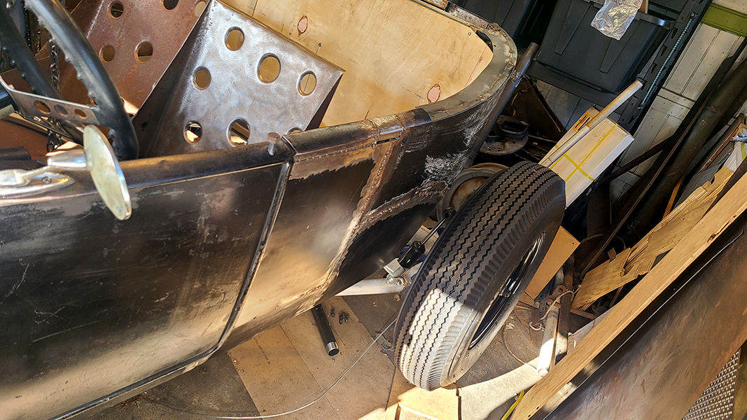

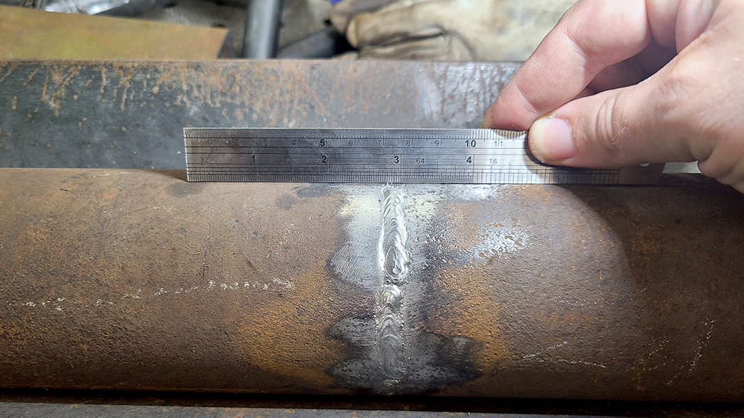

    I did a bunch of smaller tasks this weekend to clean up some loose ends. I got my drive shaft cut down another quarter inch to get it just right, re-welded the U joint on my steering, cleaned the car out (it had turned into a bin), screwed the backer panel into the rear of the cab, and put my 7.50-16 Firestones on finally.

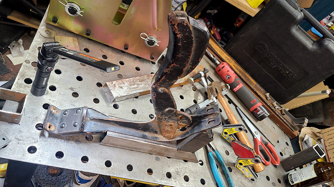

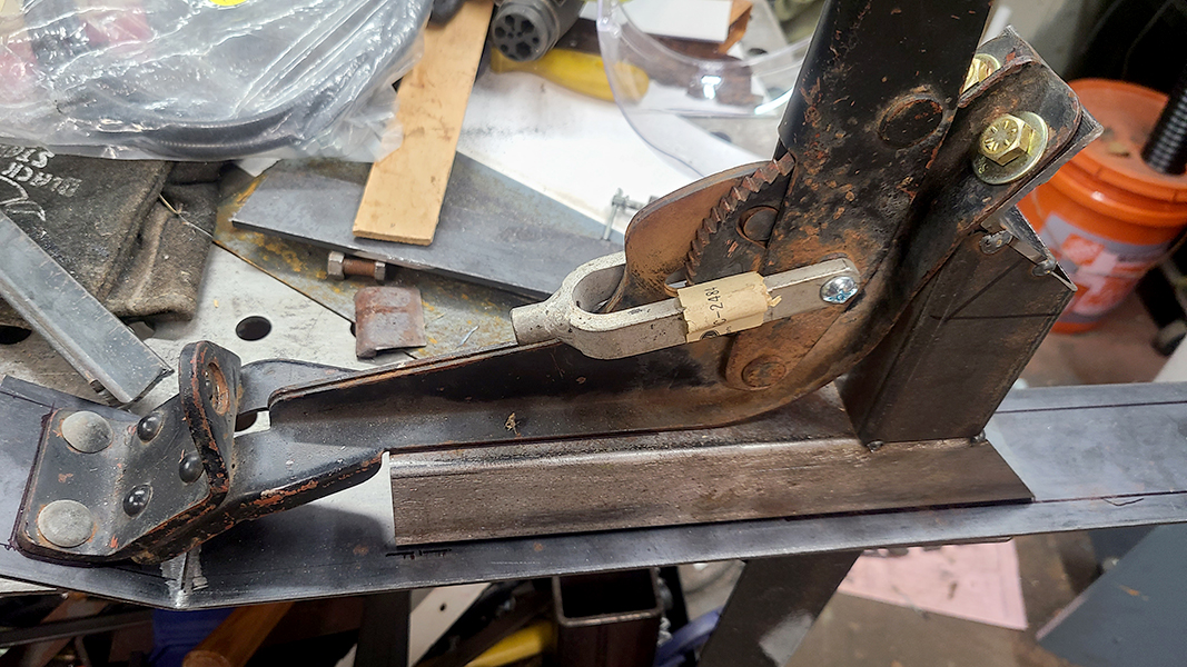

    Then, with that momentum going, I started on the parking brake mount. This is a F-100 under-dash handle (if I recall correctly) that I've flipped over to run like a console or floor mount lever. An earlier handle ***embly would have been easier to mount but this is what I had. Hopefully I can figure out what clevis and cable I need to use.

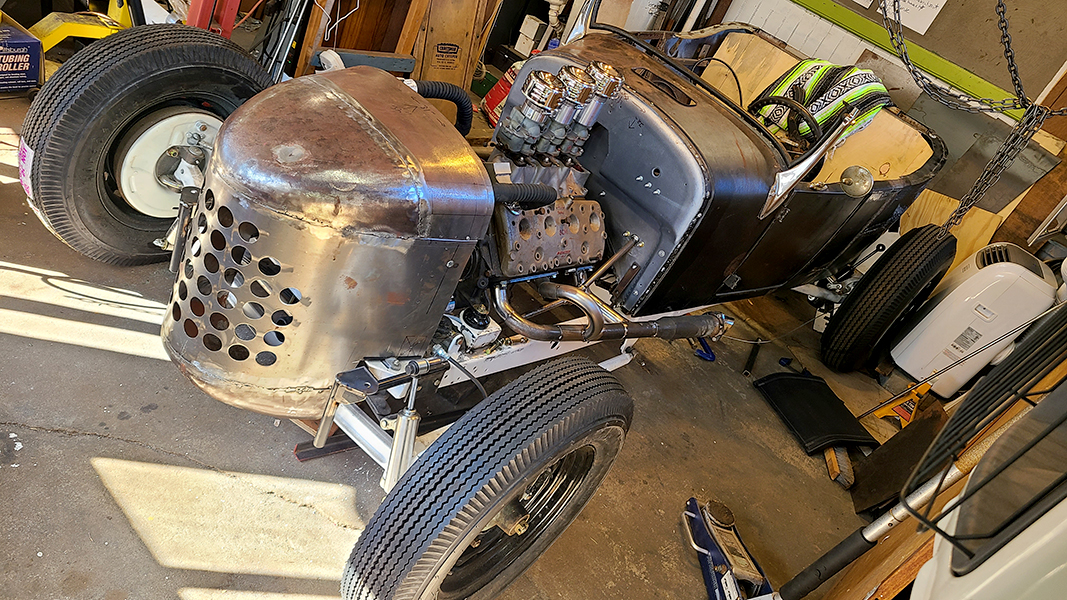

    Stogy, patmanta and Six Ball like this.
  13. patmanta
    Joined: May 10, 2011
    Posts: 3,882
    patmanta
    from Woburn, MA
    The matching Firestones 6.00-16's are still at the shop waiting to be picked up; one of us just needs to get down there and get them. I also have to take one of the rear 7.50-16's back to get flipped around. I got a white tire marker to make them say FIRESTONE so the car will go faster also.
  14. patmanta
    Posts: 3,882
    patmanta
    from Woburn, MA
    Been puttering around in the shop a bit looking for odds and ends to pick at on weekdays. I ended up making some templates for interior panels which led me to realize I needed a bit more structure to hold them. I settled on closing up the back "bench" with some sheet metal, bending some runners for the subrail to panel interface, and repairing the B pillars where the curved piece was cut away inside. I'm just going to cover all the ugly.

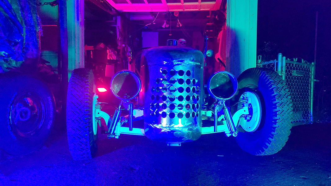

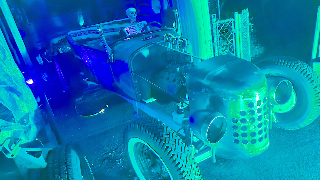

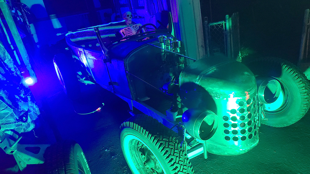

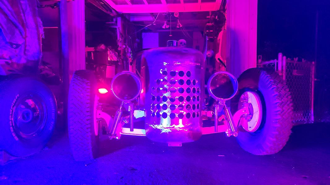

    Also tested out some Halloween lighting for tonight:
    Nailhead A-V8, Stogy, slv63 and 7 others like this.
  15. MMM1693
    Joined: Feb 8, 2009
    Posts: 1,856
    MMM1693
    Is this car front wheel drive? :D
    Six Ball likes this.
  16. patmanta
    Posts: 3,882
    patmanta
    from Woburn, MA
    I don't get it.
    Stogy likes this.
  17. Six Ball
    Joined: Oct 8, 2007
    Posts: 7,245
    Six Ball
    from Nevada
    I think it's the tires.
    Stogy likes this.
  18. MMM1693
    Joined: Feb 8, 2009
    Posts: 1,856
    MMM1693
    Yea its the tires, just being a smart ***
    Stogy and Six Ball like this.

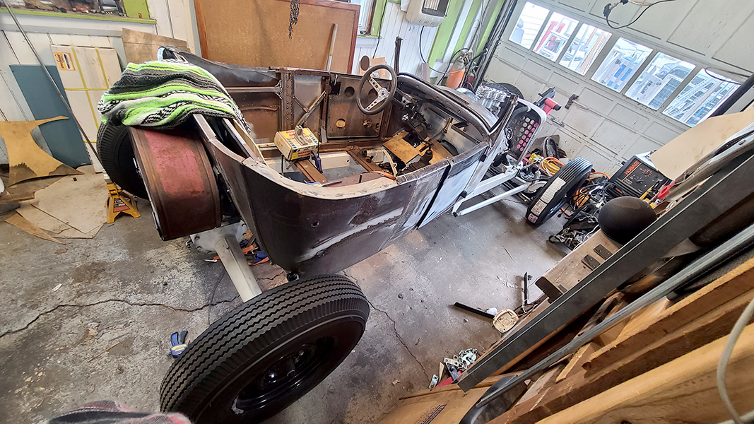

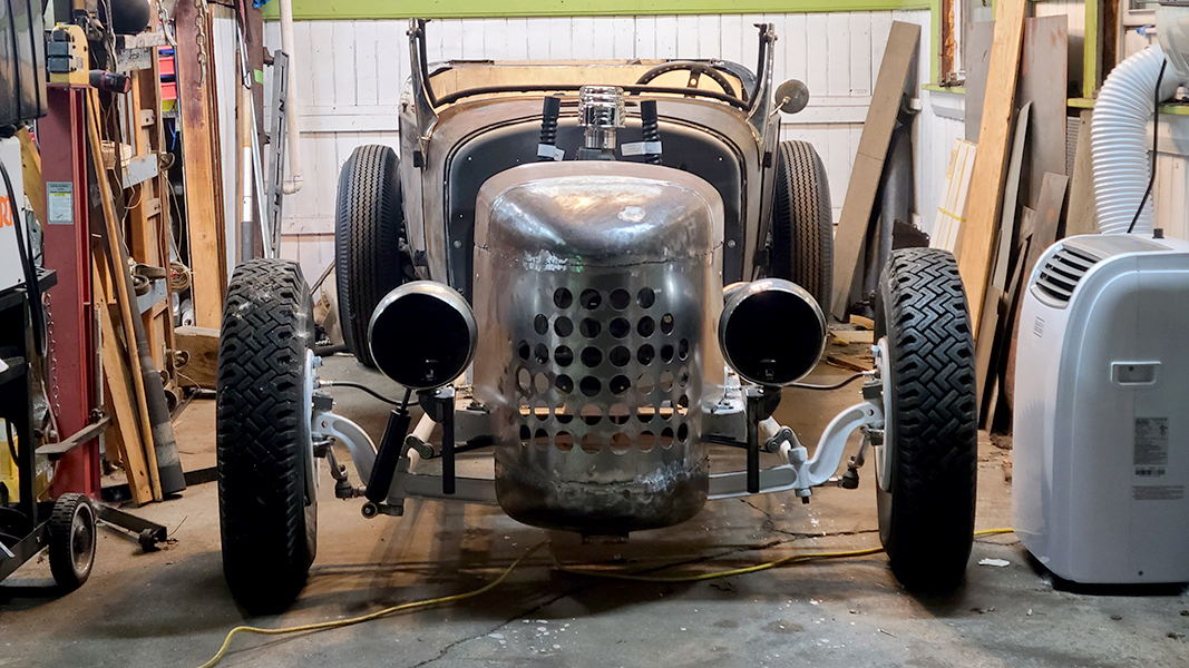

    I've been picking away at my car since October. And I've been awful about taking pictures but here is a photodump from Halloween for eye candy.
    I've got my parking brake handle bracket a little father along. My engine is almost ready for final ***embly and I'm taking my clutch and drive shaft up to the machine shop this week.
    20221031_174936.jpg 20221031_185919.jpg 20221031_185921.jpg 20221031_185923.jpg 20221031_185924.jpg 20221031_185928.jpg 20221031_185943.jpg 20221031_185944.jpg 20221031_185945.jpg 20221031_185951.jpg 20221030_182411.jpg

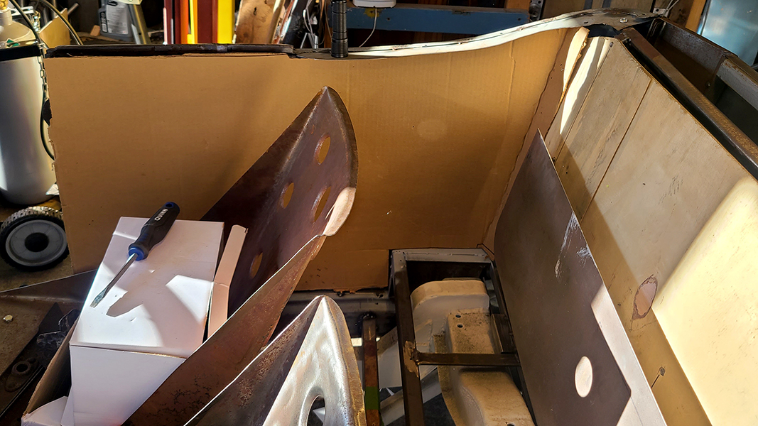

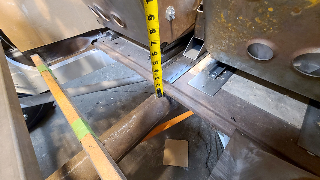

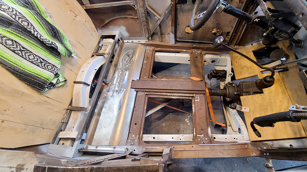

    Starting with the worst, most recent, discovery here - when I added another 2" to my kick up, years ago now, I neglected to make adjustments for the subframe floor or radius rods. And now I have JUST REALIZED IT when I ***embled the torque tube and tacked the relocated rod bracket tab to the tube. I feel pretty dumb and had to walk away from it and think (still am).
    I am going to need to make some sort of floor hump. I figure. since I know it is 2" causing the problem, I could run a line from 2" off the top of the frame to the front of the torque tube and get an idea where I could have problems. I may be able to make an angled run back to front instead of a clunky hump all the way to or past the front subframe crossmember (which I would prefer not to cut if I can get away with it).
    I think my options for the rear radius rods are:
    1. Move the rods inboard on the rear end bells with a weld on tab and shorten them
    2. Weld in ladder bar brackets but run the LBs to the torque tube
    3. Use longer rods, torch bend them to run outside the frame like the split bones up front
    4. Use the tubes from a 46-48 wishbone to sweep under the frame (I have a set but I am very hesitant to sacrifice them)

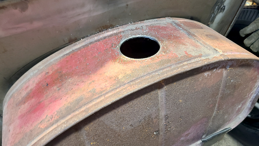

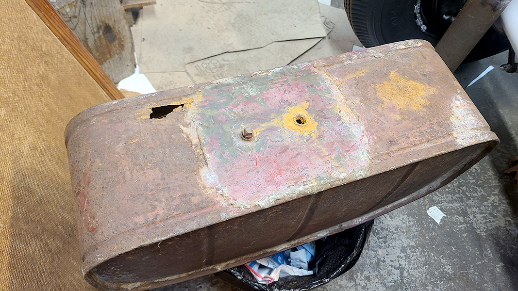

    Next, not unexpectedly, the tank I love and want to run has some issues. I had to find the center on the cap and run it out with a hole saw because it was hopelessly seized. Then I poked and prodded all the pitted areas and got my finger through them.

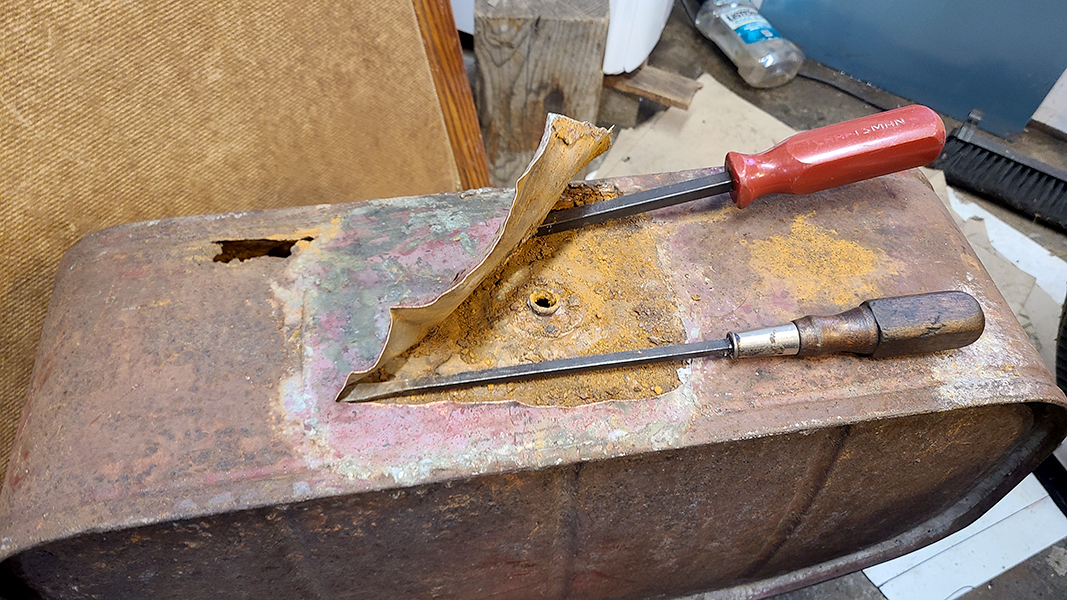

    THEN it was time to investigate the repair on the bottom. Apparently someone leaded a sheet of copper on there and used a 10 penny nail to fill the bead. It obviously worked but I am going to cook all the lead off this thing and weld in steel patches. This tank is worth the effort to me though I may run an other tank if it's not done by the time everything else is ready to go.

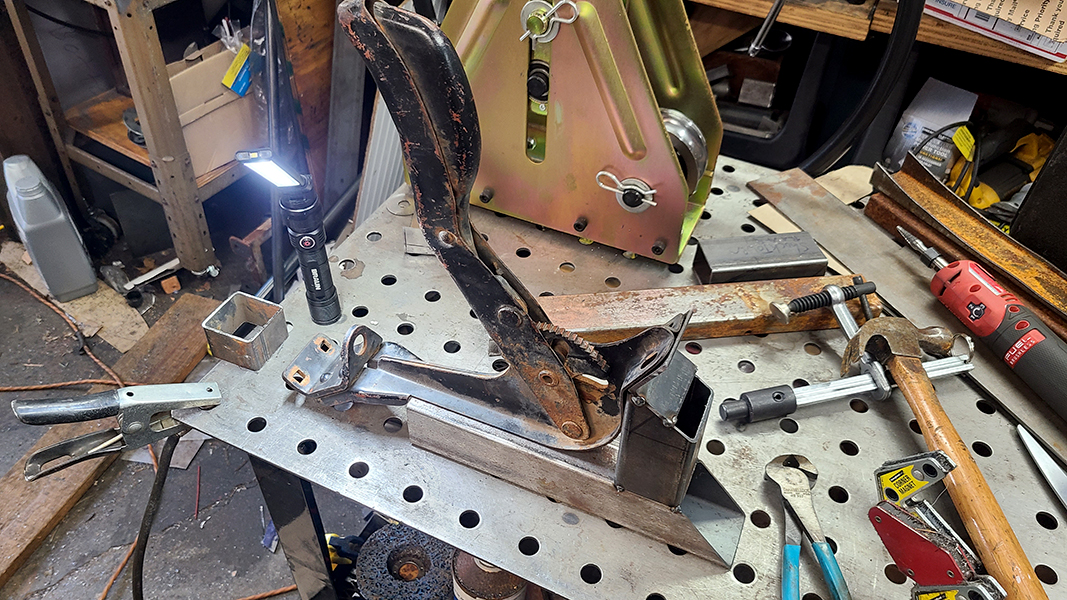

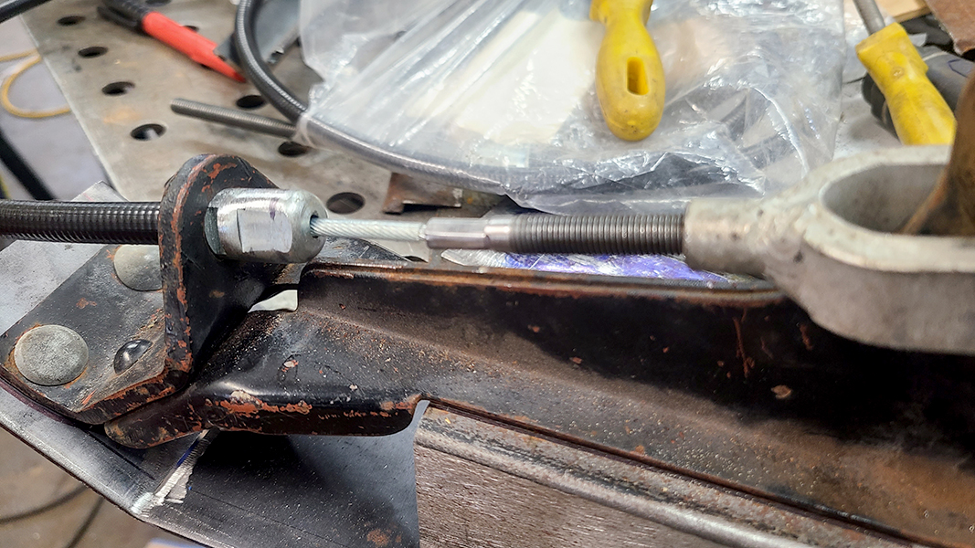

    Next up (actually before all the other stuff in this post) I worked on my 53-56 F100 parking brake and cable some more. I got a NOS clevis and then discovered the fitting on the repop cable needed filing to fit (thanks @toreadorxlt ) but once it did and I found a clip, I got it to work. Now I need to learn how to shorten a cable and find the parts I need to tie it in to the 46-48 p***enger car rear brakes. I'm also going to have to try to figure out how to mount this lever on whatever floor hump I need to make.

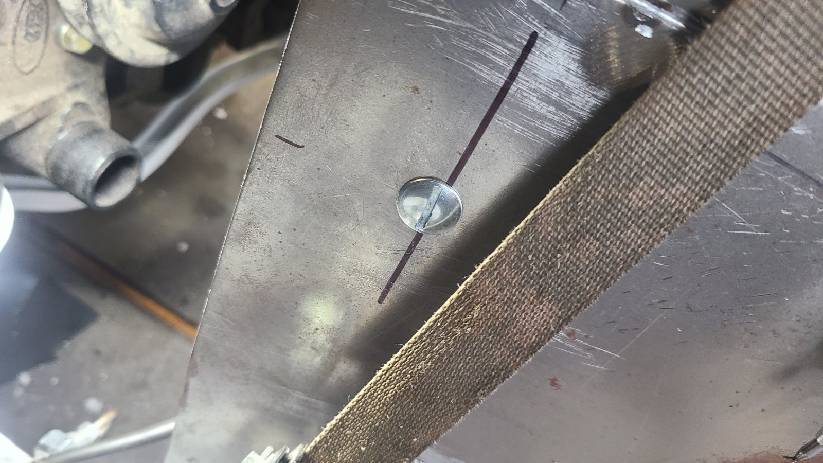

    SO, in the interest of speed and cutting down on working 16ga hammer-braking and or bending, I am looking at a 46-48 Direct Sheetmetal rear floor set that I can fit/trim. I like the flat top hump because it is easy to section and to mount my brake handle to. The general shape looks close enough to the lines of my subframe where this would go so I am hoping to be able to straight cut the middle to adjust any sizing.
    ALSO, I am ISO a F1 brake handle ***embly now because I think it might be a cleaner install than my F100 lever if anyone who reads this has one to spare.

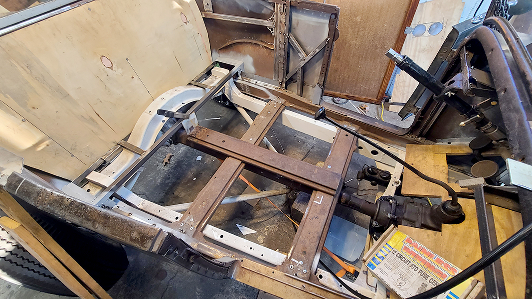

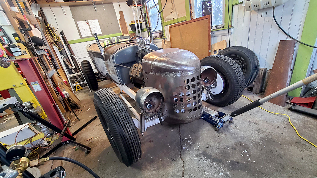

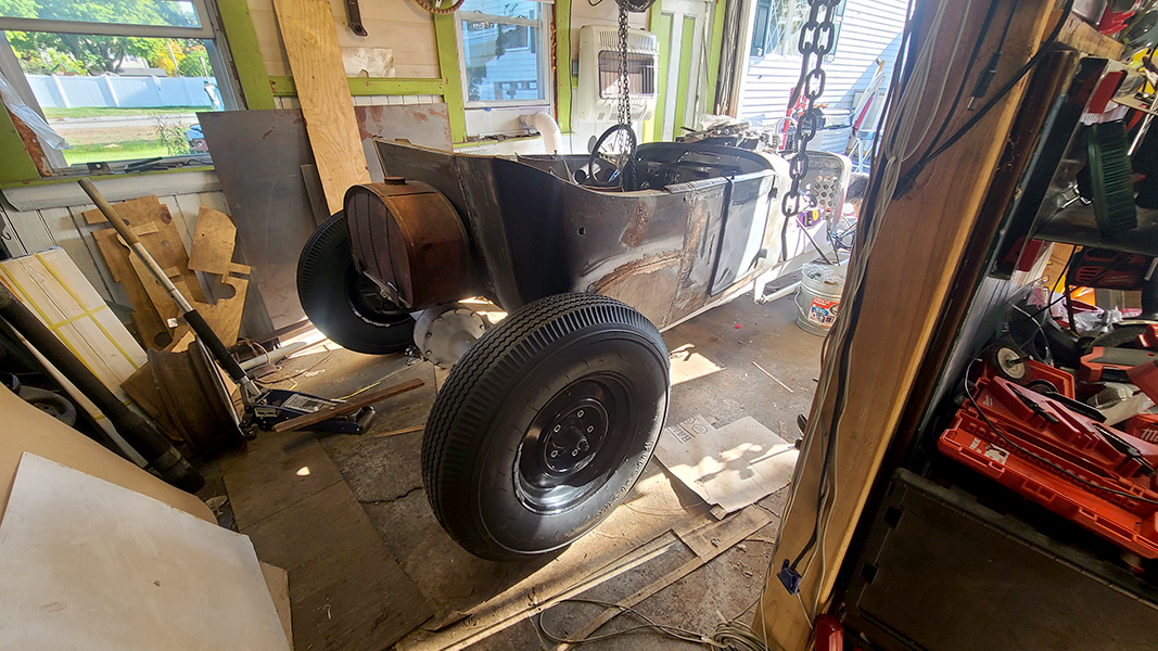

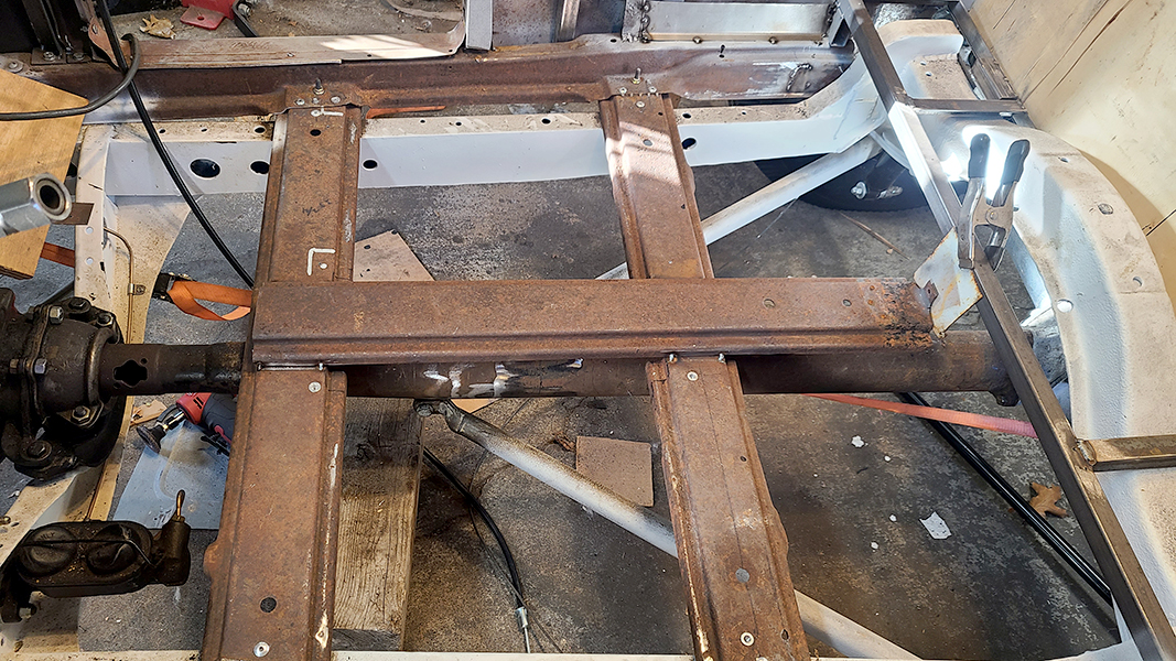

    OVERDUE UPDATES - I decided on a build with what you got solution for the floor. I took a couple pieces of subrail crossmember and ran down the middle. This gives me a good 3" or so clearance where I need it. Seats will still fit too.
    Got to use my little 8" powered bead roller to give the floor panel some strength after cutting on it.
    20230417_151344.jpg 20230417_150331.jpg 20230218_155157.jpg 20230130_155444.jpg

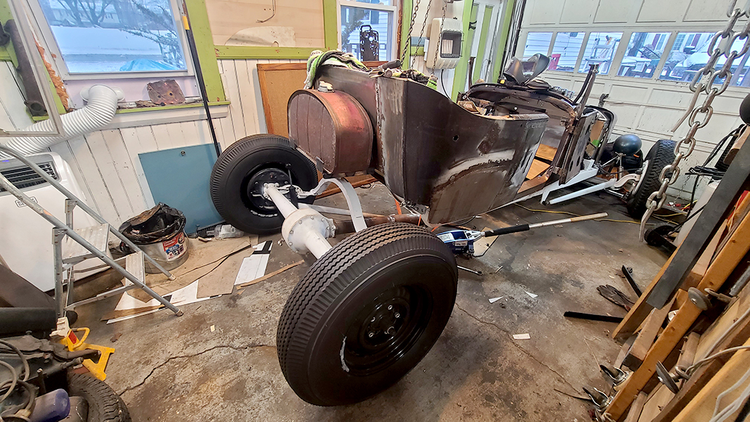

    I put my Firestones on the front and they lifted me up a bit more than I had expected. I'm no longer sitting with a rake and I had to adjust the at***ude of the block to get it right again. SO, guess what! I had to cut my mounts out, chop them down, shape them to fit around the steering box, and weld them back in! YAY! Honestly, they were too high anyway but it was a bit of a chore. I'm running half inch spacers under the transmission too now. If and when I step down to a smaller front tire I can pull the transmission spacers and keep things at the right level.
    20230417_151347.jpg 20230417_151344.jpg 20230417_150331.jpg 20230417_150216.jpg 20230416_163325.jpg 20230416_163216.jpg 20230409_161303.jpg 20230409_161238.jpg 20230326_141625.jpg 20230326_141619.jpg 20230225_154153.jpg 20230218_155157.jpg 20230130_155444.jpg 5116860-6225ea1d195a1724daafea8f0116b134.jpg 5116864-aa34c23527bcada32c7c9ae8f91caf02.jpg

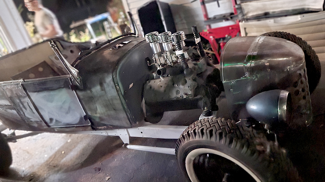

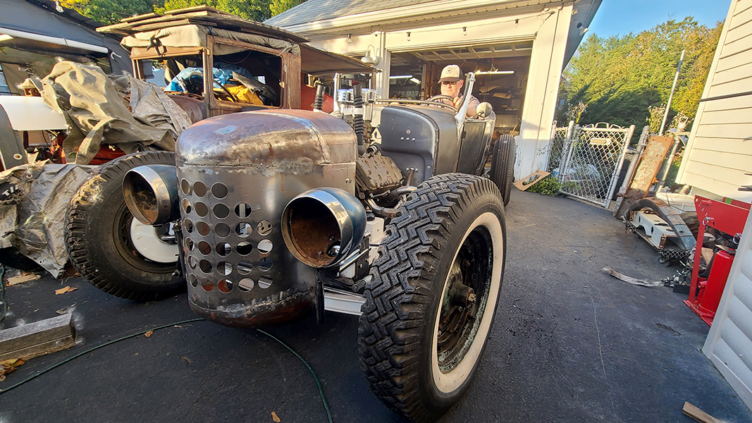

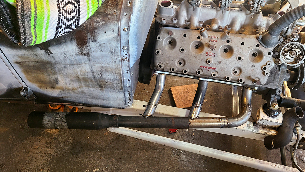

    Where to begin... It has been a minute since my last update. At this moment, I am scratching away at the last bits & bobs & newfound problems on the way to starting my engine!
    Here's what I've done along the way though:
    Block height: I've had to adjust that by cutting down the frame mounts and again with spacers to fine tune (no pix).

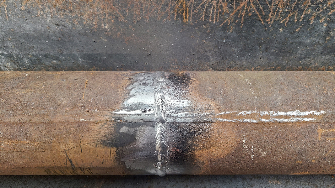

    Headers: I've tacked both headers together & put some exhaust hangers on the frame for the 3' gl***packs.
    20230429_152016.jpg 20230429_170225.jpg 20230707_144708.jpg 20230730_184326.jpg

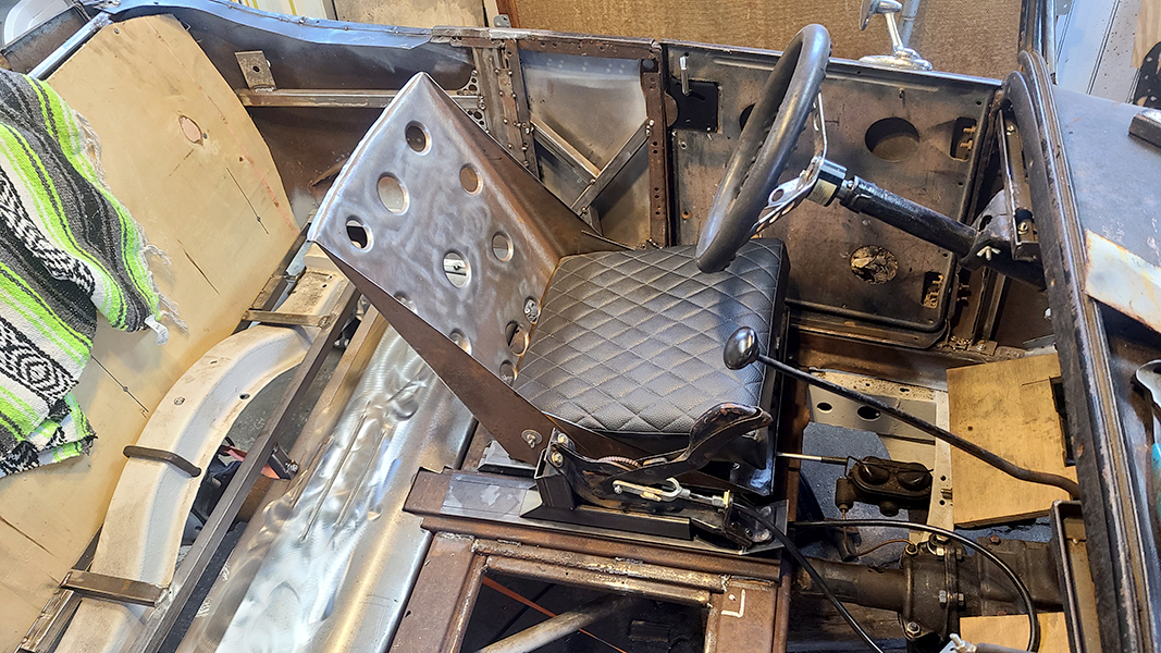

    Seats: I finally made a second cushion!
    Shocks: Fronts are mounted!

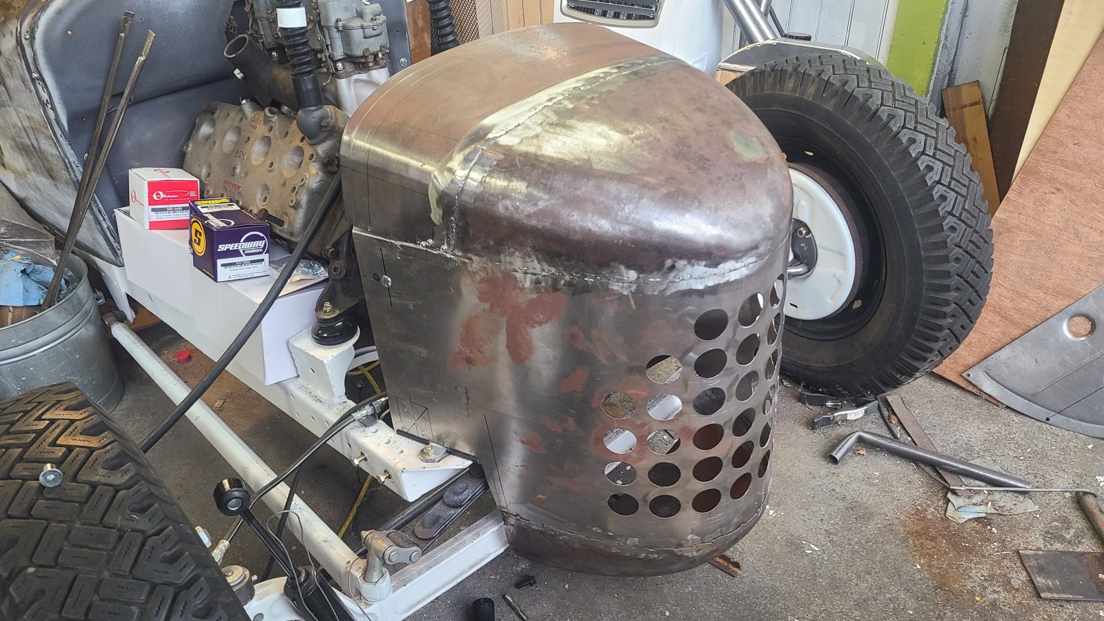

    THE FAN: I solved the fan issue by using a Merc fan hub & drilling the fan to bolt on.
    Nailhead A-V8, Stogy, OFT and 5 others like this.
