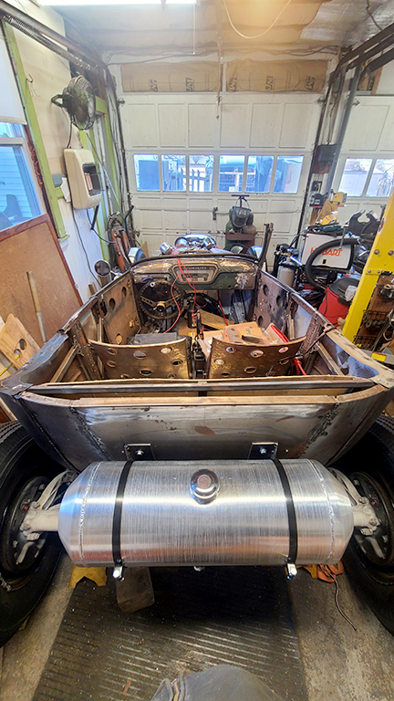

    I also mounted the "temporary" fuel tank (the little red one that I love needs A LOT of work)

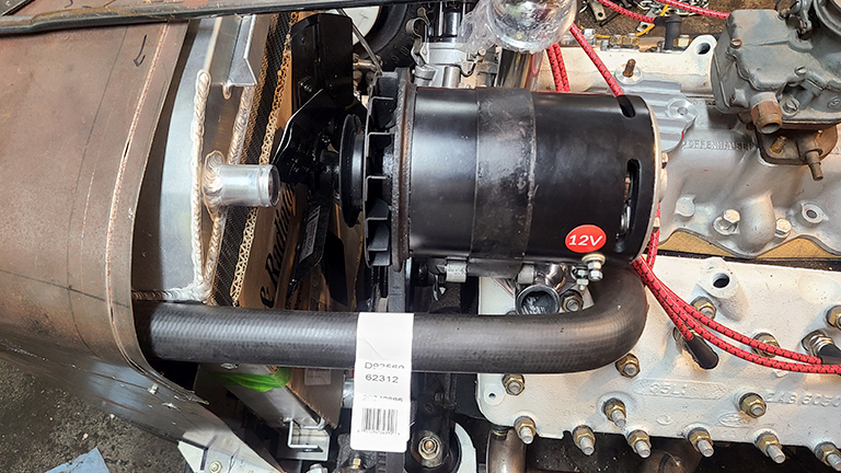

    How about a silicone hose bend or 2 to get around the generator? Speedway for instance has them in different sizes and even some with 2 different sizes to adapt from o e size to another.
    Just a thought...

    Find one of the brackets that mounts the generator off of the head bolts. Or better yet make one.
    It is really looking good. This would all be so easy if there weren't so many moving parts that have to work together. Like building a big model or show car. :eek:

    THANKS FOR THE LEAD! I will chase this path down.

    I think I am past that point potentially but we shall see. Do the head mount brackets drop the generator lower?
    I have some bends, I just need to get back out there and try them. Really, I wish I had a local radiator shop like the old timers all talk about. I don't think those are nearly as common now. I don't expect the multiple bends to really work long term but we shall see. I do need to get a bottle for my TIG but I don't want to try to weld thin aluminum for my first project in years so I'll probably end up soldering tubes to get tighter turns on the driver side. The lower is an issue as well because of the steering box.
    I wish I had set the engine back another inch and the body back 1-1/8" more because everything would be easier.
    Yes that means I have firewall clearance issues. The fuel pump that I wasn't thinking about when I made the recess on the firewall needs 1/8" more clearance because of course it does. It would also have made getting the body on and off of the frame A LOT easier but here we are.

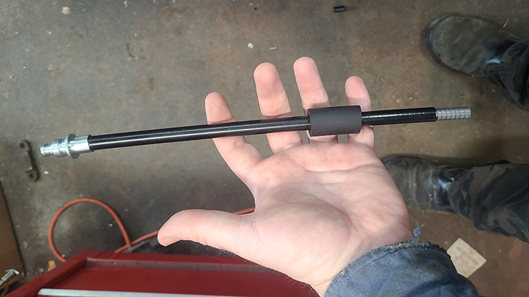

    IF I could find the correct ferrules, caps, fittings, etc. it would be simple but it's all seemingly unobtanium for a retail customer. The closest things I could find were for bicycles or for decking (wire rope stuff) as far as the Parking Brake Cable went. I did end up finding a nice new front parking brake cable from Bob Drake for a 39 Ford that's 37" long and has an anchor tab in the middle which should work just right for what I need to do.
    I have one of those Offy style cast aluminum pedals but nothing that came in the "universal" throttle cable kit was much of any use for connecting it. The Mr. Gasket cable kit Speedway sells them with does not look great to me either since I do not see how the blade end would p*** through the hole in the bracket without modification or constantly getting hung.
    I robbed the Lokar S**** pedal from the Basurati and hooked it up best I could just for the sake of making it function, and made a janky link to run a second carb.
    The second carb WOKE THE ENGINE RIGHT UP OMG.
    Really a lot of the problem I have is with parts availability here. This stuff isn't as easy to source as it must have once been. I am looking to build a rod actuated throttle and choke setup at this point since I can actually find that stuff and I think I can make it all work without a munch of Metric Mystery Hardware thrown into the mix.

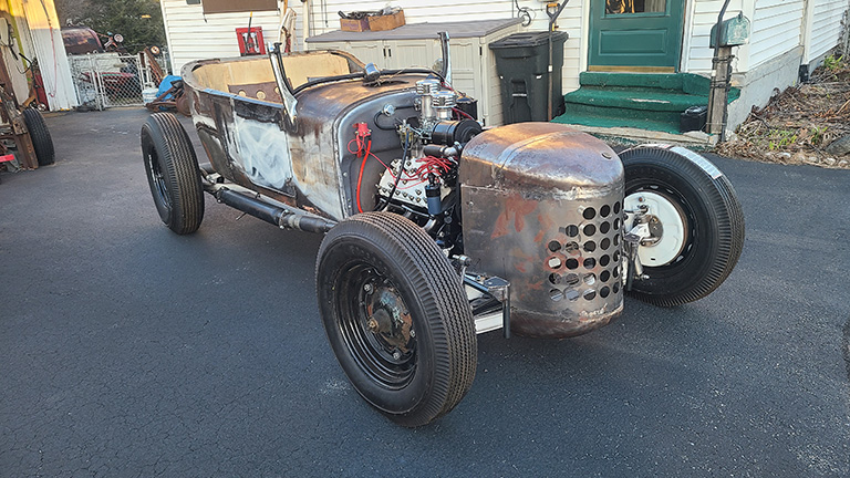

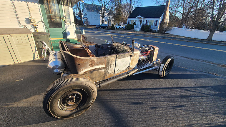

    I need to catch up on updates but, spoiler, I DROVE THE THUNDERCASKET TODAY!*
    (*to the end of the driveway)

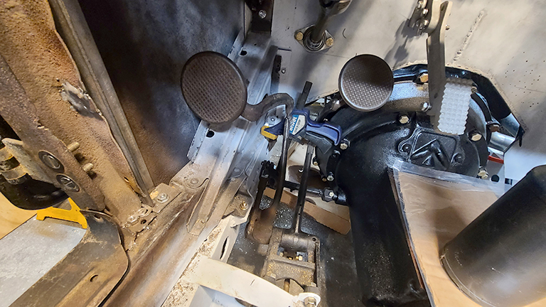

    On this throttle cable, I'd like it a lot more if the bracket was extended up inline or bent at an angle so it was a straight pull. It won't fray immediately, but just when you are comfortable it will.

    That is the main reason I don't like cables. They work when they shouldn't until they don't. :D

    YES, I hate the current throttle setup; it's barely functional and I want to replace it with rod linkage and put my cast Offy style pedal back in. Presently, I'm running the s**** out of the other car and a $17 Amazon cable that I cut up just to get going.
    I am picking up the rebuild 81 from Prewar & More this week, so I will be going back at ALL the linkages soon.
    The mechanical fuel pumps are still not pumping fuel to the carbs right so the electric pump has to be running. I may have a wiring issue with how it is set up now; the second $10 pump started coming in and out almost immediately yesterday. I have a Carter P4070 in hand that's going to be installed soon also. I will either just run it or I will wire it to the Start pole and use it for priming, we shall see.

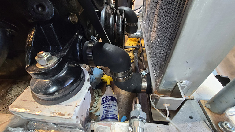

    OK, rewinding to catch up to how I got here. So, the RADIATOR has always been way too close and I did not find any simple options to correct that, so, I just had to make it work. I've probably got more money in hoses I've either cut up, ruined, or didn't use than I do in gauges for this car at this point. It was AN ENORMOUS PAIN getting all 4 hoses to work. I ended up cutting the lower driver side outlet & brazing (HF alumaweld) a Jegs elbow in there to clear the steering box (which is in a great place but in the way because the radiator is too close).

    The generator was interfering with the front carbs fuel inlet (this is why it is capped off with the two new 97s sitting to the back). I had to get an Edelbrock pas side bracket & have it cut to fit my Offy triple. This ended up working with a 58" belt AND I was able to get the fan working with a stock length belt while still clearing everything.
