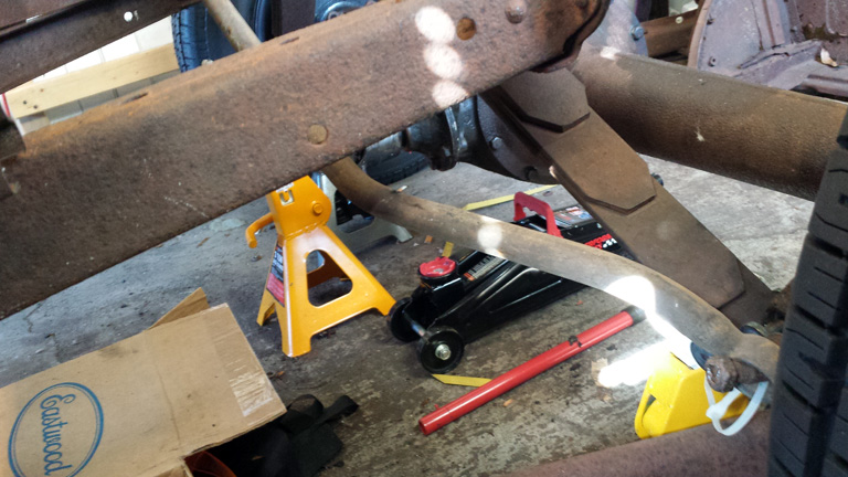

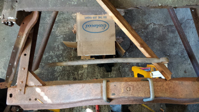

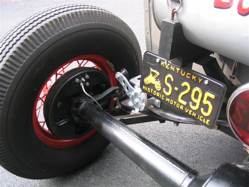

    Something does look odd...
    Here's mine for reference.
  2. patmanta
    Joined: May 10, 2011
    Posts: 3,882
    patmanta
    from Woburn, MA
    Yeah, your shackles look about half the length of mine. Though as it sits, I'm not sure if a shorter shackle would sit close to 45º under load with this spring.
    What are you running for a spring in yours?

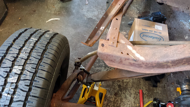

    As for relevant, meaningful things, I got my motor mounts off in preparation for fabricating a set of flatmounts. Once I get a set i like made, I'll post my design here. I haven't found any other than the coordinates that the Frenchtown Flyer posted, which I'm using.
    I also purchased a 48 rear track bar to see if I can incorporate it in my rear suspension design. I've got some pictures attached here. It looks like it will fit and not interfere with my driveshaft or frame, as long as I locate it properly and do my kickup cut far enough in to clear it.
    Opinions?

    Just wondering here...did you need to stretch the spring to reach the shackles?
    Seems like all the problem relates to the shackles being too long.
    Of course, I'M not there with it in front of me so I have no way of really knowing!
    The Panhard is a bit of a question mark.
    With the spring spread to reach and the shackles preloaded there is really no need for it, and the angle its on seems like it would thrust the frame sideways when you hit a good bump anyway.
    Panhard pivot points need to be the same height to prevent that.
    (Parallel to the ground...although really the bends in the bar are meaningless. It's the pivot points being the same height that makes the difference.)
    The later Fords used them because the springs weren't preloaded and the shackles basicly hung free, which allowed for a softer ride but no side to side sway control.
    In my mind, those radius arms are gonna need a torque arm as well.
    I would use the heavy 36 style as they are, but the ones you have are known to be weak and I've seem many pics of them cracking at the mounting holes etc.
    Better to build in the strength you need now!

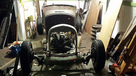

    Thanks! Sounds familiar! Are you trying to use the 27 frame or are you using something later? Also check my thread, Ford 300 to Model A Motor Mounts. They're not finished, but it will be and I'm sure it will help!
    I've actually gotten a lot farther since my last post, though not much of it is evident when looking at the car. I got a repro 28/29 grill shell finally so I can at least start seeing the car a little closer to what I'm going for.
    Other than that, I pulled the old, rusty, cracked and de-arched spring pack and bought a brand new one. I'm still fighting the old metal bushings in the spring perches however. I didn't have much luck with the hacksaw method but I'm gonna give it another go.
    I also fabbed up some motor mounting fixtures per blasted's post. My flux welder throws copious boogers and ugly welds, so I didn't take any pictures of them. I wasted the last of my time Sunday so they didn't get used. It was raining anyway and I gotta open the bay door to get my hoist in there anyway.
    Thanks! Yeah, I've given up on the track bar and the 40 bones for this build. I'm leaning heavily towards a set of Ladder Bars from RJ's since they're Alliance Vendors and can help me with the sizing if I need them shorter, which I likely will.
    As I said above, I got a new spring and I also got a set of shorter shackles. I'm still fighting the old bushings so it's not on there yet.
    I just didn't get as far as I wanted to this weekend. So, installing new kingpins up front, the new rear spring, and test mounting/locating the engine are still on the TO DO LIST... hopefully for 2013...
    Anyway, here she is with her face on. The hood is going to be long, just not THIS LONG; the engine is going to come forward a few inches.

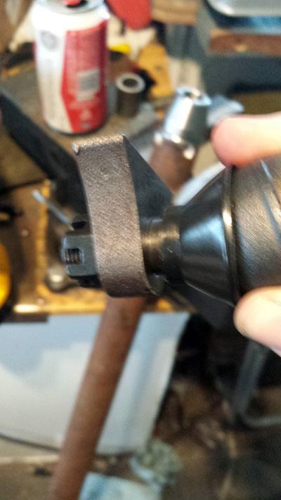

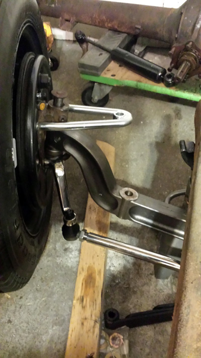

    OK, back in the shop all weekend. Started getting my tie rod and steering arms on. I've got 2 pas side F1 spindles with the stock arms chopped and ground off. I've got a pair of deep drop steering arms on them now. I think they will just barely clear the wishbones.
    I've also encountered a little trouble mounting that hoop steering arm to the F1 backing plate. One side can be done, but the other side, the bolt won't clear the brake cylinder. Right now it's just in there with one bolt and no grease shield. I'm going to have to take the whole thing apart and assemble it with the hoop first.
    I got my wishbones opened up, drilled for plug welds and got one bung tacked in before I ran out of time yesterday. I'm hoping to put things back together and see what I've got this weekend.
    I have a set of weld on "shock mounts" with the 7º taper that I'm trying to figure out if I can use for tabs to mount the front wishbones. At a minimum they give me something to clamp to the frame for mockup until I figure out if they're sufficient or not (Pic below).
    Here's where I'm at:

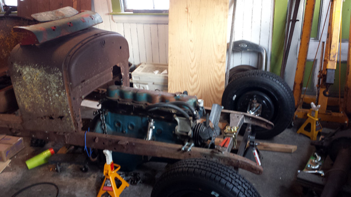

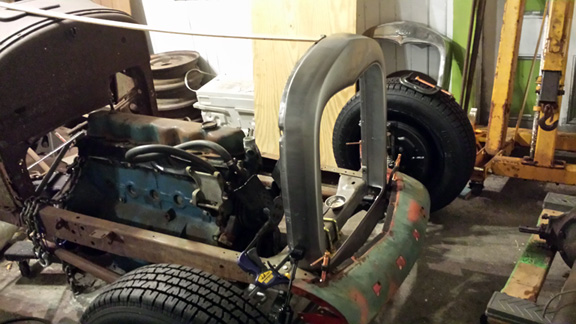

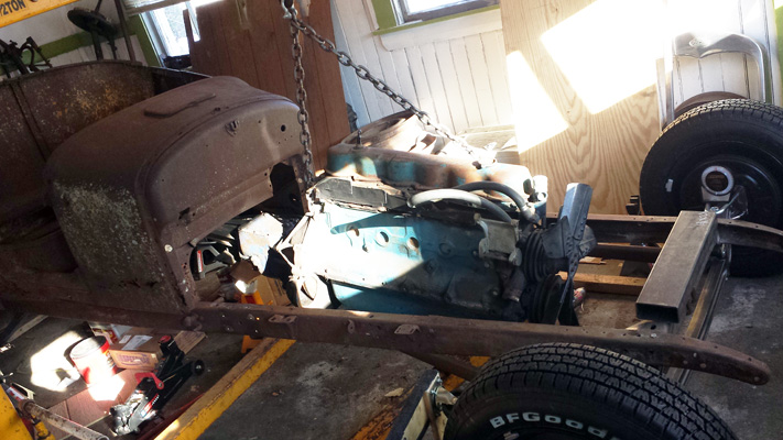

    More mockup progress this weekend.
    • I received the Vette driveshaft and it looks like it's going to be a good fit.
    • I reworked my temp mounts that I'd constructed based on blasted's thread, since my mounts are likely going to be near level with the frame.
    • As far as mounts go, I found a set of Ford mounts that are unlike most all of what I've seen. They're flat and centered. I can't find them anywhere online, but they're supposedly from an 87-97 application.
    • I managed to inch the hoist in there and work it and the engine into position. I've finally gotten the frame sprung and weighted. I just got new windows, so I ended up with some weights that came in handy.
    • My front shackles are looking good at 45º but the rear is still a bit shallow. I may pull a leaf out back and see if it settles a bit better.
    • The front crossmember is sitting at about 14" and the rear is at 19" with 2º of rake. It's still a bit much for my taste so I'm thinking a 2" to 2.5" kick up is in order if not more. I'd like to get lower overall but I'm not sure what my options are beyond what I've done up front with the dropped crossmember, axle, and reverse eye spring.
    • I'll be doing some cutting on the wishbones; they're pulling the caster back to about 2º from the 7º it was at naturally.

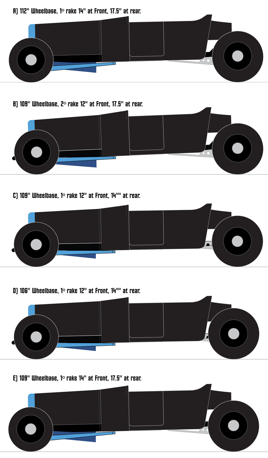

    I've got a scaled drawing together to help figure things out a bit.
    The wheelbase to ride height is something I'm pondering hard right now. This drawing is representative of where I will be with a 2.5" drop in the rear and without removing leaves (measured 14" at front and 16.5" at rear crossmember top rails).
    The wheelbase is @112" and I'm not sure how much that can change with the parts I've got without cutting on or replacing them. I can shift the engine forward a bit still if I pie cut the rear to drop and pull it in potentially. But that might also dictate a shorter drive shaft. I could go buy an un-cut set of 37 wishbones and pull my front axle behind the front crossmember and drop me down, but then my frame horns would be awful close if not protrude beyond the wheels.
