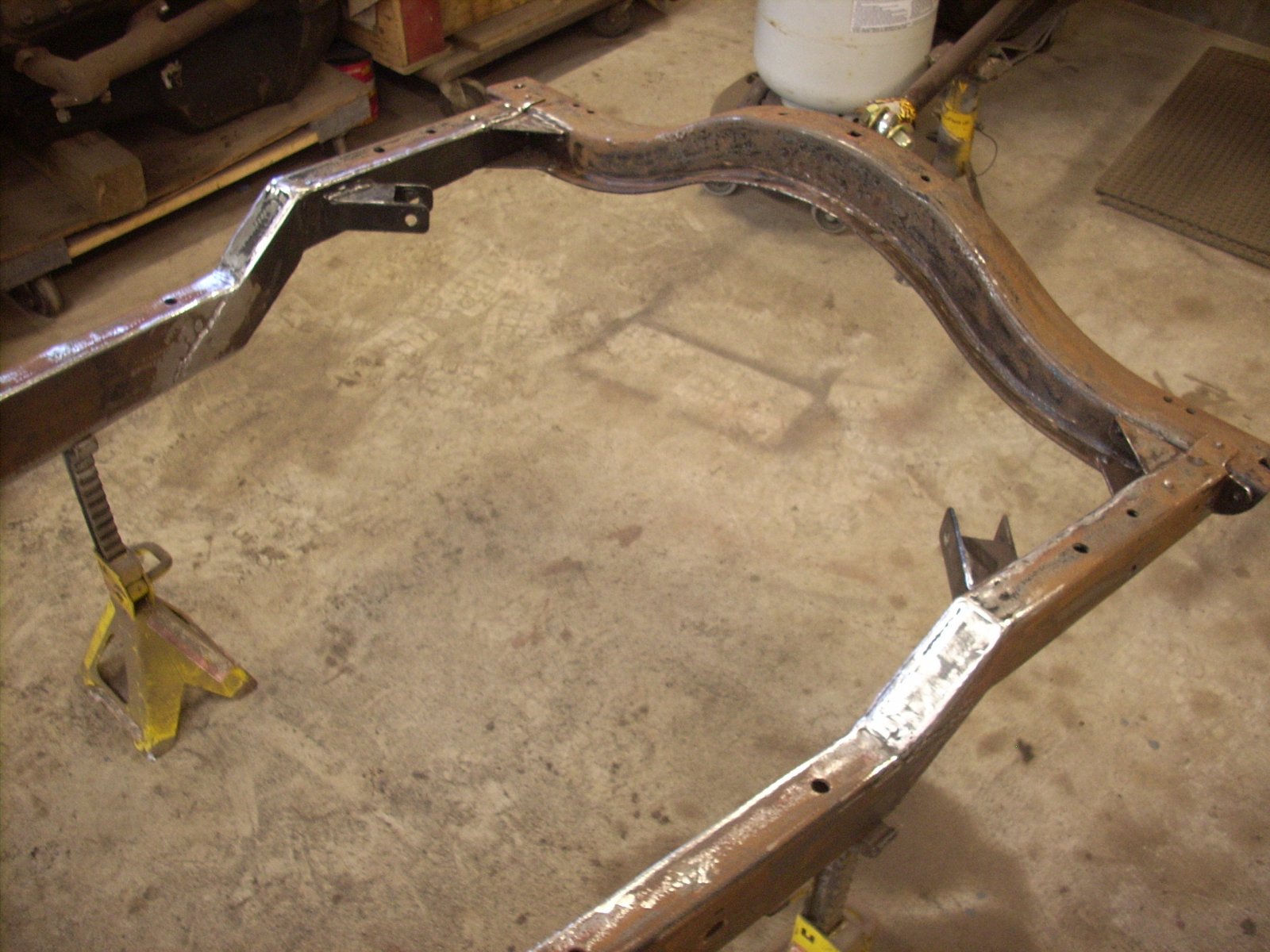

    Something has always bothered me about the Tardel Drop and I've never asked the question or stumbled upon the answer, so please bear with me here.
    The bottom of a Model A rail is tapered. So, when you move the cut section (45° cut) up and sit it on top of the rail flat, it would have a backward tilt to it.
    Is this just something that's negligible or is it something that gets corrected with a spacer I've just not seen mentioned?

  22. mike bowling
    Joined: Jan 1, 2013
    Posts: 3,559
    mike bowling
    Not enough to worry about- and that's a "Mike Bowling offset" ( I got the idea for on the HAMB)- no Tardel involvement on this baby. I got his book from a friend to locate my flattie motor mounts and found out it was BAD info ( so did 'em twice) Book went back, and "trial and error" was the name of the game. Besides , you learn more figuring things out yourself ( and I don't need no stinkin' directions!) Keep thrashin" my friend.
    chryslerfan55 and patmanta like this.
  23. mike bowling
    Joined: Jan 1, 2013
    Posts: 3,559
    mike bowling
    Afterthought- the top of the rail in back IS flat, so using a straight edge, make the tops parallel and everything should be finest kind. You also heed to remember the front to back taper and make sure everything is good that way too before welding it home. I always use angle iron to clamp and tack weld stuff, then check it 10 times ( diagonal measurements are always good to take). And I still wake up in the middle of the night and second guess myself!
    patmanta and volvobrynk like this.
