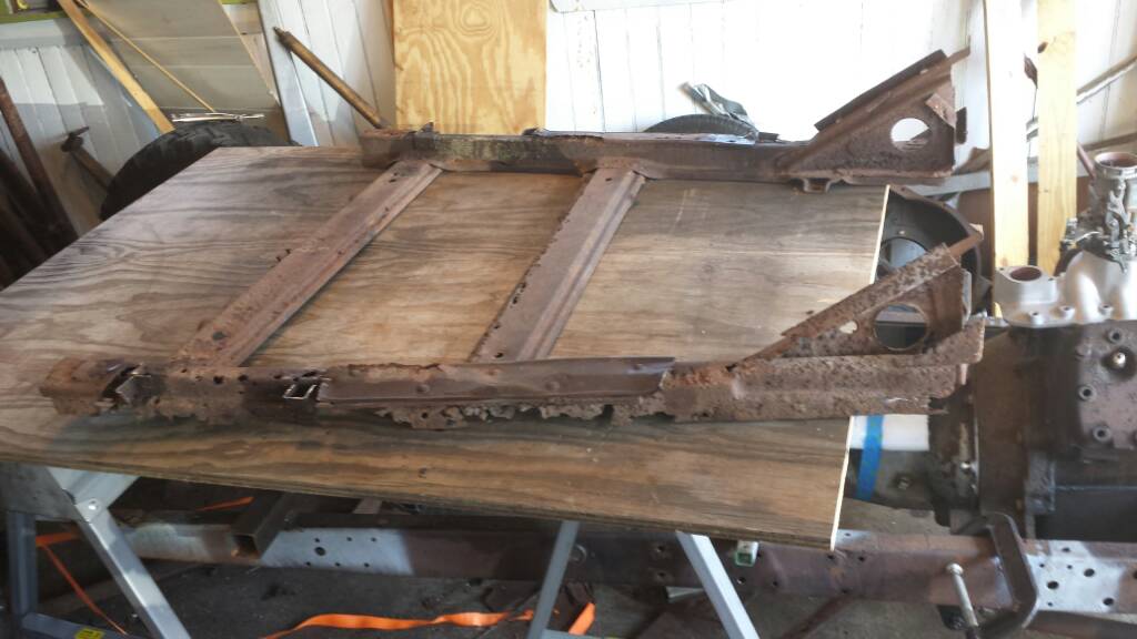

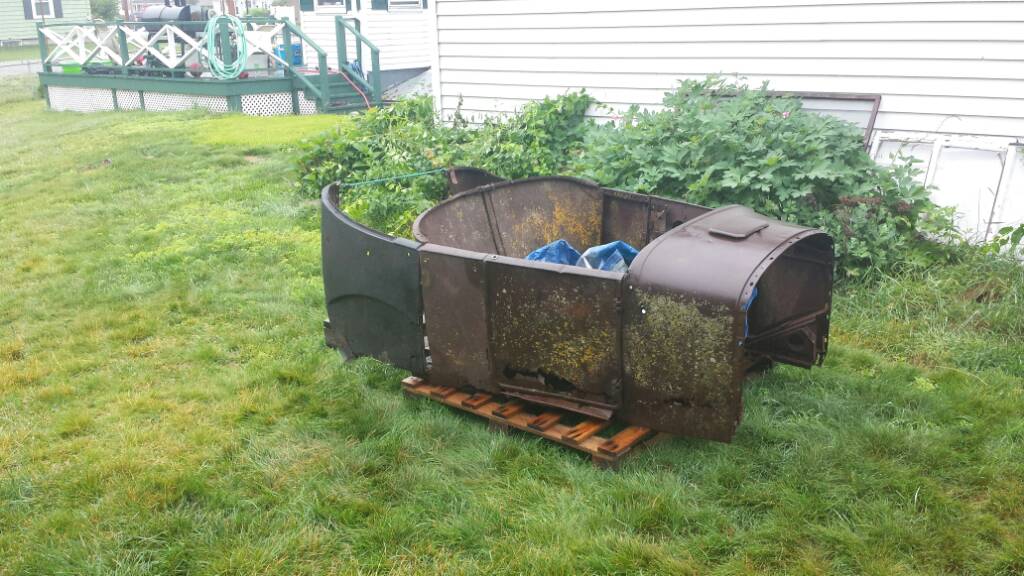

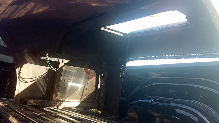

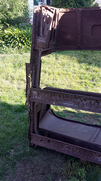

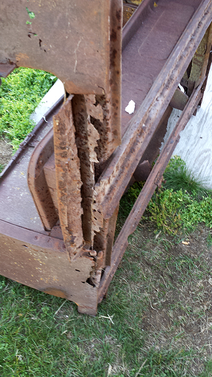

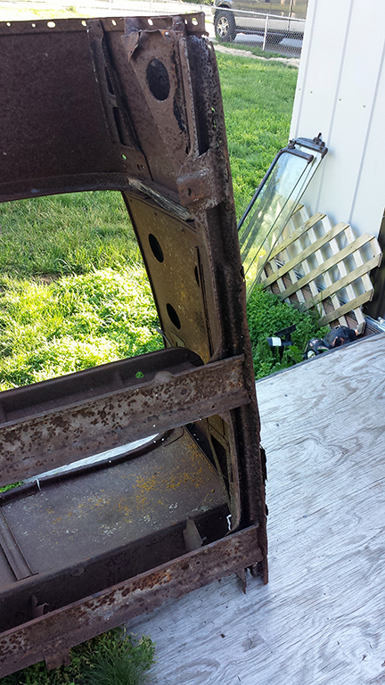

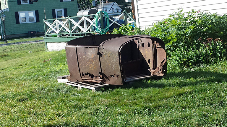

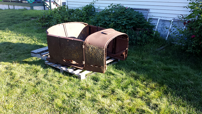

    Rained out of wanting to do Candia today so I butchered my body instead. this is the general idea.
    I discovered that the rear quarters on a touring body are no small task to remove cleanly. There are ***orted, hidden spot welds conecting the front portion of the rear sheet metal to both the rear section and the substructure. If this body were in better shape, I would have taken the time to deal with it, but since I'm going to need to cut most of the lower portions away and re-make a lot of the structure anyway, I just cut it up.

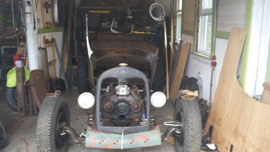

    Put the floppy body on.
    It looks like the rear crossmember is going to end up right at the back of the body, possibly neither inside nor outside, which is going to pose some issues as far as sheet metal.

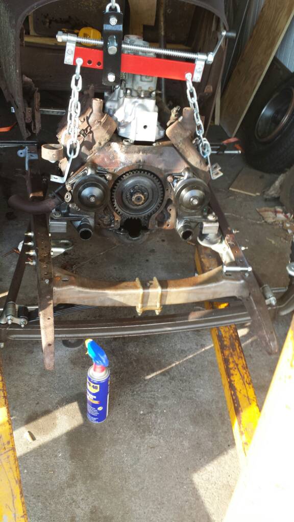

    In further photo dumping news from the weekend. I have discovered a couple issues with where the engine is sitting. Firstly, My Torque Tube wants to sit at about 0° and secondly, I have little to no clearance to run a set of lakes style headers; even the stock headers will take some doing to get in there.
    The mounts I used are about a half inch or so lower than flush mount. SO, it looks like I may need to remove them and go with another set which can be raised to flush or even potentially above the top rail. Right now the top of the rail is sitting at 16" at the motor mount and 20" right before the rear kick up.
    That flange and bend coming off the front port is just the piece from the stock headers bolted right on to the block. It is making contact with the frame.

    I may not get much done until the end of July at this point. So much going on that I want to get to do.
    Next things on my knock list are making motor mount spacers to fix that issue (see my thread,
    Flathead Biscuit Mount Shoulder Bolt & Spacer Use?) and pulling the body off of the subframe. I need to make a new subframe; plan is to use flat stock and weld/bend it around the perimeter, then weld that to some 3" flat stock crossmembers, cut it loose and build the rest of the floor structure.

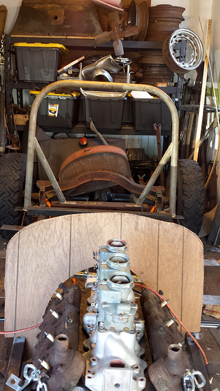

    Did a staycation last week. It was my birthday, so we did Candia (I actually sold [then bought] a good number of things) and spent most of the week and weekend on the car. I also fit in some time to drop @BenLeBlanc 's frame with my neighbor, Paul G. (who might be taking the 1917 Dodge off my hands to do one last build).
    I did my motor mount spacers, which there will be a Version 2.0 of, with an angle cut to the inside so I cover the entire top of the biscuit.
    I also got my subframe cut out and the template made up for. I'm going to do a detailed thread on that operation, because I don't think I ever found one that covered what I did. I learned pretty quick that spraying the whole area with WD40 before hitting it with the sawzall keeps the rust dust out of my eyes.

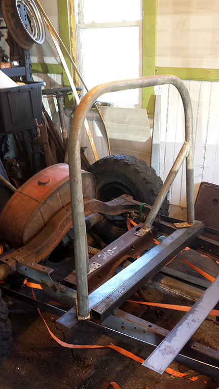

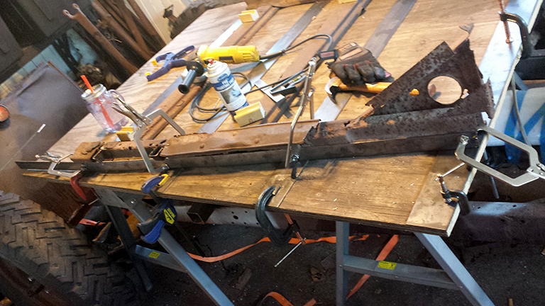

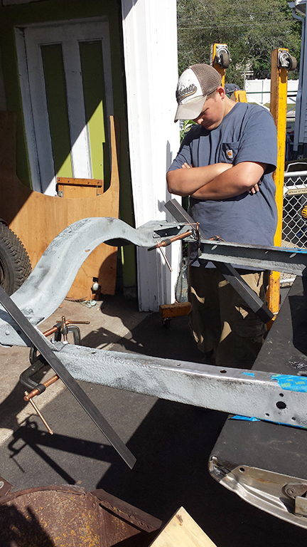

    This weekend was almost entirely awesome. I say almost, because while working on fabricating my subframe, I stepped on a metal spike, that I had made by accident when my portaband wandered a bit off course. (I'll insert a photo of it later). That ended my Saturday early, but fortunately, I backed off it once it had pierced my shoe and just the skin of my foot instead of going into meat and bone.
    Before that, I made progress on the subframe. I built a cross brace / cowl hoop. I built it too tall, but you get the idea, which is to have it come under the cowl bracing. Once I shorten it, I can cut the flat bar to fit around the transmission and bell. It almost fits now as you can see in the pictures.
    20150808_160748.jpg 20150808_182555.jpg 20150808_182608.jpg 20150808_182618.jpg 20150808_182623.jpg
    I'm just going to cut the vertical pieces in the middle and drop them down to fit snug against the bottom of the cowl brace I think. Though I'm thinking a urethane spacer might be an idea.
    The portaband makes pretty nice, flush cuts for the most part (I'll go over these spots with the TIG again, they're already welded on the inside now). My neighbor keeps telling me to use my vintage Craftsman jigsaw though. He says that's what they used to use for just about anything that didn't require a torch.

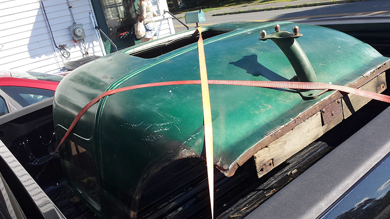

    I was up and around early Sunday and went to the Fryeburg ME Swap Meet. It's annual and only the second year so it wasn't really big. The Down East ****ering guys were supposed to be there but I didn't see any evidence of them. Anyway, the point is that there were indeed HAMBy parts there and I bought this rear section for a 30 Murray Body Sedan for FIVE DOLLARS! I may end up using the body I make from it with the other A frame I have and the 300 big six from the origins of this build to get something very different, perhaps somewhat akin to the Modified Murray or a Bantam dragster.

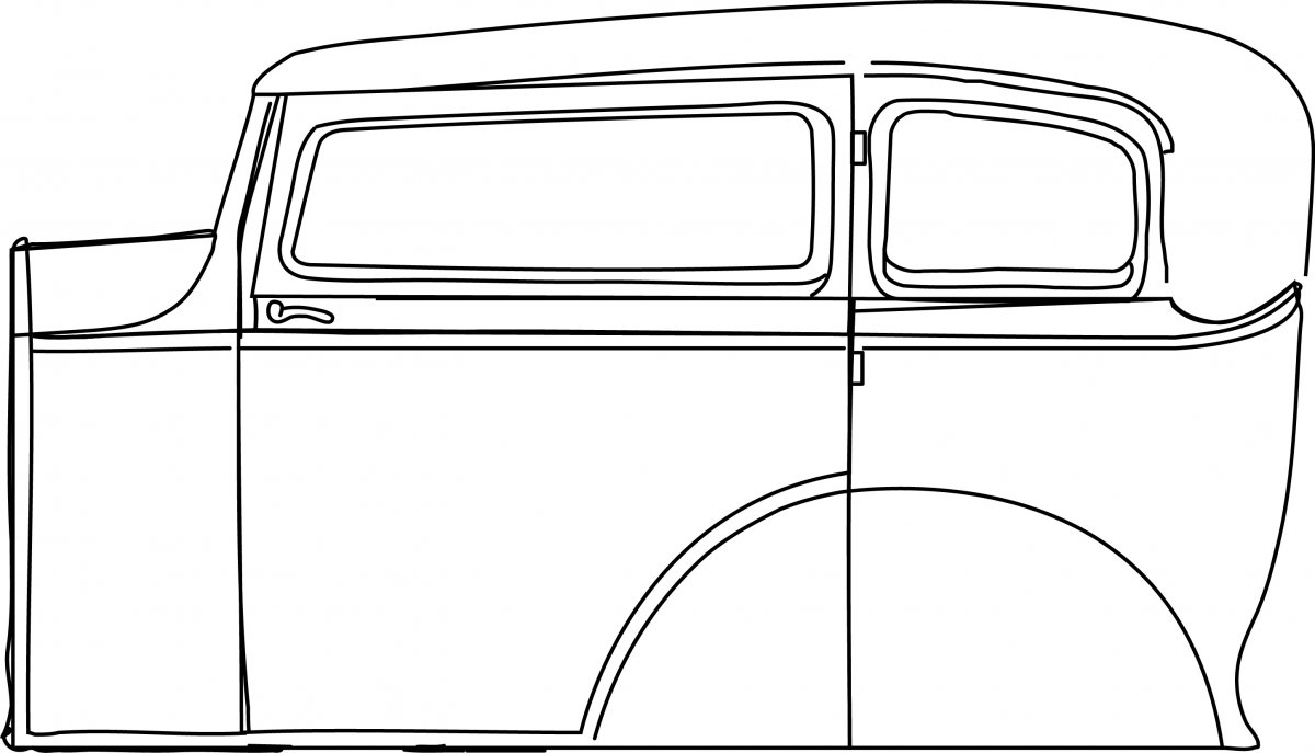

    But right now I'm looking at it with a bit more ambition and imagination. I'm seeing more of a 60's show rod with a healthy dollop of metalwork.
    Stretch the doors forward 4-8"
    Slanted chop
    35 Front window, A pillar, and roof

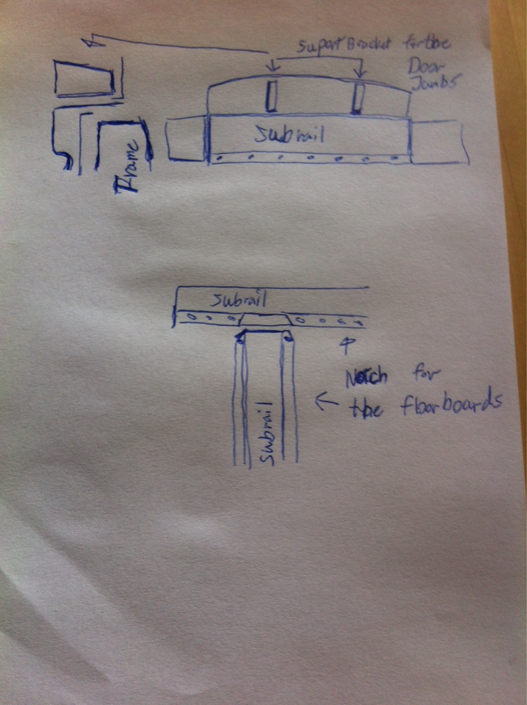

    Here is a crude sketch:
    Thanks!
    I'm going to try and go more in-depth and make a tech thread. I've got to work it out and digest it first through. My first thought for improving the process is to use the steps I took to make a form and then running the material inside it, which would yield a subframe with the same OD as the original. I am probably going to do this since I have another cowl sitting around and I'll eventually want to build it.

    I've never been a fan of the square tubing substructures because of the loss of height inside the car sometimes and I just don't care for the way they look from under the car, (just my personal opinion, I know some folks love that look). I've been building most of my stuff much like a factory floor but it requires a large amount of layout time and some serious templating. The repop subrails are a bargain but I build a lot of channeled cars and odd rods which they are not available for. Your method is simple an cost effective.

    I've been approaching this method mainly from the Channeling front from the beginning, so I've tried to think it out to be able to go either way. The real challenge with making a subframe, no matter what you use, is nailing the outer perimeter; you can use anything you want, elegant or crude, go get the sills and body mounts but that outer line is the magic.
    Since I have not found ANY Model T subrails being reproduced or good plans for the originals, I knew I had to come up with something and use my rotten subframe to do it.
    For someone that's doing cars for customers repeatedly (I'm not there yet), I'd suggest taking whatever subframes you've got and making jigs like I've started my subframe. That will net you a form that can be used over and over and will give you the correct contour and OD to fit original sheetmetal without modification (I think I said that already, oh well).
    As for my plan, I am going to need to stiffen the cross structure; the 3" flat is great for forming but gets floppy once it's set on the frame. For a wood floor build, the simple solution is to use half inch angle and but it against the flat stock. I'm not finding any real gain in using box or rectangle tube to do this with the steel shapes I can get locally and angle is easier to weld on IMO. The angle is the same thickness as the rest of the structure and the only half inch tube I can get is half the thickness. I don't see any gain in weight loss between the two options and the angle will be SUPER easy to weld in comparison. I may consider t******* the top edge of the angle for a steel floor insert and/OR just try to keep it out of the way.
