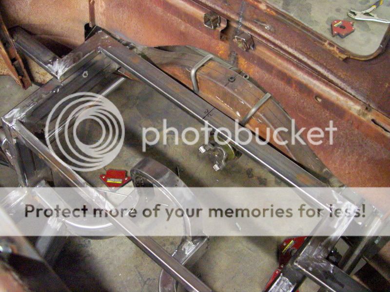

    Here's what I started with. Drive shaft loops.
    Since I don't have a mandrel bender, I had to made them by hand...
    The tall one is for the upper rear and the small one is for the lower front.
    The front one I'm putting off for a bit until I get the 2x1/4 flat bar bent up for the top of the loop. The rear loop is ready to weld in though... SOOO...
    The welds will get finished off with the rest of the frame welds once the body comes off and I can flip it over.
    Next, the rear sub-floor above the Z-d portion of the frame needed to get some modification. The 1x2 runs right over the middle of the kick up and it needs to be moved so I can access the area below a little easier where the battery and some storage will be.
    Before (notice the 1x2)
    And after the modification.
    To add more strength to the body sides below the quarter window regulators, I added some reinforcements that will get tied into the subfloor as well.

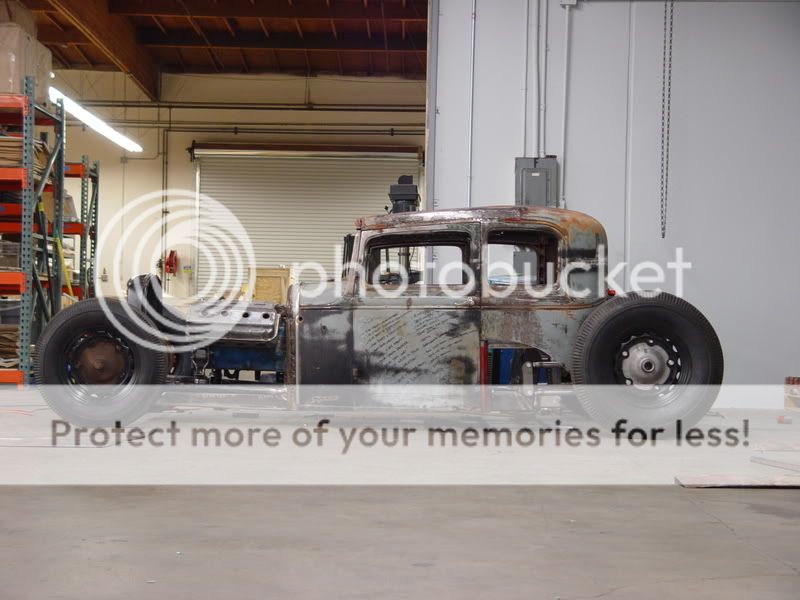

    And I can finally get a decent profile picture showing the stance.
    Man... working on this thing feels like I'm running a marathon sometimes. I'm sore, and not in "working shape". It will be a little easier to finish that sub-floor with that bracing out of the way, but crawing around in this thing is deffinitely challenging sometimes.
    So, you guys should see some real progross over the next month or two. I have a lot of things to address and I'm shifting the focus to the body and subfloor for awhile. Here's what I need to look at next... (not in this order, per say)
