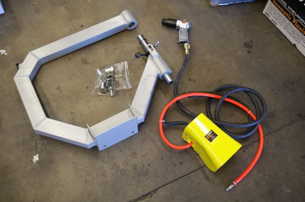

    Okay... Sorta slow going, but going, none the less!

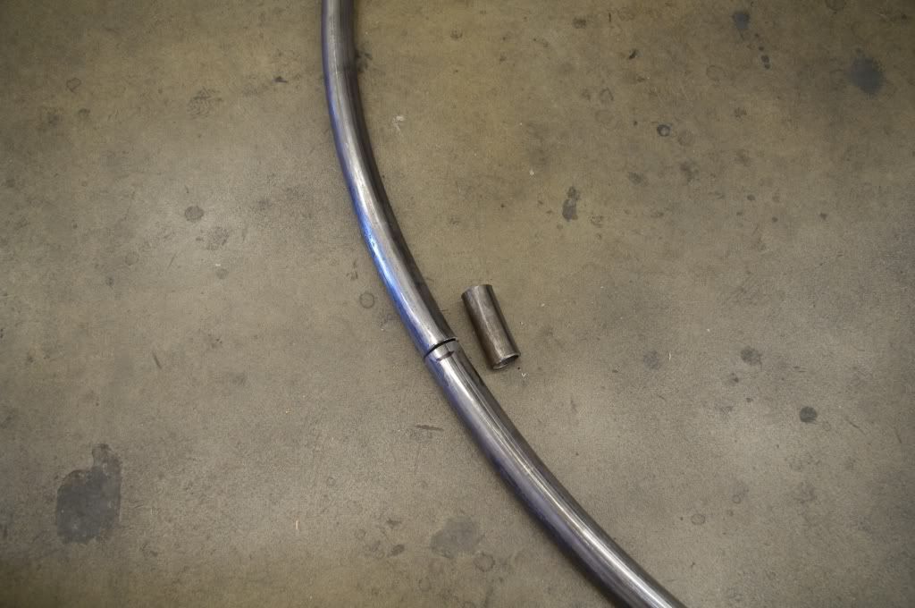

    I'm in the final stretch of frame prep before primer. Been working on the hoops for the rotisserie a little bit each night after work. The hoops are really starting to come together now....
    The 1-1/4" tubing will also be rolled to match the radius of the two halves and I will cut off about 6-inches or so to use as a plug to join the two halves together. Should make the joints really stong when full welded together.
    The last 5 inches, or so, of each hoop halve has to be cut off. It does not see the full radius of the bend because of the distance between the top driver die and the two lower dies. So I had to roll just slightly past a half-hoop.
    Then the v-groove wheels I picked up will be modified slightly, on a lathe, so that the tubing will ride in them a little better. I think each wheel is rated for around 700 pounds, so that should be more than enough capacity once it's all together and ***embled for anything I will use the hoops for...
    For awhile now I have been thinking of building a planishing hammer for some up-coming pieces that need to be made/finished. That "unmentionable store" had them on sale for cheap and then I had a coupon. So for $80 I got something that I can modify, build a stand for, etc.. For that price it was worth it just for the pedal ***embly and the dies. The air hammer will eventually get replaced with a good quality 4X riveter, and I'll make some more dies for it as well. 90% of the frame will probably get junked.

    Not a huge update, but something, none the less. It was a ton of work rolling these hoops to such a tight radius, but they are finally done and ready to be welded up...
    The smaller diameter curved bar is the tubing that will be used for plugging each welded joint...
    Going to try and do the final fit tonight and weld them up, if I have time.
