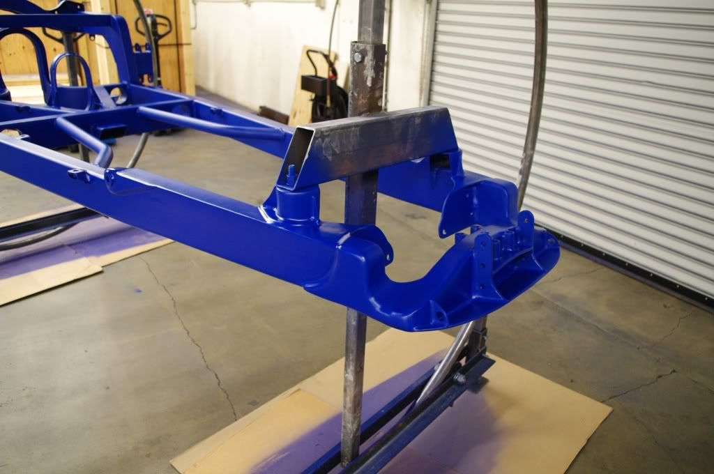

    Okay! Getting REALLY close to another milestone! The frame, after TONS of sanding and prep work, is finally in PRIMER! I have some block work to do, and a couple touch-up spots including where the front rotisserie mount is, but other than that, it's ready to get color!! WOOHOO!
    Here's another SMURFY primer update! :D
    Outside in the light...

    K13
    Looks great Scott. That blue is retina burning.:D
  28. You should just roll with the primer. :p

    Now, gotta ask, is the blue primer specifically needed for the final color or was it just luck of the draw?
