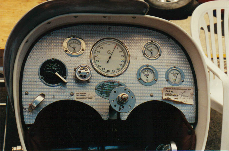

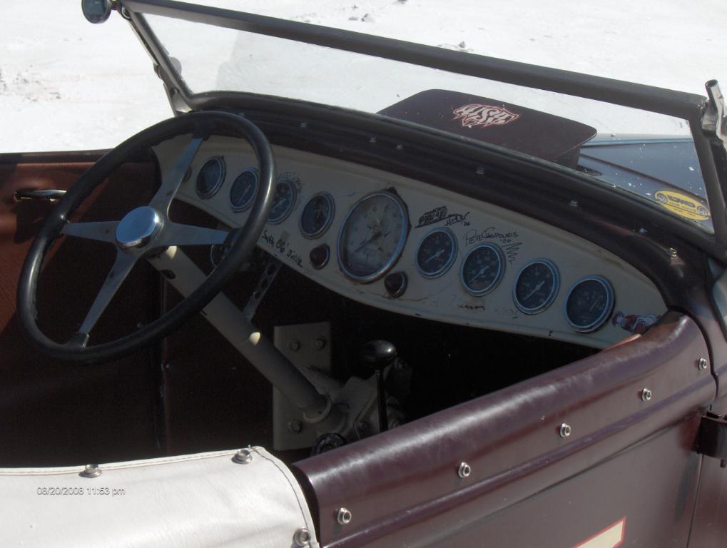

    I guess I don't HAVE to have a rolled edge... I would like to see some examples of flat panel dashes like this this actually DO have rolled edges.
    Here's some dashes that were inspirational...
  9. 1/8" thick you could just put a slight bevel on the edge. Round it off with a few strokes of the file.
  10. scootermcrad
    Joined: Sep 20, 2005
    Posts: 12,383
    scootermcrad
    Yeah, thinkin' of doing that and just being done with it. Easy cheesy...

    Study the GP Bugatti dash/firewall it is a one piece unit and strong enough to save a few drivers in a rollover back in the day. The two aluminum panels are riveted to aluminum angle about 1x1, that is what the copper rivets are holding together.[​IMG]
