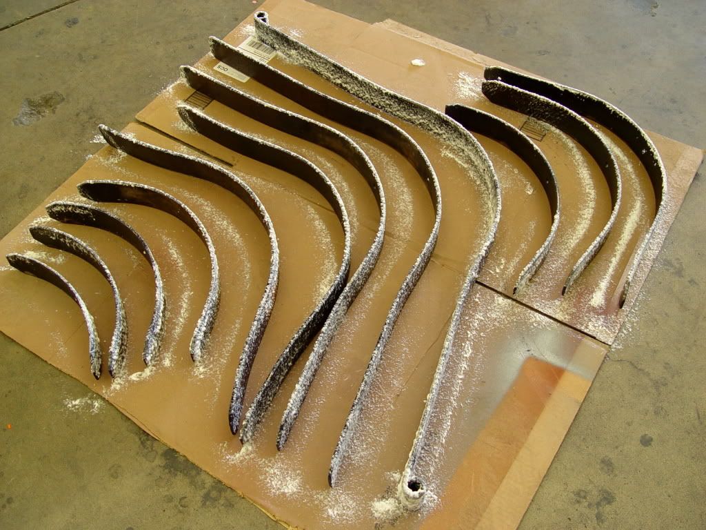

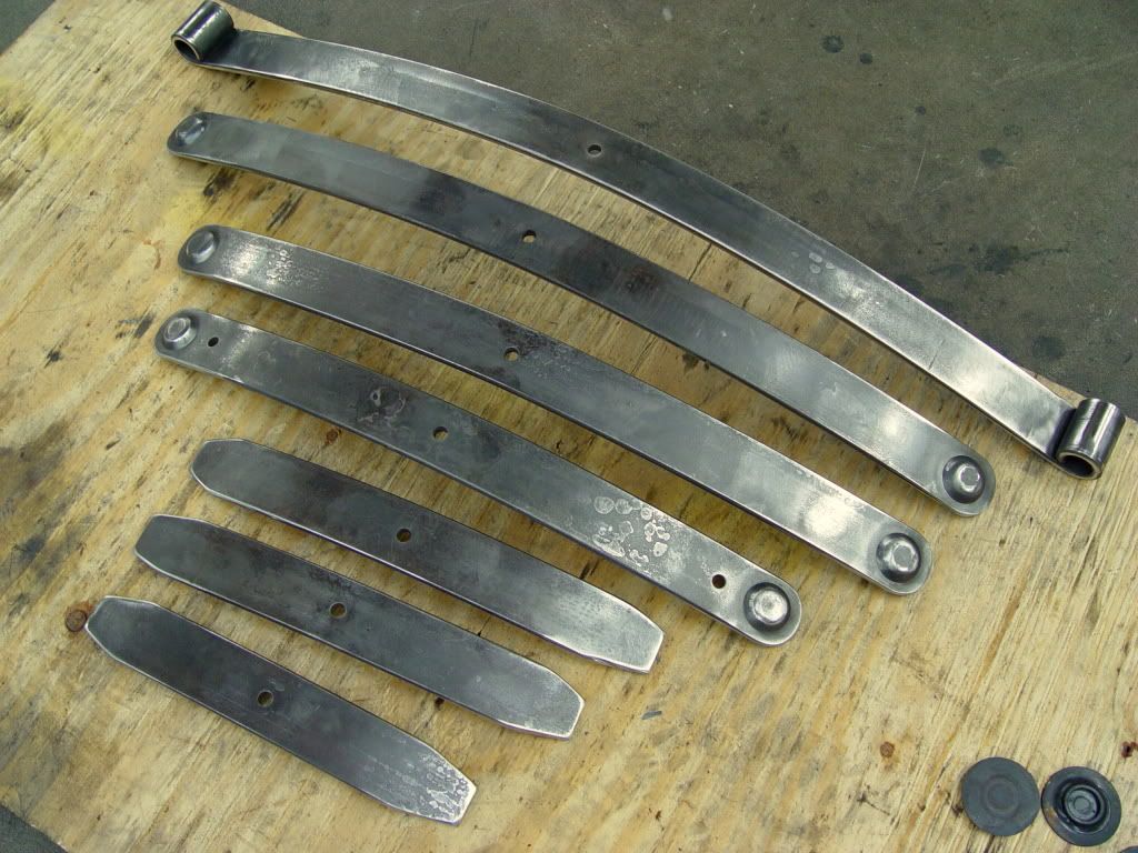

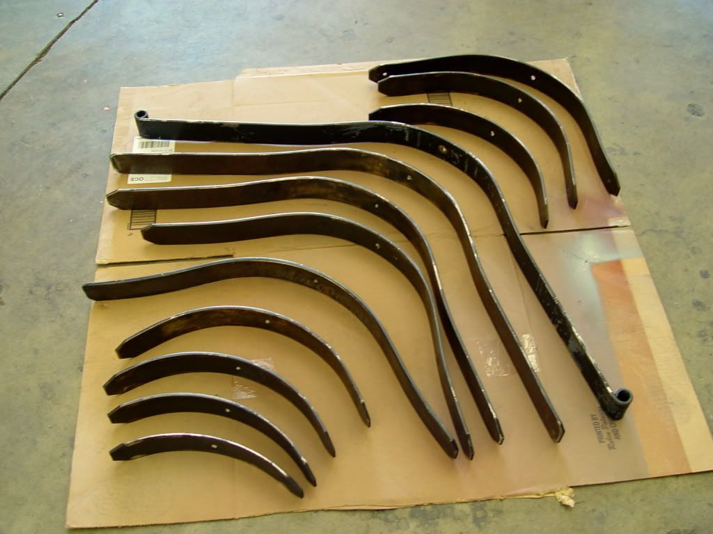

    The thing that I was REALLY dreading was getting the springs all prepped for paint.
    The front spring is a Posies superslide "HD".
    The squared lookd of the support springs at the top of the spring pack was killing me, so I taped them to look more like a stock Model A spring.
    Then it was time for the rear spring! WHAT A MESS!!! New and old grease to remove, strip the paint, there was even a little bit of CHROME left on there! What a nasty job! Hours just cleaning and stripping this thing! In addition, I polished all of the adjoining surfaces where the ends of the springs had worn from sliding. Also rounded off the bottom edges so the could slide better.
    After some serious scrubbing, s****ing, wirebrushing, and abrasive work, the leaves are ready for primer and paint!
