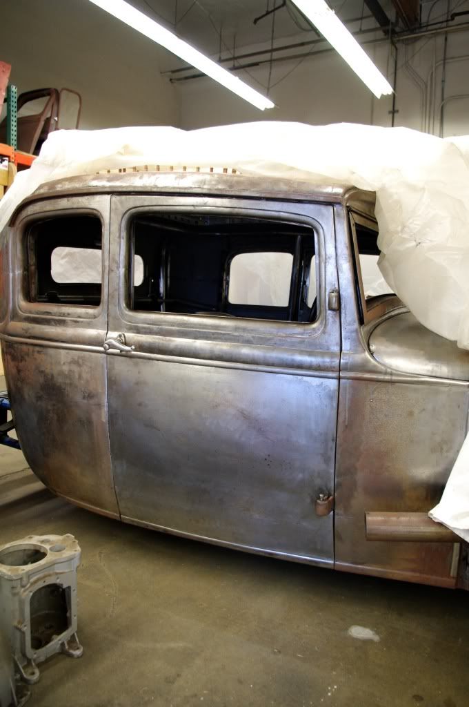

    So I haven't done much of any updates lately. Been really busy, but haven't been taking a lot of pictures. Just been putting the hammer down, but also have had a lot of stuff to do at home... And... Well... I bought another project to do after I work on all my other projects. :rolleyes::eek:
    Since most of the exterior bolt-on stuff has paint on it now, I've been focusing my attention on the doors and the body. Mostly the doors. I put patch panels in the doors awhile back, but wasn't happy with the seams after I was done. So I went back and straightened those out. Lots of hammer and dolly work as well as using the shrinking dist and redoing parts of the seam. They are going to get a little filler, but they're not too shabby overall. The front and trailing edges of the panels needed attention as well so the door gap was correct. MORE finessing...
    Inside bottom of both doors was completely rotted out. So far I've reconstructed the passenger side, but still have to do the driver's side.
    Chop seams on both doors had to be finished as well as making the window retainer and garnish molding mounts from scratch. Looking good, but MAN, it was a ton of work. Never dreamed these doors would need this much attention. :eek::eek:
    Here's how they're shaping up, though...

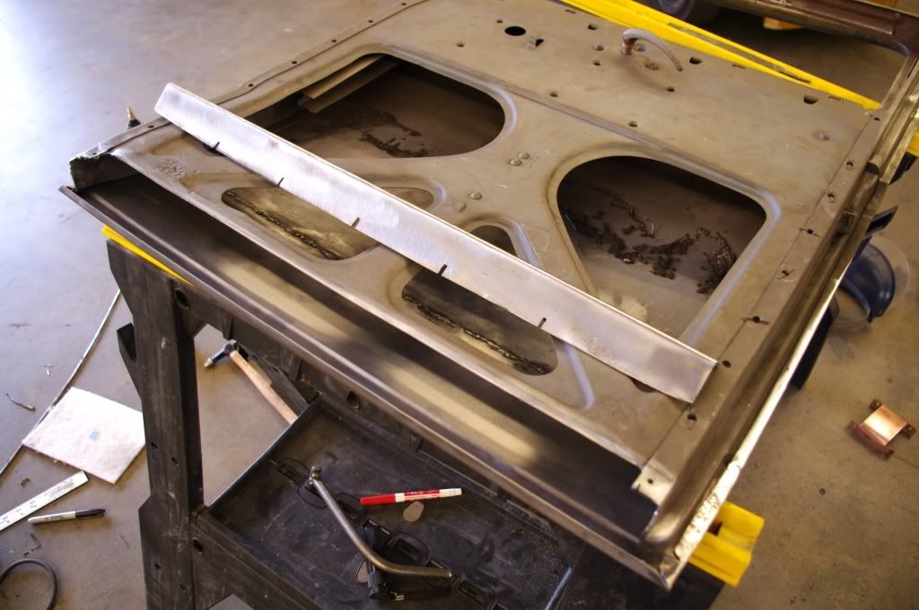

    Simple bend with 18 gage and some slots to replace it.
    tacked
    For some reason I didn't take any pictures between that stage and the final product. But you get the idea.

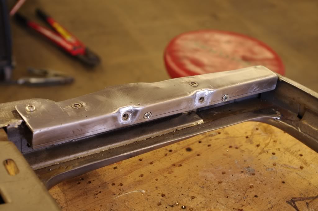

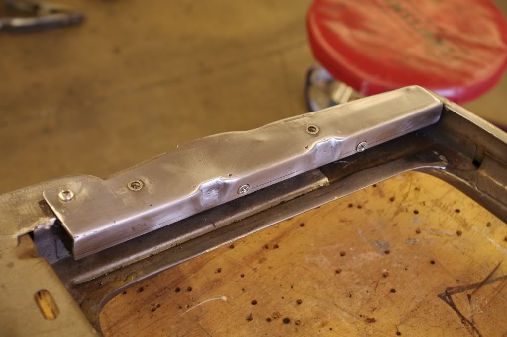

    Here's the window retainer I had to make...
    What was left of the old one sitting next to it
    Don't mind the ugly screws. They're just for mock up. Gotta' get the correct ones yet.

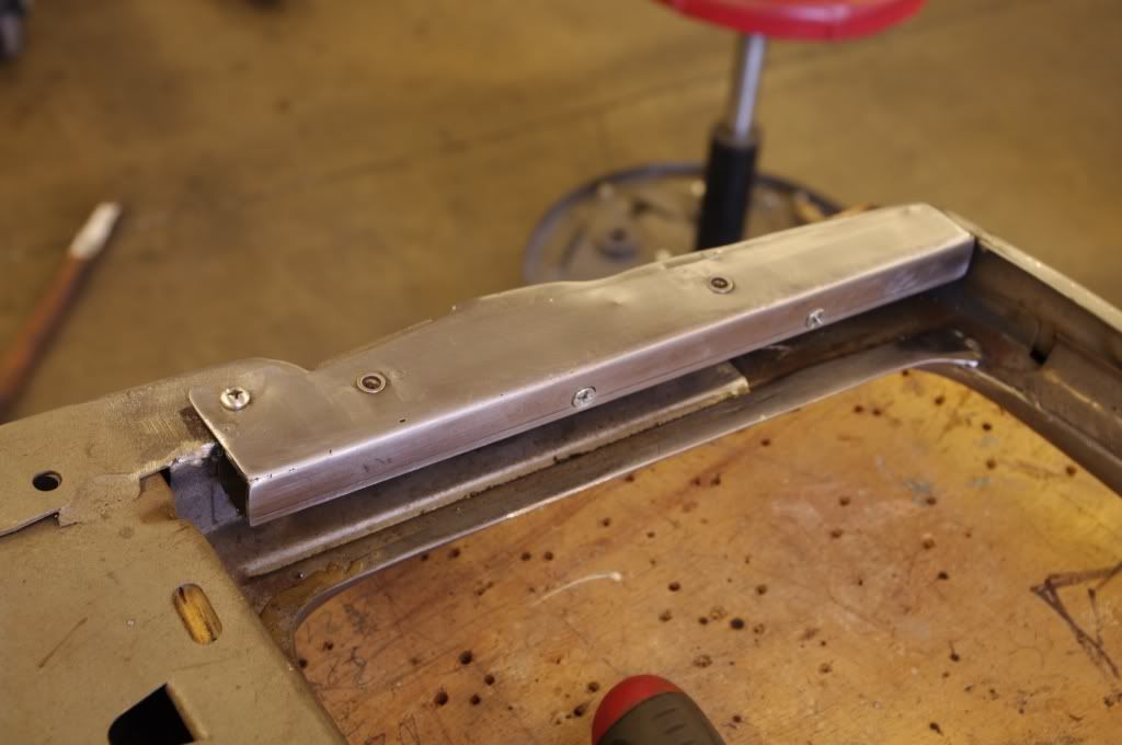

    Next I had to modify that piece so the garnish molding could be screwed in place. Sort of complicated. Needed angle recesses to match up to the shape of the garnish.
    8-32 inserts installed

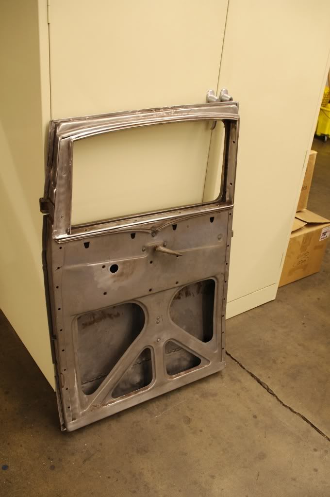

    The door is shaping up nicely! You can see the finished bottom now, and I also removed the door upholstery hooks and filled them.
