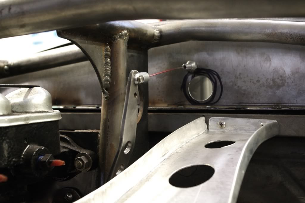

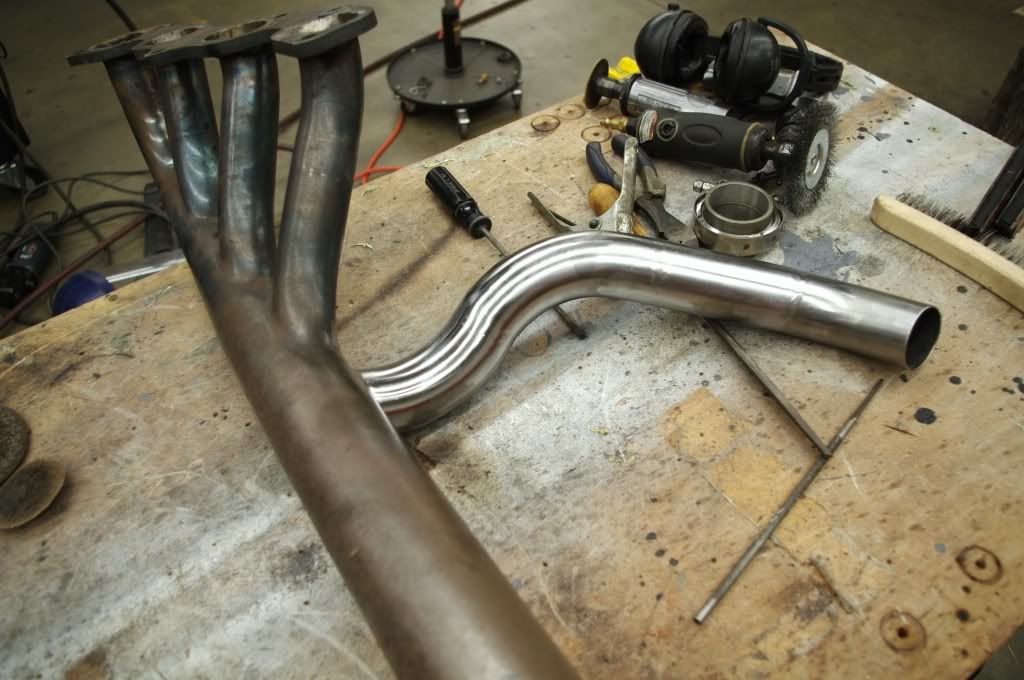

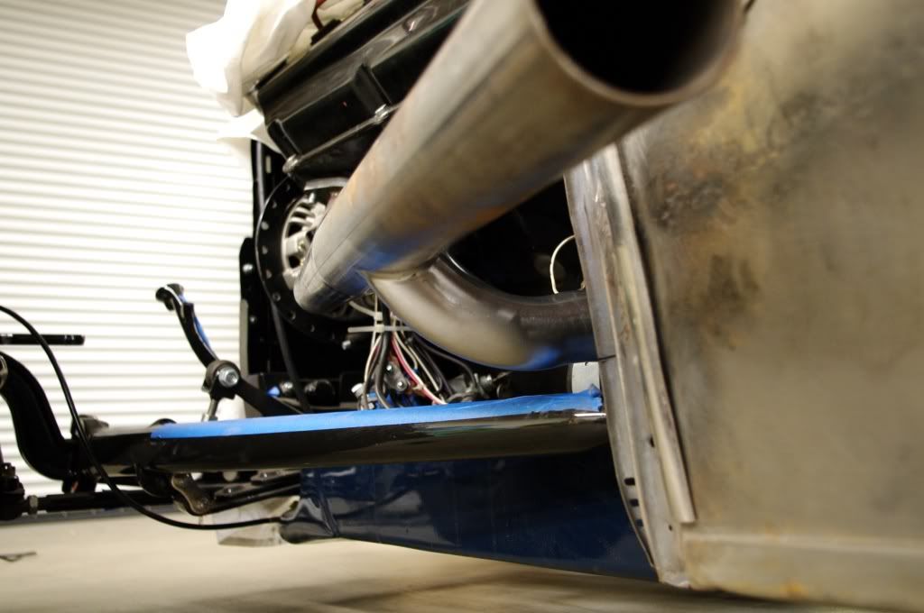

    I've been focusing a lot on things I need to get done with the body in-place so I can get it off the ch***is and progress on some real finish work. Transmission tunnel and floor stuff, oil filter mounting, rear panel work, and most recently I've had to get the dump tubes done for the exhaust cut-outs as well as the throttle pedal working and linked to the engine. So here's a few teasers...
    NOTE: All the phillips head screws I'm using are just for mock-up. I have slotted screws to replace them all... (just saying it before JJ calls me out)
    Other side
    Then I finally did some work on the throttle pedal ***embly. "vroom vroom" noises are becoming much more realistic with working controls! :D

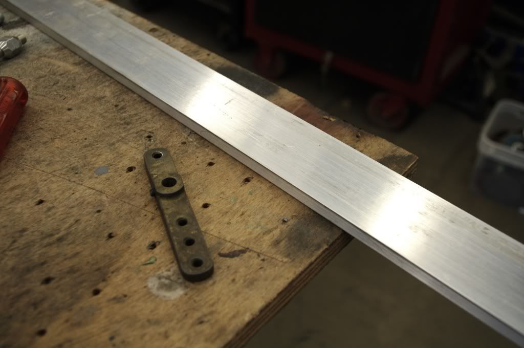

    Needed an input arm for the 6x2 linkage as well. I had this one from a linkage I borrowed from another HAMBer to set up mine, so I sort of replicated it, but wanted a clamp style instead of set screw style.
    Little knurling on the cross shaft...
    And sort of set up... I hate the look of those plated parts for the throttle cable. I will probably paint them, or something.

    One question that you most likely have covered, but will there be a sleeve/bushing of some sort on the cable guide through the firewall?
    On that entry angle it looks like a good place for the cable to get scuffed.

    Yes... The cable goes through a machined aluminum piece attached to the end of the cable housing, and it's sort of hard to tell from the angle of the picture, but I tweaked the cable entry point in the firewall so that the machined sleeve was running as tangent as possible to the swing of the pulling arm.
    That big *** hole underneath where the cable comes through will probably be closed up and moved. That was for wires, sender tubes, and everything else, but I think it's going to be in a bad place.

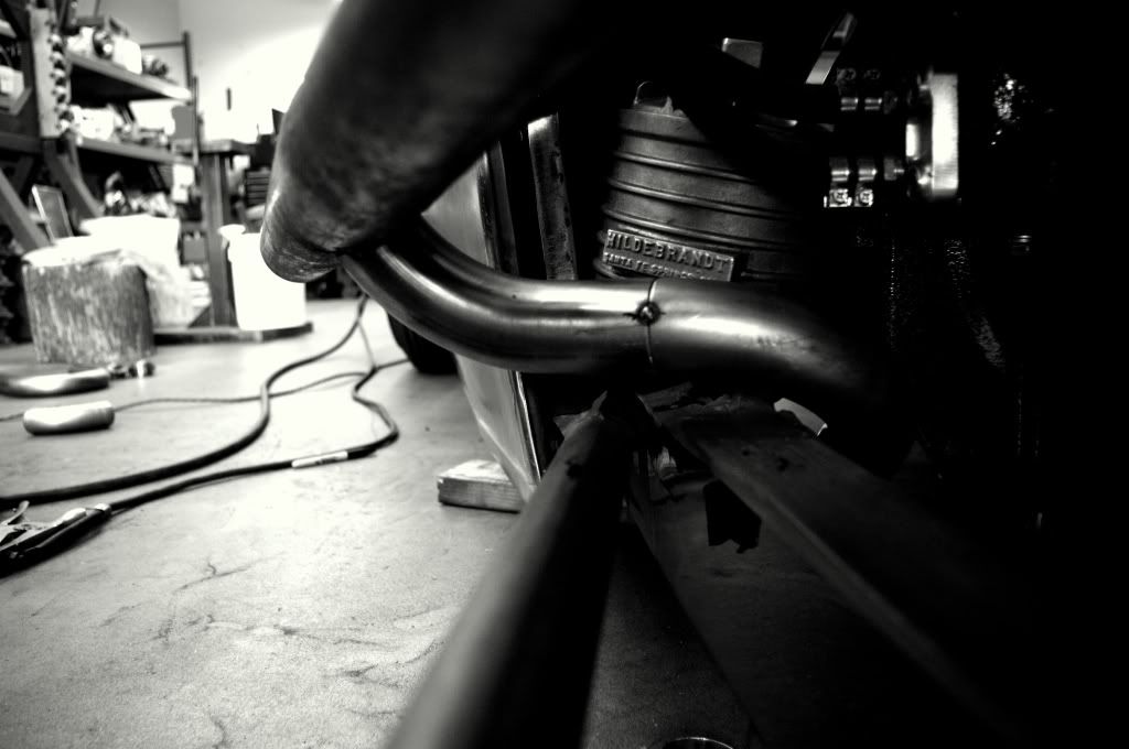

    I really like (and can appreciate) your exhaust system work. The way you made the tubes come off the dumps so they are not noticeable is really nice. I did the same here on mine. I think it pays off in the long run.

    Thanks for the words guys! I appreciate it! I think it's really hard to explain/show the differences that have taken place with this car. Just takes hours and hours to straighten out one line, fix door gaps, make various patches from scratch and weld them all in. The thing that is REALLY time consuming right now is I'm faced with all the little means of attaching garnish moldings and window regulator panels that were attached to wood that has since been replaced with metal. Had to do some really creative things just to have provisions to screw things back together. :eek::eek:
    That's virtually the same cap design I was going to go with... Guess I'll have to change it now. :rolleyes::D HAHA! Looks fantastic! Just nice and clean! Nice work!

    Looks great Scott. Where did you get the clamps for connecting the sections of exhaust together from?

    The v-band clamp unions are from Silicone Intakes - http://www.siliconeintakes.com/
    Most reasonably priced I've found. VERY slick way to create a low-profile union. I had to be able to pull the rear half of my exhaust through the frame which meant I couldn't use a bolt-on flange or anything like that and I was afraid that a slip type union wouldn't hold like I wanted, so I opted to go this direction. I think I paid $58 shipped for both sides with a pair of clamps and the flanges for both sides. I'll do the rest of the exhaust with the body off.

    That one piece just about sums up the quality of this build, 5+ hours to make it? [​IMG]

    30 seconds to cut the material, 5 minutes to set it up in the mill and square it, 2 minutes to transfer and punch the holes, 5 minutes to set up the chuck and drill the thru-holes, another 5 minutes to switch to a 5/16" end mill and mill the 0.10" deep slot to retain the rear nut, 10 minutes to flip it over, take another 0.10" off the back side and free-hand the shoulder around the pivot hole, make the recess for the screw head and chamfer the corners. 5 minutes to cut the clamping slot (which is crooked and drives me NUTS), another 15 minutes in file work, 10 more quick sloppy minutes with some abrasives and a super quick polish job. Soooo.... About an hour. :D
