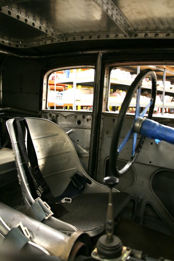

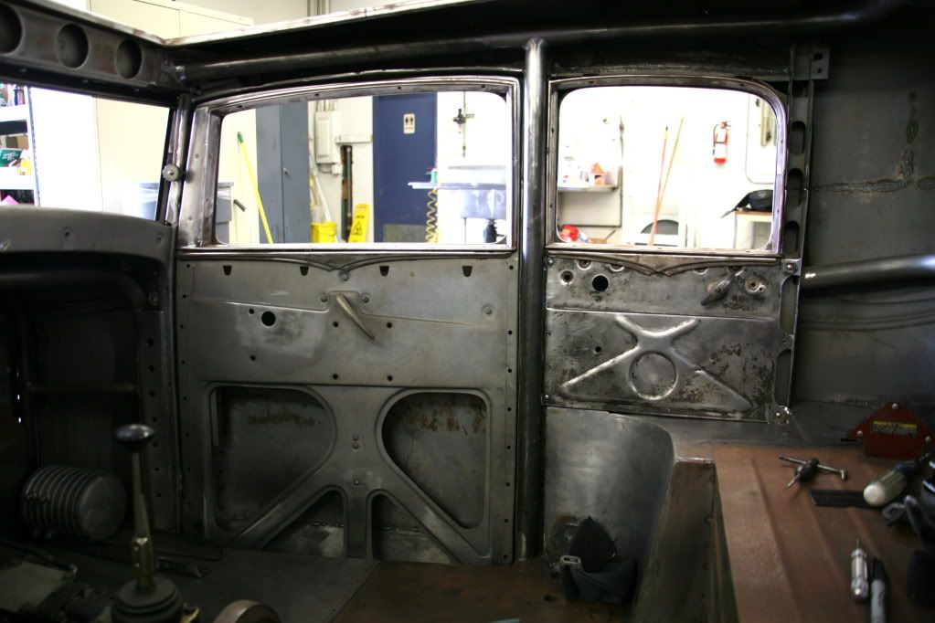

    Okay... Here's the kind of **** that has been taking me awhile...
    Quarter window regulators and panels, more finish work on the floors and firewall.

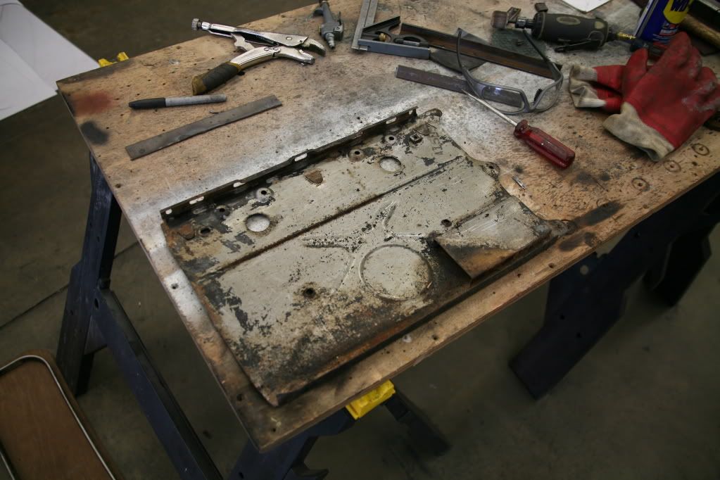

    Not sure why I don't have a picture of these all cleaned up, but the regulators turned out nice and work great. One needs a new spring, but other than that are ready to be prepped and painted.
    More panel stuff...
    Actually found a part number after stripping the paint.... Interesting.
    Putting panels back in place were not so easy. Had to make mounting tabs so I had something to mount the regulator panels to. No wood to screw to...

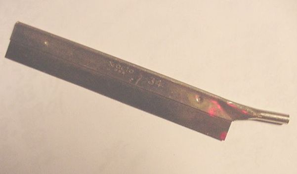

    An X-acto would work on aluminum, and save you a few bucks. :)

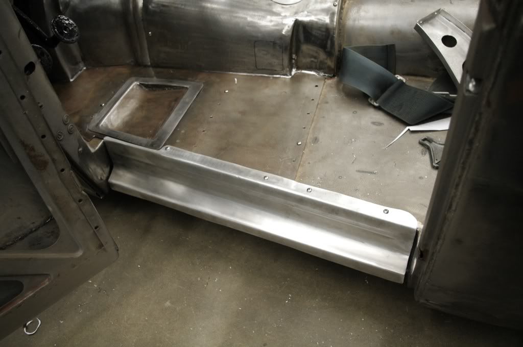

    Next thing I had to address is the access cover for the oil filter. The oil filter has to be access from inside of the car because of the way I ran the headers. The firewall relief was already installed, but wasn't removable. So I had to cut it out, add flanges, smooth it all out, and get it to fit right with the floor pieces and tunnel. Still needs a little bit more fitting, but it's close now.
    Oh... and excuse the welds. I knew I was going to smooth out the welds, so I thought this would be a good component to work on a little TIG welding. Far from being awesome. :eek::eek::eek: Just gotta' keep practicing though...
    After splitting the tunnel so I can remove it easier. STILL not done though...
