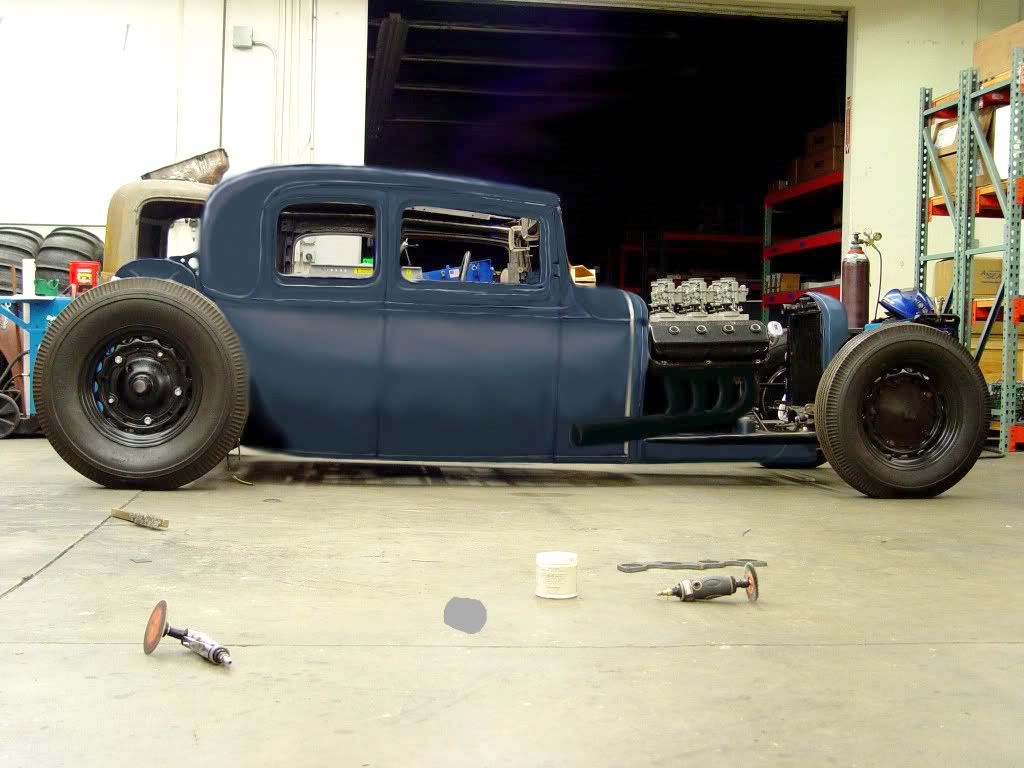

    Scott,
    I apologize if I have asked this before or in you have answered it before but:
    How are you going to terminate the lower-most body line into the rear of the cab?
    Are you leaving it as is or are you doing a little more work there to vanish it back?
    The rear wheel wont cover it correct?
    Big Brother..
  5. scootermcrad
    Joined: Sep 20, 2005
    Posts: 12,383
    scootermcrad
    Excellent question, my dear brother!
    I actually figured someone would ask me this eventually after showing those pictures.
    I have an internal battle with this right now. The wheel blocks the view, but doesn't hide it (if that makes sense). As you can see it needs more work. I have three options, none of which I will be able to deal with until it's getting re***embled:
    A) carry the bead all the way around the filler panels and don't put the tail on the rear panel
    B) Carry the bead around the filler panels and INTO the tail panel
    C) Carry the bead into the filler panel, but then let it fade out and just have the lip turned under (since it's not really seen).
    I'm leaning towards option 'B' because I really think the tail panel gives it a nice finished look and it was also part of the original car as well as a panel that was UNIQUE to this car. I think it would be worth the effort to do this. It's definitely the more difficult way of doing it, but I've come this far so I think the extra effort would be worth it.
    I'll make a sketch of what I'm thinking... Hold tight!

    I am in agreement. I think carrying the bead all the way around would look great. As you have said you have come this far and put this much effort into it already, what is a little more? You have done some amazing work my friend.

    B, go with the tail piece and finish it....we've already had this conversation on half ***ing versus touching everything, this is a prime example.

    Go with A or C. B looks too much like Orange County Choppers. I mean, these are 80 year old cars and for them to look correct the character of that body needs to be preserved. If we start changing everything you get Shadow Rods right? The best looking Hot Rods stick to "K.I.S.S"......Keep It Simple Stupid.
    I will agree that choice B looks great design wise, and you as an engineer will have a hard time leaving it alone. But you have to separate yourself as a professional I think sometimes when building a Hot Rod. Internally and structurally this car exudes your attention to detail with the Super stout quick change, 6 speed, bracketry etc but where you car can overstep the boundary and start crossing into something far from a traditional based Hot Rod is when you start ****ing with the body so much that the character is lost from the original.
    To me you have so much ****ing Talent Scott it's not funny. You just need to reign in the restraint and let things either be as they were or allow for the simple path. Think of the best Hot Rods in history. Doan Spencer roadster was way ahead of it's time btu still very much a '32 Roadster. He changed things on that car but knew when to say enough is enough.

    Well I have to admit that I constructed that thought before I seen the actual piece that you planned on using. Your drawing conjured up thoughts of crazy pullmax beaten panels and something that looked out of place. The idea of using something from the car in a different place is far better then I originally thought.
    However, see the way the back of the used to be in the above image? It's never going to get better then that. A simple body line that follows the bottom of the car is really my only vision that I can see. When I look at option "B" in the real world from the picture provided, I see the piece but I also see how much other sheet metal probably will be involved to envelope the the rest of the suspension with out looking unfinished. This is where things start to get out of hand.
    I trust that because the rest of this car has turned out so great that what ever you choose will be cool. I just want to see you driving this car soon. So if that involves taking a simpler approach then so be it. I think we both could benefit from taking a trip out to Spokane Washington and hanging with Chris. He builds his **** simple but it's definitely cool and certainly all Hot Rod. hahaha!!!!

    This part of construction wouldn't stop me from driving it. I am going to look at things again.
    the biggest problem I have with all this is that the 4-link is a huge disruption for the lines of the sheetmetal in that area. I would really like the lines of the body to compliment the mechanicalness of the rear suspension components. Right now it just looks like an extended pickup cab with an axle behind it. Not grooving for me.

    Seriously though, did you try to picture some of the suspension pieces in paint? They take on a whole new look once they have a coat of black or whatever on them They won't scream out for attention. If I were in your pickle, I would look into making the parts that create the disruption into something beautiful. Whether that be a coat of black paint or what but on a car like your where the mechanics are so well thought out the last thing I would do it hide them. That's your bread and ****er right there. Indian Larry always had a cool motto regarding the display of the inner workings on his bikes. I don't know it by word but he tried to make the bikes easy to work on and showcase the mechanical side of the bike and because of that it became something beautiful.
    You're a hell of an engineer, I am sure that your four link is going to look awesome once the paint is one. But that's not saying that the "B" piece is not cool too. I just think it's not necessary.

    you know I am a man of few words. So with as little words as I can muster I will give you my feeble design opinion.
    You need to leave that rear kick off. The only way that kick would make sense to me in your application is if it still had the fenders on and well you don't.
    You have such great lines with everything ***embled right now that putting that tail on would just disrupt so much visually.

    I like this! I actually really appreciate all of you coming together and giving your input! THANKS!!!! I'm not one to poopoo ideas when they make sense. Especially when I'm on the fence myself about the ideas.
    The reason I didn't put the panels in the bead roller before I put them in was because I didn't know exactly how they were going to work and fit. I didn't even know where to cut exactly. I started cutting and just kept t******* until it matched the rest of the lines.

    Scooter,looking good!! Bear with me here, I think that of your current options, 'B' is the best. So far the body, to me, looks unfinished. I am not a fan of lots of curves, (on cars that is) I prefer more of a straight line approach. With motorcycles my favorite is the Art Deco Harleys. I just love the frames, all straight lines. The curves of the fenders just bring out the frame lines. I do realize that you kept the origional body lines, but it just looks unfinished. I guess time will tell when it is all said and done. I absouletly love the attention to detail in your car.
    But you have to get it finished!!!!!!!!!!

    Don't forget my photoshop paint job. This shows the color. It's down low and fairly hidden by the engine because of how pinched it is, but it will contrast the blacked out headers and other engine details.
