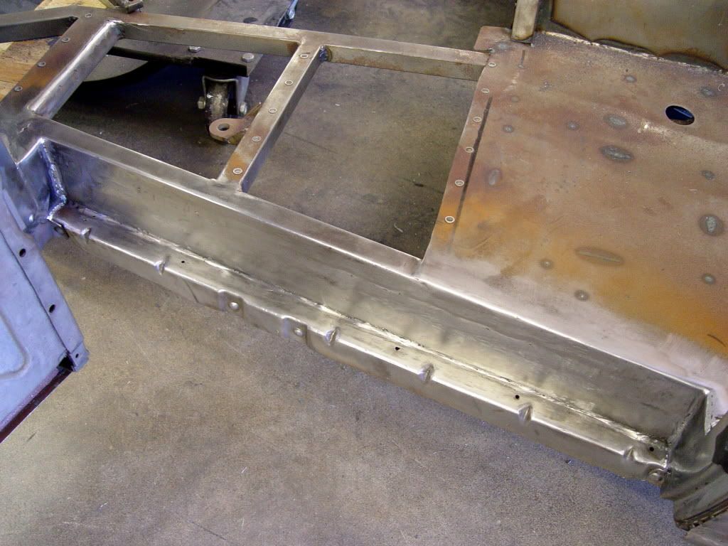

    Here's some pictures from this past weekend. Worked on the driver's side door sil and A-pillar supports that tie the cowl structure into the A-pillar.

    Looking Good Dude! That rocker step is just beautiful.

    What's going on in this photo scooter.... looks like the A pillar is gimped up? Did you already have a wreck? :D
    Looks like it's going to be hard to flush fit some kick panels??

    It's a 1/4" plate (both sides of the car) that ties the whole cowl structure into the A-pillar. It has sort of a twist to it because of how the cowl structure's tubing ties into the subfloor at the bottom.
    There won't be much of a kick panel inside. Maybe no kick panel at all. Not sure yet. If so, they will be up against the inside of the cowl sheetmetal. I need all the room I can get for three pedals! :eek: Channeled cars ****...

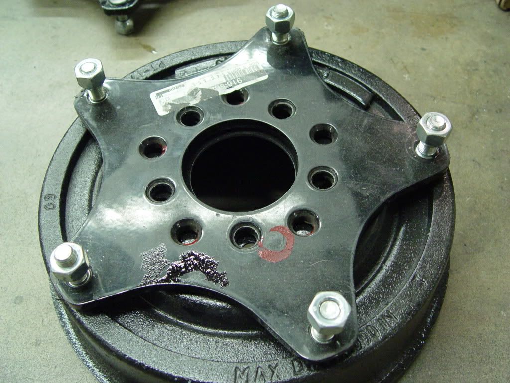

    The other thing that needed to be addressed, that I felt motivated to work on, was getting the wide-five adapters, with their new studs, to sit flat up against the brake drums. Super important that there is no gap, or I'm asking for serious issues!
    Obvious gap...
    Solution: Mill about .100" off the back end of the wheel studs...
    No more gap!

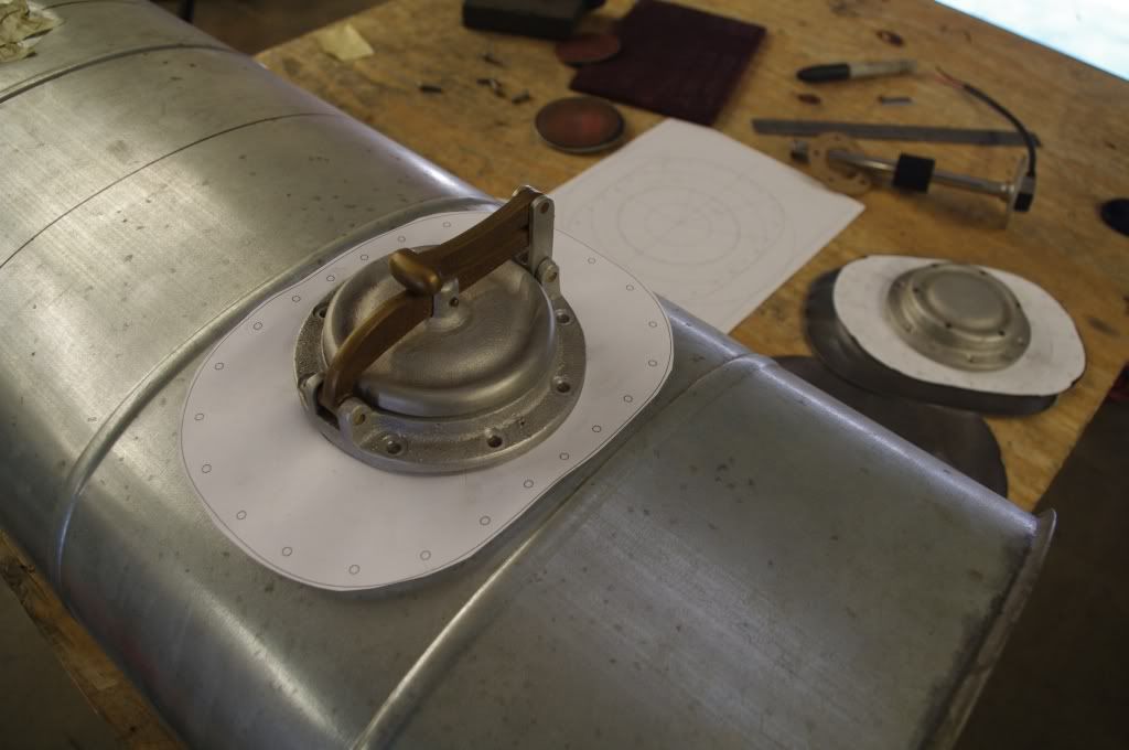

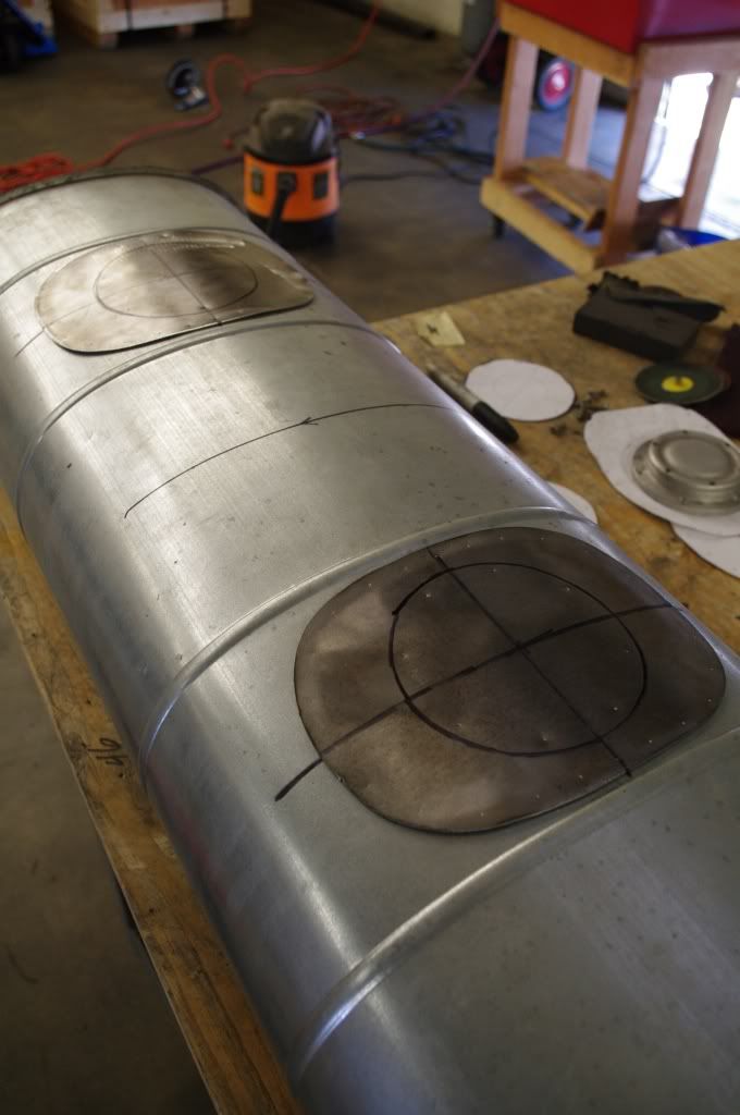

    Headlight buckets are basically ready for primer. Need to address the garbage that's inside. The 28/29 commercial buckets were mis-matched. One had been nickel plated and was flaking off. Took off all the peeled plating and then some to be sure the plating wouldn't lift or flake off under the paint.
    Not much else worth showing, except that I started making the adapter bonnets/flanges for the fuel tank.

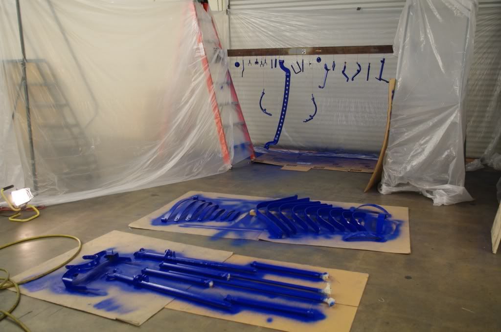

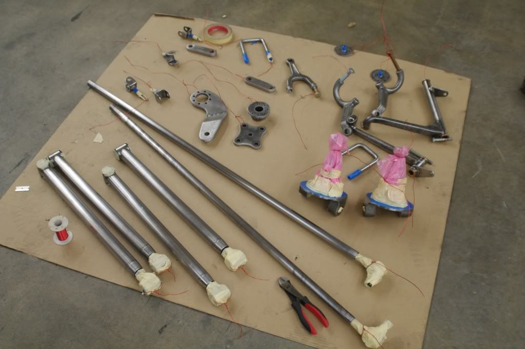

    Okay... Some "smurfy" progress!
    This probably won't look like much of a progress report, but I'm hear to tell you that there is a ton of work getting to this point from the last update! Prep, prep, and MORE PREP!!!! All in the name of getting the primer down!
    I've had just an insane amount of help from aerocraftsman, slowandlow63, overspray, pimpin paint, and several others! Thanks to everyone who has taken the time to hold my hand through the painting process. This is my first time REALLY using professional quality paints/coatings. I've done a TON of body work in the past, but never top coated with anything worth mentioning. I even had to get used to something other than a spray can... HLVP gun.
    So here's something to look at. It's hard on the eyes but it represents SERIOUS progress and a TON of knowledge earned during all this. Super excited about this. Everything that I primered will be GLOSS BLACK!
    The primer is Valspar's new DTM Epoxy Primer. It's available in a whole booklet of colors and they can mix it custom if you want to run around in a certain color before going all the way. It will even reduce further so it can be used as a sealer coat. I went with a blue thinking it would be a nice base coat for the single stage that will get put down over top and that I thought would be a little darker... but... well... ended up super bright and smurfy! Put your sungl***es on! :eek:
    The small parts masked and ready to hang up...
    Axle ready for wipe-down...
    There were a few pieces that I really wanted more of a finished look. So in the end you will see most of the visual welds will be smoothed. In this case I used Rage Gold and followed up with some sanding to get rid of 90% of what I put down. This is the radiator support.
    There's a couple other pieces, but it will be up to the m***es to figure out what and where got filler. Not much did... (thank god!) I just wanted some pieces to have that "cast" appearance as much as possible.
    Steering column got filler and skim coat beause the tapered tube portion was just driving me nuts. It was made from a piece of tubing and got 4 pie-cuts to get the shape. Didn't turn out perfectly round, but damn close. Want it as close to round as possible, so it looked like before primer went down.
    Quickie and steering column ready to be wiped down...
    And now for the blue...
    I have some block sanding to do and a couple runs that need attention, but mostly I'm ready for BLACK!
    I decided that I really wanted the durability of a two-part, single stage, Polyurethane. So I'm using an aircraft/industrial coating that's pretty similar to the Imron type paint. And since it has plenty of Polyisocyanates in the mist, I decided to follow the manufacturer's recomendations to buy a Fresh-Air Supplied Respirator to protect myself. The respirator is made by Hobby Air, and since I'm not doing this on a production basis, I think it will do the job just fine!
    So this weekend it's on to laying down some gloss black on all the PITA parts, and the suspension parts. Then I will start the parts that will be the final blue I've chosen for the sheetmetal. Frame, grille shell, headlights, tail lights, dash rail, garnish moldings, fuel tank, etc., etc,.... Another million hours of prep... GAH!
    So that's where I am! I have to say HATS OFF to those of you that paint for a living or even on a regular basis! This is an absolute sh!t ton of work! It's been fun learning the process, though! Getting better every time I mix a batch of paint.
    The real good news is, that once these parts turn black, and I get the frame painted it's final color, I can start re***embly. THAT is very good!
