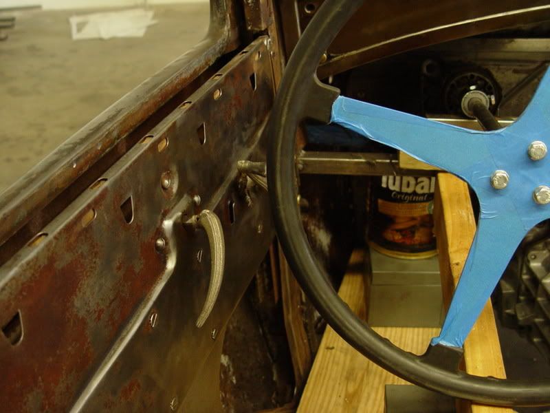

    Some new parts came in... picked up a Lime Works steering wheel from another HAMBer, quick release hub to mount it, steering shaft, a Wilwood clutch master cylinder, and a 67-70 Mustang brake master cylinder. Now I could really start thinking about how in the hell I'm going to control this thing.
    I'll be using a Mopar steering box for the cowl steering and the pedals will be set up reversed swing style (masters pointing back towards the driver). So I did a little mock up on the floor just to do some thinking.
    Now mocked up in the car.
    Not much room for the fingers! :eek: I think I can make some adjustments to work that out.
    Here's the quick release. I won't need to remove the steering wheel to get in and out, but it will help getting to things inside the car when needed, for adjustments or whatever. (the ugly red anodize will be stripped off. Summit said it was black... obviously it's NOT!)
    OH yeah! I made a burly header panel out of 1x3. It REALLY stiffened things up quite a bit! I still need to adjust the fit a bit and add rivnuts for the windshield, but other than that, It's pretty much good to go.

    question - are you going to leave the cowl top removable so that you can fill the brake and clutch reservoirs?

    I got the quick release from Summit racing. $49-ish?? I think it's a Rebco. SUPER easy to use. I figured once it's refinished in black it will be semi unoffensive looking. The less obvious it is the better! Blending it with the column I'm going to make is going to be a little tricky though. I'll figure something out.

    That's what I'm worried about too!!! :eek::eek: I spent about an hour sitting in it today with wheel in hand trying to figure out seating position. Came to some conclusions....
    1) clutch and brake will be tight but managable if I have the throttle (probably s**** size) close to the trans tunnel. I'm going to have a "rub plate" for my foot to comfortably slide on to operate the pedal.
    2) I'm going to round off the top of the Z behind the seat and gusset the bottom and maybe fish plate it. This should allow me to actually move the seat back an inch if I choose. I'm going to use some very low profile adjusters so the seat stays nice and low on the floor.
