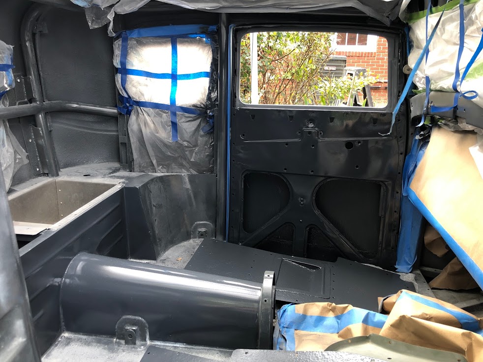

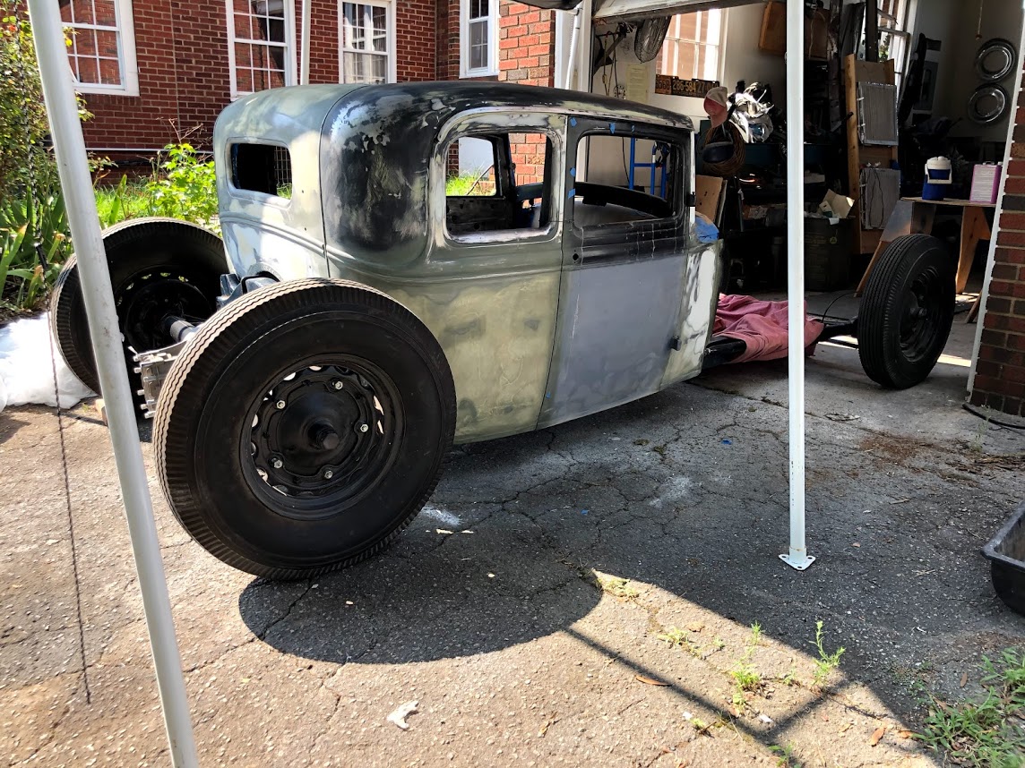

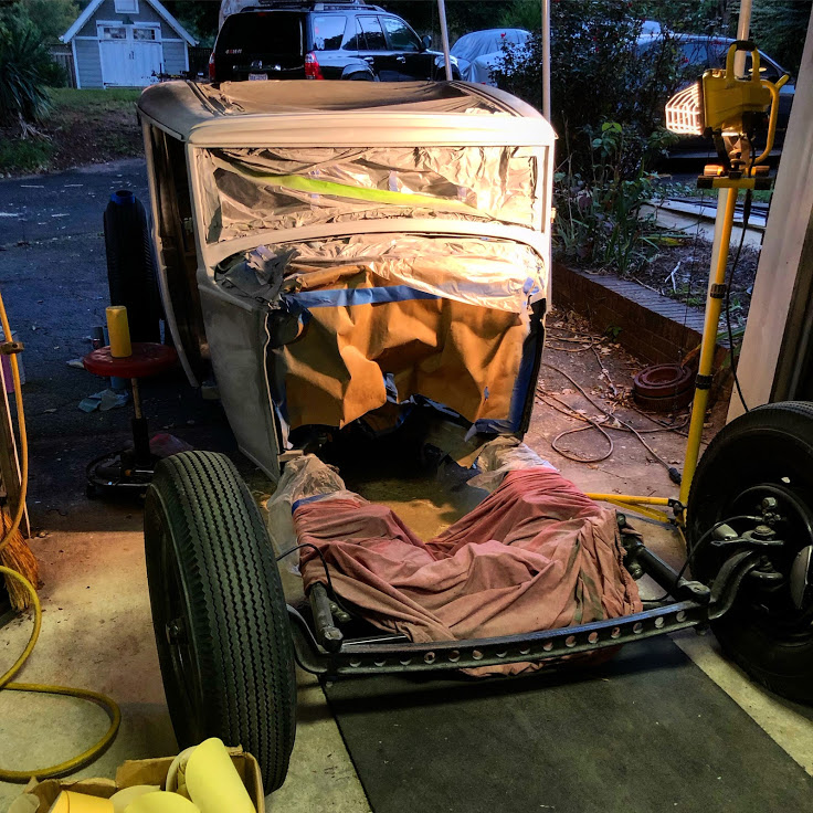

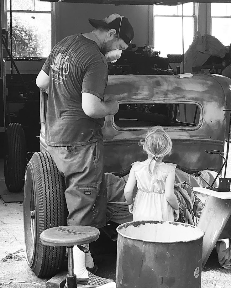

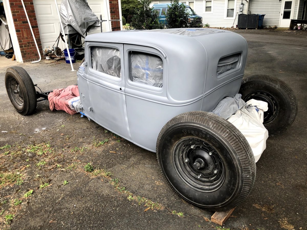

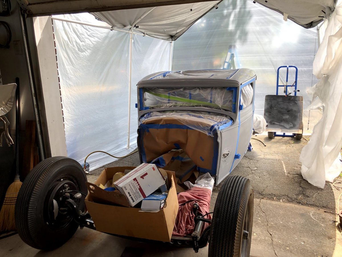

    Sooooo.... I have a decent update. I worked my *** off this weekend to get some high-build down on the main cab portion of this car. This is just a first round of high-build primer. I really needed to get a good baseline on where I'm at with the body work, so it was time. Plus, with the humidity here I was chasing flash rust and it was killing me. I would literally work an area in the morning and after a few hours it was turning red. Just exhausting!! But now it looks less like a cow and more like a car.
    I should also add that there is no way this could have happened if it weren't for my amazing wife holding down the fort and taking care of the kids, all while trying to get her own business off the ground. All I really want to do is support her on her business venture and hang with the fam, but I know it's important that this car gets finished and I'm glad she ALSO knows it must happen and why. My parents even came over yesterday and spent most of the day here just to help us so I could keep going. It's a struggle to balance something that falls more in the "hobby category" with general family life and responsibilities as parent. I don't want to miss out on anything...
    Anyway. Progress. From cow to primer.
    My 3 year old in her "Elsa dress" asking me how things are going and making sure I have everything I need. Damn, I love this kid. I love that she knows what "hot rods" are, too.
    Doors are masked because they're just not ready to shoot. They will be next. They don't need an awful lot to be ready. Maybe a full day of hard work and they'll be ready for high-build.
    And first look while pulling the "paint booth" apart.
    NOW I can see all the little details that need finishing. Overall, things are MUCH flatter than I expected them to be, considering the car was chopped, channeled, narrowed, shortened, and sectioned about 14 different ways.
    So next up will be the doors and whatever little bits like the garnish moldings, and that kind of ****. Then I will do a re-fit of the doors to make sure the door gaps are the way I need them to be. I need to make sure all the latches and whatever I plan to use for door seals work before going much further, as well. Last thing I need is to go all the way to color and find out that the doors don't close right anymore and the windows don't go up and down. Oh wait... I don't have windows yet.
    SOOO much left to do, but it's finally looking like something.
    A further note. My friend C***ie has been a huge help with this, also. She is doing a little color sanding for me to help keep things on schedule. She has the dash rail as a test piece and asked if I would let her do the cowl top. I hate asking for help, but at this point, I'm not going to turn down that kind of help. Otherwise this car will just never be done.
    That's if for now. Looking forward to getting more done. Never thought I'd see the light at the end of the tunnel for this paint ****, but I'm starting to see it. Or, maybe that's just the train coming...

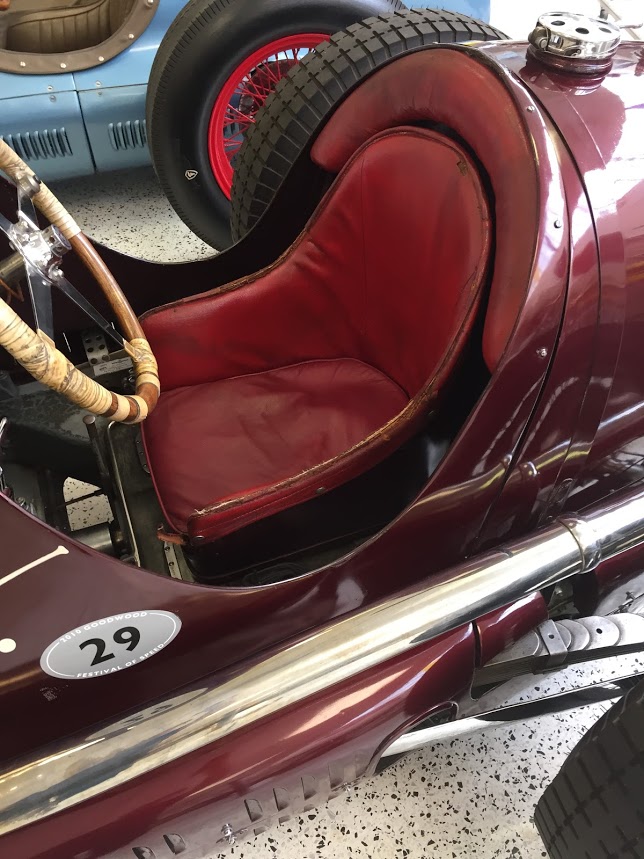

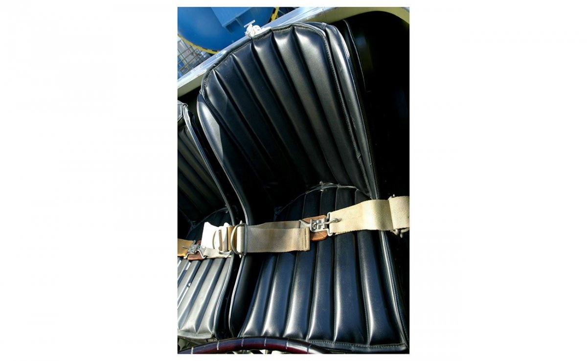

    Had a ****py set back last night. The young man that was going to do the upholstery on the seats backed out less than 3 weeks before my deadline (September 1st was when I needed them back) even though he had 13 months to figure out how to make it happen. Got the seats and materials delivered back to me last night, but now I have no time to find someone else to do them, so we're resorting BACK to "plan A". "Plan A" has always been to have my Wife do the seats. She has the machines to do it, but doesn't have a lot of experience or time. I guess everything happens for a reason, though. She ultimately really wanted to do the seats, but with her starting her business, and everything else going on, there wasn't going to be time in the day to make that happen. But, we have no other options, so she's excited and a little stressed out at the same time. We're going to use the money saved to hire our babysitter a few extra days.
    I was really excited to just show some finished seats and be able to put my **** in them. This ALWAYS seems to be my experience with hiring people to do work for me, though. This is why I always try to do my own stuff. I really feel like there is a reason for this, though. So stay tuned!!! Guess we'll be doing the upholstery ourselves, too...
    Just a reminder of what the heck the seats even look like...
    Here's some inspiration for what they're going to look like

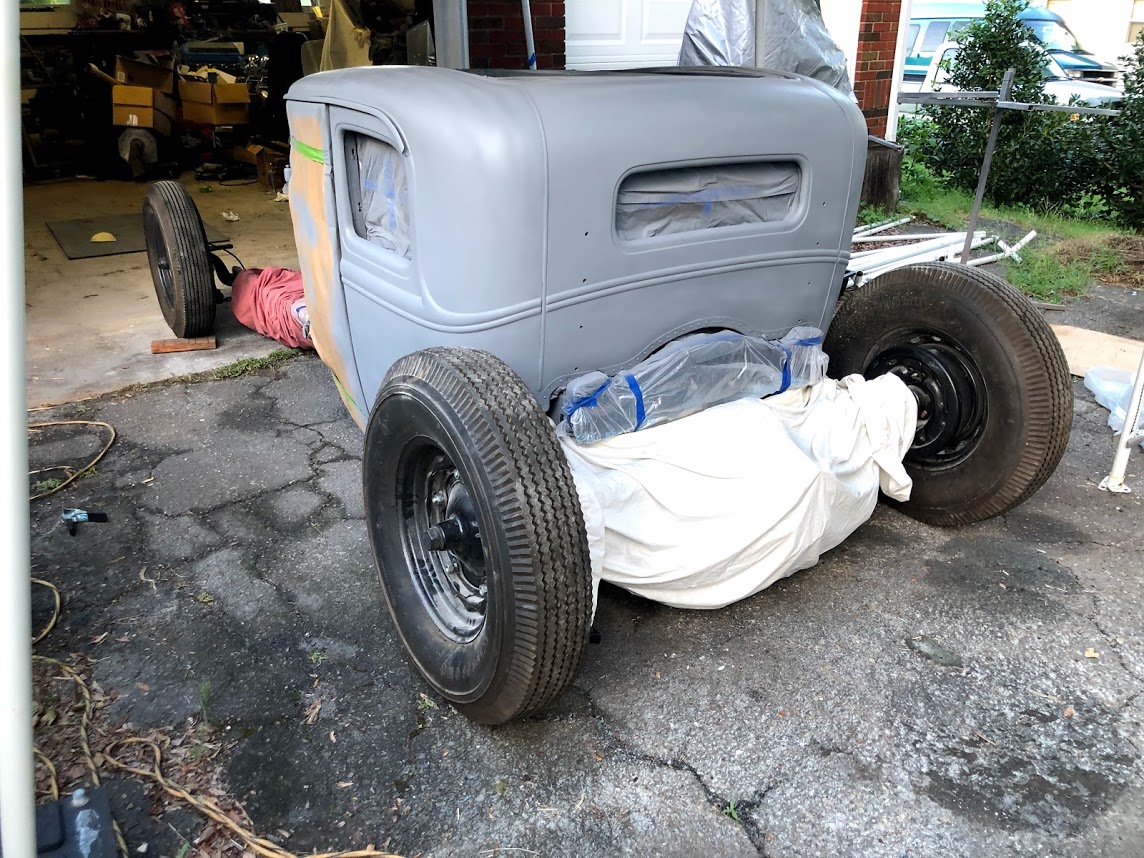

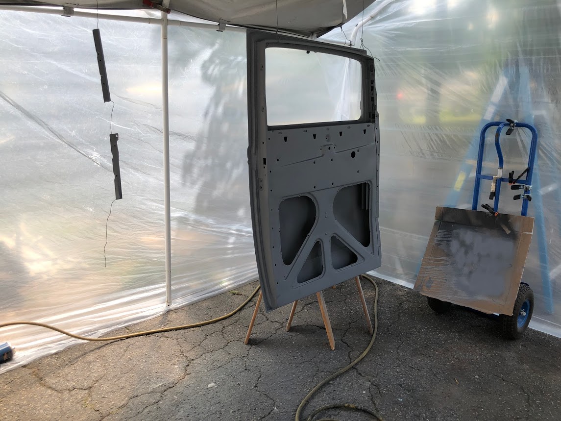

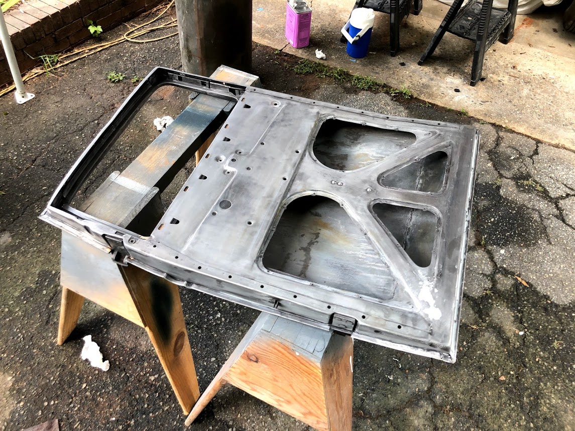

    Alright, alright... I got a little bit more work done. I've been working on the doors. They weren't too bad, overall, but just needed a lot of little things to get them in primer. Making sure any surface rust from sitting around was off and the INSIDE of the doors just SUUUUUUUCK! I stripped the factory tar off the inside a long time ago, and just needed to get them clean and sealed up.
    After a bunch of scrubbing and prep work I finally got these friggin' doors in high-build. I'm also finding that BEER drinking is really the best way to p*** the time between coats. HAHA
    That recommendation came from an English guy, once...
    Anyway, there's primer on the doors, which means all of the major body parts of this car (less a few odds and ends) are completely coated with SOMETHING! Never thought I would see the day!
    IMG_3641.jpg 62049674859__3A9DF337-692E-45F4-A95A-056359E99B93.JPG IMG_3872.jpg IMG_3874.jpg
    There is an actual metric ****-ton of work left to be done before it's ready for that Washington Blue, but it's moving along. Now that I have primer on, I can really see everything that needs to get attention. A whooooole bunch of little details here and there that will make my fingers raw, but I'm really getting close to seeing how this car will look in full color. Hopefully the color goes down better than the cowl top. Unfortunately, the cowl top will probably have to be redone. Seems I fisheyed it pretty good. They may be too deep to sand out. Could be a number of things that caused it, but I really suspect I rushed and didn't get it clean enough or there was some garbage in my paint cup. My friend C***ie has been helping with color sanding to keep me on-schedule and make sure I don't screw up anymore. So grateful!!

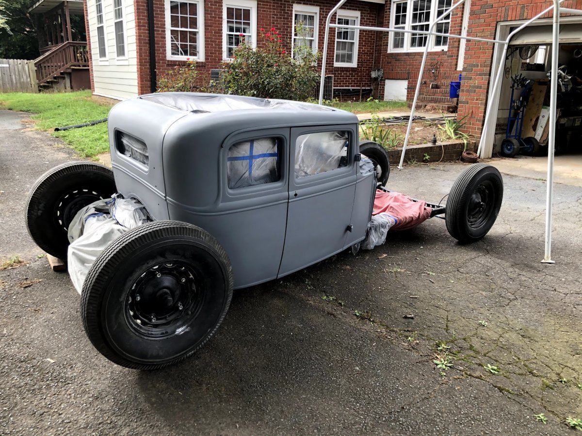

    Okay... more sanding and more primer. I would say I'm about 95% done with all the body work on the body itself. Few more small things to work out and want to take another look at the door gaps, but we're getting pretty dang close to final primer. Getting excited. If there's something I'm really learning, as time runs out, it's that this car has a bunch of character this is just going to remain. This car was never intended to be a "show car". Was always meant to be a "driver". So this being my first paint job, it probably won't look like a Million Dollar Paint Job, but it's going to feel like a million dollars to have it in the color I've been dreaming of and back together. If this car is getting used for what it's intended, none of this **** really matters. It's been a little bit of a struggle to come to terms with the fact that my OCD will get the best of me if I don't just leave some of it alone. Finding myself leveling areas and making them beautiful that will NEVER be seen, just kind of has to stop, now. I'm out of time. It has to be done. So whatever character is left when the car is complete, I hope people just appreciate all that I've been through to even get it this far.
    Next I need to address a few things on the doors, including taking another look at door gaps. A couple other small things and a few pinholes I need to catch with putty before I start blocking. But it's really taking shape, none the less.
    Some scenes...

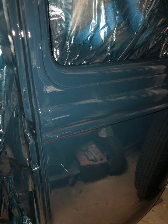

    I carefully put six coats of 1936 Ford Washington Blue Acrylic Urethane (single stage) on. Only a couple runs and sags, but since they happened early, I thought I better get enough material on to get a good cut and polish.
    In to the night, it was interesting to see how the color changes in various lighting situations. The halogen light really brought out the green undertones.
    And then finally... because no good paint job could possibly go perfect, while I was cleaning up I set the halogen light up on the ledge next to the car, and I guess it wasn't sitting quite right and....
    ...it fell into the left side of the car. I cried a little. Couple big scratches I get to fix now.
    But all ****py endings aside, the paint looks FANTASTIC!!! I'm super happy with how flat the panels ended up being and no strange issues like I had on the cowl top (which I ALSO get to re-shoot next weekend).
