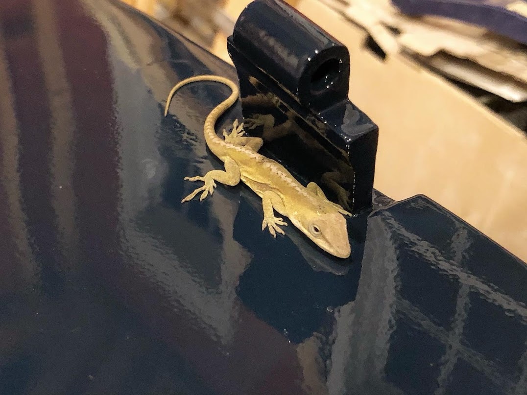

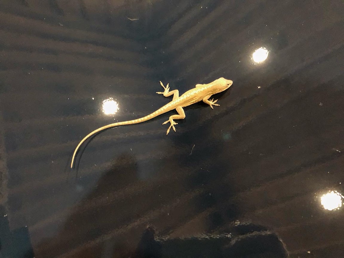

    Well... I caught this little guy warming himself a couple days after these had set. Kind of qualify as reflection posts. HAHA! You can see some of the color sanding work I have to do.
